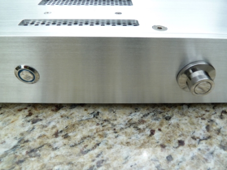

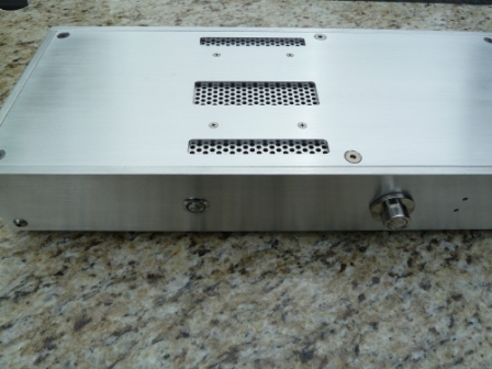

I did a little snooping to educate myself on photos and posting. Here are some photos, compressed enough I hope, to be visible but not foul up the system.
I really wanted to get the chassis parts black-anodized, so the switch and knob would contrast with the front panel, but the cost is prohibitive for one-off projects: $130 for six chassis pieces, almost all of it set up charges. Instead I just gave the pieces a careful sanding, for the "brushed aluminum" look. I suppose that will have to do, and I'll just wear latex gloves all the time. ;>)

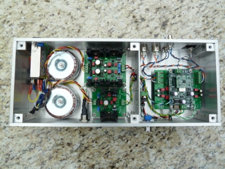

I plead guilty as charged, because I did indeed spend a lot of time trying to figure out how to make the project look nice, for a number of reasons, including Wife Acceptance Factor. (Never underestimate the importance of WAF to the ultimate success of any project!) I also wanted to house Russ and Brian's well thought-out and beautifully-executed product in something that would do it justice. To quote Nelson Pass: "Whatever you do, keep in mind that the chassis will be the temple in which your project is housed, and do a good job. Plan it carefully, take your time, and try not to be too cheap about it. For proper perspective, [Pass recommends] the book Zen and the Art of Motorcycle Maintenance, by Robert Pirsig." (A-75, Part II article)
We all bring different skills to DIY audio. Mine include greater ability at metal working than at circuit analysis, and I saw no way that my meager knowledge of electronics would allow me to improve on this Twisted Pair product. My last two projects were linear regulated power supplies, done in point-to-point wiring on vectorboard, and I took the opportunity in building those to substitute some higher quality parts and to draw from the design ideas of more than one person. Since I couldn't do that with the Buff and IVY, I concentrated on the temple, rather than on the truths within.
Incidently, the exterior of the thing is only part of it. I took care to put the AC bits and the transformer magnetic fields as far as possible from the sensitive audio and digital circuitry, and added a full partition to aid in shielding the latter. I went back and re-did the chassis (when it was already complete) with strategically placed holes on the bottom, and I milled out sections on the top, after learning that shunt regulators have the potential to generate a lot of heat that needs ventilating. I imagine this will help with circuit stability and with component life. I included an AC line-filter network to avoid messing up Russ's sterling results with the garbage on my power lines. I included a nice Bourns CP pot instead of the unit supplied with the Volumite kit, because I'm an incurable pot snob. (Sorry Brian, that was one place where I had to ignore the BOM and go it alone. I know it has absolutely no effect on sound quality in this case.)
I agree, Function is what it's ultimately all about. But Form is very important too; and Form-married-to-Function is an ideal worth striving for.
I wish you well on your upcoming Buffalo III project and will be interested to hear how your endeavors turn out.
