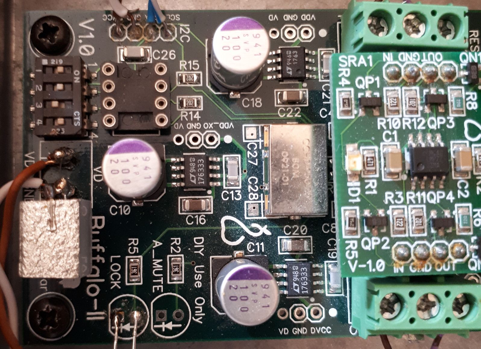

Hi Russ & Brian,
Been enjoying the buffalo II DAC for long time now but now am exploring options for optimising the PSU arrangements.
Is it possible to have completely separate digital & analogue supplies & ground planes & also have completely separate supplies for the L & R channels ?
Or do I have to have a different DAC for each channel to give this kind of separation.
I am stuggling to find schematic & PCB layout - could you help with that ?
I attach a pic to show you the regulator boards I have at present. I am using a single placid supply at present.
Any advice you may have to get the very best from this buffalo DAC would be welcome.
thanks
mike mears
p.s. I am trying to prevent any noise on the digital ground polluting the analogue grounds & likewise between the two analogue channels.
