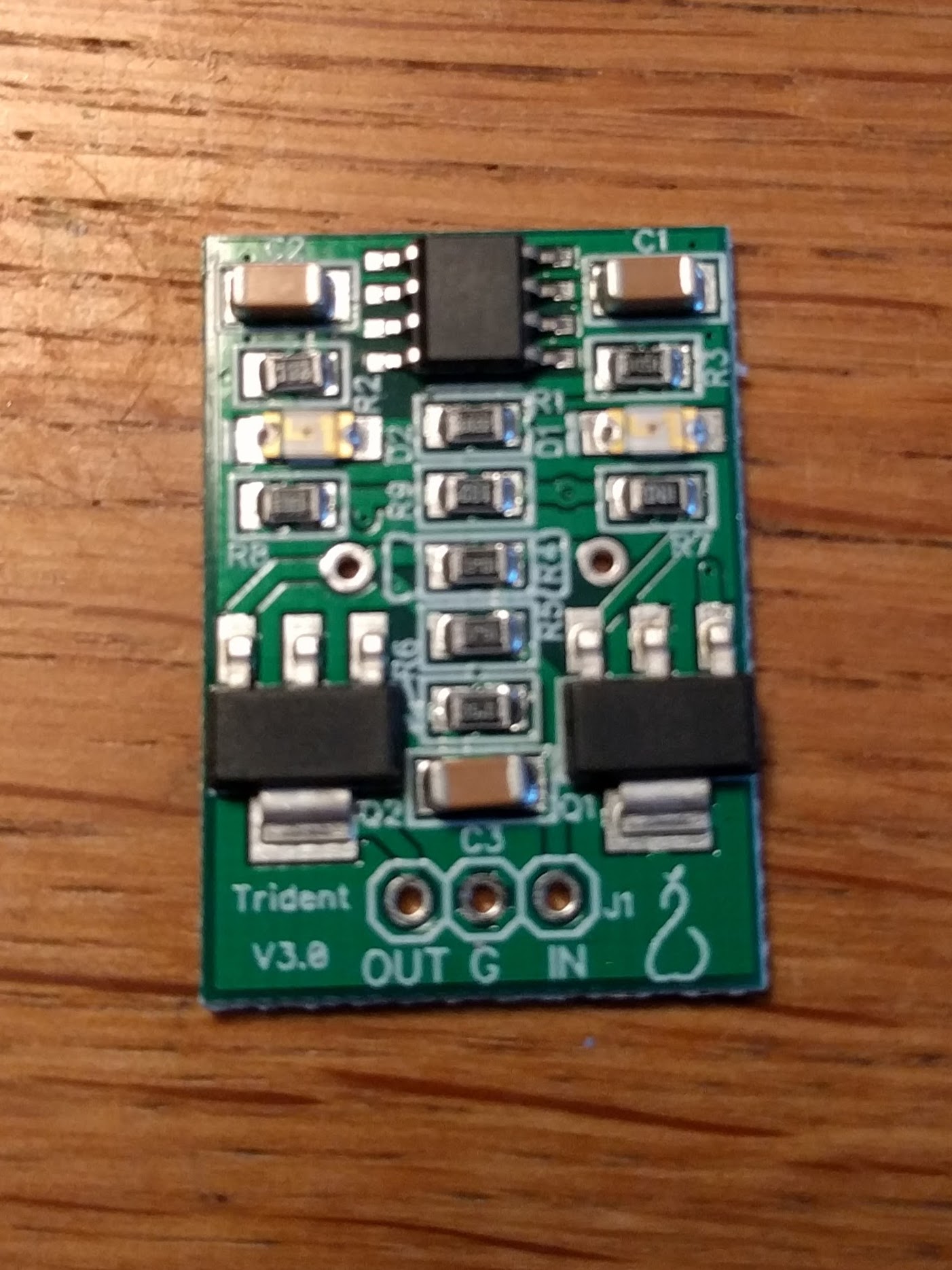

I have a Buffalo II with trident regulators, 100 Mhz, but quite old, I would say 2011 or so. I found conflicting information about the maximum voltage the trident can withstand. On the website is written 6.5 V on Leon guide is written 5.5 V (Actually this is what I remembered).
What is the right value ? I would like to power it with a 6 V battery and I am tryint to understand if this is safe or not.

It depends on the version of the Trident. The newer V3 Trident can handle 6.5V, the older Tridents are limited to 5.5V.
The Trident 3 has two larger SOT223-4 ZX5T951GTA transistors and are marked V3.0.
Also, the new TridentSR is limited to 5.5V as well.
