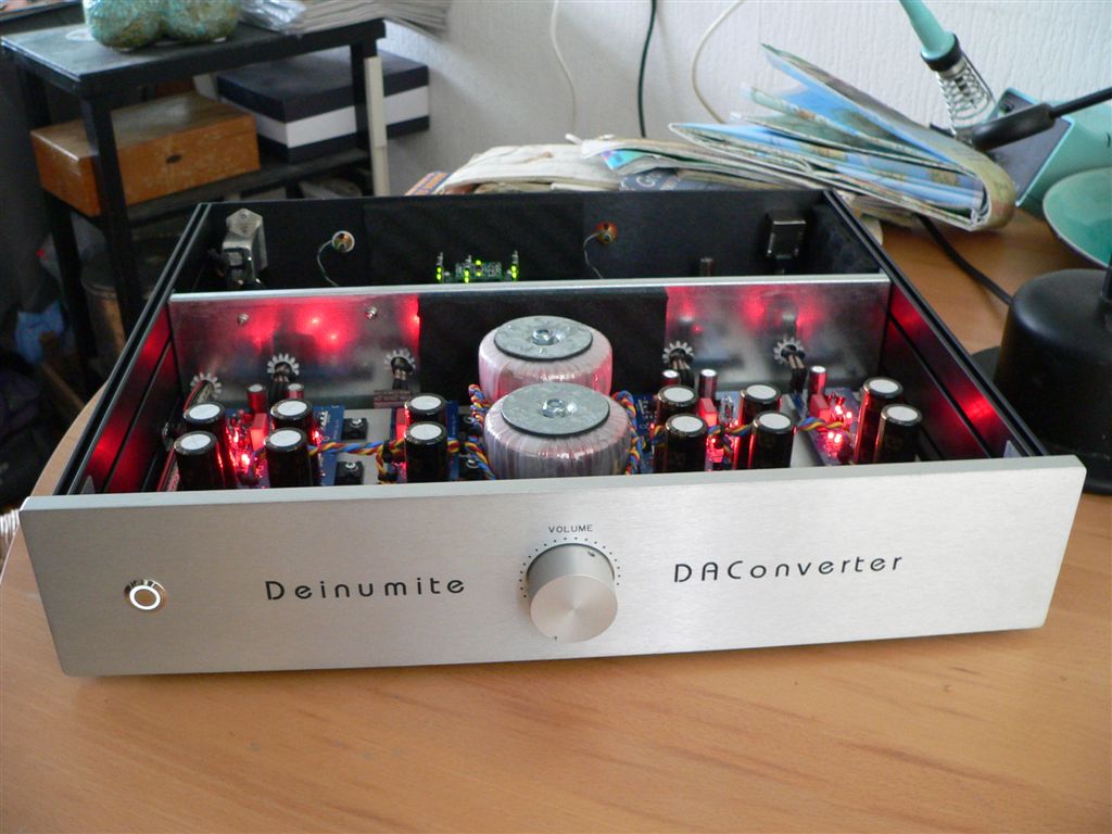

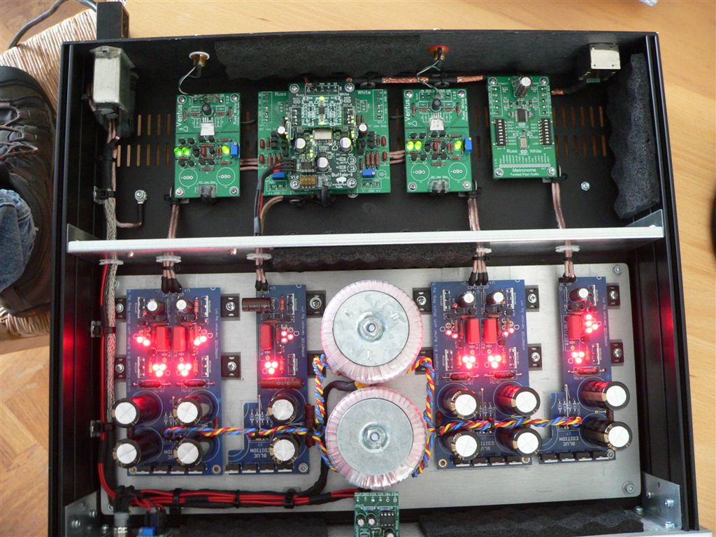

Just because I like threads with an occasional picture.
Thanks Twisted Pear, the B2 sounds GOOD and reveals more every day !
Nice box, where did you bought? excellent & neat work, congrats
![spin :spin: :spin:](https://files.diyaudio.com/forums/images/smilies/spin.gif)
Wow that looks awesome. Nice use of the dcb1 buffers too.
What else is in that box?
