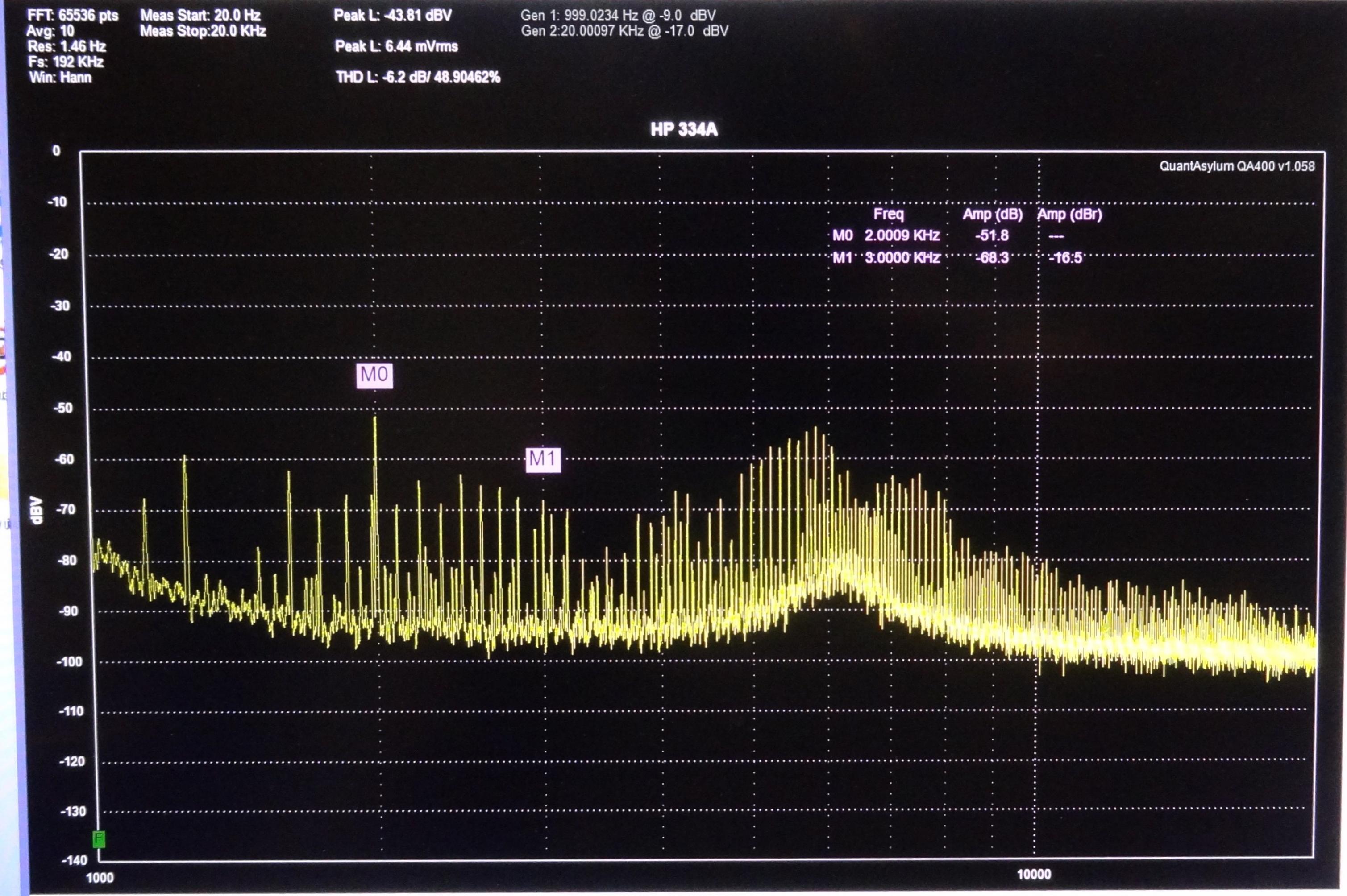

Here are 3 pictures of an HP334A used only for its variable frequency null feature..... (not used for a distortion analyzer). An oscillator (ShibaSoku AG16B) goes into the 334A and the output monitor on the 334A goes to a QA400 ADC/FFT. The 334A range is on its -50dB scale or .3% (fs=1v = 0db). The auto-null is a big plus and keeps everything locked and steady very well. With manual only, there is too much drift off null.
1. measured source shows the QA400 may be the limitation at just a tad below -100 for 2H. In reality it is much lower. Source generator ground floating.

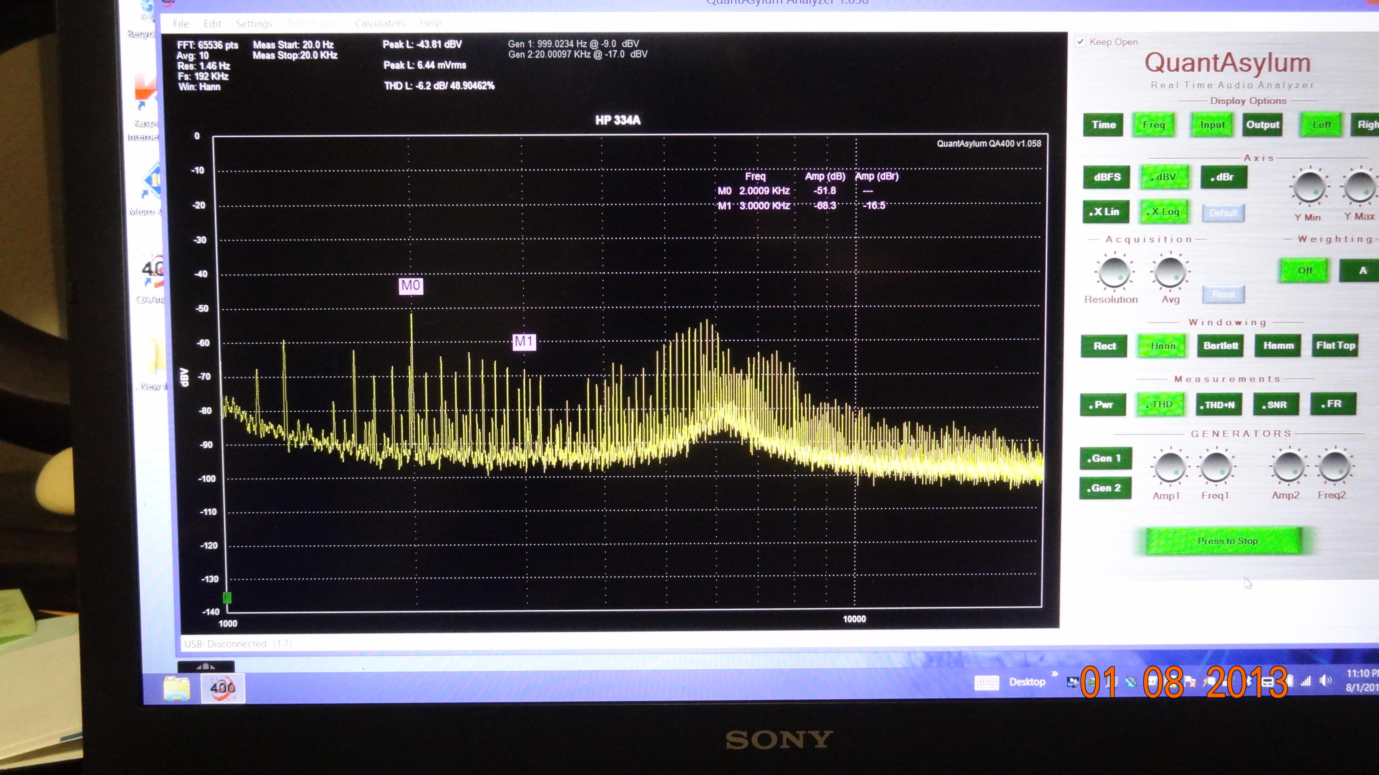

2. Same but with souce generator grounded to chassis.... lots of noise picked up/loops created.

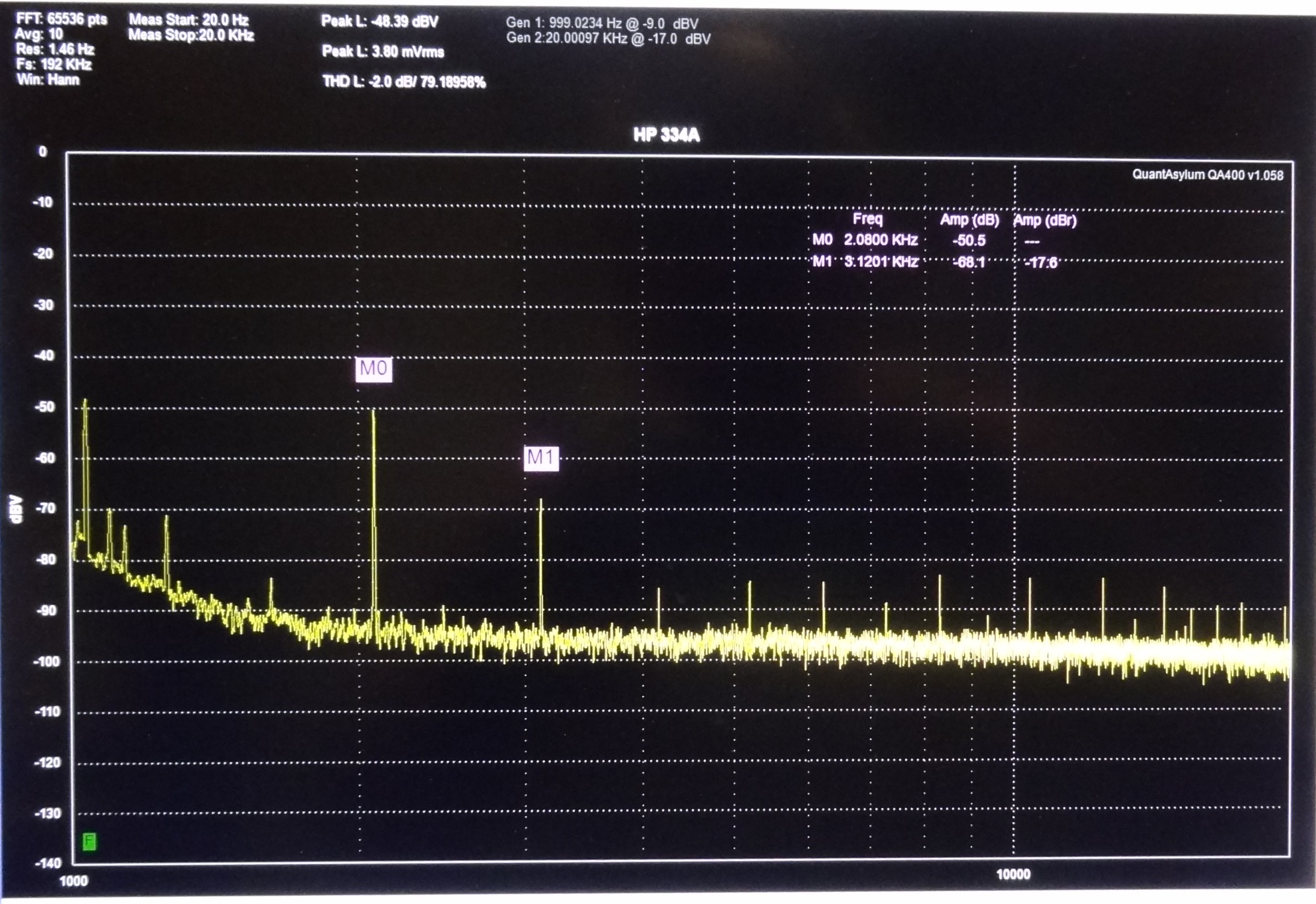

3. 334A still tuned to 1KHz but the source gen freq increased to 1.04Khz. You can see the notch filter atten affect on the 1.04KHz signal.
Seems it has potential to be a useful instrument for nulling DUT signal for ADC/FFT input and other R&D apps.

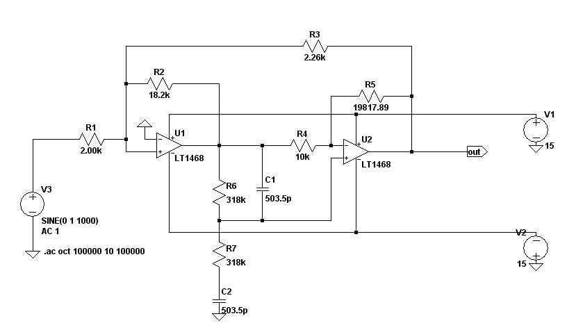

I quickly made an LTspice sim of the Wien-Robinson notch filter; I'd never heard of this filter until today, when a I got a book called "Circuit Design: Know it all," from Newnes Press. Turns out the circuit is very similar to one I designed myself when i was trying to get the HP334 to work better. Sadly, this circuit, like nearly any for a Wien notch filter, still has a diff amp for the post-filter amp, so common-mode issues will be there....
Here are the design steps for this filter (I chose the circuit values to be in the mid-range of impedances, but the tuning Rs (R6, 7) and Cs (C1, 2) are roughly those found in the 334 at 1kHz):
1. Pick f, R, and C for tuning using f=1/2Pi*RC.
2. Pick a filter Q -- I ended up with a Q of 3, which gives a 2nd H. attenuation of about 0.25dB.
3. Pick a throughput gain, A -- I chose unity. The 334 filter system attenuates by a factor of 3, which is not good from a s/n point of view, so unity gain should improve that by about 10dB, but will mess up the output scale on the front. To keep things as they are in the 334, a gain of -10dB (0.3162) could be used, but I haven't looked at what that does to parts values....
4. Calculate alpha = 3Q–1
5. Calculate Beta = A*3Q
6. Define R2
7. Calculate R1 = R2/Beta
8. Calculate R3 = R2/alpha
The 334's auto-tune adjusts R6 and R7 to tune for phase, so that should still work OK in a 334 mod. Varying either R4 or R5 adjusts the amplitude balance, and the stock system also should be usable in a 334 mod, though auto-tune signal polarity will need to be checked.
