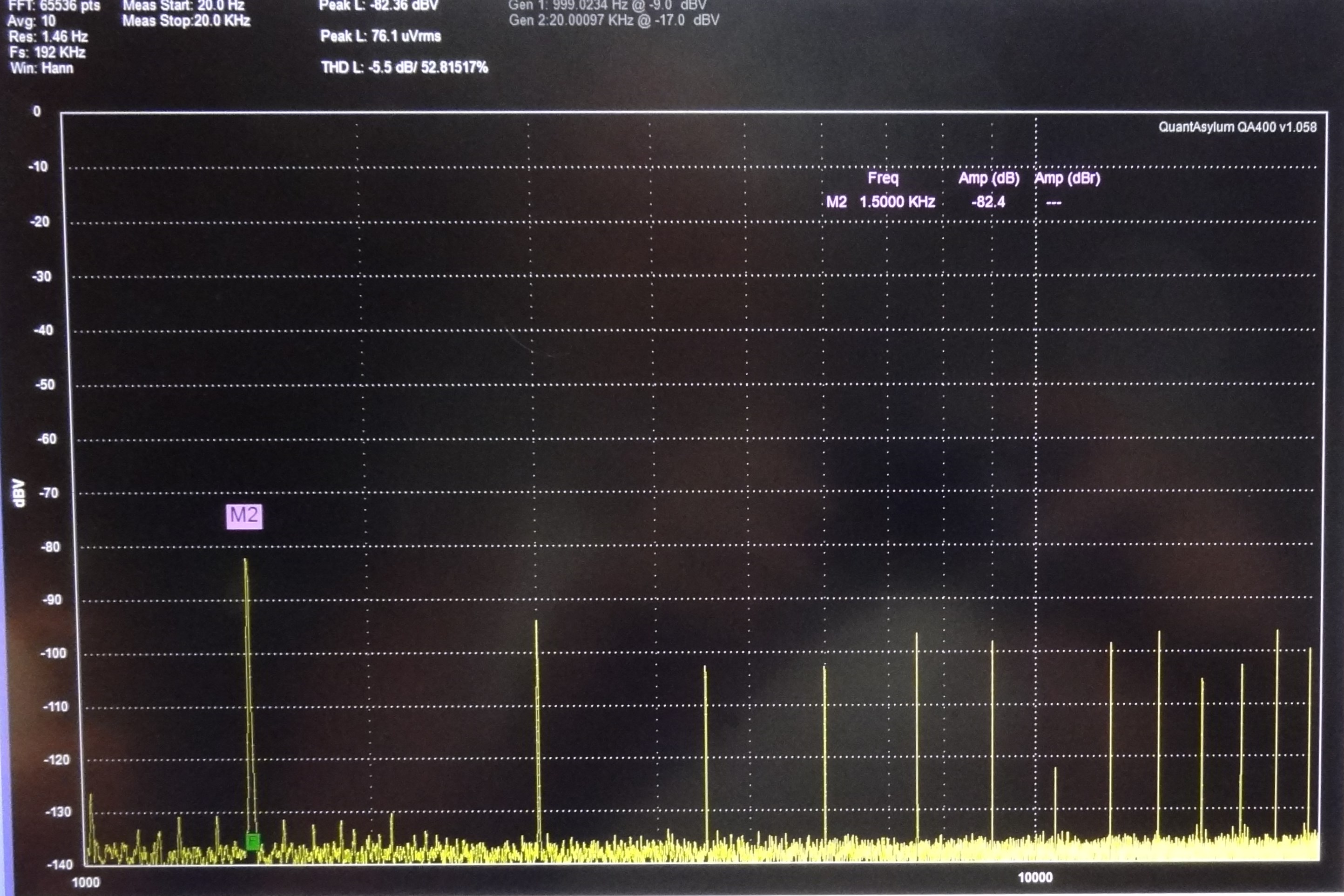

Same as above except input is 1.5KHz (meter out of circuit). Suppressed fund. is seen... that is about right I think.
[How good the null is depends on how good I nulled it and drift before capture the screen. To get best and most stable null.... the 334A needs to be on for hours. The inside temp is warm and stable by that time and a best null an be obtained.]

I have been seeing changes in level of the harmonics at low distorton levels with low cost ADC based test equipment; The 2H and 3H change with input level when the input source isnt changing it harmonics.
there is another uncorrected 2H level change and it depends on the notch filter Q/depth. The notch affecting the level of the 2H. In the case of the 334A, a change in the depth of the notch by 10dB caused a change in the 2H of 4dB.
The auto-null affects the notch depth and thus the 2H as well. That is, the manual null vs auto null produces different notch performance with the 334A (and maybe others) and the result is the detected level of 2H is affected.
These sort of things need to be nailed down.... rather than assume what you see is what the DUT does.

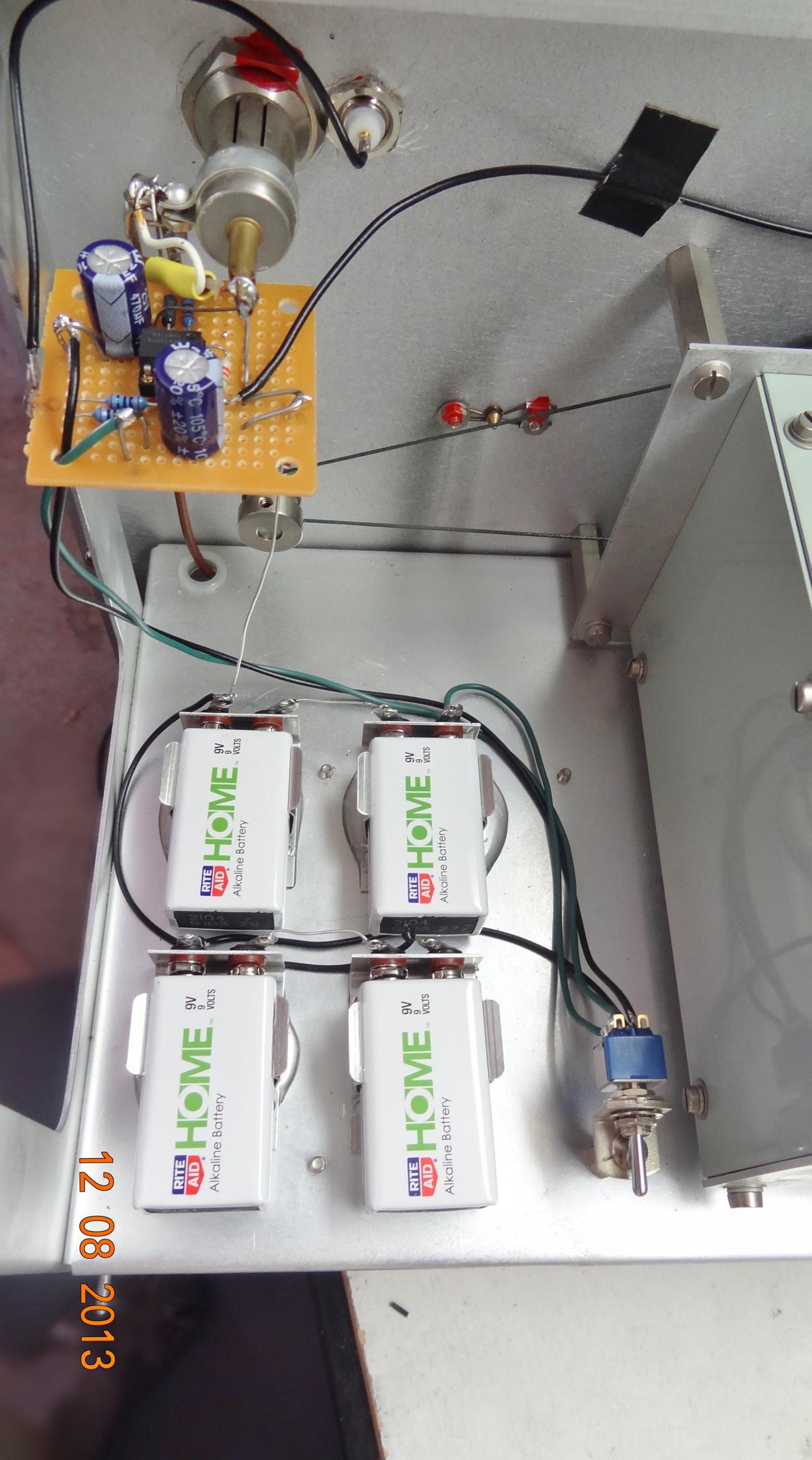

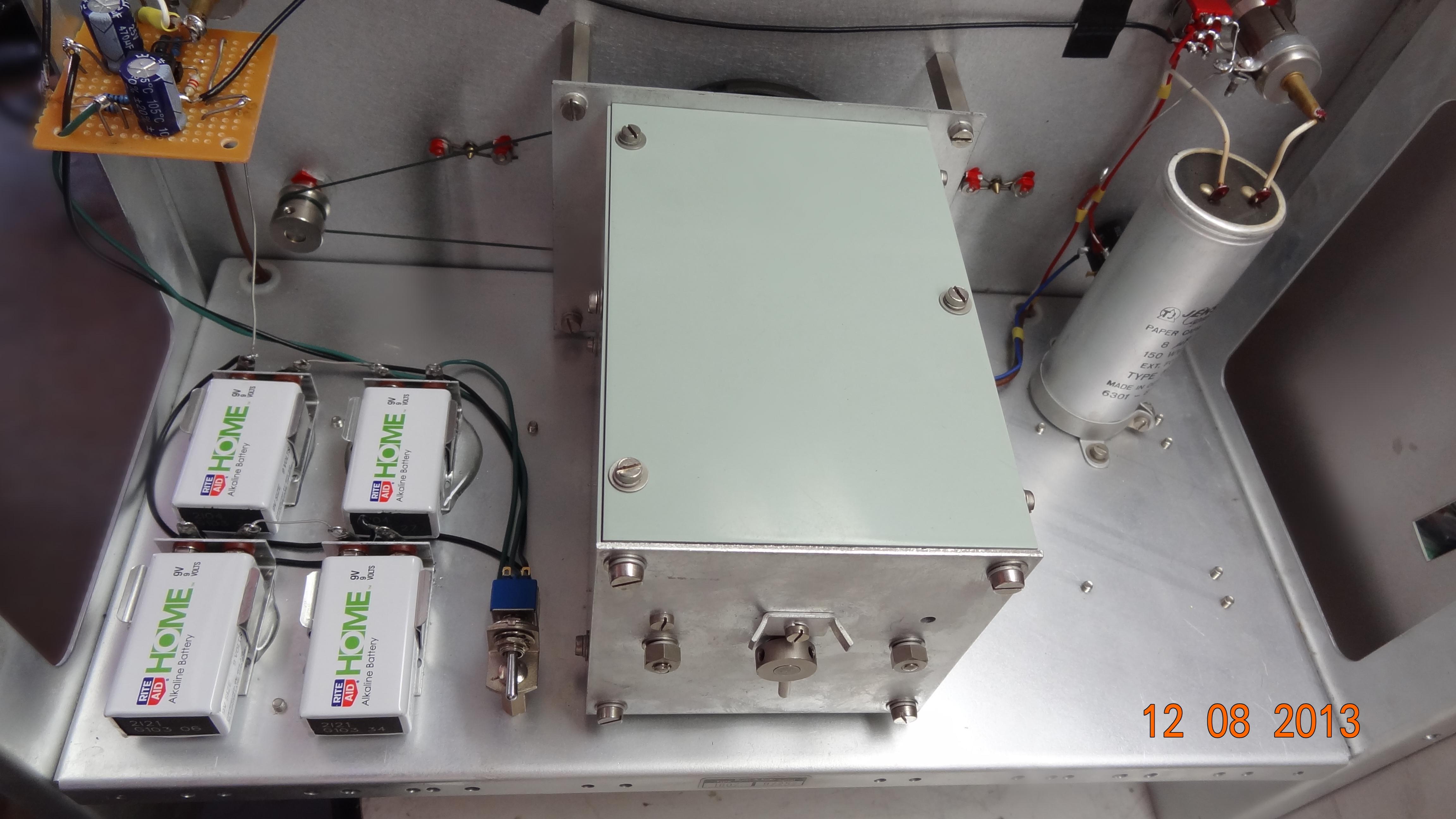

B&K 1607 Activated -
Here is a variable notch filter which is passive (no distortion) and made switchable to active (very tiny distortion) which eliminates the need for correction or fudge-factoring the 2H by increasing Q of the notch filter. The low output Z helps interfacing as well. This is shown in more detail on the short B&K 1607 discussion.
Battery powered and switchable active/passive and a ten turn balance control for even finer tuning.
Now, how do I apply that auto-tune circuit to it?
THX-RNMarsh
[BTW - all 1607's wiring is solid silver and all tuning/null caps are Polystyrene film and variable air cap. Very High Q and low distortion.]
THX-RNMarsh

The least intrusive would be to use a mechanical servo on the tuning cap. But you still need to measure the relative phase. I'm just reading up on phase measurement. It's clunky but wouldn't add to the distortion. You could take the output of a vector voltmeter to drive the servo. This would work very well if you don't mind a lot of outboard gear. If you want a neat little package then never mind.
Lot's of vector voltmeters on Ebay for cheep.
I'm not sure you really need the "afc" to get value from the filter. The oscllator will drift and the filter will drift but you are not using it as a classic distortion analyzer to remove the fundamental, just to reduce it 20-40 dB to extend the useful range of an FFT.
It practice a few manually tuned notch filter modules matched to a few of Victor's oscillators could be all that is necessary to get SOTA measurements from a QA400. The Twin T plus feedback and 20 dB of gain should be ideal for the task. 40 dB of post filter gain and an HP333 or HP334 may be able to see that deep? (I think we went down this road a year ago?) if we limit the actual notch depth to 40 dB w/ 40 dB of gain it become usable with almost any distortion analyzer.
