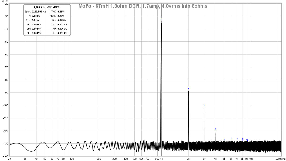

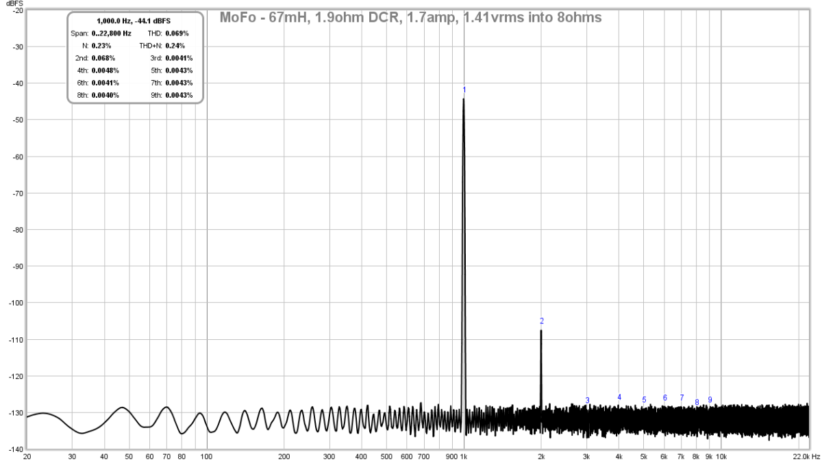

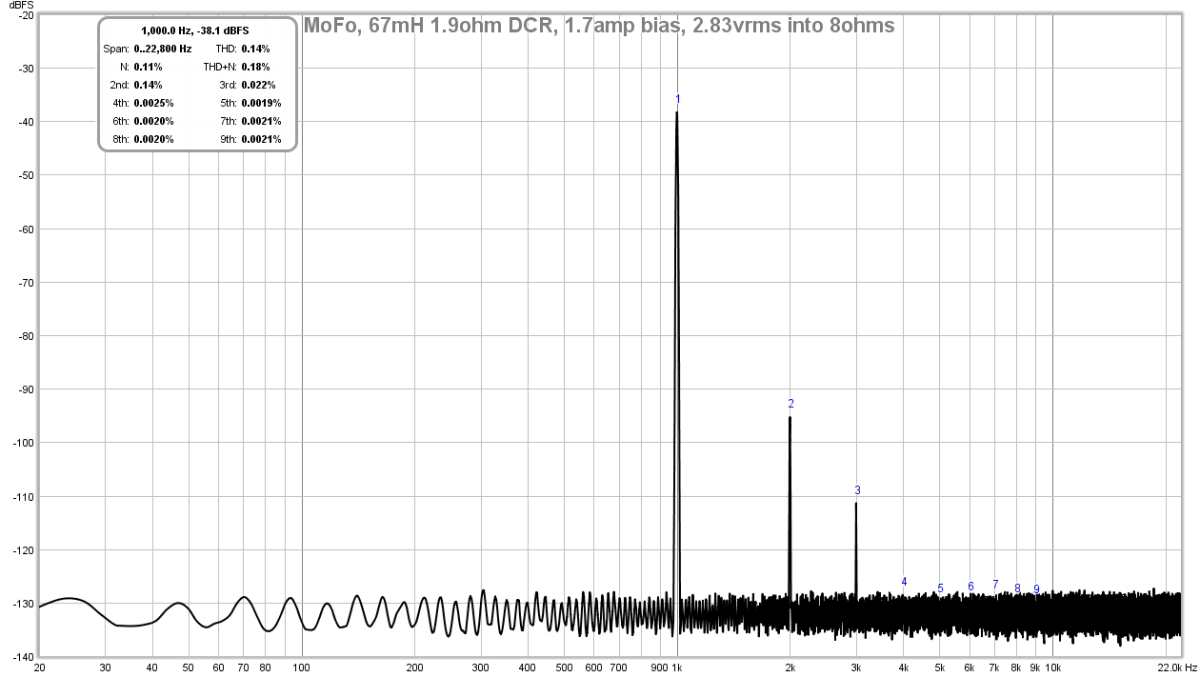

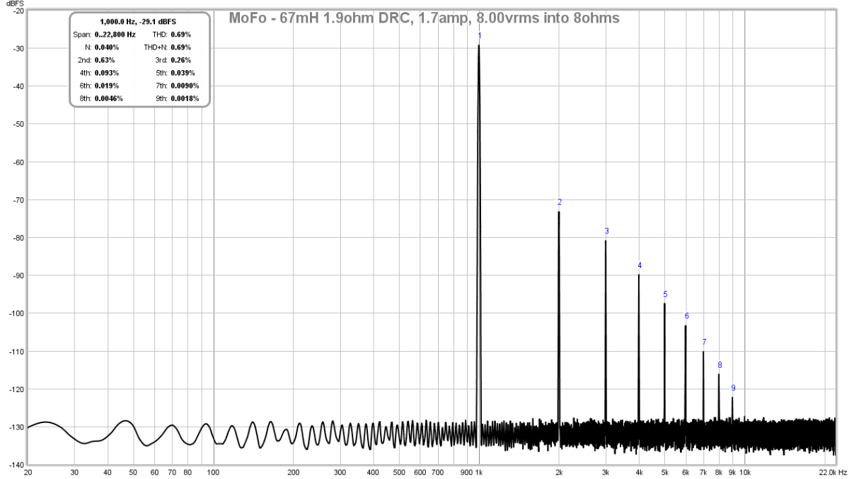

Tests with 67mH Microwave Inductor
I have been hanging onto a dead microwave oven for 6 years, did not know what was inside that could be useful, but now the time has come. I opened it up to find a beefy inductor which I measured with a DATS2 LCR meter as 67mH and 1.9ohms DCR. I promptly swapped out the two 25w 8ohm parallel resistors for the big fat choke. I set the bias for 1.7amps. I am using a 5amp 24v smps fed through a Juma Easy Peasy cap multiplier (IRFP240) for 19v to the amp.
I was driving this with the Aksa Lender Preamp and source was a Focusrite Solo 2G USB audio interface.
Here are the distortion measurements for 8ohm load.
1.41vrms (0.069% THD):
2.83vrms (0.14% THD):
4.00vrms (0.21% THD):
8.00vrms (0.69% THD):

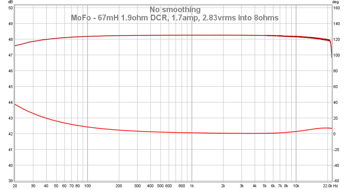

Here is the frequency sweep for 2.83vrms into 8ohms (1dB vertical scale - very flat, maybe -0.5dB at 20Hz):

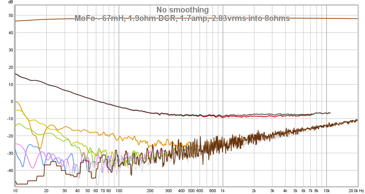

Here are the distortion components vs frequency for 2.83vrms into 8ohms:
