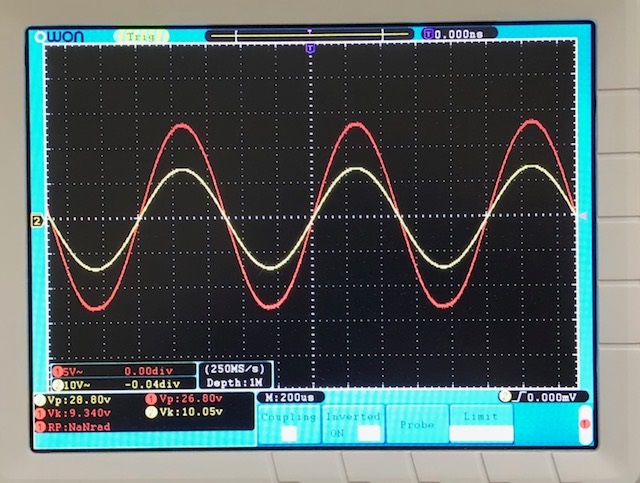

Maximum output un-clipped is 26.8vpp into 8ohms or 11Wrms output (yellow is preamp input, red is MoFo output):

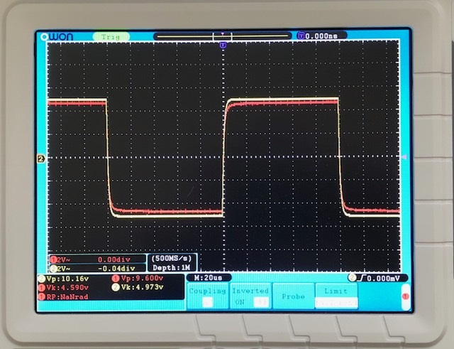

9.6vpp 1kHz square wave (output is red):
With all the above data, and listening tests, the MoFo is a fine Class A amp capable of nice performance. Ability to drive 11Wrms on 19v Vcc is impressive actually. Gain of my MoFo appears to be actually -0.63dB not 0dB.
