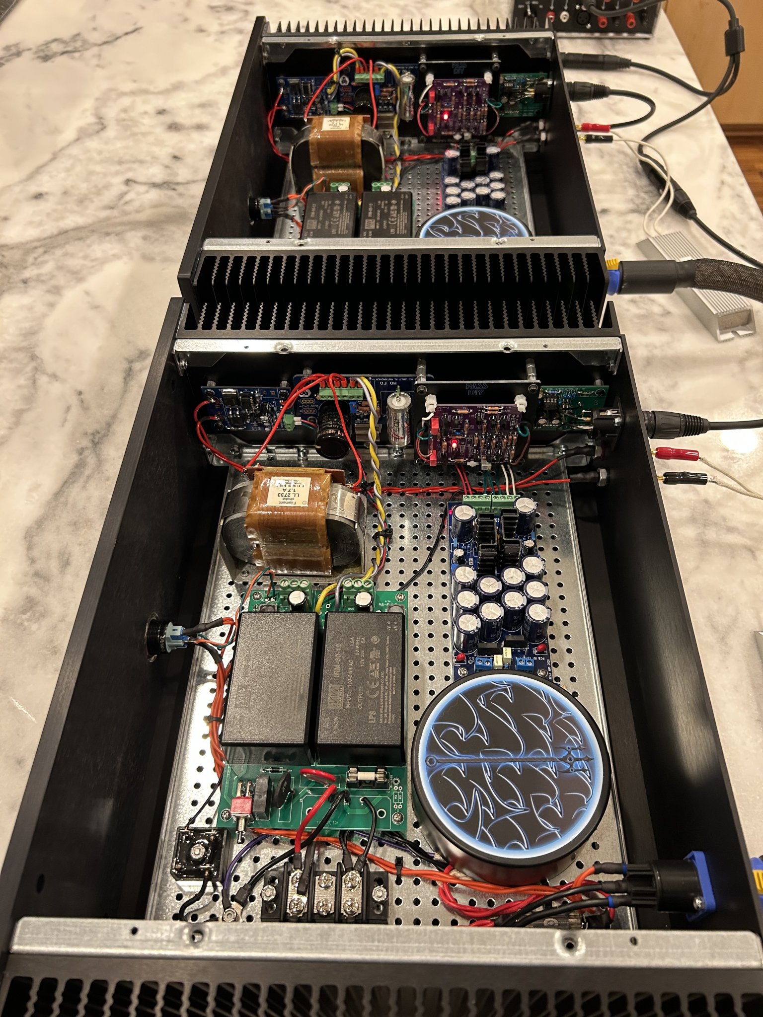

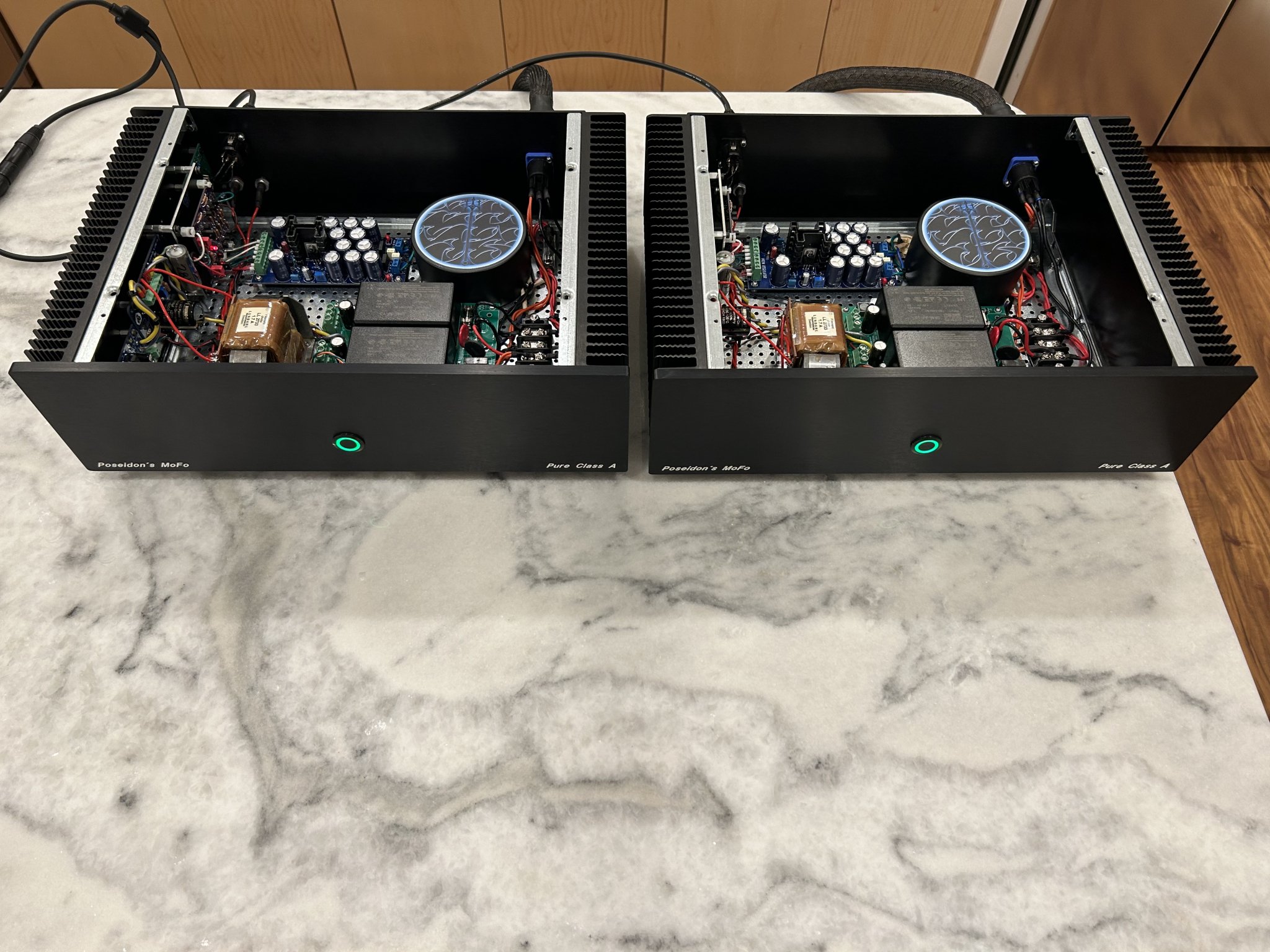

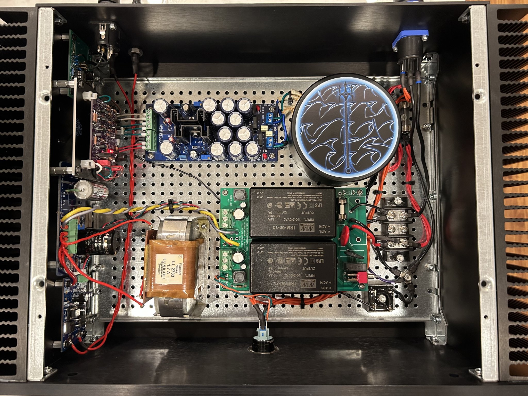

Ingredients:
- Neurochrome THAT RX::Mono (discontinued, but Table 14 from this link helps in understanding the circuit)

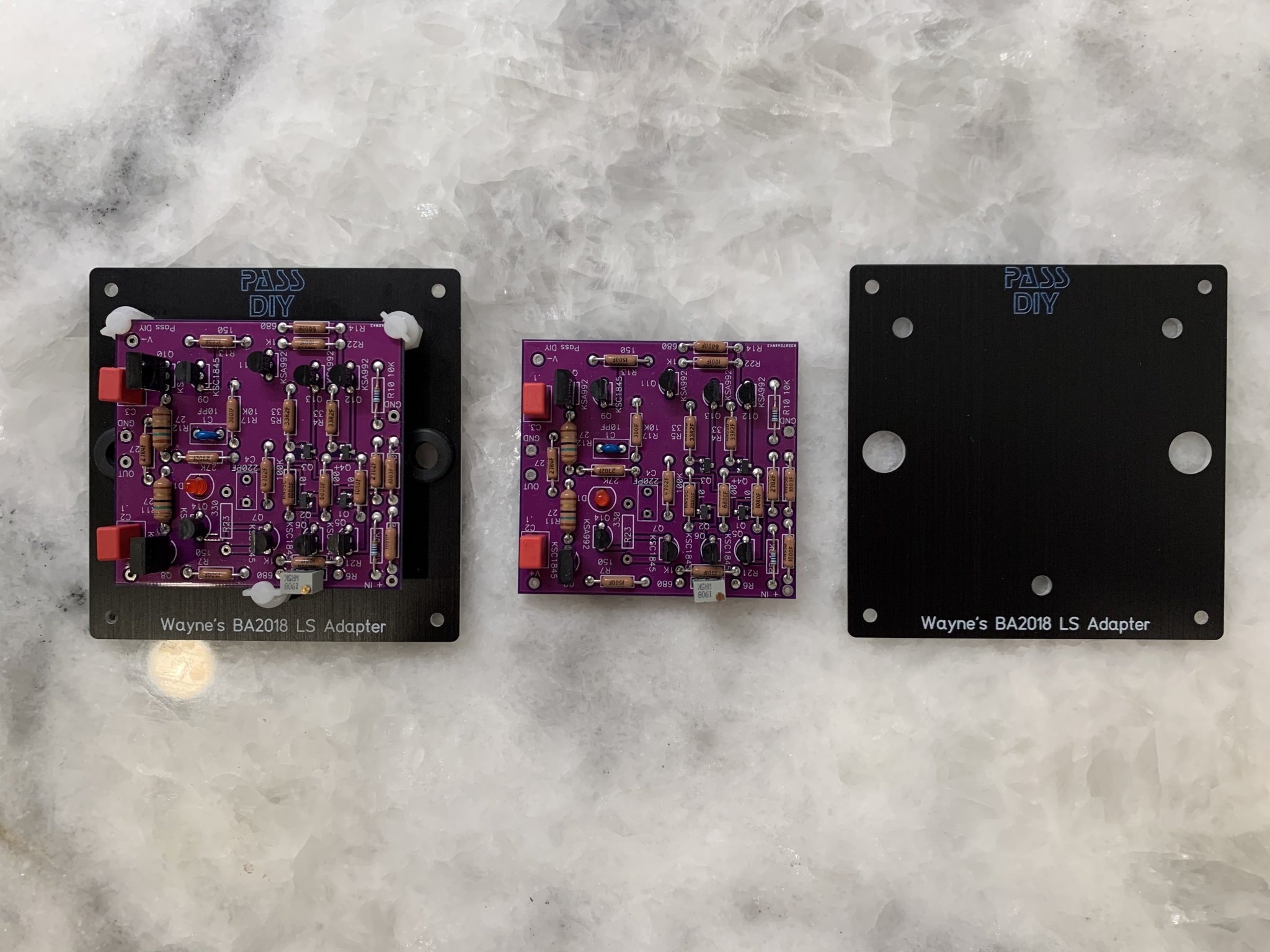

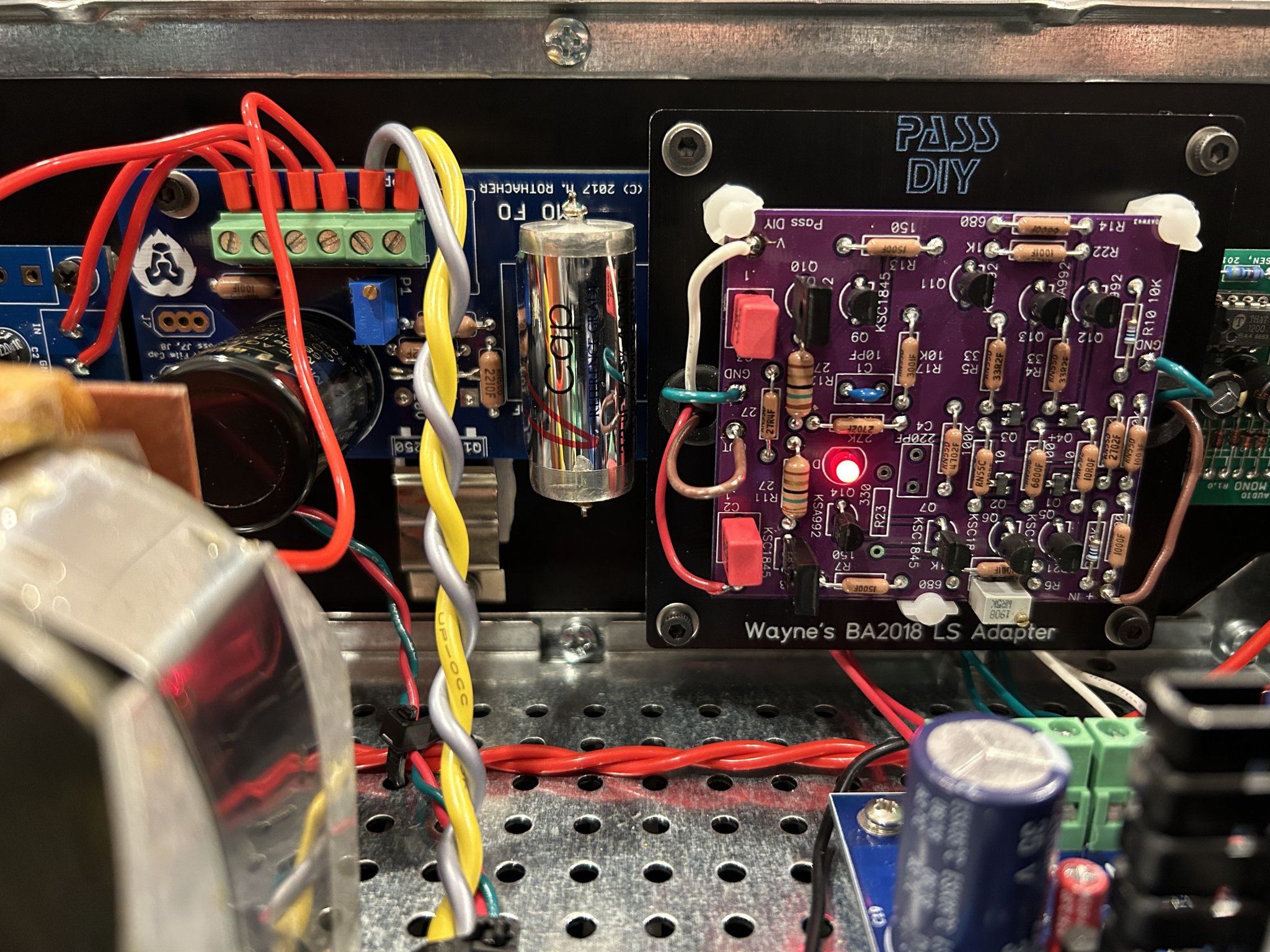

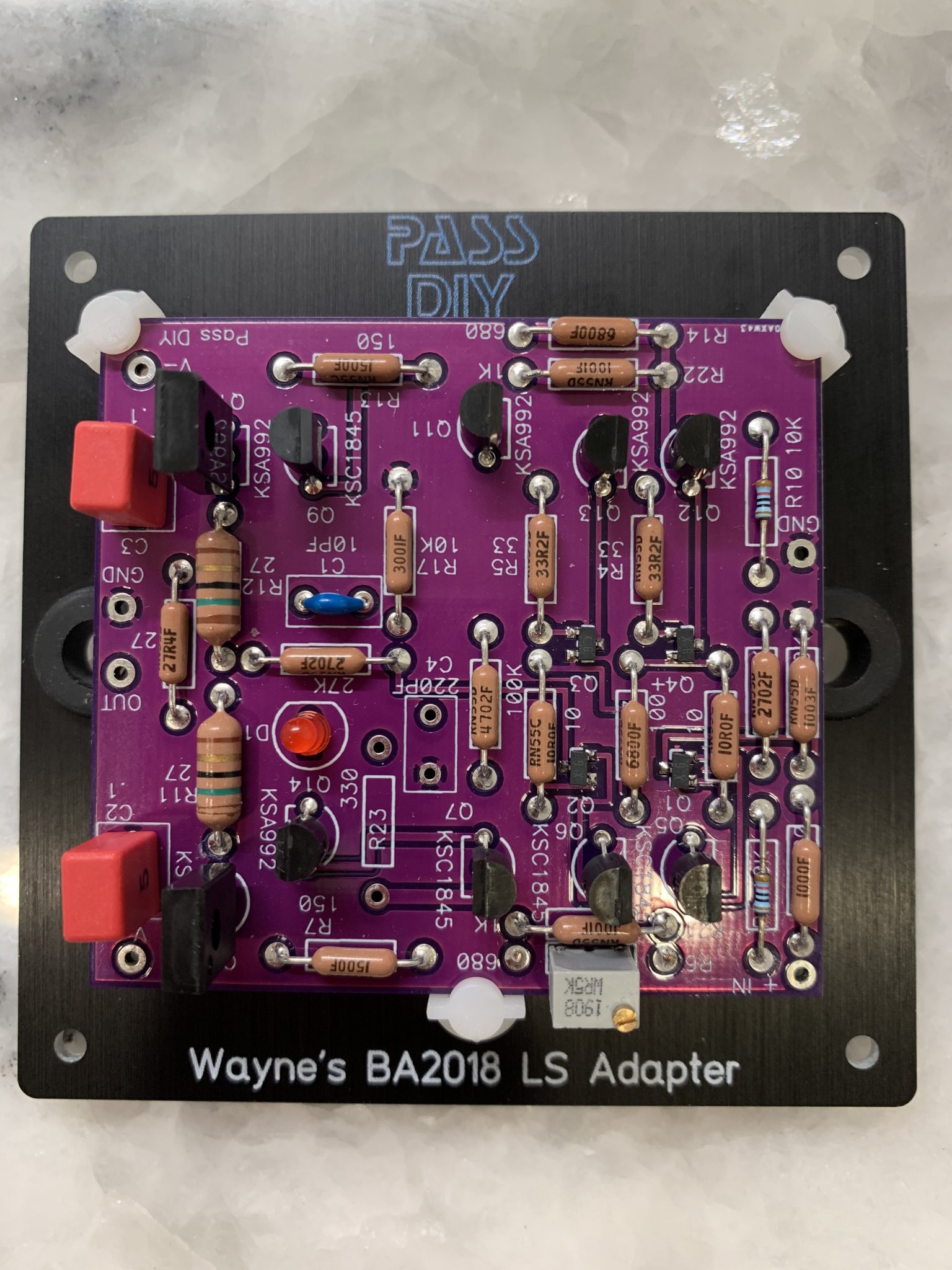

- Wayne Colburn’s excellent linestage/headamp design he revealed at BA2018 and that 6L6 gifted me a while back. Yes, these are the pink boards. They, as you know do not have any mounting holes so lateral thinking had to sink in (thanks Wayne!!). Along came Adafruit’s edge mounting kit and then some prototype sessions on Front Panel Express. I’ve set R17 to 3K (instead of 10K), as such overall gain is ~ 20dB.
- Michael Rothacher’s MOFO using member Prasi’s board layout.
- Lundahl LL2733 dual C-core choke with the chokes wired in parallel such that the DCR is ~ 0.9 ohms.
- Neurochrome Guardian-86 (this is the thru hole version which I soldered years ago, but now discontinued). It is somewhat superfluous in the circuit given that the MOFO is cap coupled on the output. That being said, the 5 second delay at turn on, is a nice feature. And I’m all about safety!
- Neurochrome SMPS-86 (discontinued). This is an excellent switcher supply which includes a soft start and surge protection on the input and a Pi Filter on the output such that the output ripple is << 2.5mV RMS. In my implementation I used two 12V Meanwell Modules and lifted the chassis ground connection, as such it became a +24V supply with 120W capacity for each monoblock. It operates at 50% capacity since I have the MOFO biased at 2.5A. The Meanwell modules in operation are barely warm, about 35 degrees C.
- Mark Johnson’s excellent implementation of a regulated bipolar supply, the VRDN. I have it set at +/- 18V since the THAT RX::Mono is limited to +/- 18V for it’s supply requirements.
Heatsink when fully warmed up is ~ 50 degrees C.

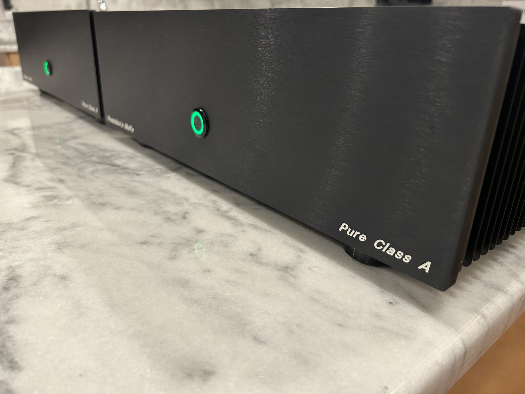

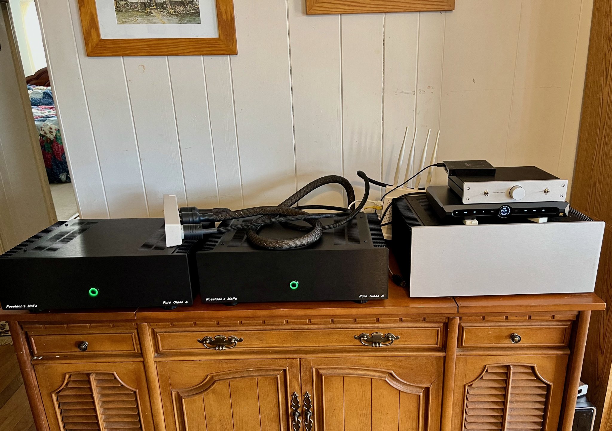

Beautiful MoFo Mono's Anand! Top notch craftsmanship
With the BA2018 frontend, no worries about using a preamp with cojones.
Had a Great visit with @poseidonsvoice and got to see the Mofo in person. @poseidonsvoice bailed me out when I screwed up my F6 and got it working and biased. It is shown in the picture and the rest of the system is a Tekton Mini Lore in a small room. The Mofo was amazing. Not sure of the adjective but more presence and clarity. than my F6's. Plus the Mofos are gorgeous really quality work

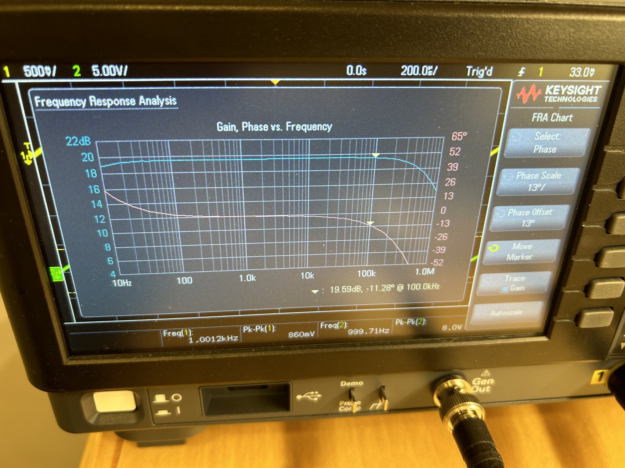

Henry,
I’m not Vunce, but with Wayne’s BA2018 linestage, gain is set by the ratio of feedback resistors, R16 and R17.
For example, R16 is 27K ohms. I would leave that alone, and not change it. R17 you can change and it is 10K ohms stock.
As such, the gain (Av) = R16/R17 +1 = 3.7 times.
3.7X when used in the dB gain equation (gain = 20* log [Vf/Vi] ) is
20* log 3.7 = 11dB.
In my implementation, I changed R17 to 3K ohms, so Av=10 which is 20dB gain.
If you want 26dB gain, then change R17 to 1.5K ohms and keep R16 at 27K ohms.
Hope this helps.

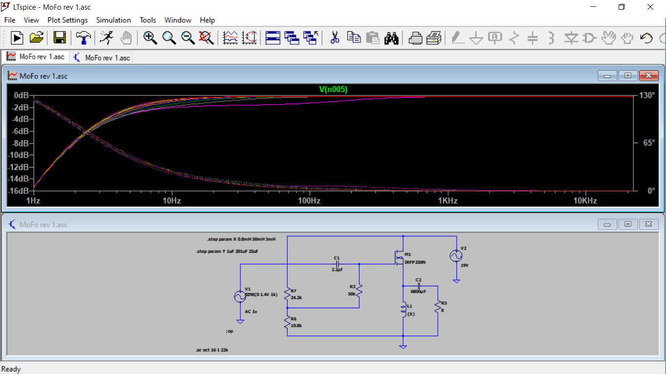

Yes, schoolboy error!Load R5 should be 8 Ohms?
I've worked out how to do a DC op point and set the divider for c1.7A across the choke. I think. It wasn't too far from the mid point of the divider.The rest is "practical shortcuts".
What current is the MOSFET running at? 1mA or 100A is unrealistic. That's the first place I would throw a (virtual)meter.
SortedR1 is to avoid plug-in pops, skip it for preliminary eval.
R7 R4 can be combined (you are correct that you do not need filtering or trimmers here).
R2 can be omitted because SPICE does not know about wiring resonances (unless you laboriously set it up).
I gave the choke a series resistance of 0.8R to represent the DCR I measured.The graph going down to -55mdB is meaningless: -0.055dB is real-real tiny.
I do not know why "stepped choke" seems to flatten out at -1.8dB. I don't see any step-network? I may be confused by monster cap driving 1k resistor. Or does your choke have internal resistance (if so: a proper amount)?
Investigating a little more, running the sim from 1Hz rather than 10Hz gave this plot, which explains the previous sim, but doesn't really make sense to me.
So I'm still suspecting my Spice skills need work. I've uploaded the Spice .asc in case anyone's interested enough to have a play. And can perhaps tell me what I'm doing wrong.

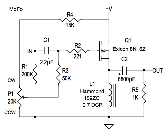

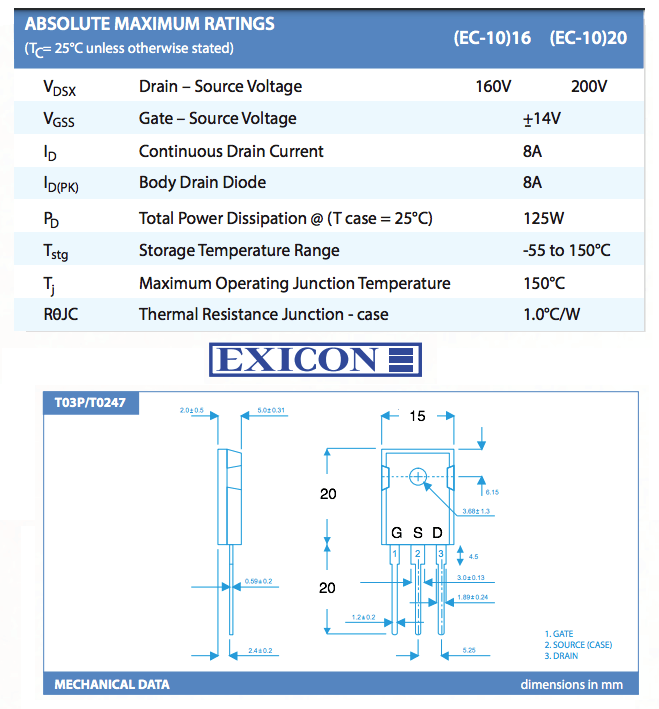

They can be used with no changes at all. As ECX10N16 has lower transconductance than IRF250, amplifier output impedance will be higher, probably ≥ 0.5 Ω.
However, that laterals have 5 times less input capacitance, so it will be easy to drive it with tube preamplifier.
Thanks for your reply! The schematic I have is attached. Is this OK?
Andy,
You should be fine. Just remember that with Lateral Mosfets, pin 1 is the Gate, pin 2 is the Source and pin 3 is the Drain. Vertical Mosfets like the IRF250 have different pin designations (Pin 1 = Gate, Pin 2 = Drain, Pin 3= Source) and if your pcb was designed for Vertical Mosfets, you'll have to do some cross wiring.
Please let us know of your results!
I've thought about using N channel SemiSouth JFETS myself, but too many projects and too little time!!
Best,
Anand.

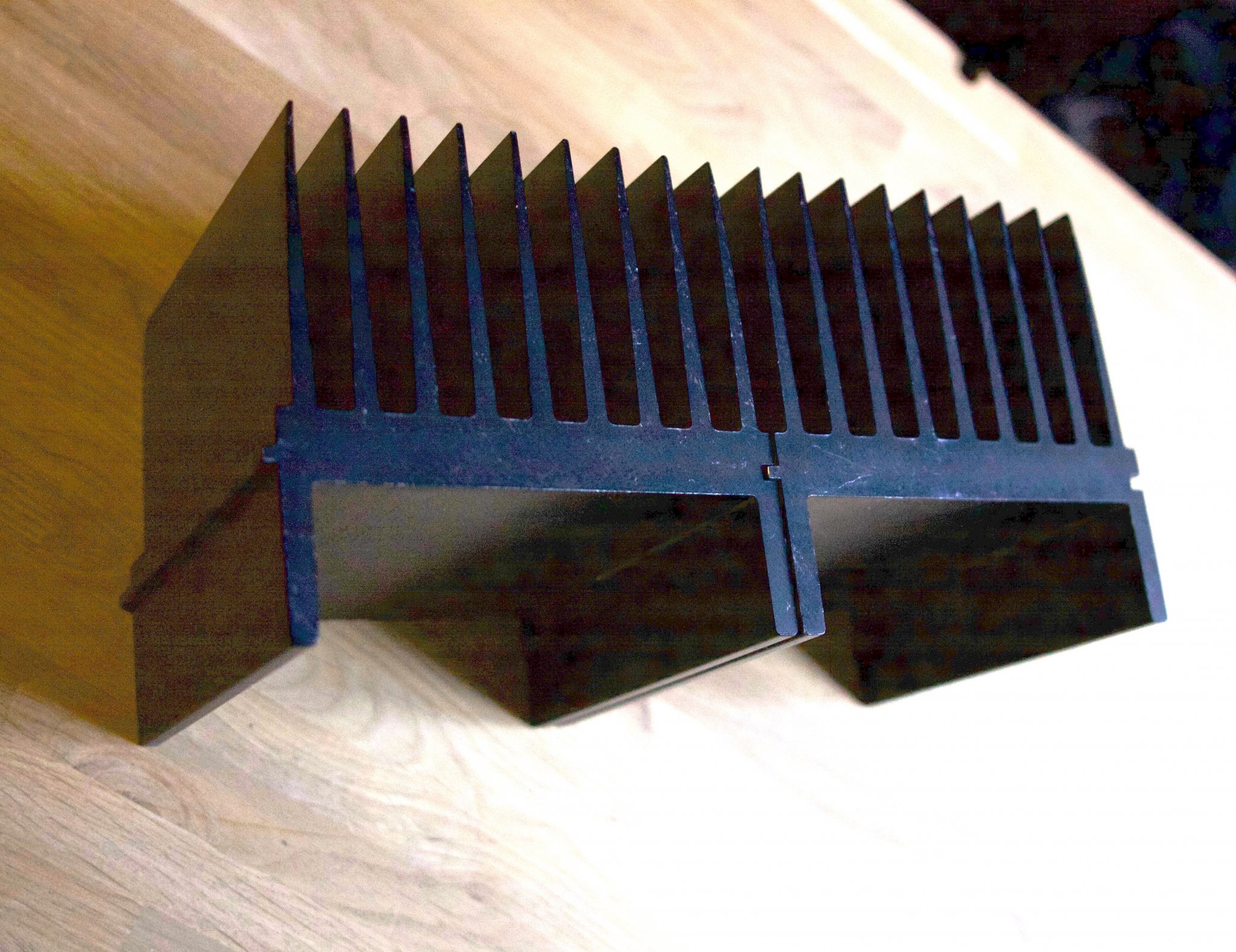

Here's my proposed heatsinks. I have 4 of these square ones. Each is 4.5" x 4.5" x 5" or 11x11x12.5cm high. Weight is 1.3kg.
I could use one for each Exicicon 8N16, total two. Or I could bolt a couple together, one pair on each side, to make a square enclosure with all four.
If I bolt two of these together, can I mount the Mosfet on the middle part sticking out, where the two pieces will be bolted together?
One MOSFET per heatsink would be best, mounted 1/3 up from the bottom.
