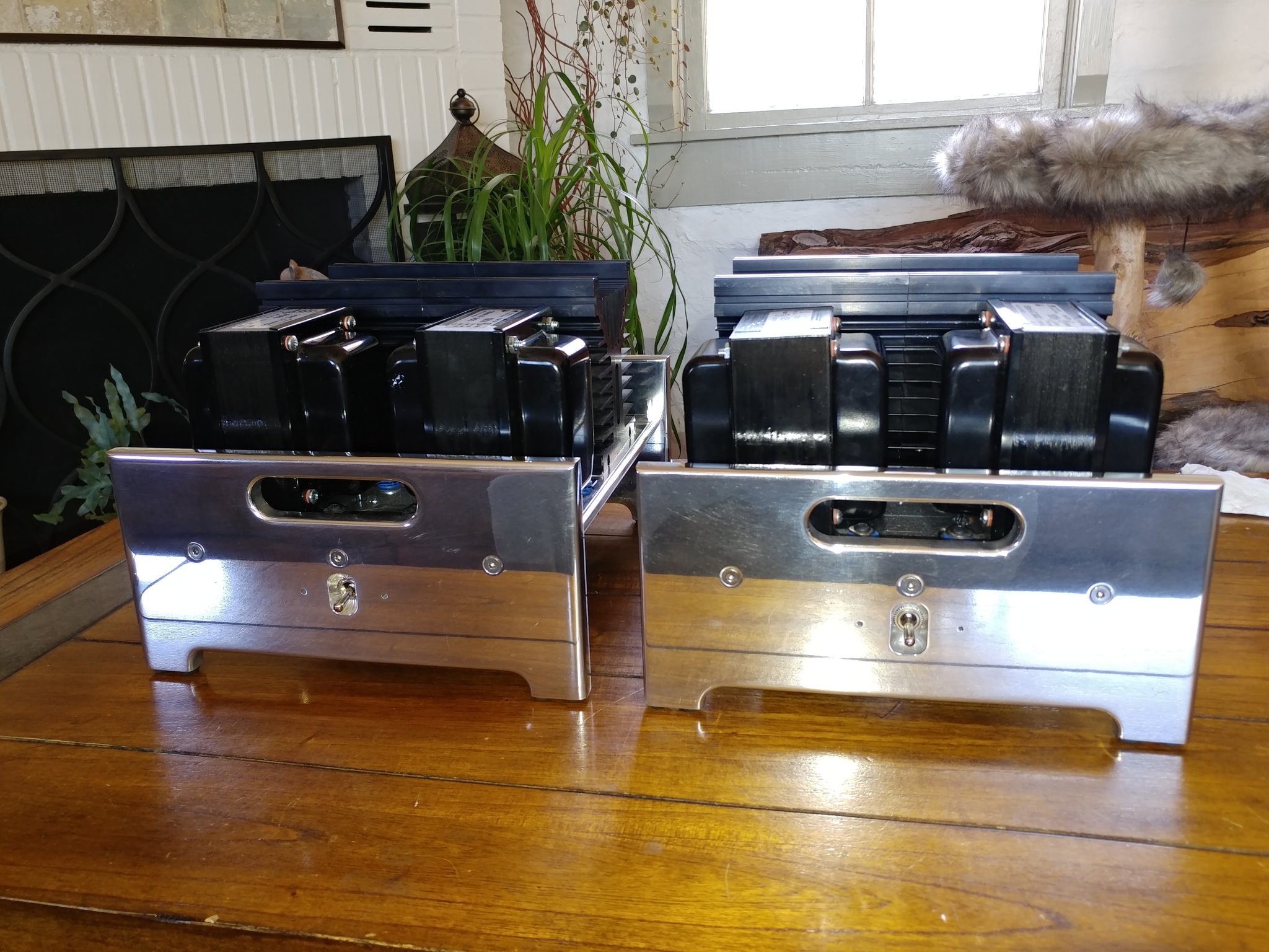

In my opinion, more inductance, more better, as long as it is compatible with the current demands imposed on the choke. You want the choke to be in a comfortable place and the datasheet tells you at what current it is saturating. I built the Big MoFo and wanted a choke that could utilize the current requirements of that design. I also use the amplifier with near full range speakers.
If your design requirements don’t require a ton of bass (i.e. less than 50Hz), I could see the use of a smaller choke and less inductance (in example, an amplifier for just midrange/tweeters In an active setup).
Bear in mind, that more bias current will also decrease overall THD so a bigger choke is nice to have.
