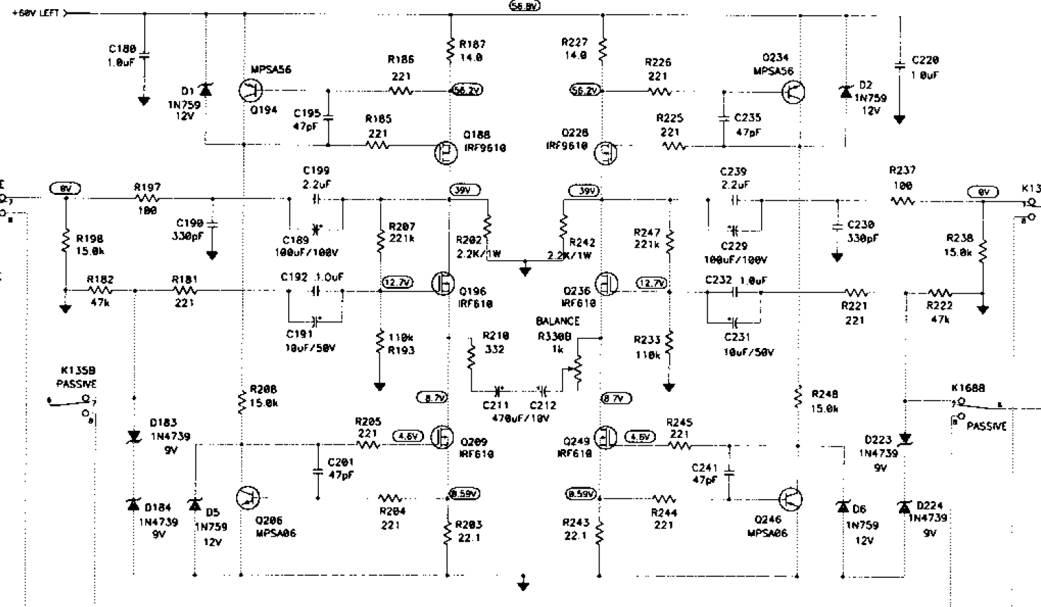

48.3 and 48.2 mH for the closely matched ones, 23mH for the 'special' one. I did not consider the fourth since it is not only bent up, but it arrived as a different, slightly smaller model (601 series). Seller had a bad day, I guess. All were measured with a Sencore LC-77 Z-meter.
Agree on the value proposition with the smaller Hammond chokes vs. MOTs, I'm comparing cost to the $80-$85 3-amp Hammonds since I will be using higher currents into a 4 ohm load.
For a net difference of $200 (four chokes total), I'm willing to remove the MOT secondaries if I'm not comfortable insulating them for the high voltage AC that will be generated.

Maybe it's not worth much, but physically, the 10lb MOTs are 4x the size of the 159 Hammonds and have thicker wire. I think they are capable of much higher current before saturating if compared to the 2.5lb Hammond. Typically, they are used in 1200W microwave ovens - that's about 10amps AC. Not sure what DC rating is but it seems to be holding up pretty well at nearly 2amps.

4 ohm output, inductance
The most important reason to go for the MOT, seems to be the high current needed for 4 ohm. Ok. Agree on that. 🙂
They also look cool, I know. 😎
The inductance of these MOT things is not that high (no gap) btw.
The 50mH inductance seems to be the minimum to get a decent power bandwidth. Around 27 Hz the inductor takes about 50% of the current. The other 50% is for the speaker. But this is only true for a 8 ohm speaker. For a 4 ohm speaker, more current is available to the speaker. Or: the inductance can be lowered to 25mH to get the same power bandwidth.
For a 4 ohm speaker, you can get away with a lower inductance. That opens possibilities for other chokes. The 159ZE has 28mH at 3A. Cheap one. 😀
Same goes for a balanced version. Each MoFo sees half the impedance (if one side goes up, the other goes down and the middle of the speaker stays constant: you can think of it as 2 times a 4 ohm speaker in series with the centre constant). So also with a balanced MoFo you can get away with smaller inductors. Down to 12mH for 4 ohm version (159ZG).
