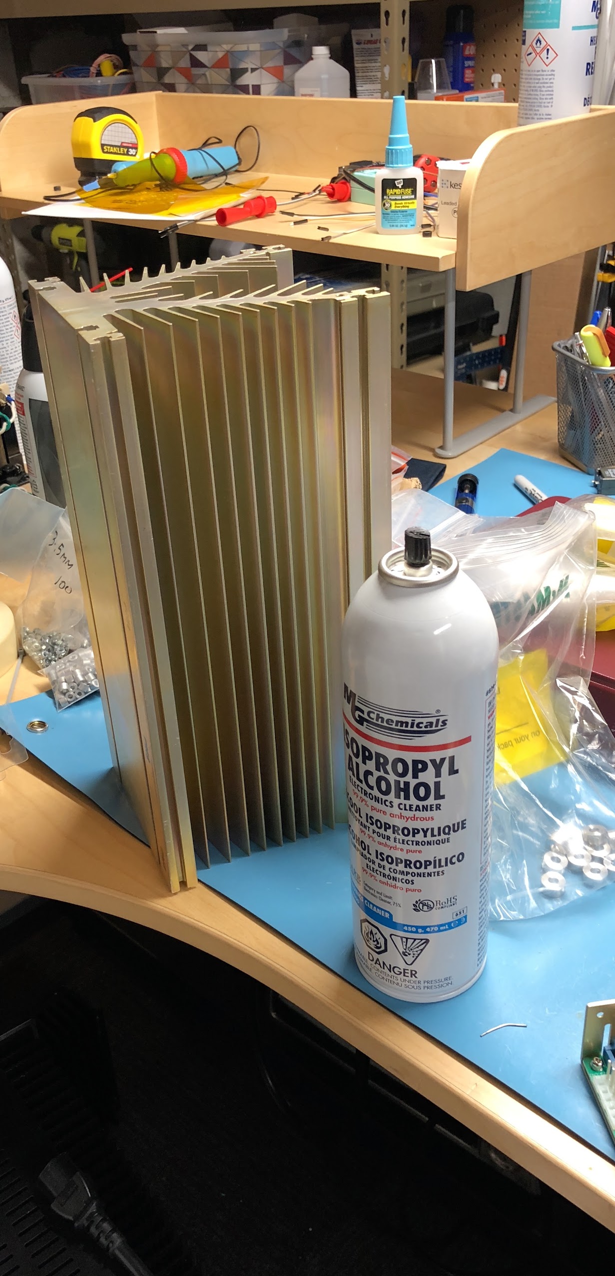

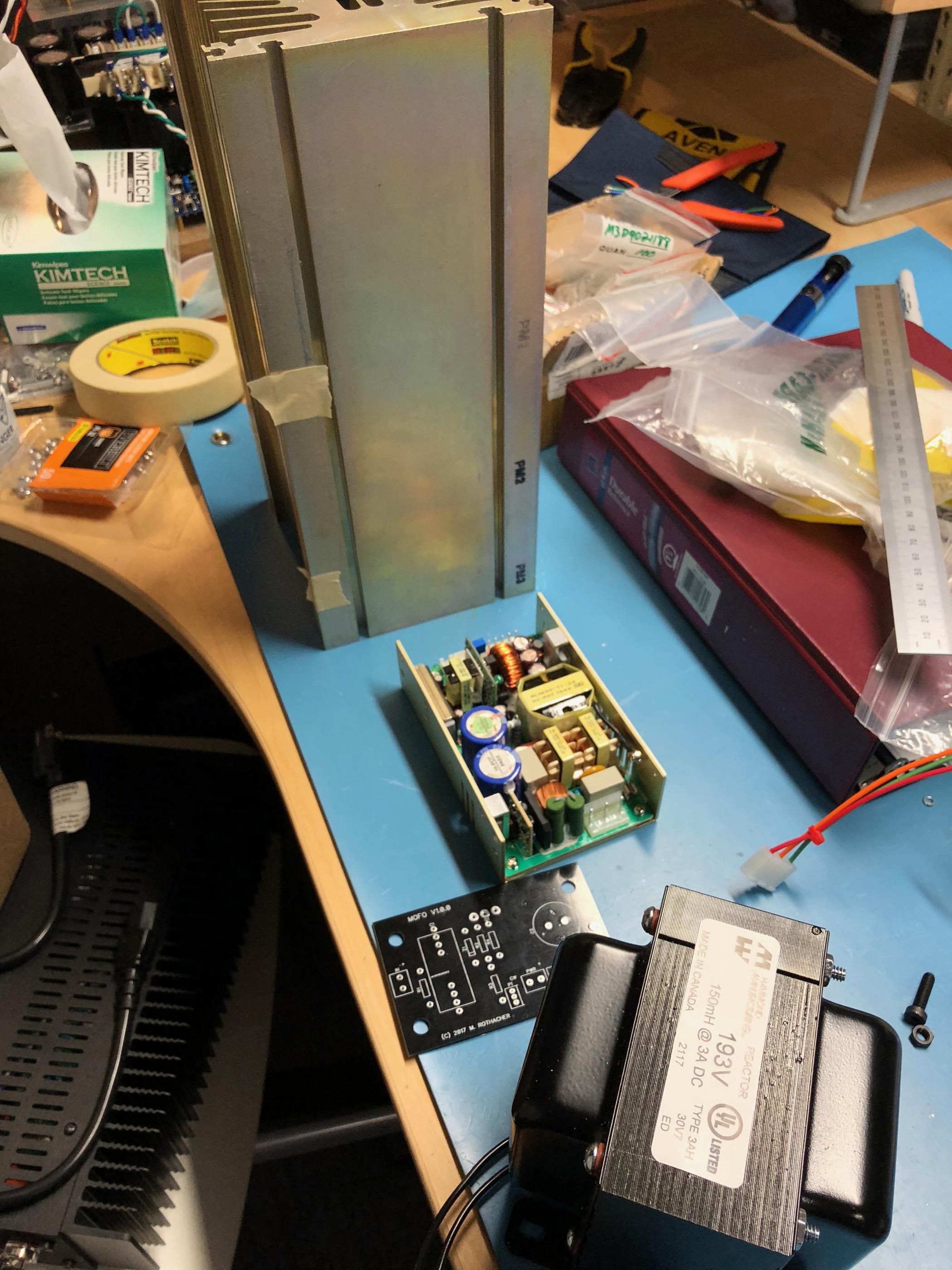

I've been slowly gathering the parts for my Big MoFo build. 24v 250W (135W without forced air) SMPS from eBay, power module heatsink from eBay (I plan on getting it cut into 2 for monoblocks), and the Hammond 193V. I had a lot of other projects planned, but this one was just too simple (???) and fun to not get started on

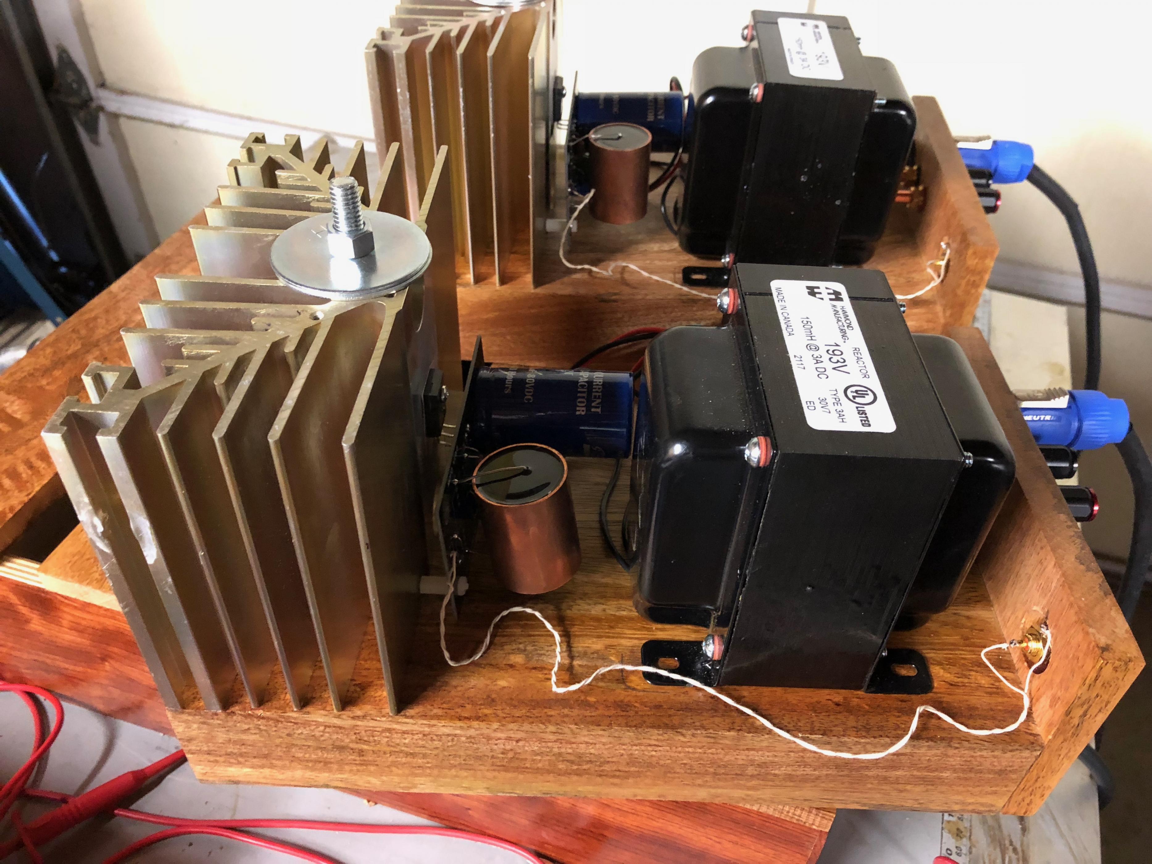

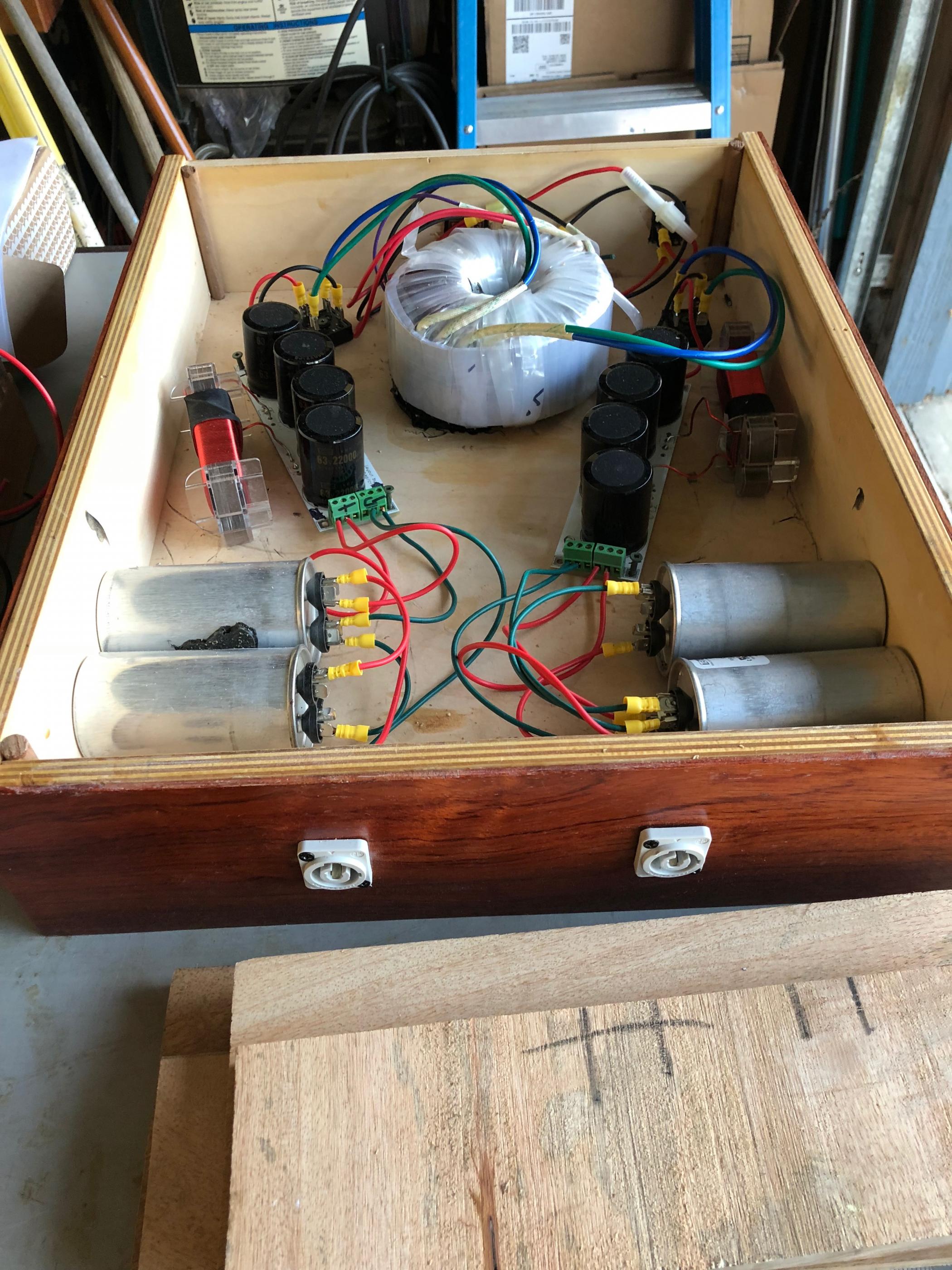

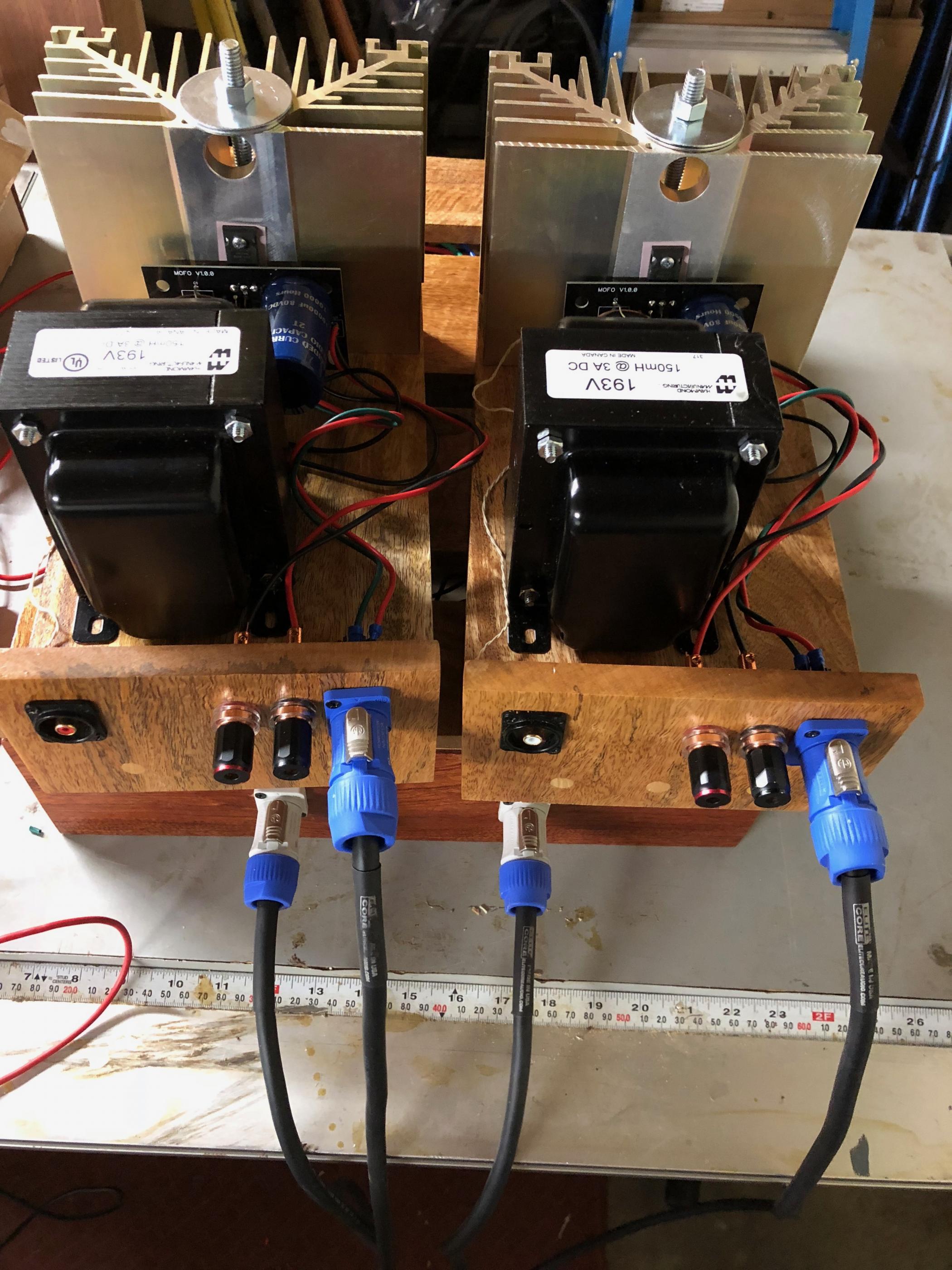

![IMG_6423.jpg IMG_6423.jpg](https://www.diyaudio.com/community/data/attachments/596/596640-a37fe0b135ad2d81ceb8514fa359b7d2.jpg)
The MoFo is up and running
Used 15VAC transformer (500VA) to do CLC PSU
Bias is 2.5A (voltage with this is 18V)
Driving with XP-10
Very nice sound with great soundstage. Primarily female and male vocalists at this point. Will try some Led Zeppelin later
Thank you, thank you and happy holidays

Red and black wires to the output terminals are not consistent between the two mono blocks ??
