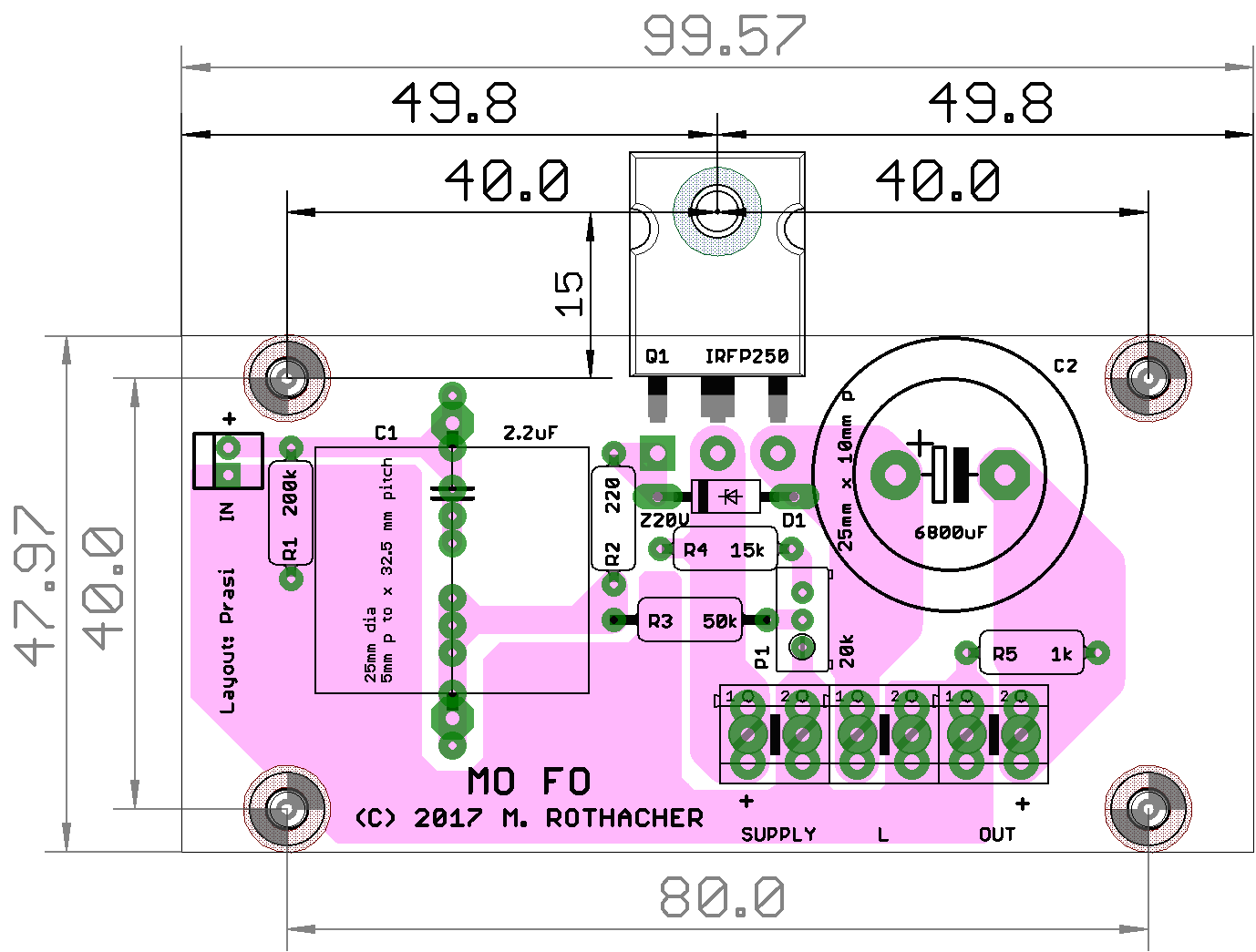

Continuing, here is the revised layout that follows UMS guidelines (80 mm x 40mm mounting holes and Mosfet mounting at 15mm away from mounting hole.) Also included cap pitch options for C1.
regards
Prasi

if allowed, rotate 180° C1 and place IN connector on the bottom near +V.
My 2 cent.
JP
Hi JP,
Could be explored, yes. However, I wanted to separate the signal from high current traces. From the pdf of Mr. Rothacher, I guessed that he wanted to keep them separate too.. BTW an amazing write-up, makes an interesting evening reading and re-reading.
regards
Prasi

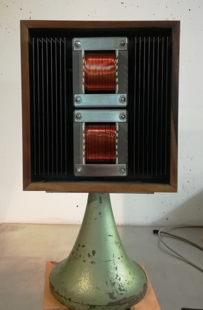

Dear Michael
Many thanks for the MoFo article. I particularly appreciated the calculations (as with LuminAria)
Since heatsinks and chokes for class A power amps are the more expensive parts why not put several amps in one and make them switchable?
The picture below shows "3R one" (repair-reuse-recycle) that features a
choke loaded De-Lite De-Lux with IXTH6N50D2 and
a MoFo with IRLP3034
