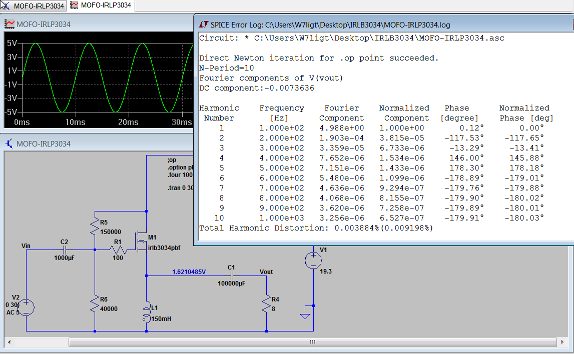

I woke early this morning so I played a little with the MoFo amp in LTSpice.
In simulation the IRFP7430 gave much less THD and a much nicer distortion spectrum with less higher order harmonics.
With 19,3 volts (typical Laptop) power supply, 1,7 ampere current 5 + 5 volt @ 100 Hz over a 8 ohm load, and 50 mH 0,5 ohm choke I got the following numbers:
IRFP7430 = 0,017% THD and only second and third harmonics visible in the FFT.
IXYS IXTK200N10 = 0,031% THD and a visble fifth harmonic in the FFT.
IRFP054V = 0,066% THD and a visible fifth harmonic in the FFT.
This is not very surprising due to the unique "Triodity" of the IRFP7430.
I am very tempted to buy a pair of Hammond chokes.. I love the extreme simplicity, and I know from previous similar projects that it can sound excellent.
Johannes
I have been testing the MoFo amp in LTSpice but with a larger choke.
I tried the IRLB3034pbf (TO220 equivalent of IRLP3034) and the simulated distortion is vanishingly low. I don't believe these low distortion values, but I do believe the general trend of very low THD from these low Vds - high transconductance parts like the IRLP3034, IRFP7430 among others.
A Hammond choke is not as good as the simplified spice-part, and a loudspeaker is a reactive load. The distortion will not be this low, but I do expect significantly less distortion then from an IRFP150/250.
Johannes
