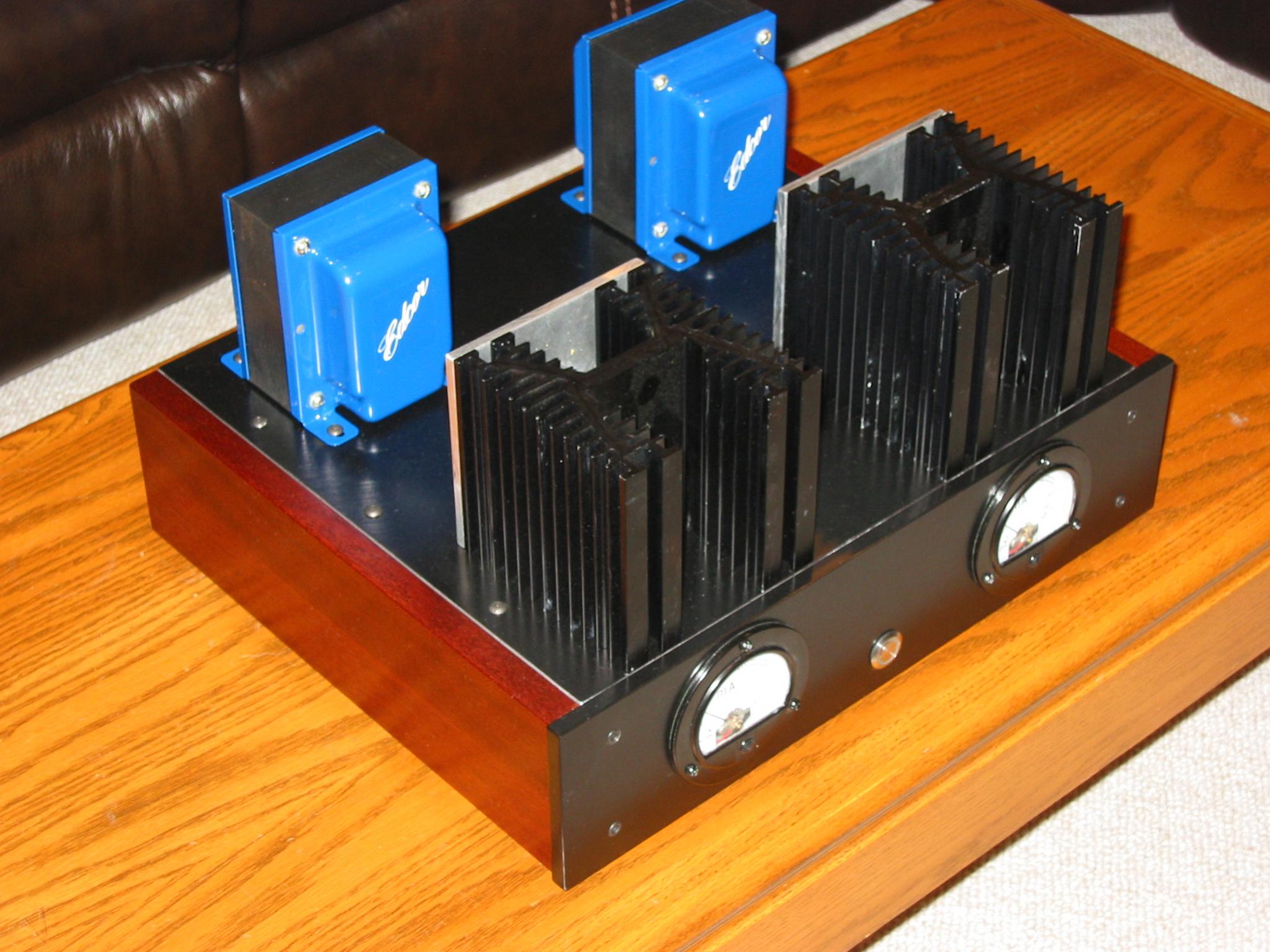

I built one with the IXFN44N80P.![]()
I was playing with Big MoFo.
This one need nice front end and preamp with lots of gain.
Do IXYS version have better specifications versus IRFP ?
Dreaming about The Dude at BAF17
Well, the distortion was lower due mainly to the much higher bias, and the output impedance is a little lower. I haven't spent any time listening to it yet.
It's really just a case of me taking things to the extreme out of morbid curiosity and the pure fun of it. Whether it sounds better or not wasn't really the priority.
