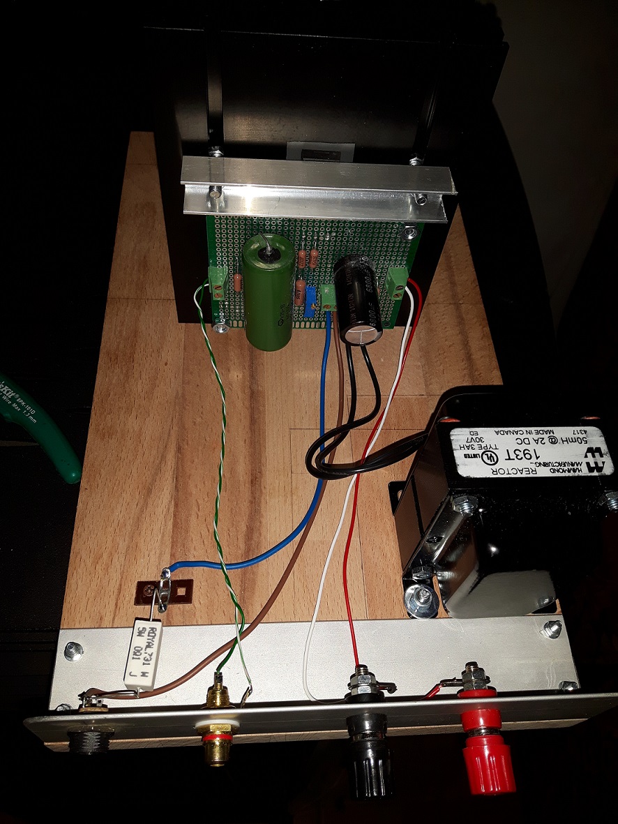

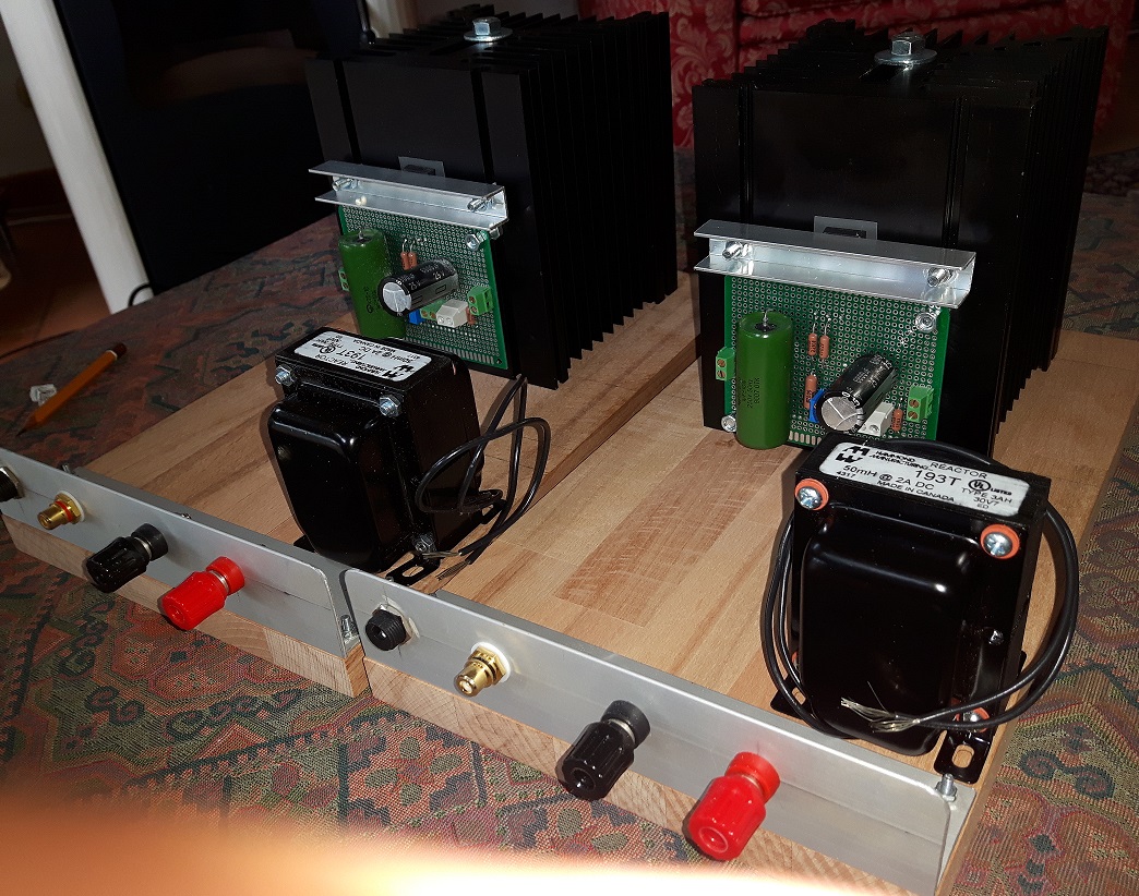

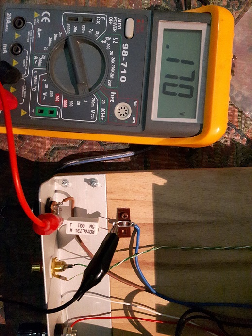

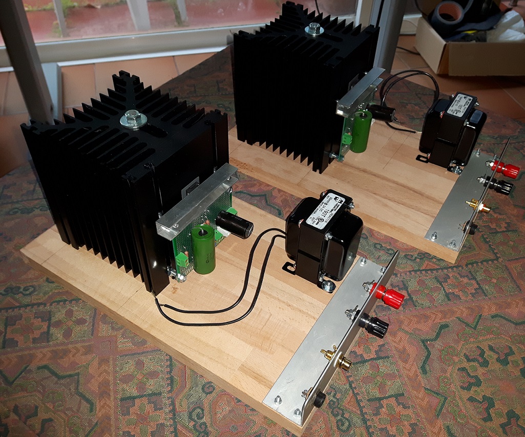

this is my MoFo. I used a simple perfboard to wire the simple circuit kindly suggested by Mr. Rotacher. Maybe I have not been original but the realization using wood and aluminum seen on the pdf presentation I liked a lot. Minimal art .... and simplicity. At the moment I do not have a pre of adequate quality to accompany the MoFo. My DAC (diy) is directly connected to the Mofo with Lightspeed (diy) to adjust the volume. So I do not have the necessary gain to drive the Mofo. I have to provide myself with a preamp suitable for quality and necessary gain. For the power supply at the moment I used the recommended SMPS (19V-DC). I performed the 1.7A bias calibration. The mosfet is the IRFP250.
I have been using MyRef Fremen Ed for years with great satisfaction.
The MoFo sounds wonderfully well. I should repeat words already said by other users that it would be boring to repeat. I can only say that he exhibits one of the best performances I can remember ... and my passion has lasted for 40 years.
After this debut I'm already preparing to go to BigMoFo (193V by Hammond and SMPS MeanWell LRS-200-24).
Thanks to M.Rotacher for sharing a real gem.

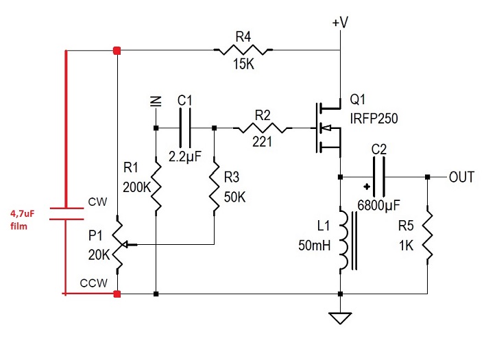

I also thought to place a cap to 4.7uF film to shunt to GND spurious in high frequency that I think can loop back to the gate .... maybe it could be useful. I would like to know if M.Rotacher approves.
Today I tried at home of a dear friend the two MoFo in his system. He was interested in getting to know the Mofos and to me instead check how much a great preamplifier affects performance. My friend owns a Conrad-Johnson Premier 14 (wonderful). Well the Mofo really has an impressive performance. My friend was very impressed and I am convinced that he will soon want to build it for himself.
It is probable that I would use at this point a tube pre accompanied by a buffer (probably a mosfet) to be built as soon as possible.
