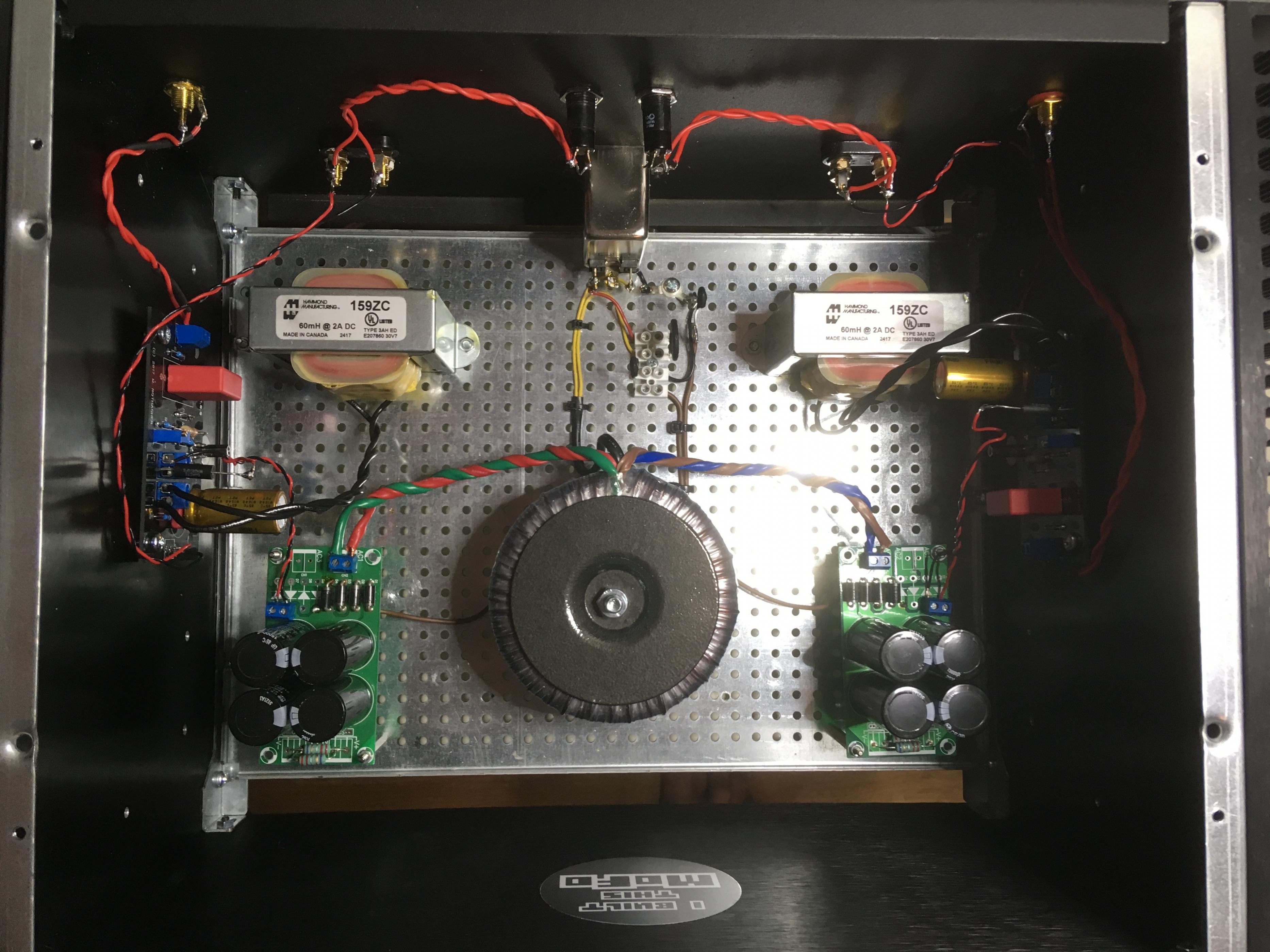

really beautiful realization.Hello fellows, here is my MoFo. 5U chassis, Voltage 23, Bias 2A and Atoll preamp. This is very good sounding amp.
your power supply does not appear regulated. have you even tried a smps?

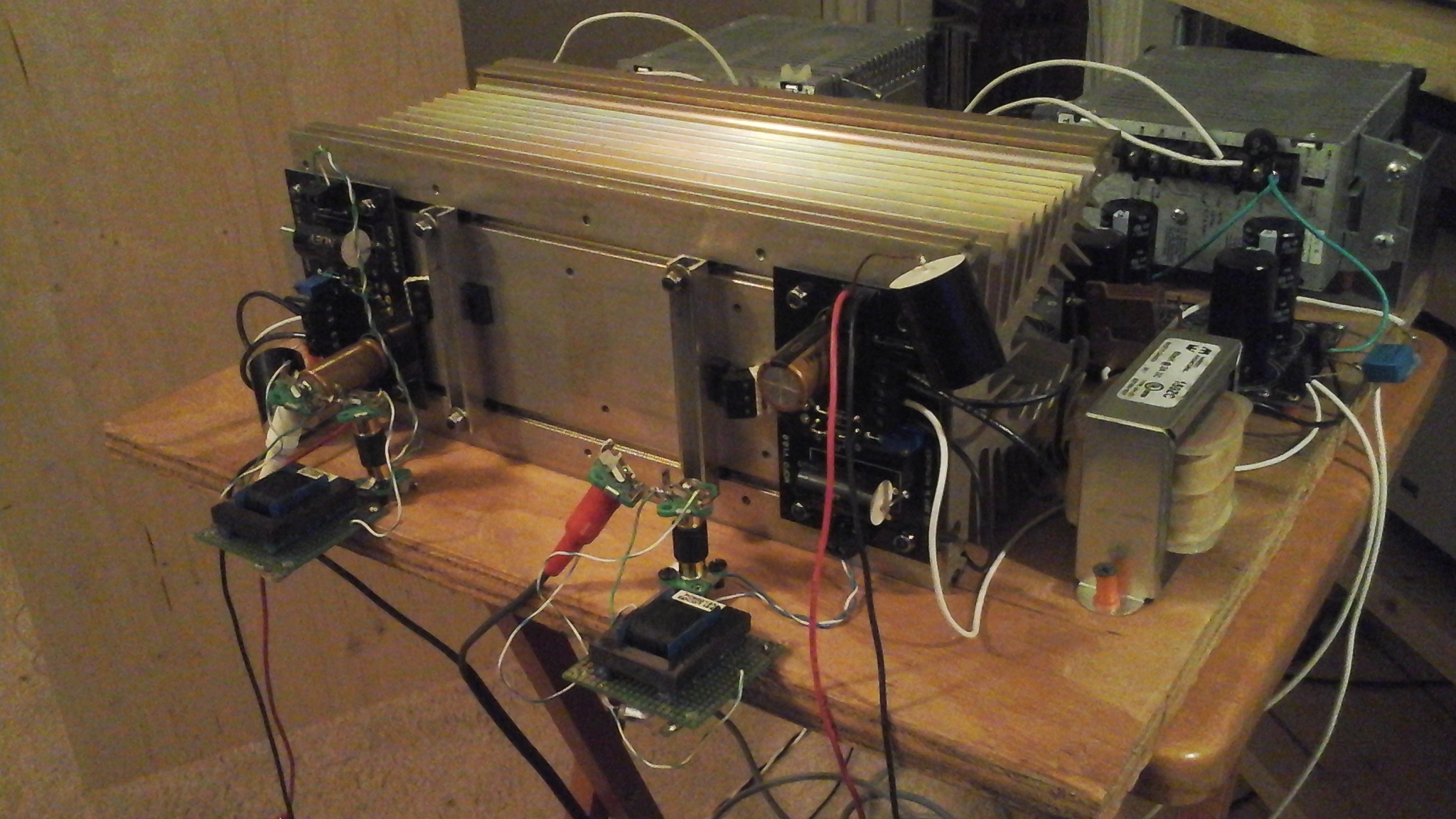

I dabbled around with some single-ended power follower ideas but never built them. Then Michael came to the rescue with an article, a circuit and a PCB. I'm still experimenting so it's mounted on plywood right now.
Right now what's sounding nice is a P-channel version of Papa's B1 buffer into an auto-former for voltage gain (same heart of Papa's M2), driving MR's MoFo with IRFP140N.
The idea was a SE version (sort of) of the M2. About half the power, but a little more low level detail.
Super nice!
The idea was a SE version (sort of) of the M2. About half the power, but a little more low level detail.Almost there....
Thanks Michael, really enjoy reading your articles.
Looking good! Plywood makes it sound better.
