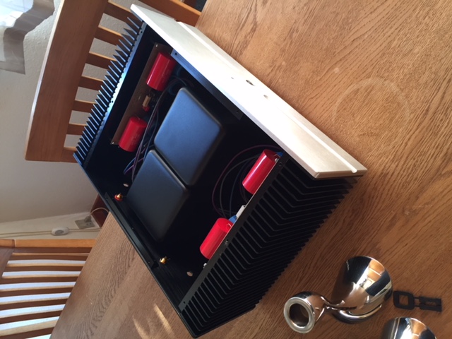

Damn, now i need bigger house

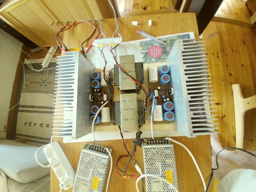

Fantastic Frank. Very Elegant.I haven’t had too much time and progress is slow, but this is what I have done since last time with my MoFo with a twist. I still need to mount the switch mode supplyes.

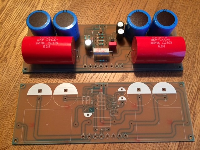

I got the transformers, boards and mosfets from Frank. Mine is not as elegant, but I have heard it play
I unfortunately had to go abroad for some weeks, so thorough listening will be later..
A nice thing about this is that it does the amplification so no need for a special preamplifier..

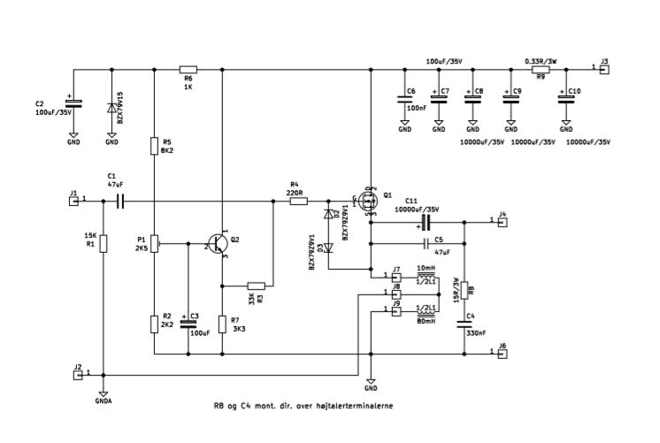

I have an existing chassis with a Firstwatt type power supply,+/- 23 volts.Would it be possible to run one channel off the + supply and use a complement p ch mosfet run off the - supply for the other channel? I know there are no IRFP250 complements out there (to my knowledge), maybe parallel IRFP240's and their complements? I know,I know---don't be a cheapskate,its just an idea.
Donut - is it 36Vct , or twice 18V?
It is 2 separate 18V secondaries.I'm using a DIY store power supply board so I can pull the common ground jumper.
do exactly that ........then having two independent supplies
