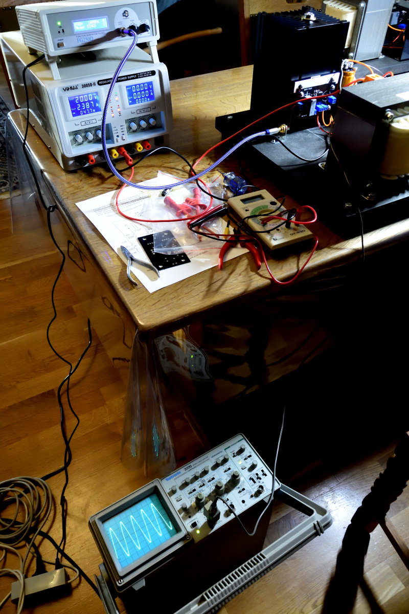

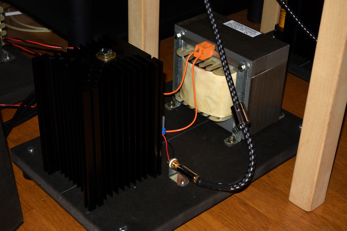

Now I got a signal to the MoFo…..and it seems to work. 250 kHz no problem and 3 Hz works fine also. Sine, triangle, square. So now I just need to modify my PSUs for the ACA so it can handle up to 3A (schottky diodes need heatsink). Also need to adjust and check the other MoFo mono block.
When I put a ear to the choke I can hear the test tone. Putting in a square it gets much louder.

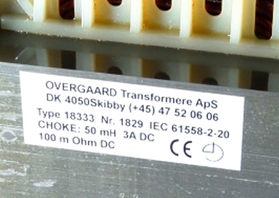

source of choke is in the image![]()
Yes, they are custom made in Denmark.
The original purpose was to get a choke that had so low RDC that output cap could be avoided but that was not possible within reasonable size (next level was 55 kg or so...). I decided to get the big choke anyway to have a lot of iron to have a very linear choke. So it ended up with approx. 73 mOhm and 20 kg. The 3A written on the label is just from my order. It can handle much more if I decide to experiment with high bias current.
I have just tested and verified that with 2.5A bias I have about 0.2V DC. So it would be possible to use it without output cap but I think 0.2V DC is too much. The output cap may also add some safety. These mono blocks are heavy to carry around. They both seems to work as it should using test generator and scope.

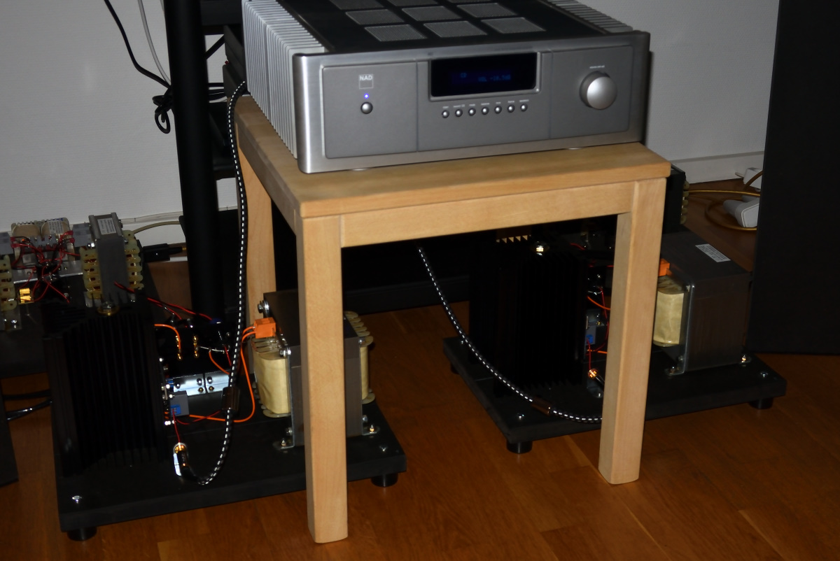

I tested MoFo this night on real speakers (OBL-15).
Modified my ACA LCLC PSUs a bit so Schottky diodes got better cooling. Then went for a bias = 2.5A. Voltage dropped from 24 to 16 volt caused by the internal RDC in the filter chokes. Filter chokes get a little hot but ok. So 16V and 2.5A for the MoFo's. I may change the main transformer later to get higher voltage. MoFo choke stays 100% cool!
It takes 1 hour warm up to everything is stabilized (large heatsinks).
I use my NAD M3 as pre amp (BA3 pre is next project). NAD M3 has a JFET kl. A input stage and it goes to 10 dB in amplification. For 95% of the music I don't need more.
Sound is surprisingly good. Think it has triode like sound in the high and mid tones. Then is has bas control like a solid state. A very good combination. Compared to ACA I find the sound a bit "warmer" and maybe a deeper sound stage. MoFo has more "muscles". I can feel that in the bas section.

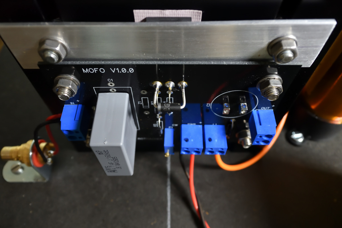

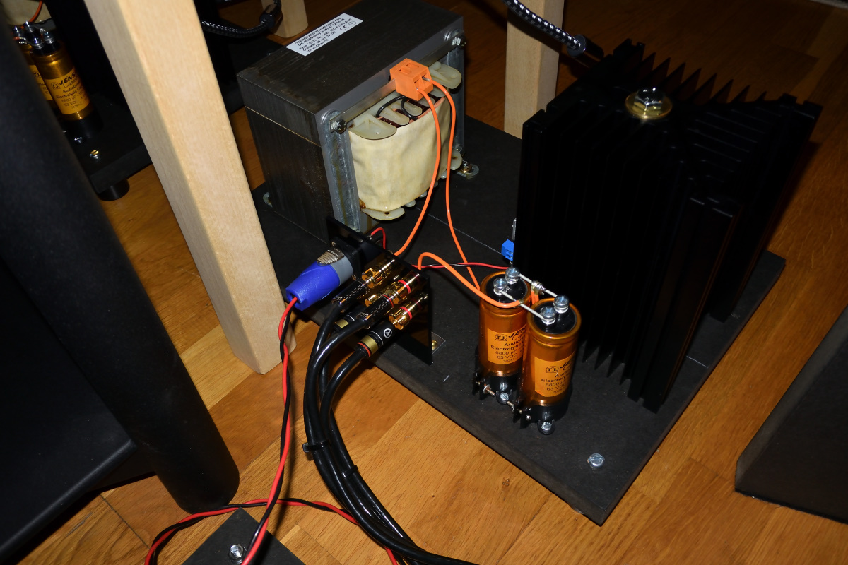

Even that MoFo looks like a very simple build…..it takes some hours. I also went for larger external mounted output caps. The wiring is a bit different. I keep the high current as much as possible away from the PCB. The orange wire is AWG12 to keep the impedance low to the output caps.
Sound is amazing!

Yes, output cap not installed on PCB. It was my intention to use terminals on PCB to connect the external output cap…..but found a better solution for the wiring. The 1k bleeder on PCB is for no use then……
I mounted the RCA connector very close to the input terminals to have very short input signal wires. Think I like that……
I could bypass the output caps if I could live 0.2V DC...….
