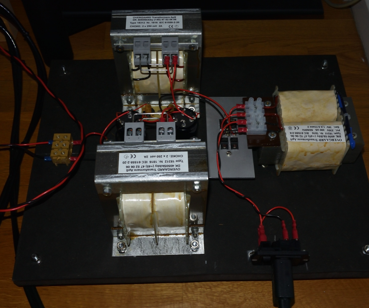

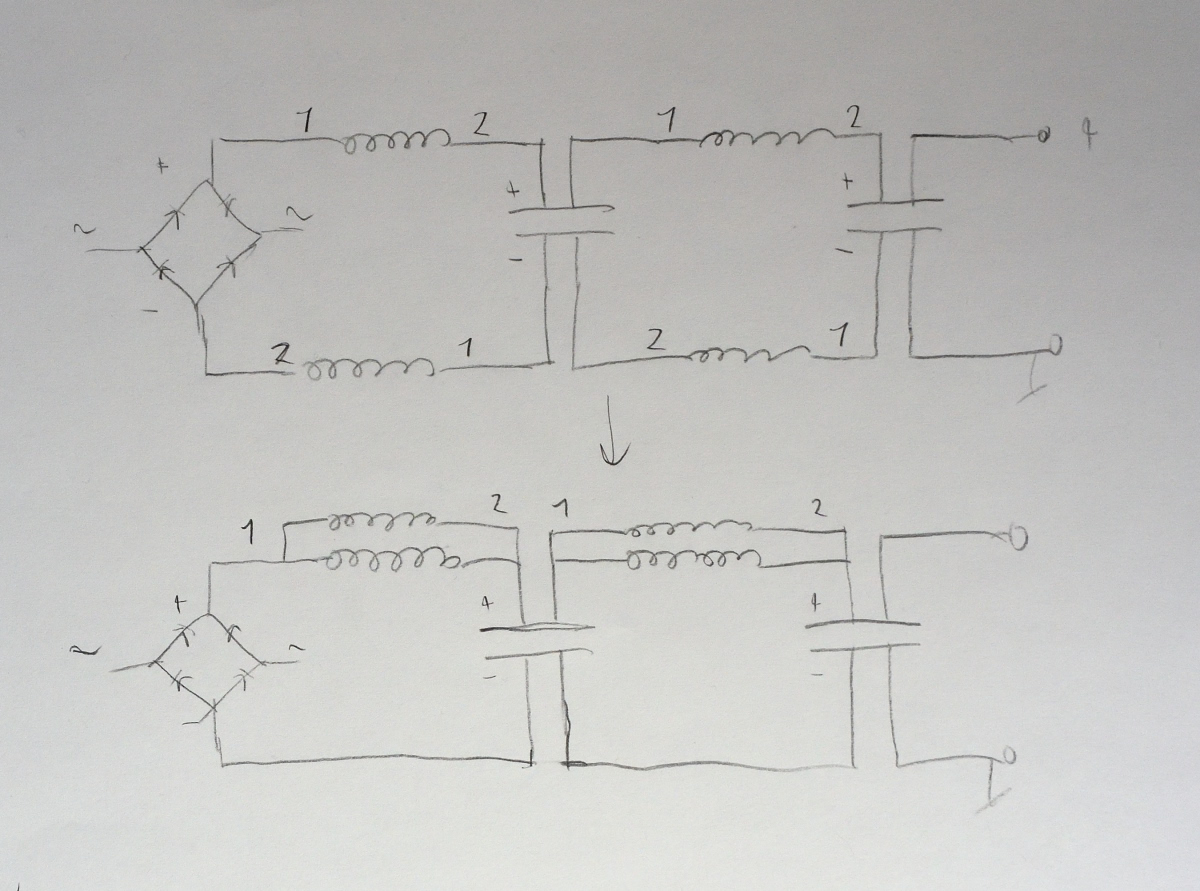

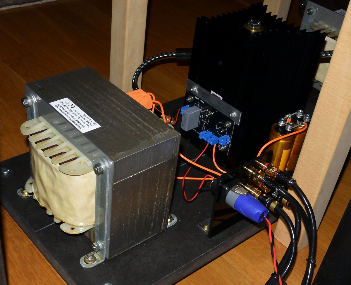

I made a few changes to my ACA LCLC filter PSUs to work perfect with MoFo. The schematic shows the changes. For ACA the output was about 24V at 1.4A. Now I have about 26V at 3A. The ripple is still low. About 2-3 mV pp. I biased MoFo to 3A. About 80W is burned pr. side. The big heatsinks seems no more to be "overkill". The reach about 53-54 C. I have no problem so far with power on/off but have not tried to stress test by "playing" with the power connector to the MoFo. I power on/off at the 230V side.
It is difficult to leave the room when it is playing. It sounds very good and relaxed. Deep sound stage. It is like a triode…...but with more bass power than a 300b can deliver. I go via a 1000 VA isolation trafo. I have two outputs. The 1:1 and a lower voltage output. About 200-210 VAC. It will be perfect for ACA so I can still use the PSUs for the ACAs (has to be tried).

I made a few changes to my ACA LCLC filter PSUs to work perfect with MoFo. .....................................................................
the inductive input supply allows a substantially sinusoidal ripple, ie without sawtooth peaks, moreover the ripple is indifferent to the increase of the load. The price to pay over the important encumbrance is the internal resistance of the inductance that causes a significant voltage drop.
But .... in the end .... have you compared with a supply with capacitive input and have you noticed a significant "best sound"?
The LCLC filter PSU is the only one tested with ACA so far. I had plans to get the Meanwell PSUs and use them to compare. Also to have a portable set of amps I could carry and take with me so friends etc. could try them.
I know I get a large voltage drop over the first choke. the AC to the rectifiers are 38 volts and the voltage at the first cap is approx. 28 VDC. So I can use 40 VDC caps. Without load the voltage at the caps is just about 40 VDC. They can take it.....even if you get a bit above 40 VDC. I have bleeders (2 x 470 ohm which maybe should be lower because the current now is 3A with load). I still need to test more without load to be sure nothing goes wrong if the fuse blows (I have a 4A fast fuse at the output of the PSU and everything should survive if fuse blows).
If I decide to get the Meanwell 24V/5A PSUs for the ACAs to have some portable or for comparation I will write how I think it sounds. It is always a difficult task to describe sound difference but also interesting. It is easy to be "biased" against something the mind think is correct!
surely each of us can deceive himself but not beyond a certain measure. So if you give a judgment I will take it seriously, good or bad that it is ...... but it is a free judgment and to exchange opinions makes us grow.
