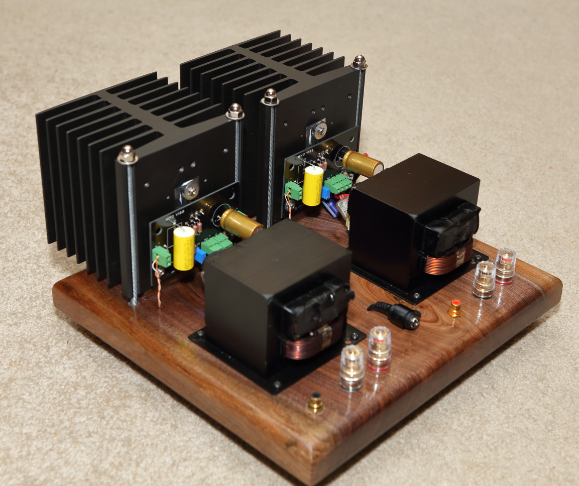

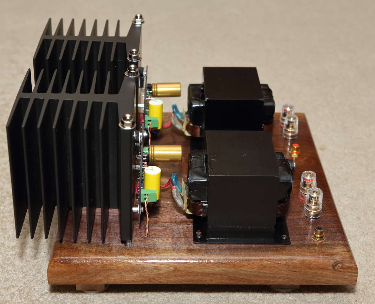

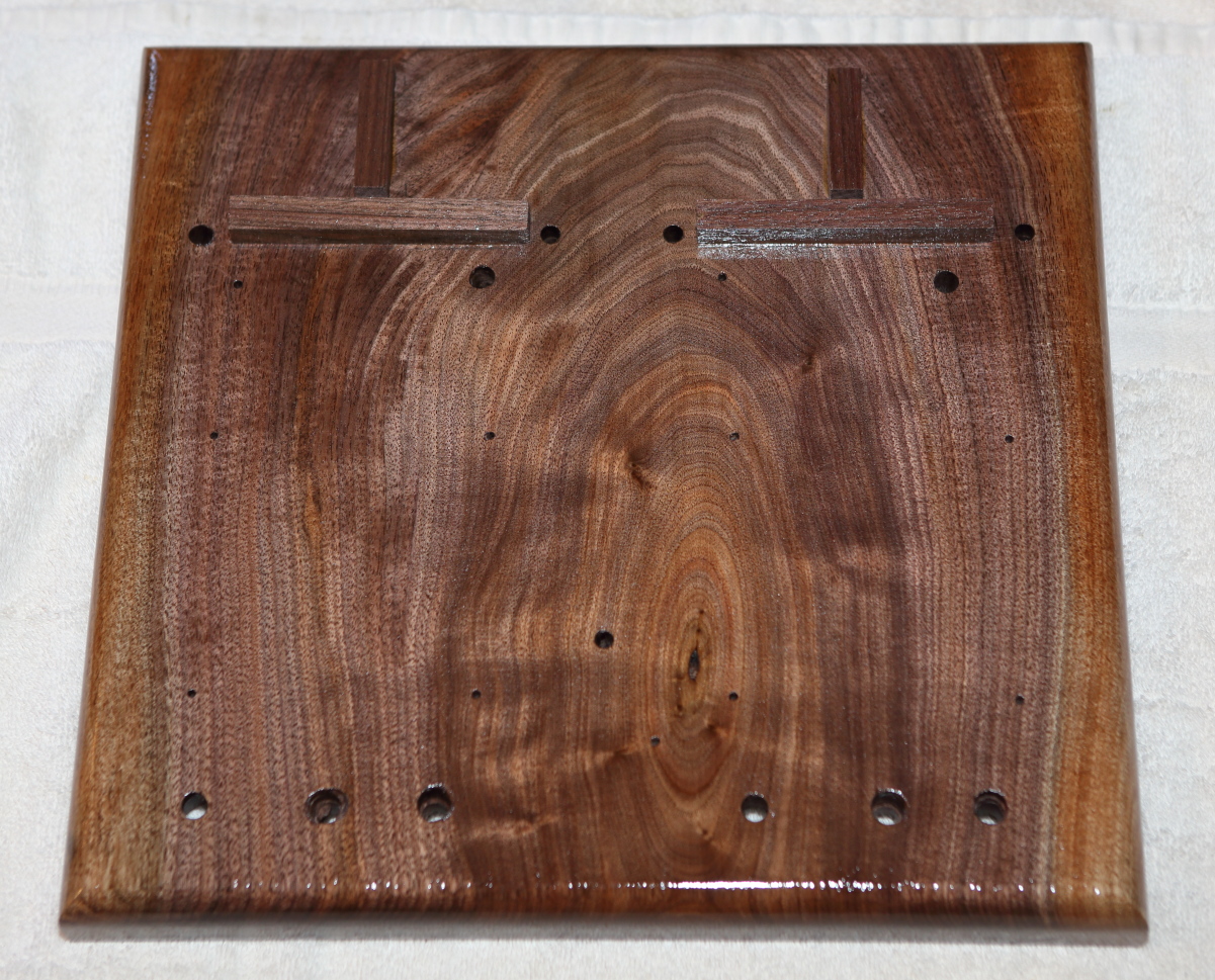

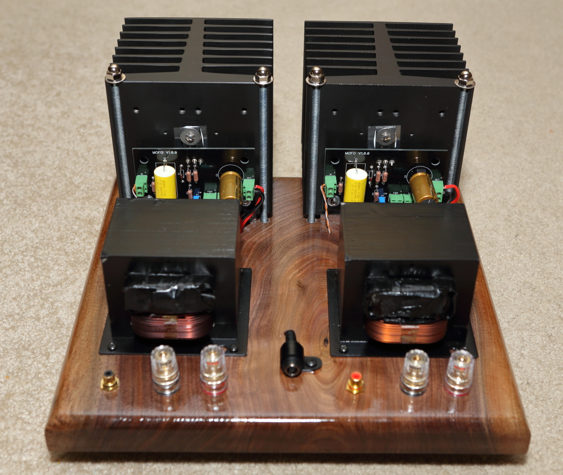

Got my MoFo amp finished over the weekend, though I haven't yet had the opportunity to listen to it.
I made it "bread board" style with short legs and ran all of the wires below deck. I made a small, wooden T-support that goes under the base of the sink to improve the airflow a bit and the last few vanes dangle over the edge of the board.
Since the sinks are isolated from one another, the mosfets are mounted with only thermal paste. This allowed me to bump the bias up to 3A for each channel and still limit thermal rise of the sinks to 25c. Using a Dell power brick rated for 12A delivers 19.1v when both channels are driven. The chokes exhibit a thermal rise of about 9c with 3A of current through them.
Can't wait to hear it tonight! It's rather heavy with all of that metal on top!

Only two albums on the MoFo amp so far (driving it with a BA-3 pre), but there is something special going on here in the midrange. There is a depth to it that when standing in the middle of the room I want to look around to see where sounds are coming from. The M2 seems to have a bit more bass, but there is clearly a depth to the midrange that needs more exploration!
What awesome sound from such a simple circuit!

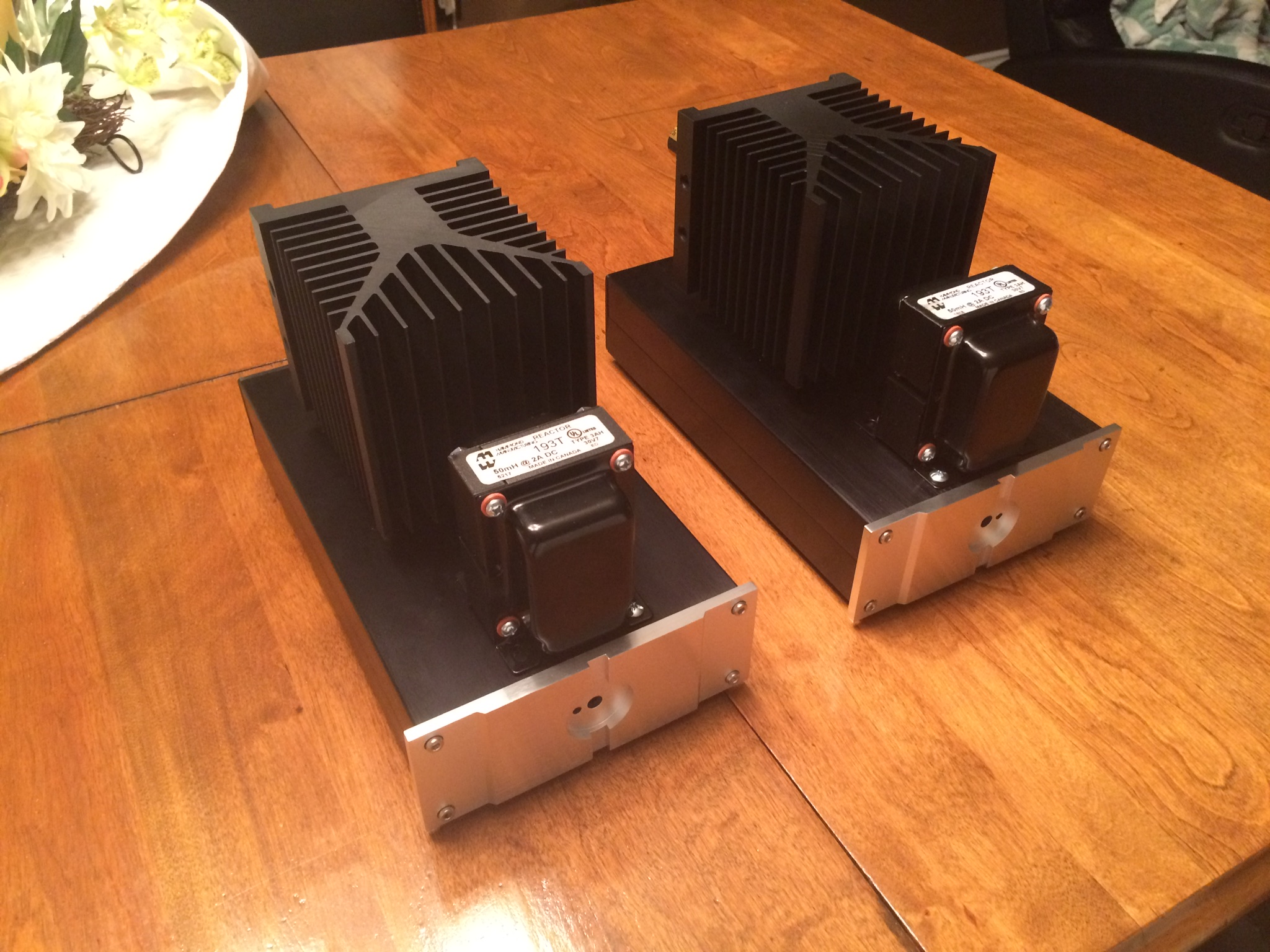

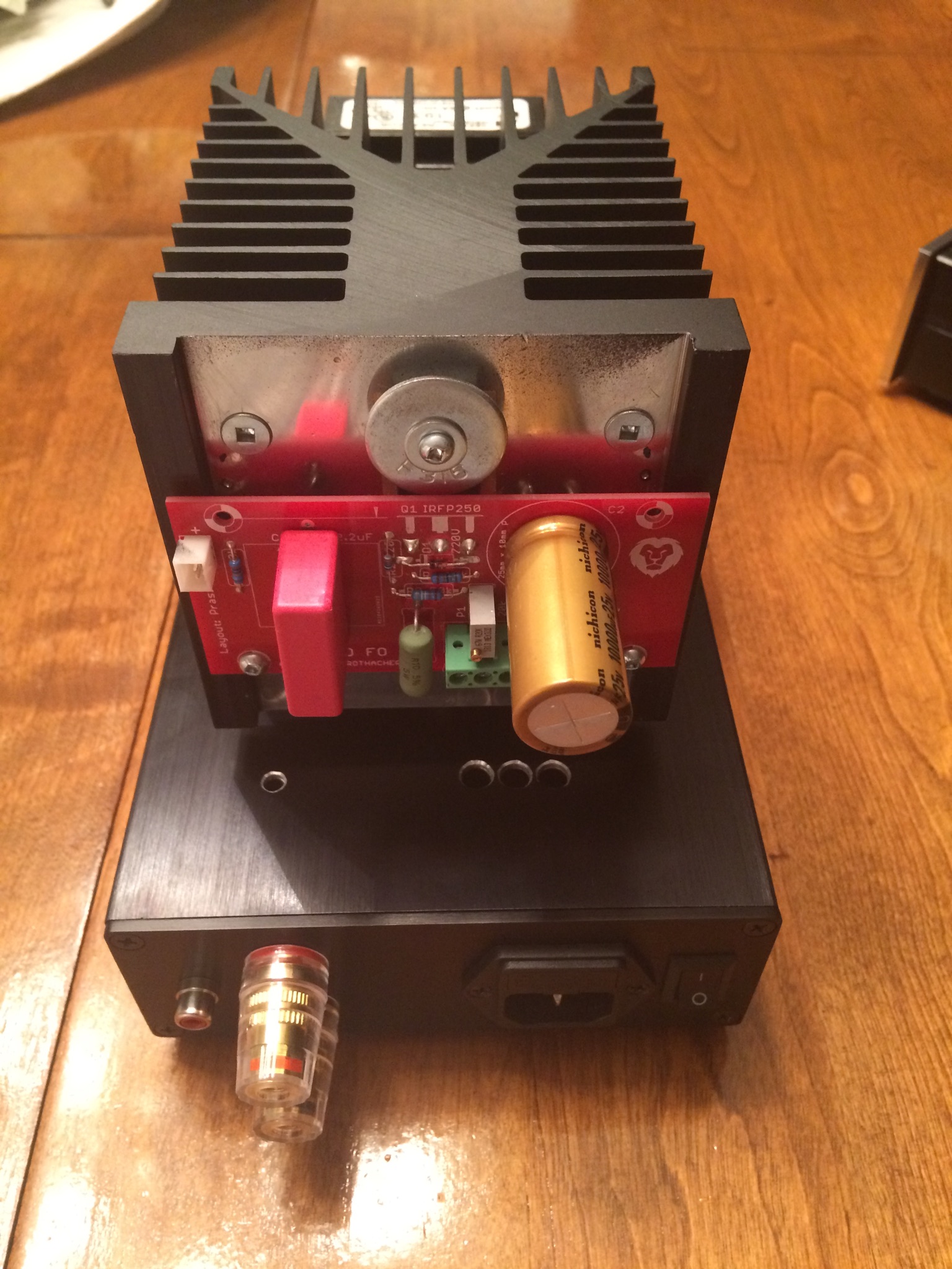

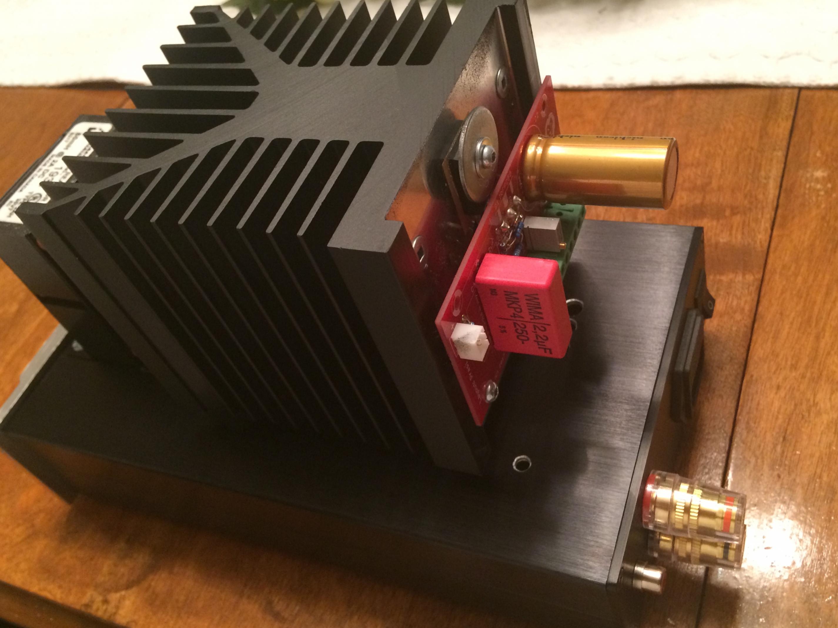

Hi guys
Just wanted to show you some pics of my dual mono MoFo.
Do not hesitate to build this amp, it’s truly amazing. Thanks for sharing your design Michael. Thanks also to Prasi for the pcb.
Both amps were wired on a work bench for a few weeks but I finally decided to give these amps some enclosures. Tomorrow I’ll have to rewire them..
There is a place for a volume in the front but it will be replaced by these circular blue led. (See pics)
Hopefully this will motivate someone to finish their own.
Hi guys

Very nice e_forier! I'm assuming your SMPS's are in the lower part of the enclosures?
Thanks.
Yes, the 19vdc smps are inside the enclosure. I’m drawing about 40% of their available power so I’ll see if heat is a concern.
