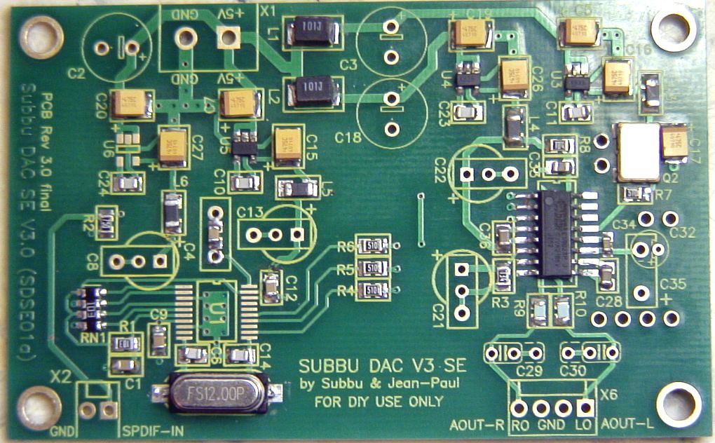

Another orientation question. C5, 7, 15, ..... are polarity marked. Data sheet does not indicate if that is the standard (-) marking for caps.
Hi we tried to pick parts that perform good but some are easier to find. We choose standard industrial parts generally except for caps which I first try out in prototypes. My 3 pieces V3 are all made with different caps. The BOM is something some of you ask for religiously. I never make BOMs as I choose caps myself. Take for instance the aluminium pearl caps which are hard to get. Have to admit the aluminum pearl caps were chosen by me as they are a worthy replacement for Black Gate caps. Since I stock both I also try both. Subbu made the BOM and sends me the other standard parts.
*tantalum caps always have the positive pole marked in opposite to electrolytic caps. Don't ask me why, it only gives confusion but it is a fact. So the + is the thick line left of the text on the cap*
Too bad the data sheet says nothing about that, it should be described. The electronic industry choose to deviate from a standard but fails to make it clear at least that is what AVX does in their data sheet.

Maybe it's not just me. I'm seeing U6 on the BOM I have listed as ES9023. The ES9023 is in place, but not at U6 - which is a five point pad similar to U3, 4, 5.
U1 is open and listed as WM8804 on the BOM, and is the part I received with the PCBs - I believe. That transceiver is what I misplaced and have ordered. Honestly, I didn't pay that much attention to the large multi-lead chips till assembly started.
So, does the BOM need some adjustments, or could I just have a version that doesn't reflect the final product? ---- or is it still just me ?????
I think that line on the BOM should read "U3-U5-U6, as I have one extra MIC5205-3.3.
With the exception of U1 and U6, all the surface mount parts are soldered on the board. I'll wait till the site gets the graphics upload problems corrected and I can post a photo before I finish with the through-hole parts.
Hi bcmbob,
I also noticed that the BOM has not the correct designators for all parts.
You can use the silk screen together with the Schematics PDF to put the right parts in the right place.
U3, 5 and 6 are the 3.3V regs and U4 is the 3.6V reg. U1 and 2 are obvious...

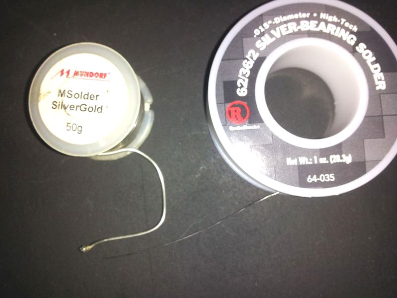

As JP stated - the 0.015"/0.39mm solder makes a world of difference. Cleaning the tip on almost every solder joint really helps carrying the minimum amount of solder to the work. Some spots have very little overhang on the pads. If available, I seems to work best to hold the SMD part in place, start at the pad edge and sweep the solder into or across the leads on the part.

You are right about using thin solder and cleaning the tip after a part is soldered. A wet sponge is the best. BTW I use tweezers made of material that can not be soldered to keep the part aligned (I think mine is made of titanium or an alloy). Then I solder one pin and push the part with a long fingernail and touch the same pin again with the Weller. Then the other pins.

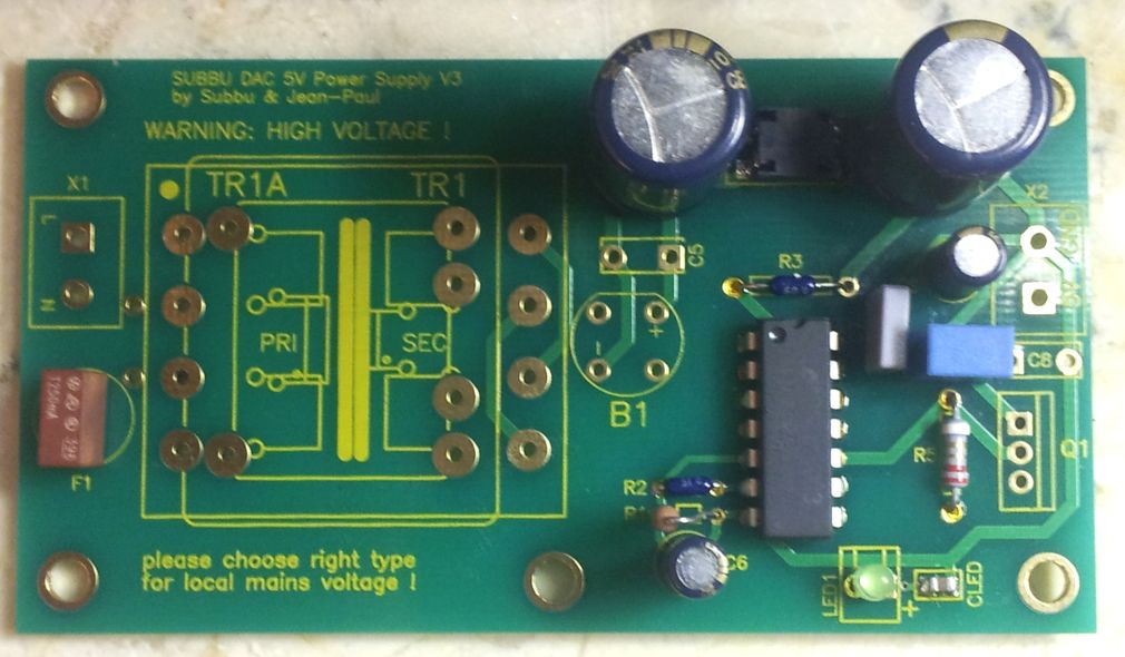

I hate to expose all my dumb moves to the entire world, but I neglected to order the biggest part in the project - the PS transformer. Guess I was thinking "small and tiny" and looked right past that big hunk of copper. Well, that's my story/excuse and I'm sticking to it.🙄
Have to give Mouser their props though. I discovered the missing trani just moments after completing a combo order for a couple projects. They weren't open in the central time zone yet, so I popped off an email requesting it be added if possible. Several hours later I got a reply stating once my credit card was charged no changes could be made. They resolved the issue by voluntarily generating a new separate order, waived all shipping charges and sent them both off side by side. I think that's something special in today's business climate. A tip of the fedora to the folks at Mouser.😉

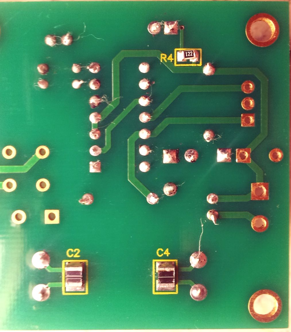

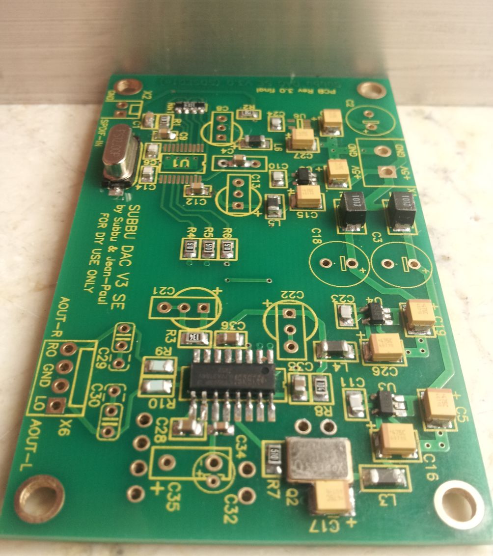

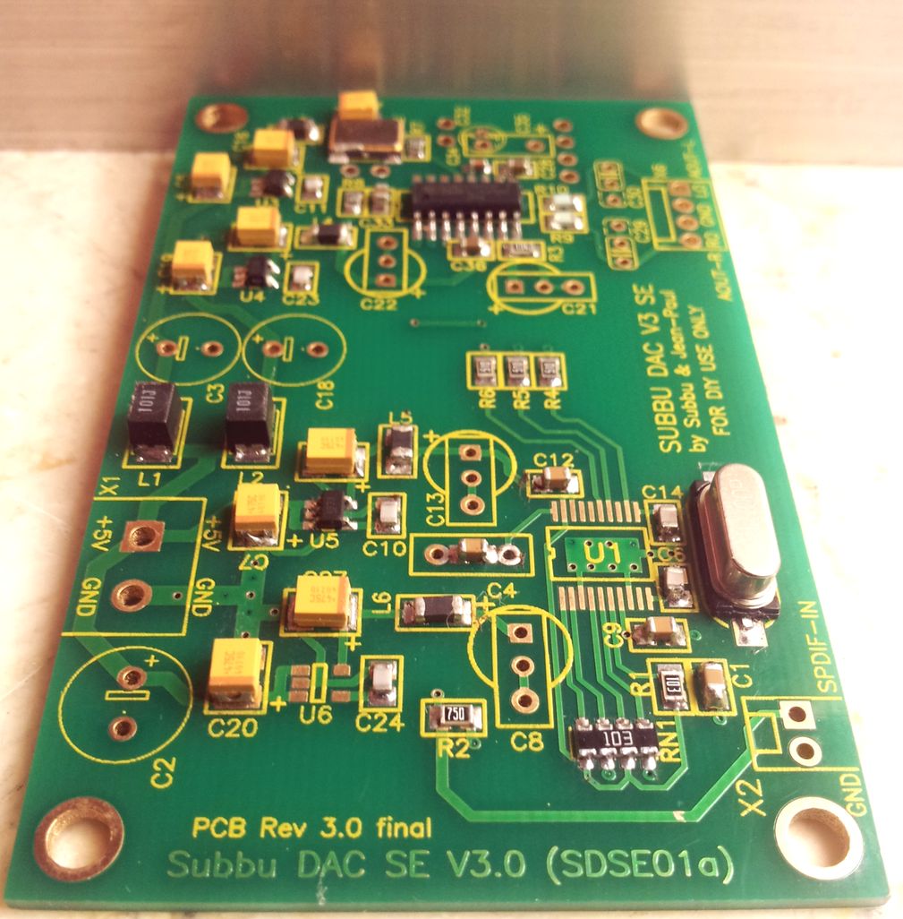

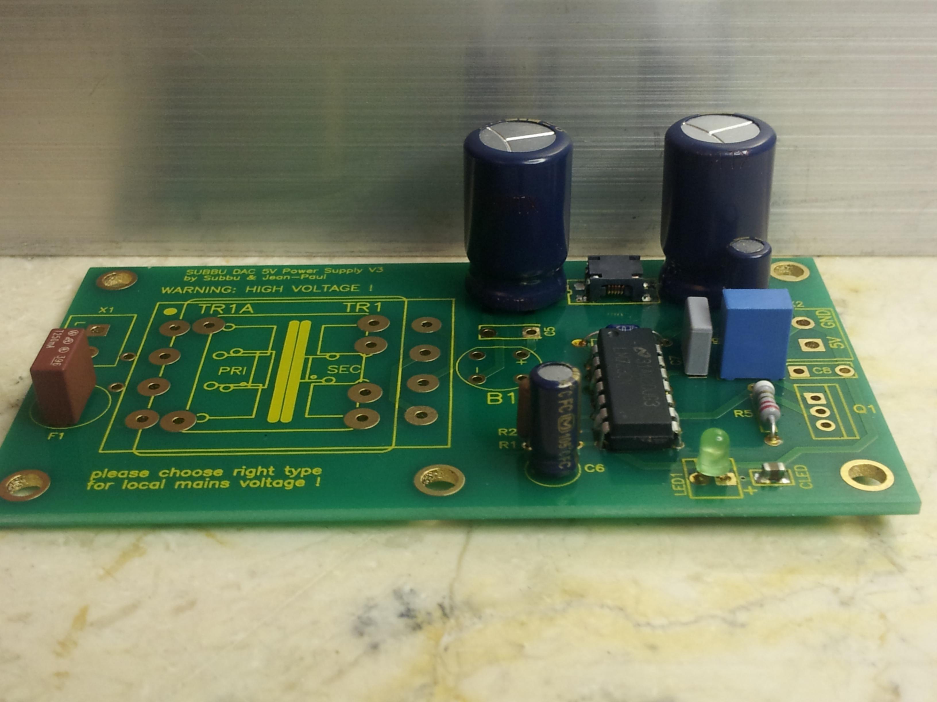

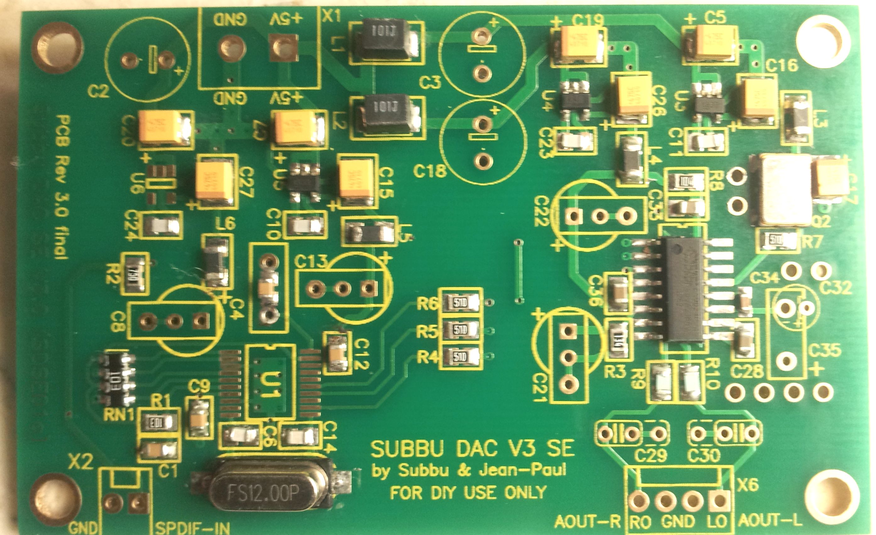

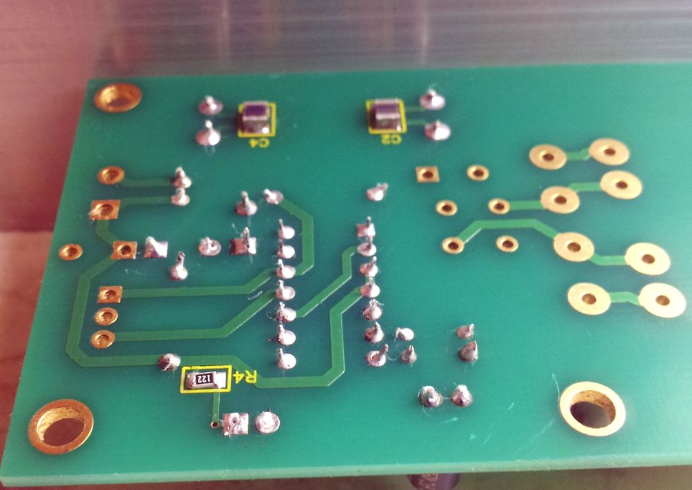

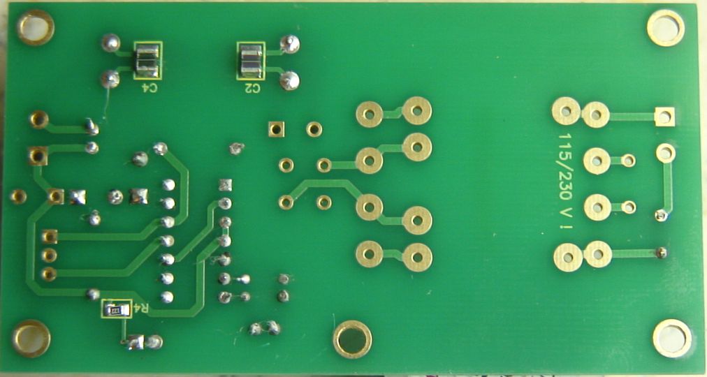

So Far - So Good, I hope.
These represent the progress to date. Might not be able to move on till Monday.
You will see some TH spots that appear to be missed or cold solder joints. I left them in because they didn't show up till after the board cleaning (Alcohol & Dow Bathroom Cleaner) was done. Care must be taken to make sure nothing is hidden by caked flux.
It's probably evident which pieces were done with the fat solder. Even with great care it can be tough to keep SMDs in line. I could make corrections, but don't want to use more heat unless absolutely necessary.
Duplicates are from different camera. The lint fibers come from the clean shoe brush used to polish the boards. Another pass of alcohol/toothbrush and they will be gone.
I'll give it a B+. What say you Mr. JP? 😉
