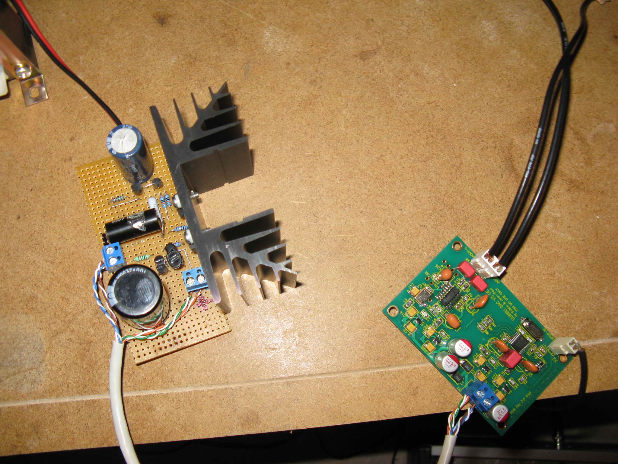

One more finished. My first SMD project and managed not to burn anything!
Of course soldering not so nice as others here, but it works.
Initially I thought I made a mistake or burned something, as I had the right voltages but no sound, but I only had to reflow some joints on Q2 and Q1.
Info here helped a lot.
Power supply regulator is a Salas reflector.
Sounding really nice right now!

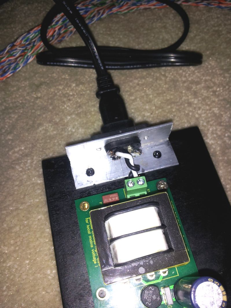

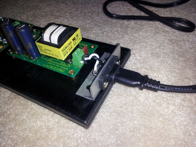

I'm not recommending this for anyone on a safety basis - but I installed a two wire set on the current platform. I will most likely do the same for the final chassis that will essentially be double insulated - some use of wood/Plexiglas.
(As shown still needs heat shrink at receptacle.)
What was your gun and technique Mr George?
I used an OKI PS-900 and 1,8mm chisel tip.
Difficult to solder was the regulators an Q2, were I had to use a JBC 15Watt with a very fine tip, in order to flow the solder. One solder point the time, while blowing and then wait the chip to cool down, in order to continue.
I also used a flux pen.
Magnifying glass of course and check every soldering point.
