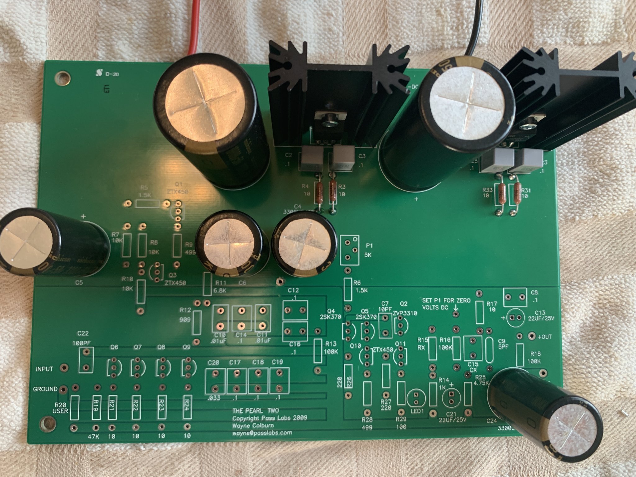

I am advancing with my build. I followed the advice on this forum to start with the regulators part of the board to obtain 24V.
Today finished that part of the build for both boards and I measured:
Board 1: ground to R3 = 23.9 V
ground to R33 = 23.6 V
Board 2: ground to R3 = 23.9 V
ground to R33 = 23.9 V
I assume all is fine but it would be nice a confirmation from the experienced folks here.
One question: now to continue on the build I just solder all the remaining components or is there another step intermediate to follow and then measure certain voltages before continuing ?

Hello Guys, really need your help. I am advancing very good on the 2 boards, only a few components to solder for this weekend and chassis will also arrive this week.
I want to pull the trigger on a turntable. From the 2 finalists I have found a good price on Marantz TT-15S1.
It comes with a Moving Magnet Clearaudio Virtuoso Ebony Wood Cartridge.
I assume I cannot use the stock Pearl 2 for this cartridge.
Can you please help on the custom component's values that I need to change in order to use this MM cartridge?

Wire per normal -- you will note from the schematic that there are position for two caps, C9 and C16 around R16, only one of which is used. You can put a resistor in parallel with R16 to reduce the gain and minimize the potential overload in the output stage. Listen first, if you find it overloads then wire in the parallel resistor if there is a problem. (The first stage will not overload). JackCan you please help on the custom component's values that I need to change in order to use this MM cartridge?
I checked now the boards and the BOM. I have used both C9 and C16, I think you meant C15 which is near R16 and which I did not use?Wire per normal -- you will note from the schematic that there are position for two caps, C9 and C16 around R16, only one of which is used. You can put a resistor in parallel with R16 to reduce the gain and minimize the potential overload in the output stage. Listen first, if you find it overloads then wire in the parallel resistor if there is a problem. (The first stage will not overload). Jack
