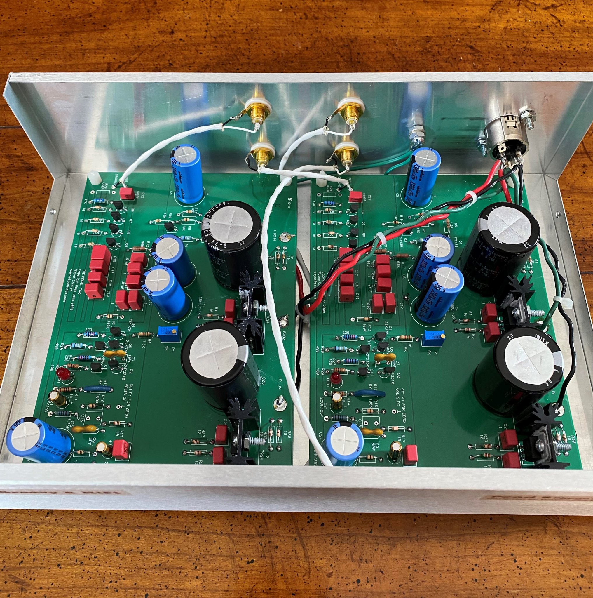

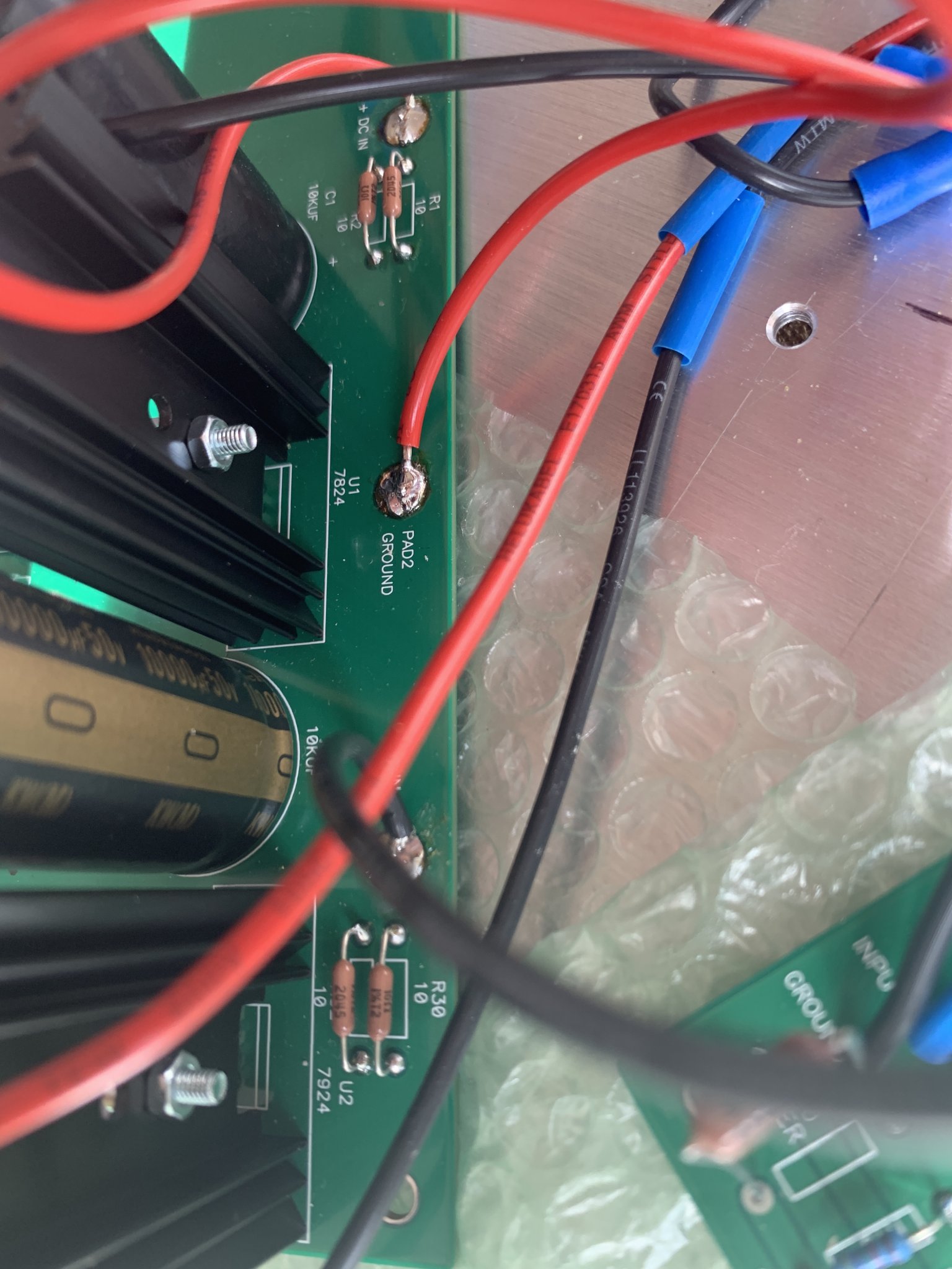

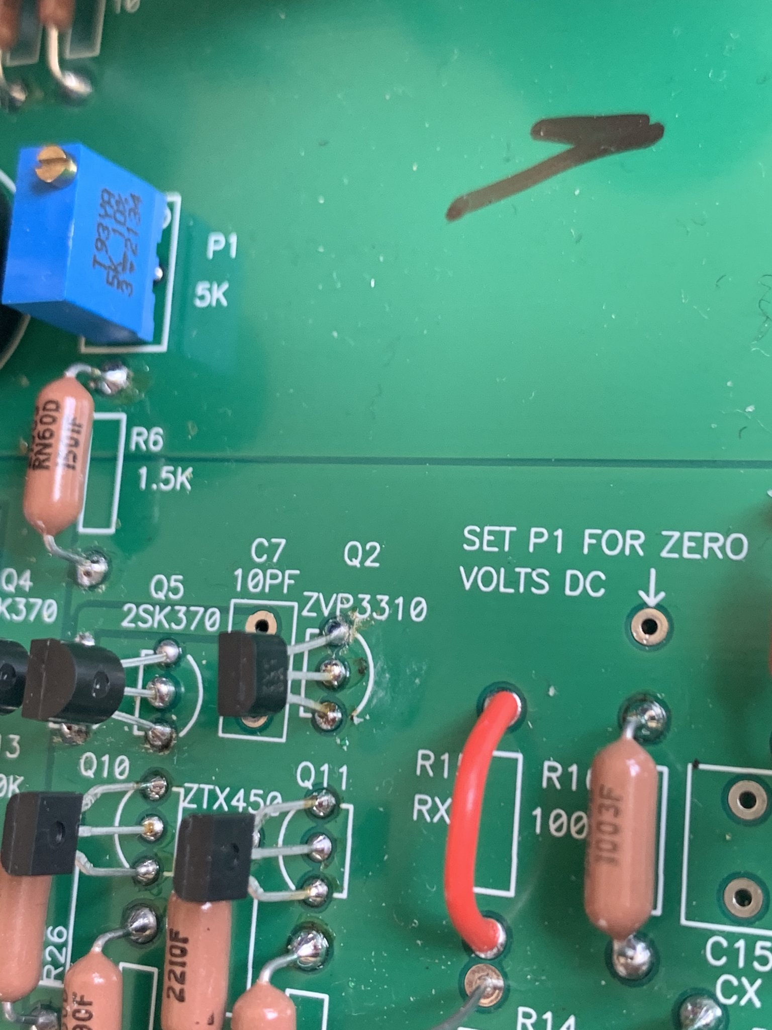

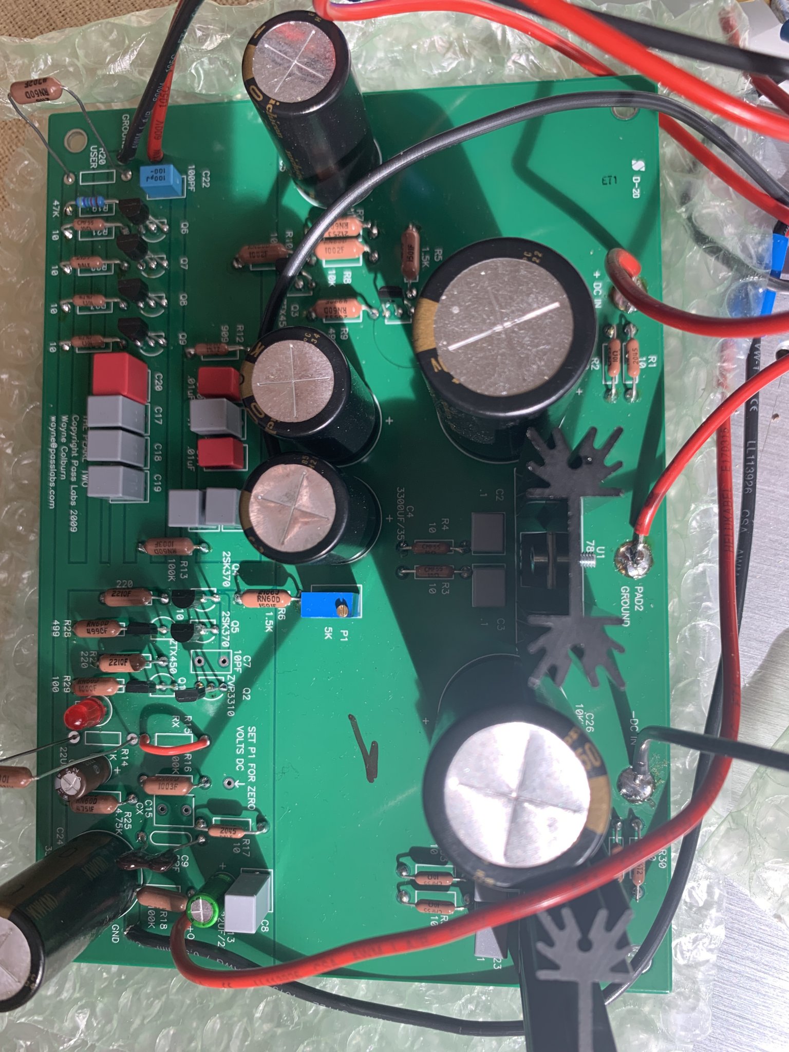

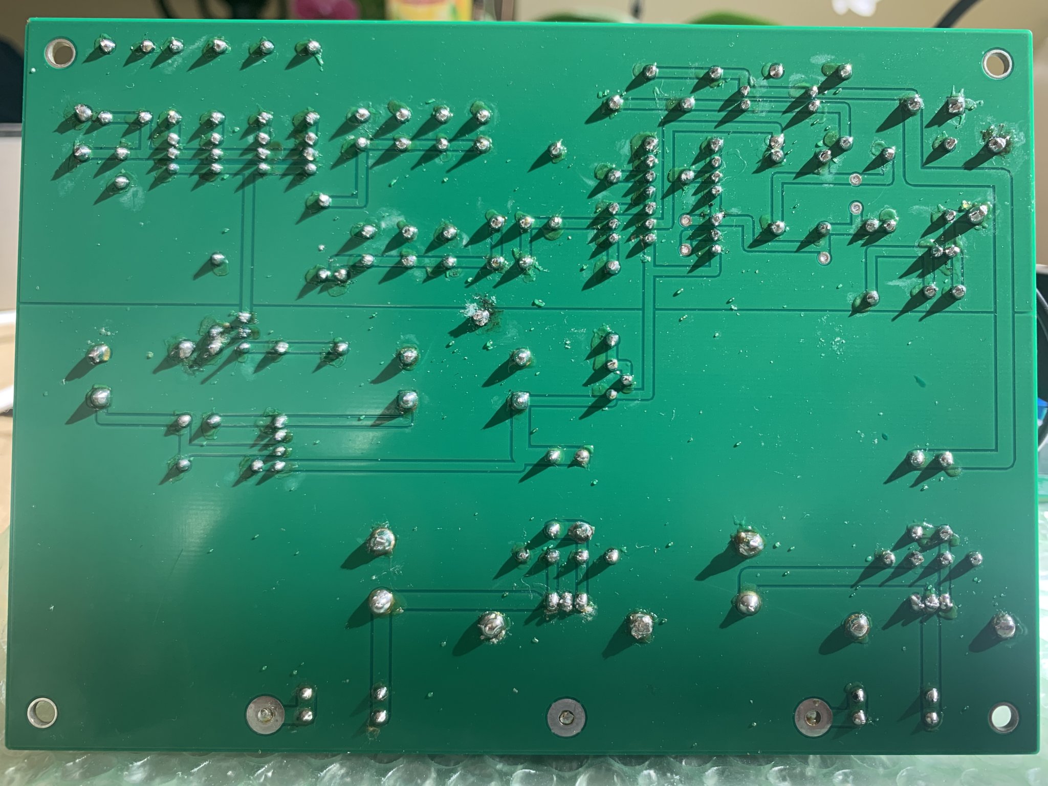

I have attached:
- back of the board pic
- front of the board
- close up at the regulators - both sides
- close up at Q2
With the meter leads - black in COM and red in V/ohm/mA I am measuring:
- red probe to +DC IN (red wire on the board) and black probe to -DC IN (black wire on the board) : 56.8 V
- red probe to +DC IN (red wire on the board) and black probe to PAD2 GROUND (red wire on the board) : 30.1 V
- black probe to -DC IN (black wire on the board) and red probe to PAD2 GROUND (red wire on the board) : 26.9 V
- red probe to R3/R4 and black probe to PAD2 GROUND (red wire on the board): 23.8 V
- black probe to R31 / R33 and red probe to PAD2 GROUND (red wire on the board): 24.6 V
- I also measured across outside legs of Q2 the current: 12.6 mA
Anything else to check?

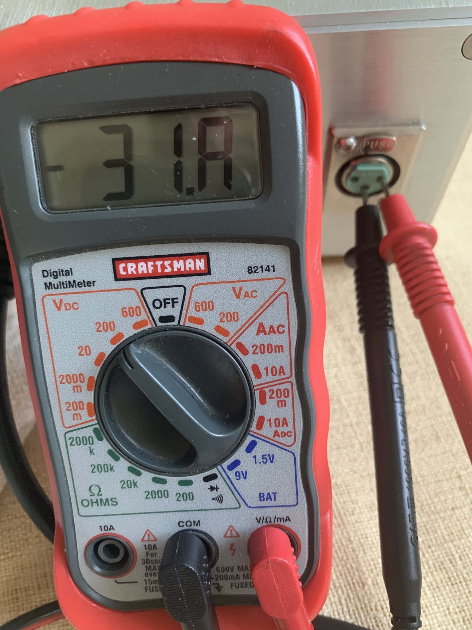

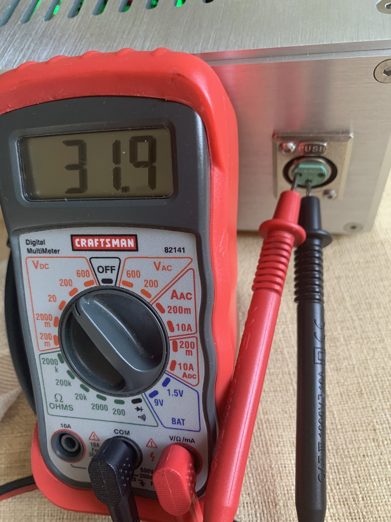

What is the voltage at the output XLR pins of your supply? Remember -- COM on the meter should be applied to the GROUND (the colour of the wire doesn't matter but black is the convention) and the voltages taken in reference to that common ground basis.

I cleaned all the flux all over the board and inspected for whiskers. It seems that all is OK. I do not have experience to tell which ones are "cold but redid some of the joints especially at the regulators.A couple of things:
You seem to be leaking voltage between the PSU and the preamp boards. I don't believe you should be dropping a volt on the positive side and you really shouldn't be dropping the 3 volts on the negative side.
More importantly, I think you probably need to examine your solder joints. A lot of them look "cold" to me. And it's hard to tell, but there might be whiskers of solder between pads. There is certainly flux that ought to be cleaned off. That might be the problem.
Hope this helps.
The voltage at PSU unit w/o load is +/- 31.8V.
I inspected the board carefully with a lens both side but could not find anything.
I still have the voltage drop.

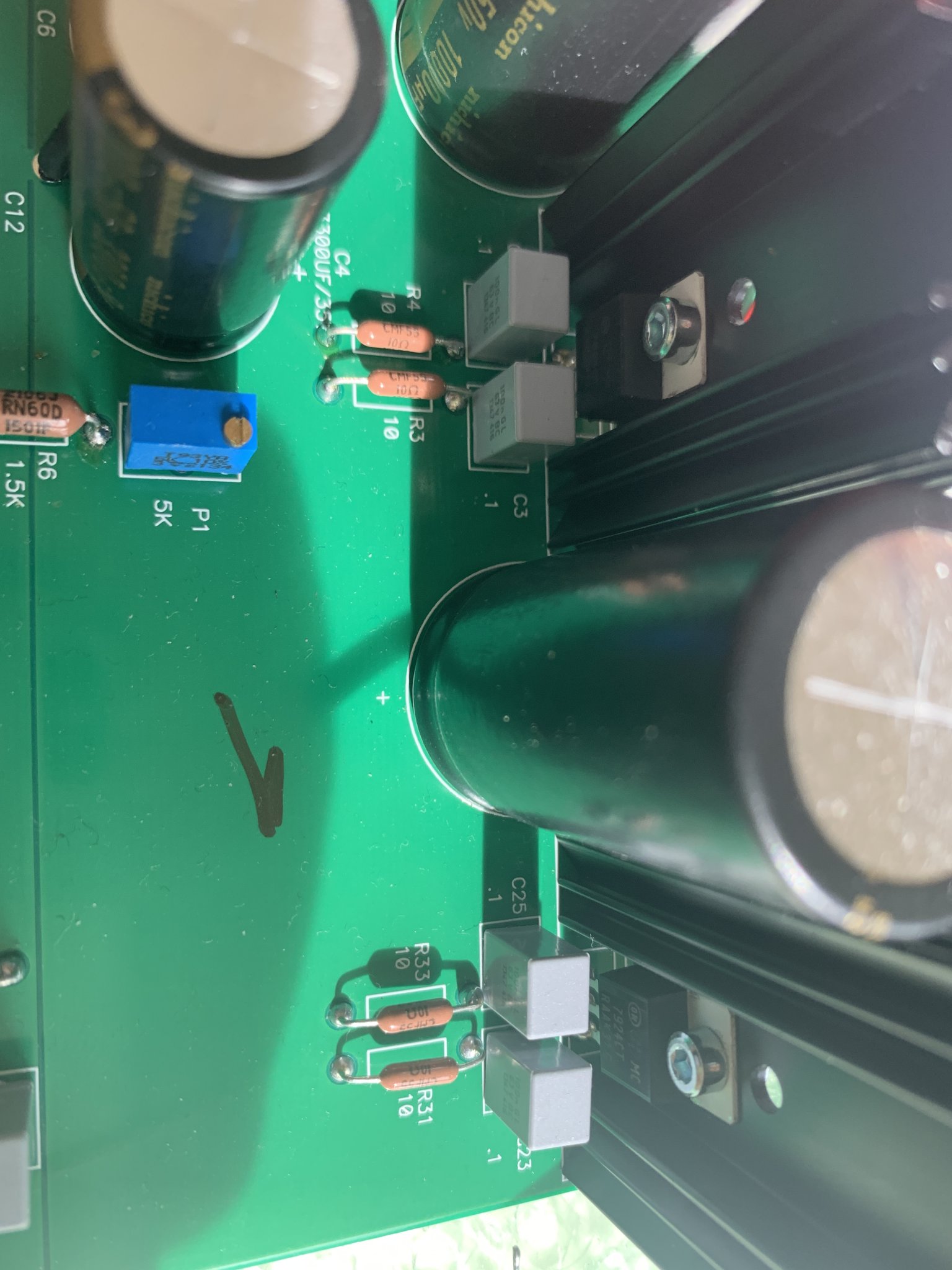

Measured as explained:
R30 = 1.60 V
R31 = 0.09 V
R32 = 1.60 V
R33 = 0.09 V
R25 = 23.3 V
R28 = 1.19 V
R29 = 1.19 V
Also with COM on GND I got at U2:
- pin2 (middle) which is input = -25.6 V
- pin 3 which is output = -25.1 V

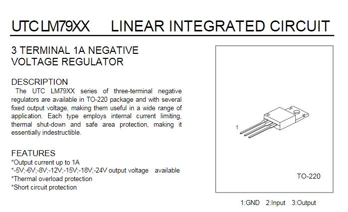

Ummm... isn't the input on a 7924 Pin 1?
While you've got your meter out maybe you could set it to measure resistance and with the power off check the solder joints by measuring from lead to lead, components that are supposed to be connected. The resistance should be under and ohm.
Bad/cold solder can be hard to identify visually but if you google it you should see some examples . But the meter should tell the tale.
Very interesting. Assuming your resistor values are correct, your R31/R33 measurement shows about 18mA current, which is consistent with your R28/R29/R25 measurements. But your R30/R32 measurements imply 320mA flowing through them.
Please verify that you have 10ohm resistors at R30-R33.
Do you have a CRC power supply upstream? If so, can you just hook up just this channel and measure the voltage across the 'R' as a sanity check and indicate what the value of R is?
If all these check out then between the parts C23/C25/C26/U2 there is a current leak. Given you comment about a hot 7924, U2 is the more probably suspect.
Edit: Please check your solder joints first as mhenschel suggested.
Edit2: Pin 1 is ground, Pin 2 is input, Pin 3 is output.

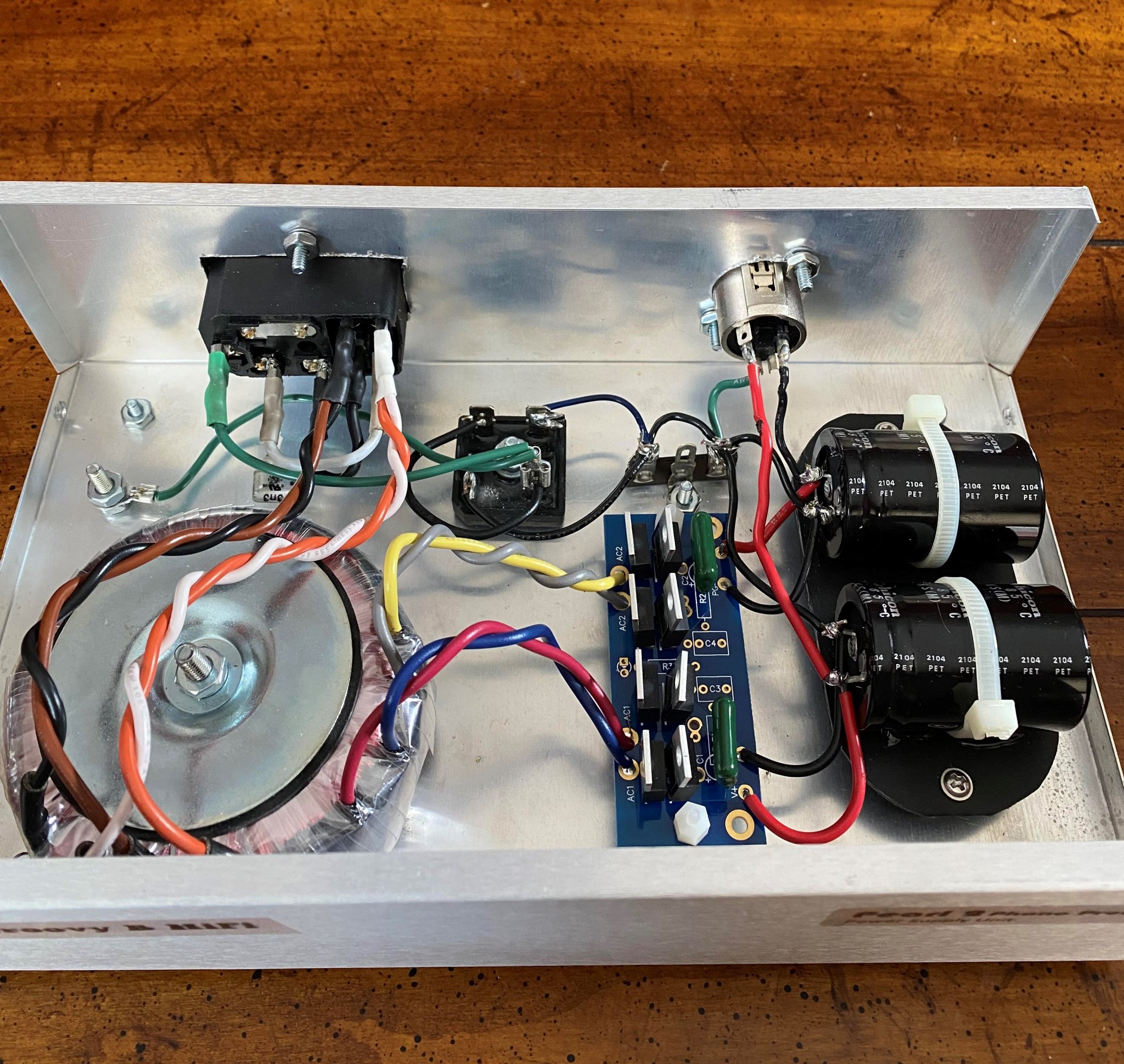

I have completed my Pearl 2 build and wanted to report on my experience. First, I want to thank those of you here who helped me out along the way. This thread is an amazing resource. I marvel at how generous people are with their time and experience.
Most of my components came from Mouser. I have attached a copy of the invoice/parts list in case anyone is interested. It is an amalgamation of the original list from the build guide, and other lists I found here and elsewhere. You will need to double check quantities, since I had some components already on hand, and ordered extra of some for use on other projects. I substituted BC550 diodes for the ZTX450 diodes in the original specs because I could not find the ZTX450s in stock anywhere. The BC550s work fine so long as you note the correct pin orientation.
I used a Hammond 1182J22 transformer that I purchased from Mouser. It has roughly the same specs as the Antek transformer referenced in 6L6's original post. It is more expensive. However, I could not find the Antek in stock anywhere. For the PSU, I used a Peter Daniel rectifier board very similar to the one used by 6L6. I ordered it here: https://audiosector.com/product/single-rectifier-pcb. The cases came from eBay. They were inexpensive as these things go (I believe I paid around $75 for the two), and I think they look just fine. The combination IEC receptacle, switch, and fuse unit came from Amazon. The knurled nut for the turntable ground came from a local hardware store.
I have only listened to my Pearl 2 for several hours so far. However, I am already extremely pleased with it. My system includes an AR XA turntable, run through a Hegel H80 integrated amplifier, and played through Frazier Concerto speakers (a weird combination of old and new). I value the Hegel's clarity and great DAC. However, it leans towards the bright (at least to my ears), especially with digital sources. The Pearl 2 provides a rich, full sound, with a big low end. It's great. I could not be more pleased.

flip69, It's great that your Pearl 2 is up and running and you are enjoying the music.
One more thought: the wire from IEC ground should go directly to the chassis connection and bolted down with a lock washer and nut. The wire from the circuit ground lift bridge can then be connected to the chassis ground on top of the safety ground wire, held in place with another lock washer and nut. The intent is that the chassis safety ground is not disturbed and remains in place regardless of other work that may be done within the chassis.
