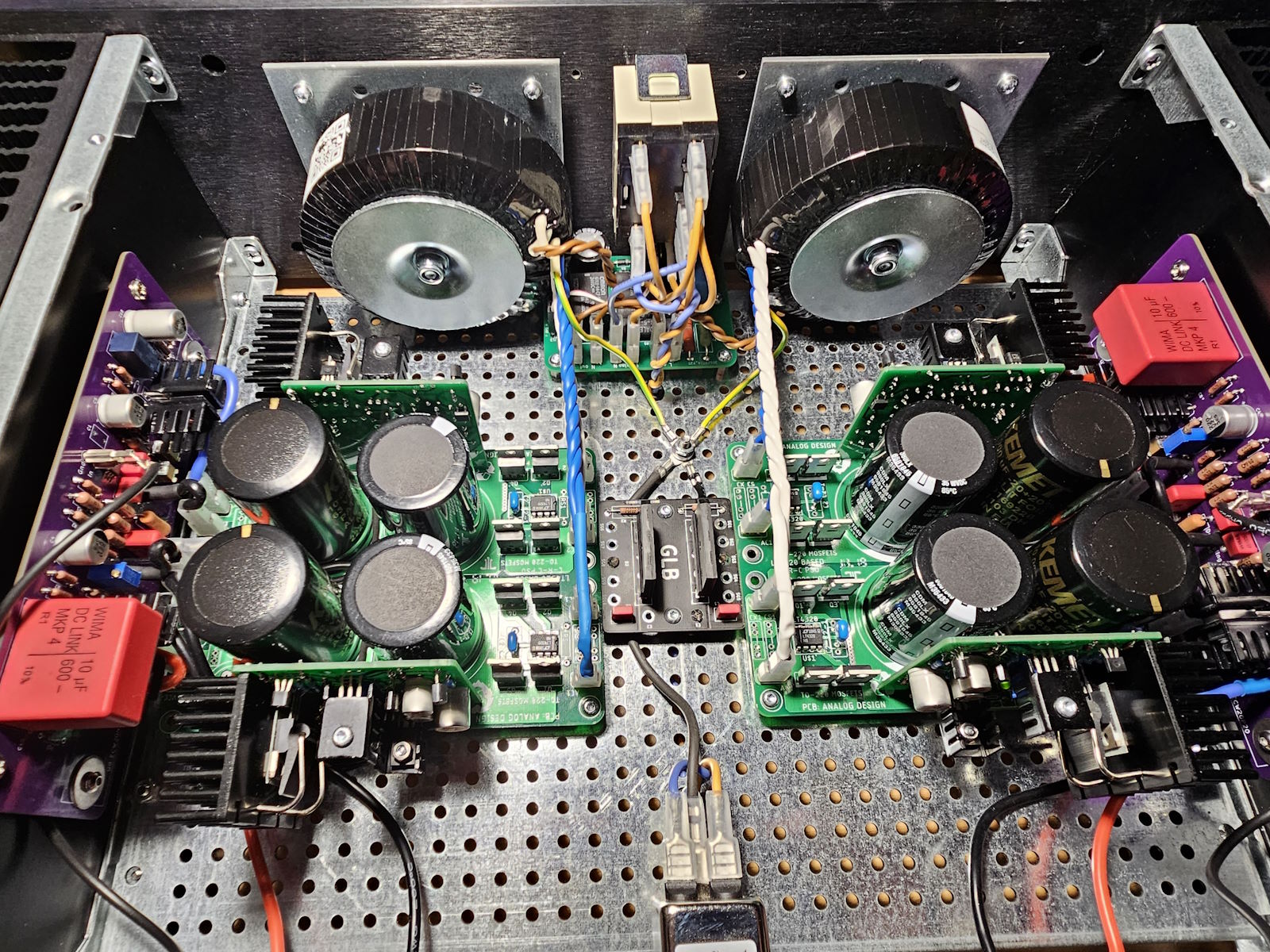

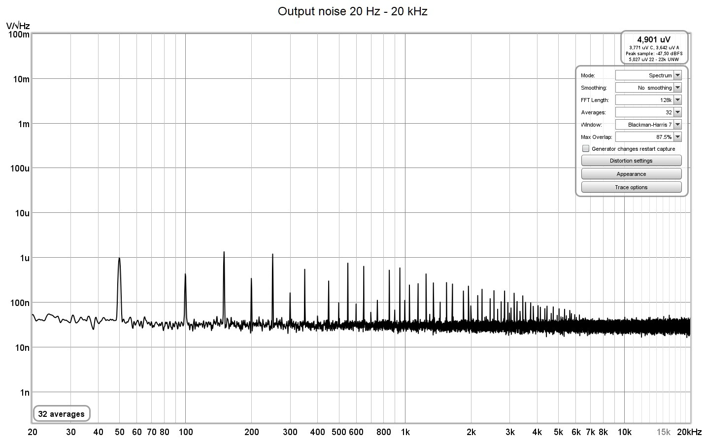

Last summer I started with OS evaluation and settled on the diamond buffer with BJT CFP output. Circuit variations were assembled on the breadboards and careful listening and measurements were performed. It was very good but not good enough. Switch to lateral MOSFETs was done, as they provide low distortion, thermal stability and monotonic steeply falling distortion harmonic profile. After satisfactory results, my preferred operational amplifier was added as a VAS stage to make amplifier circuit complete. After much more listening and measurements, final evaluation build was assembled on the PCB and listened to and measured again. All good, followed with required parts order and a lot of assembly work. Final measured results are here:
Frequency response DC to 1.3 MHz
Max. power 10W/8Ω, 20W/4Ω
Distortion:
  • 1W/8Ω 0.00005% -126 dBc
  • 8W/8Ω 0.00021 -113.5 dBc
  • 10W/8Ω 0.00024% -112 dBc
  • 1W/4Ω 0.000074 -122.6 dBc
  • 10W/4Ω 0.00035 -109.2 dBc
  • 16W/4Ω 0.0011% -99.5 dBc
  • 20W/4Ω 0.0016% -96 dBc

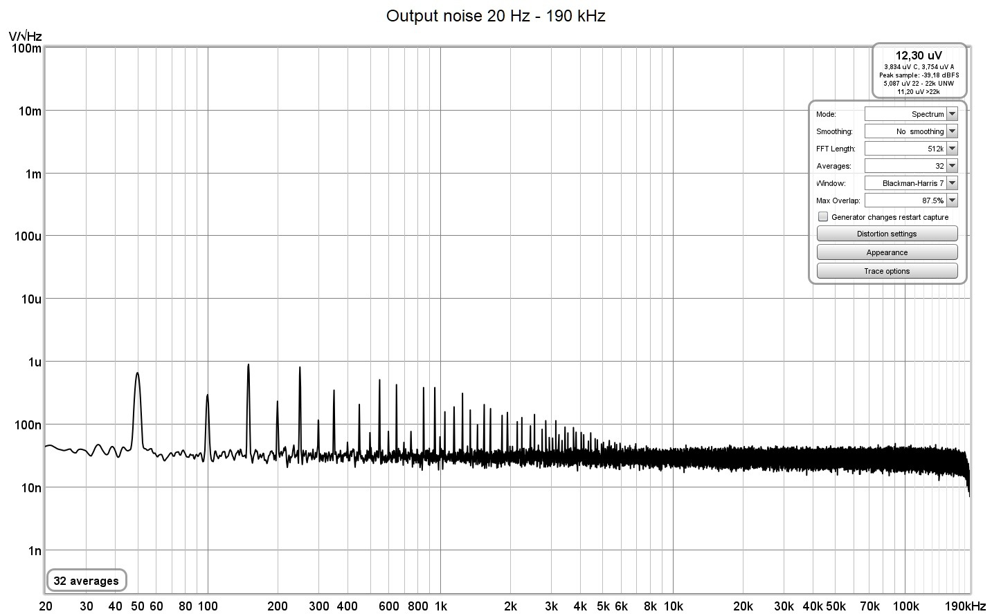

Output noise 20 Hz - 20 kHz unweighted – 4.9 uV
Damping factor 945/8Ω, flat line from 20 Hz to 20 kHz
Slew rate 86 V/us for a +- 12.5V swing (290 ns rise time)
DC offset less than 400 uV

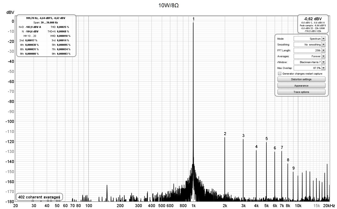

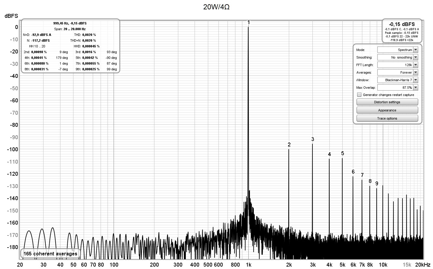

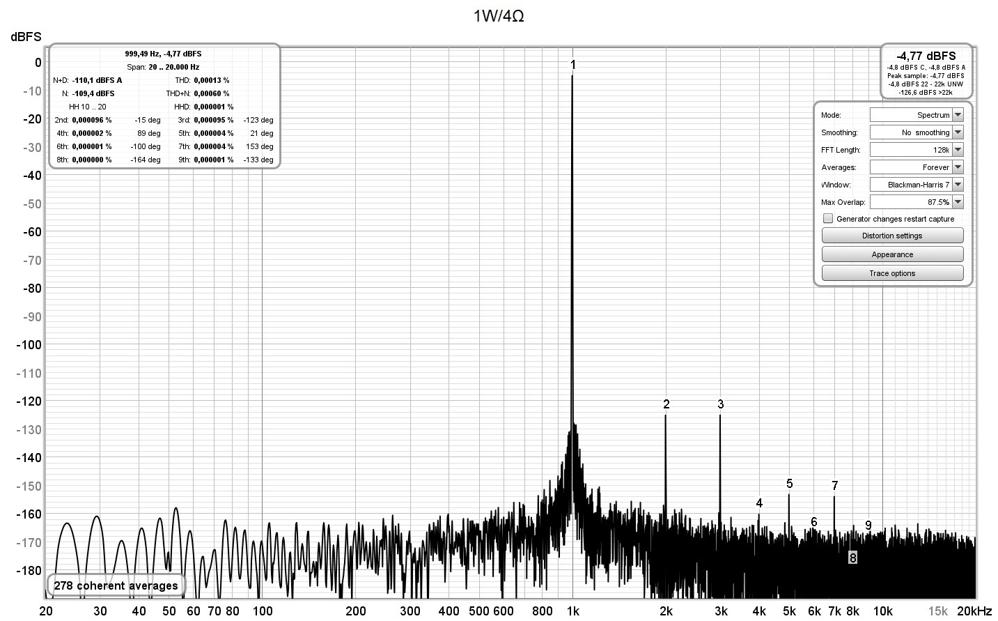

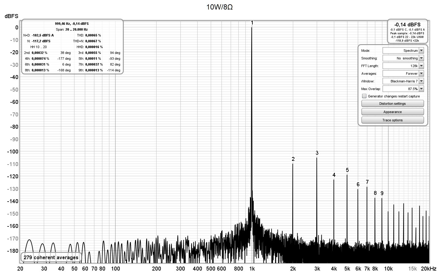

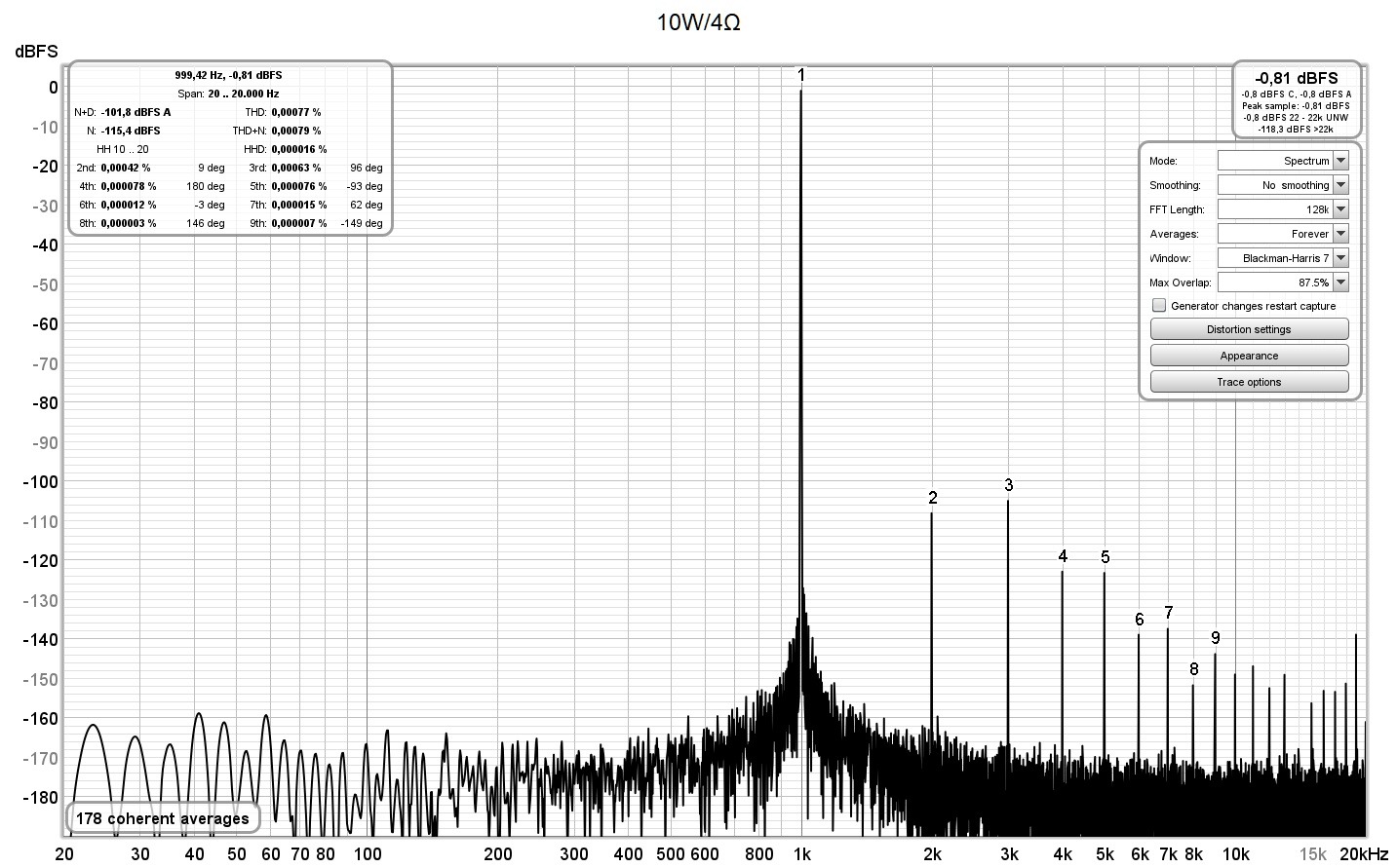

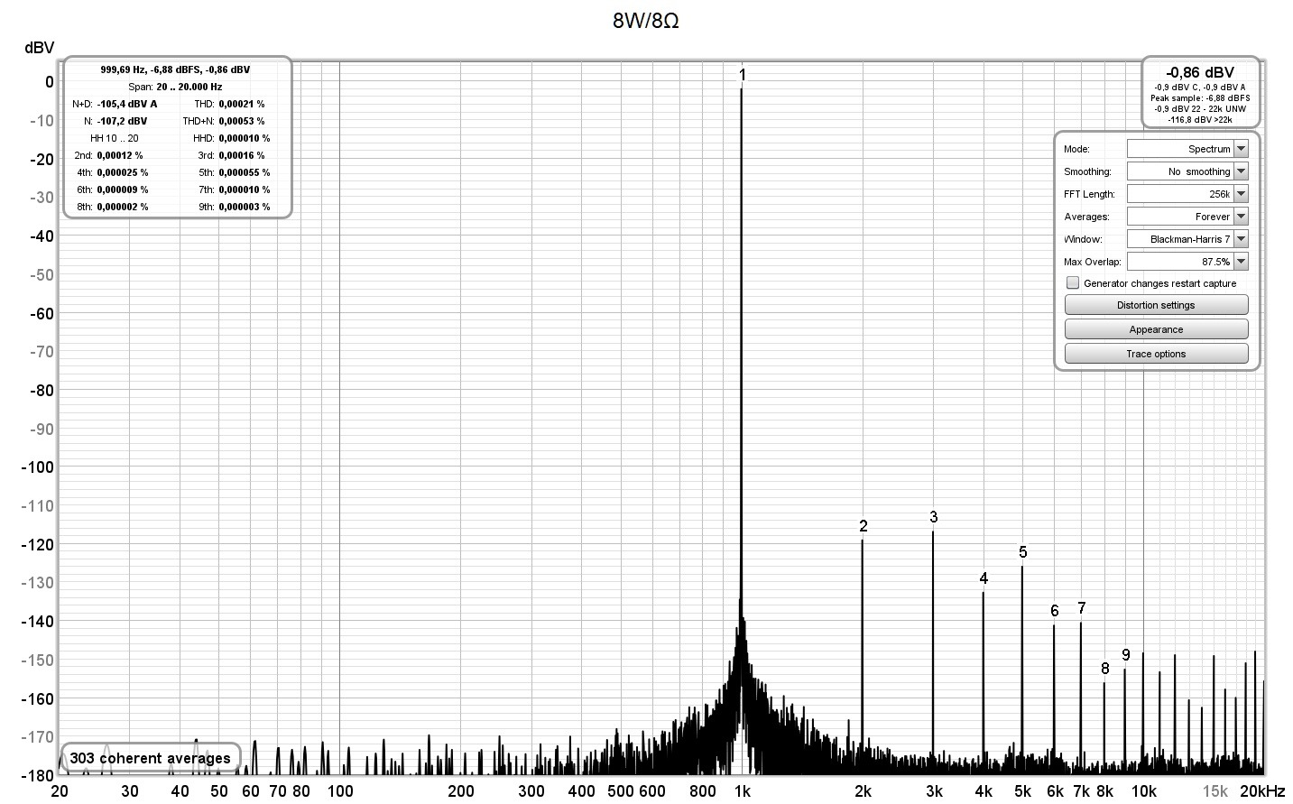

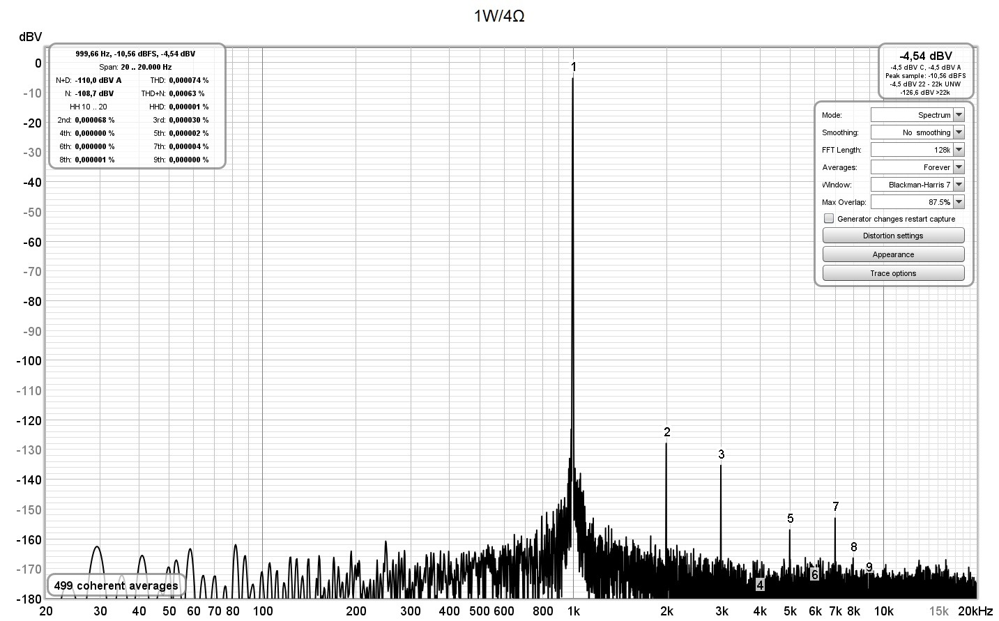

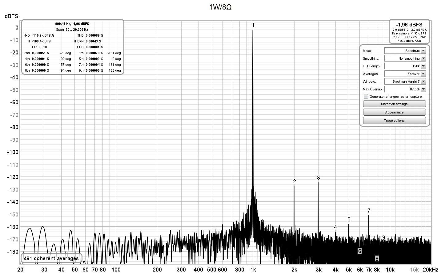

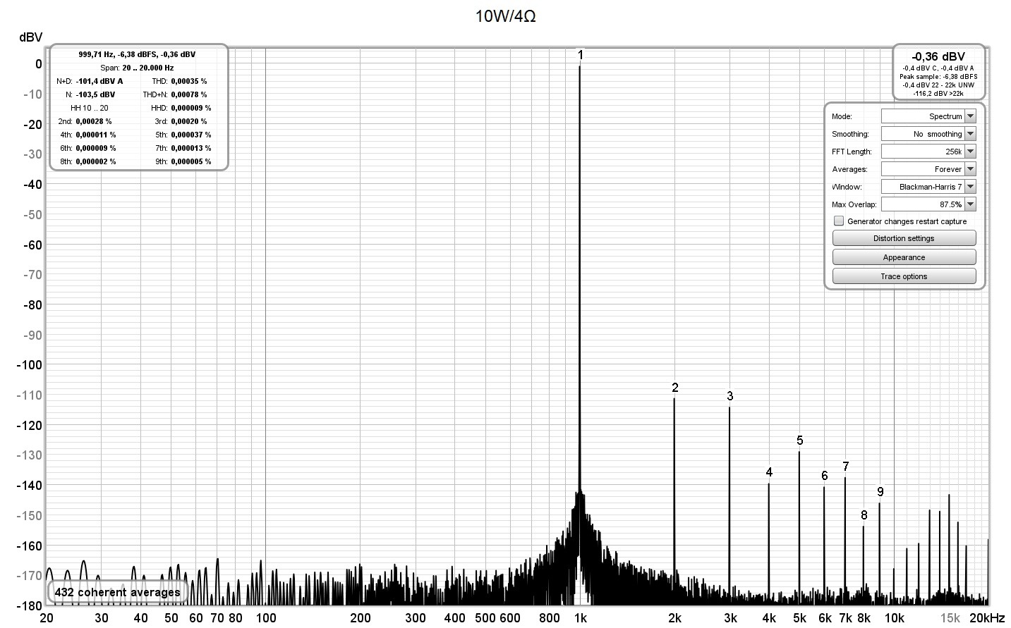

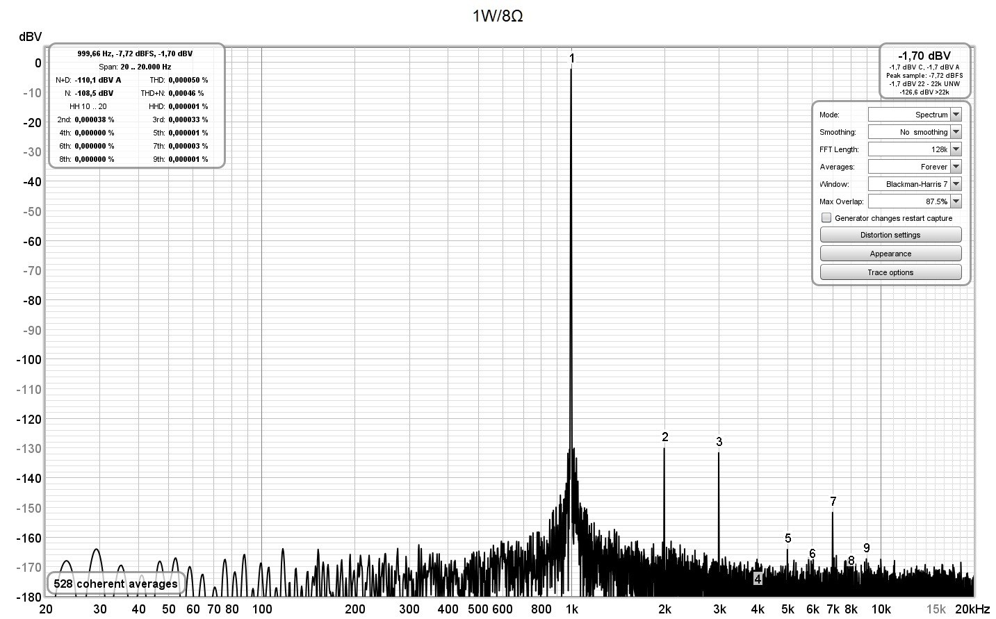

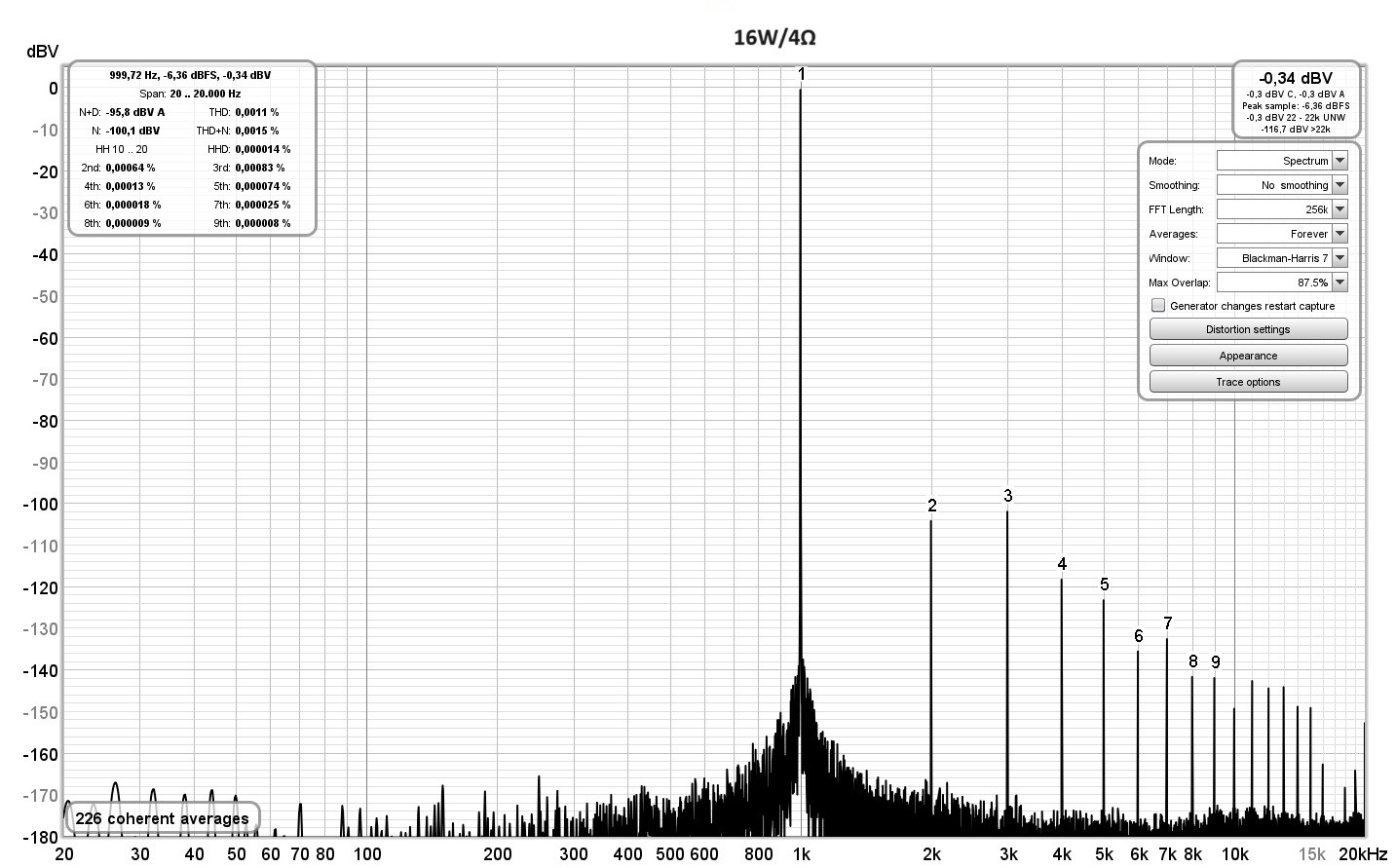

Distortion
At several watt levels, this amplifier has only very low H2 + H3 and all higher order harmonics are some 30 dB down. Low distortion is maintained up to the clipping level.

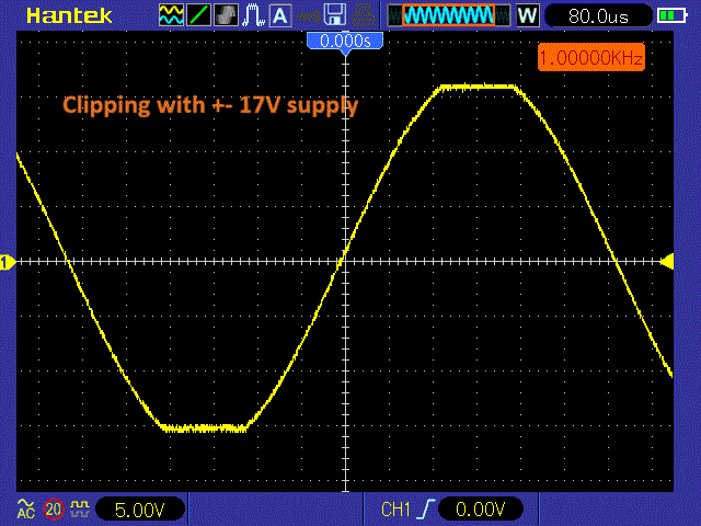

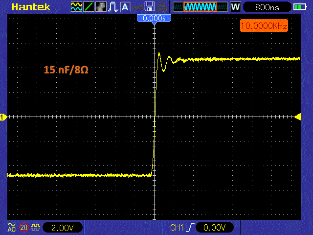

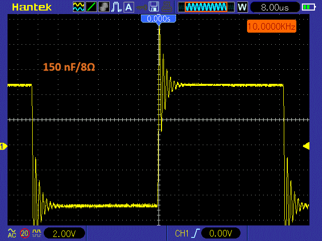

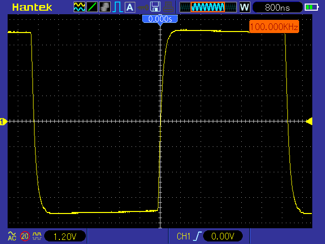

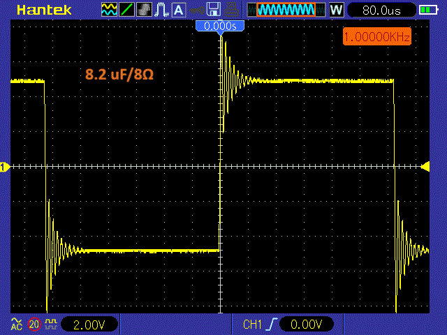

Capacitive load and clipping
Amplifier is stable with any capacitive load, from 100 pF up to any value.

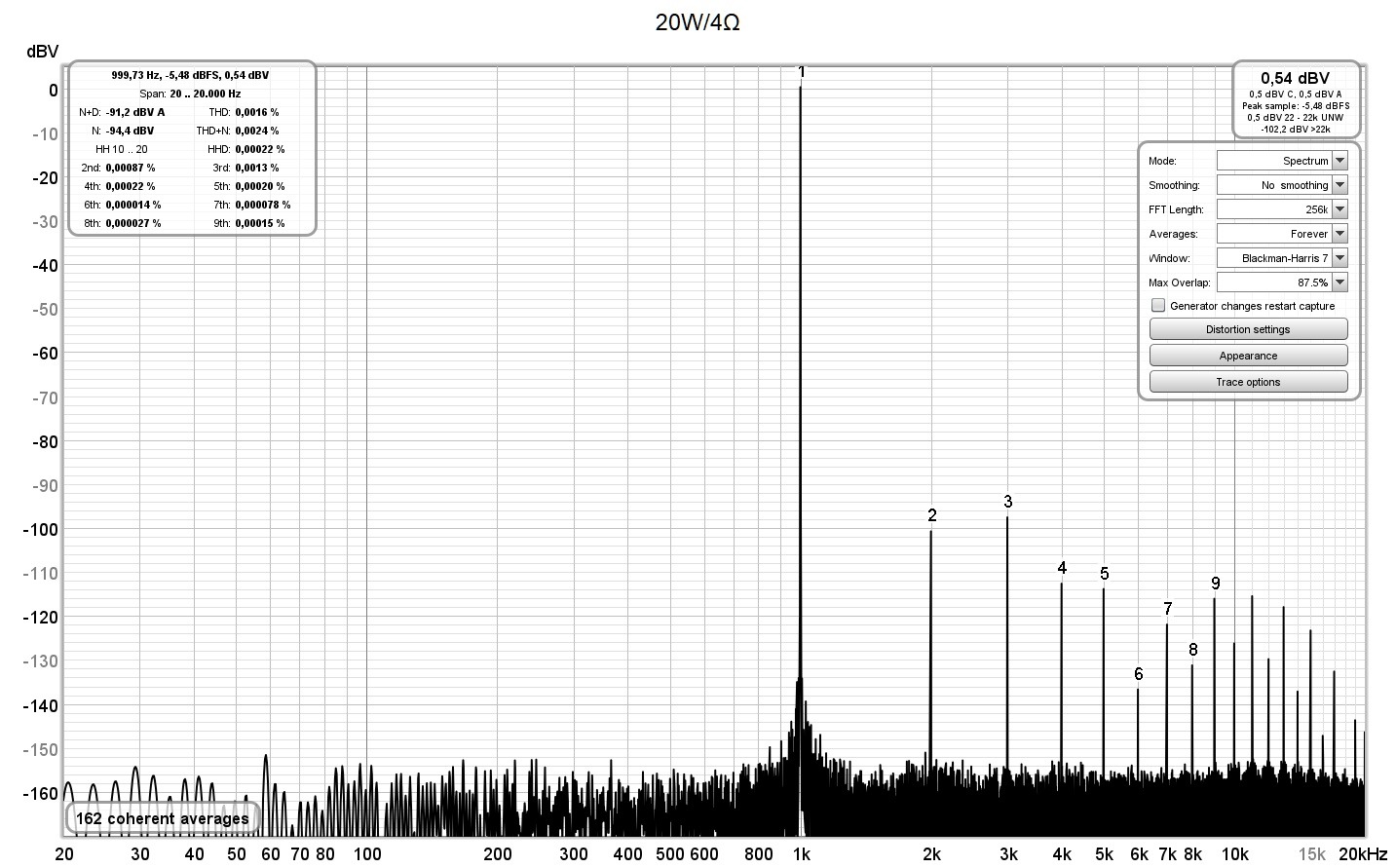

I’ve found a bug in REW software distortion measurement, that has gone unnoticed by all for a whole year after last official release. So, my distortion measurements are not correct for several dB. :mad:
Nothing major but previous numbers look nicer. Here are correct numbers (measured, checked and rechecked again, several times over).
  • 1W/8Ω 0.00009% -121 dBc
  • 10W/8Ω 0.00065% -103.7 dBc
  • 1W/4Ω 0.00013 -117 dBc
  • 10W/4Ω 0.00077% -102.3 dBc
  • 16W/4Ω 0.0014% -96.9 dBc
  • 20W/4Ω 0.002% -94 dBc

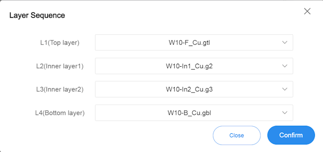

I’ve attached to first post gerber files. Format is as required by JLCPCB, where I have ordered mine, but is likely OK for most PCB production services. If ordering, check option “Specify Layer Sequence” and set values as on this picture. As this is 4-layer PCB, price is unfortunately higher. If needed, I can later add BOM in Excel format.
