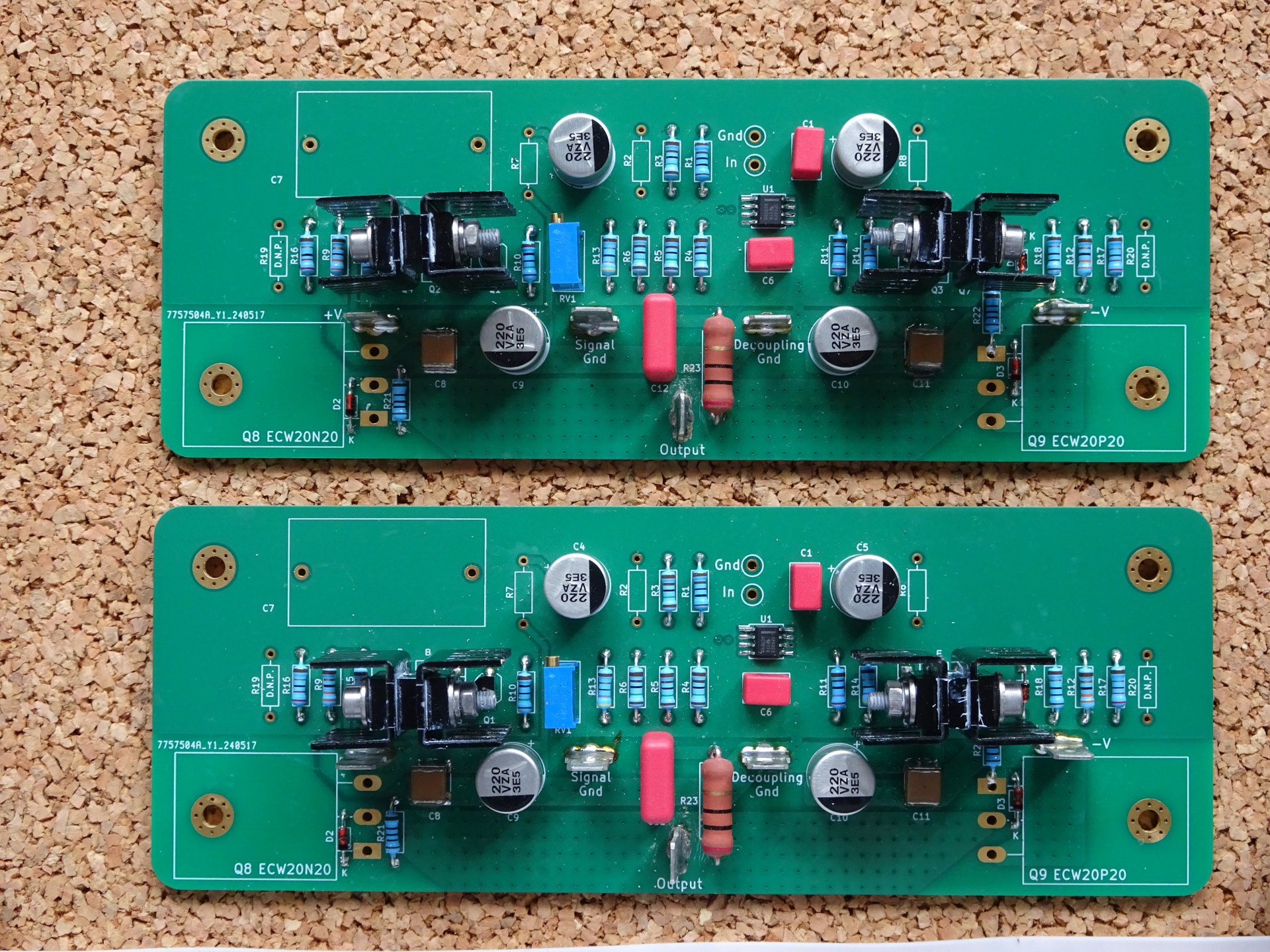

Member @mislaaav nudged me to check the TMC compensation with this amplifier, as he is working on his own version of similar design, that has a TMC compensation.

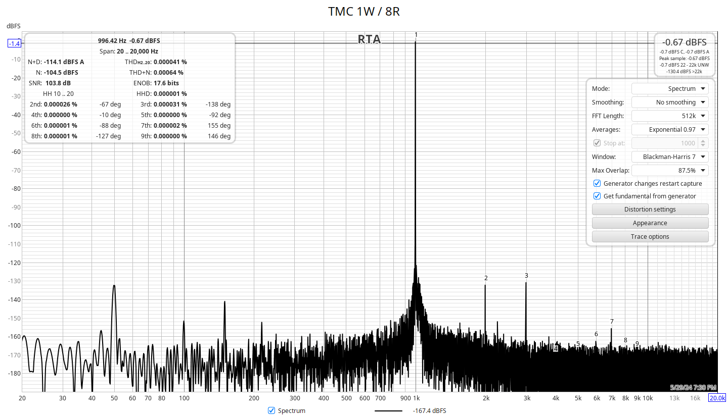

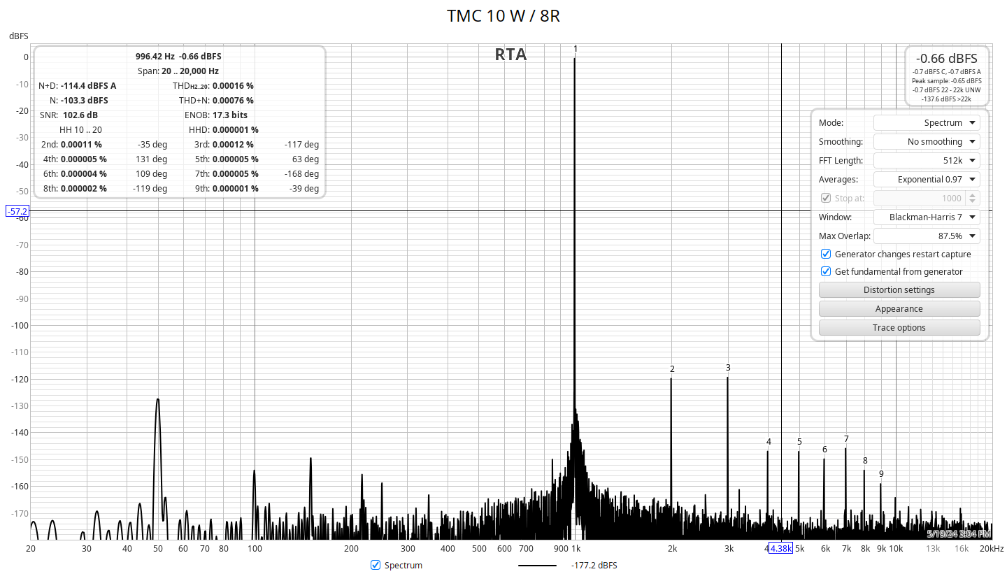

I’ve checked two pole (TPC), transitional Miller (TMC) and three pole which is a combination of TPC+TMC. Those compensation methods bring, in real circuit, some 6 – 12 db lower distortion (20 dB in simulation). For now, TMC seems the best choice as it provides the same unconditional stability as a standard Miller compensation.
Result are just a little better numbers, nothing more. Sound is, of course, exactly the same. It should be, as we are taking about distortion that is, to start with, one millionth part of the output signal.

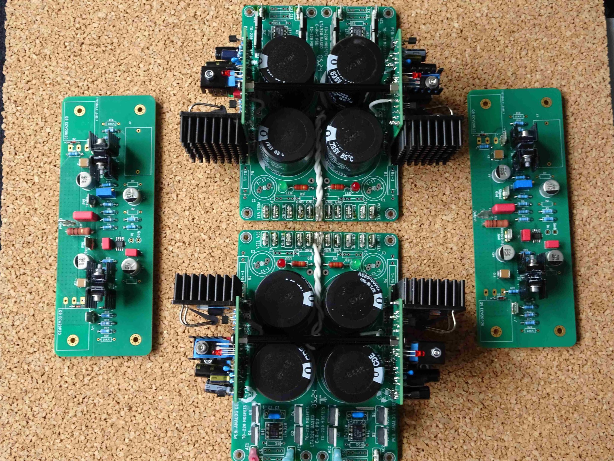

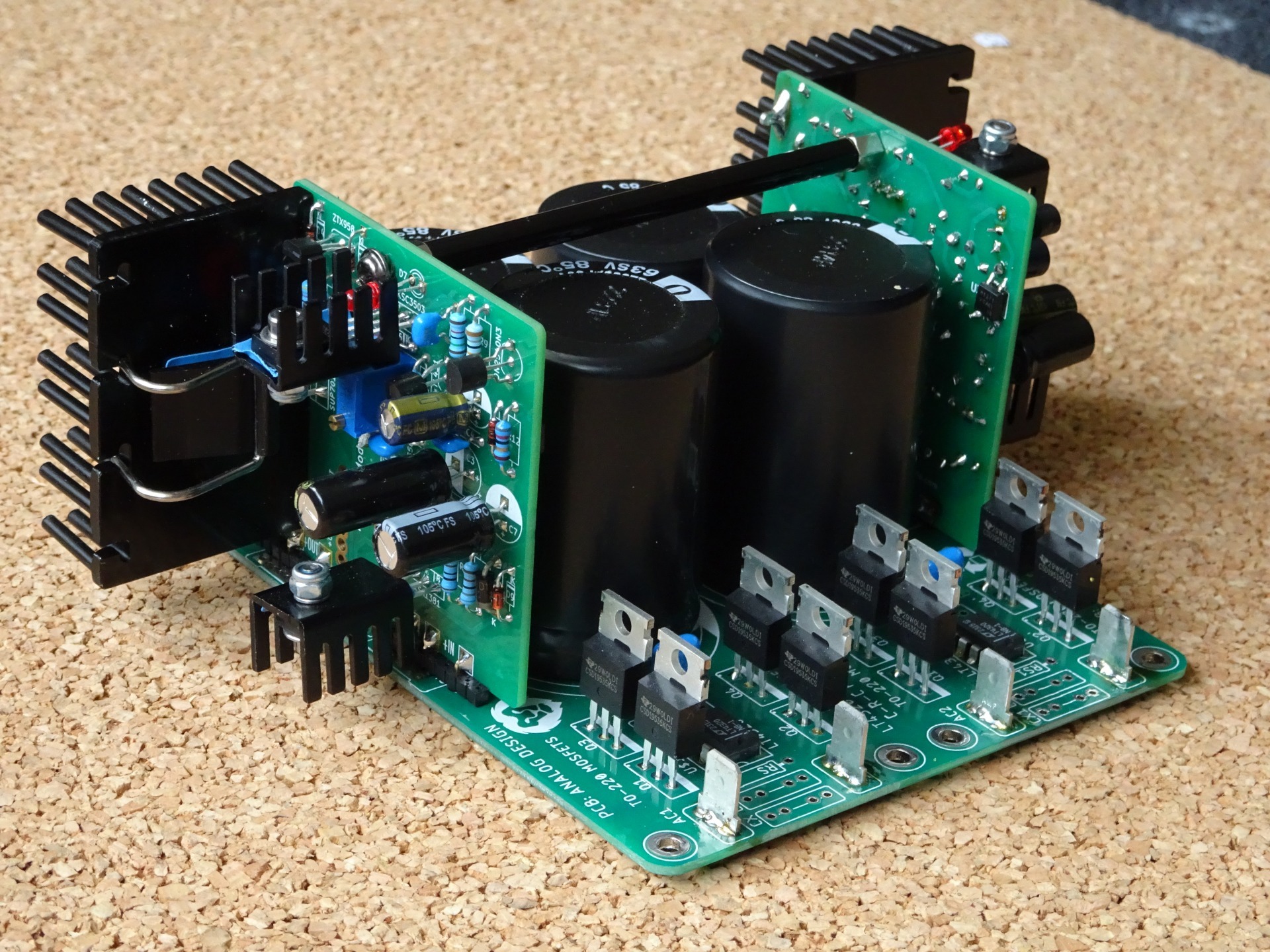

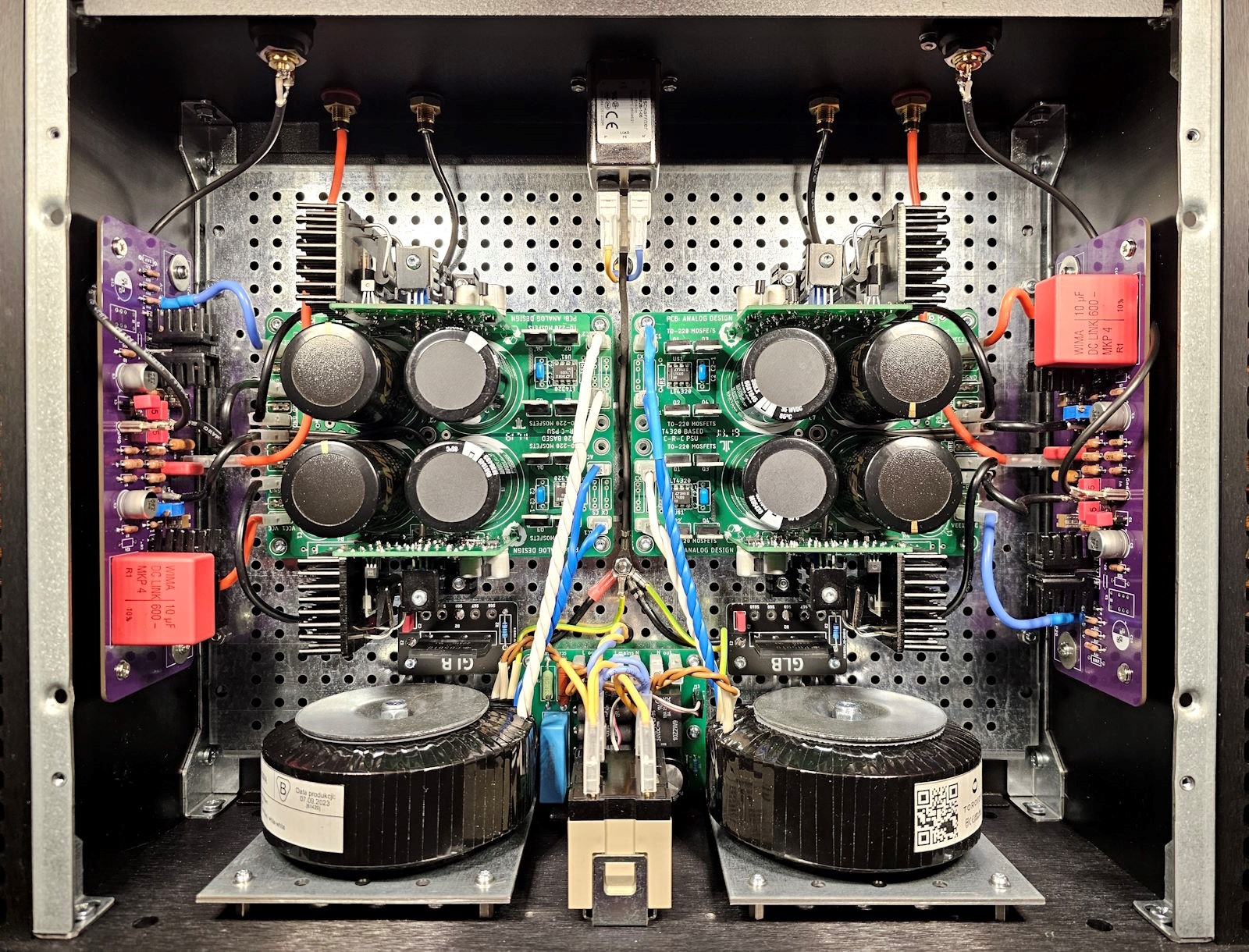

I took the chance to rearrange parts like with @cibo build.
With only 300 mm deep case, using two separate ground loop breaker circuits instead of one dual, enables better PS placement.
