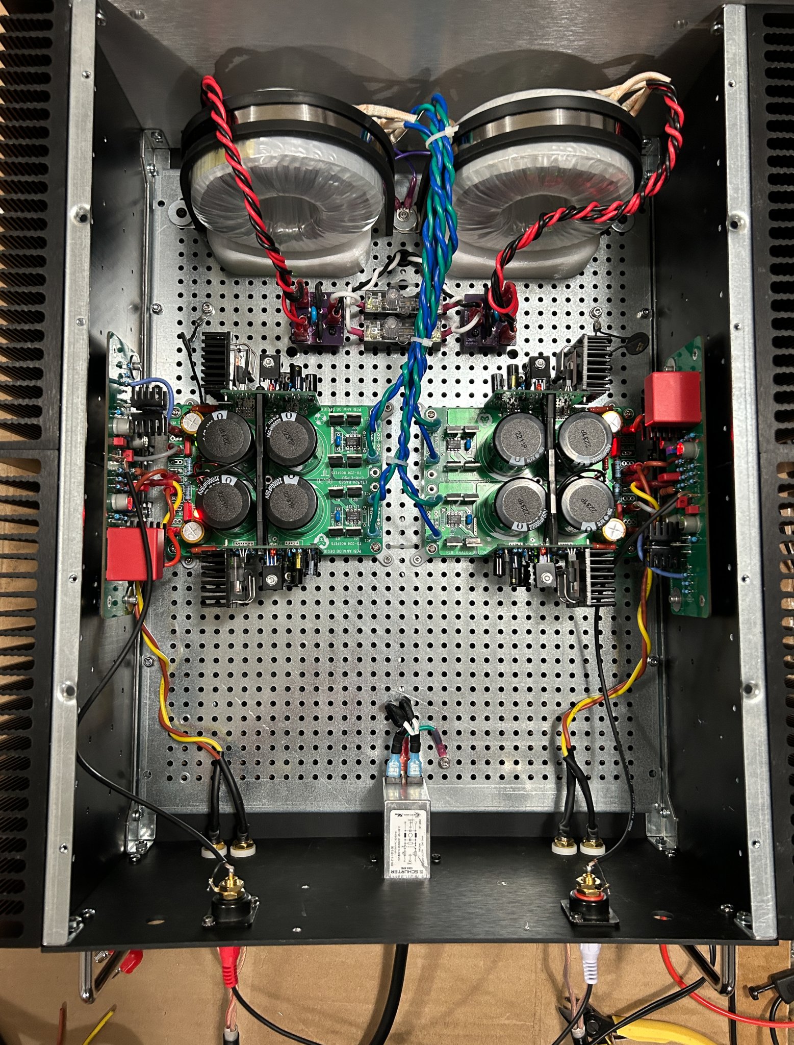

Almost ready for liftoff.PSU in the chassis... layout pretty much final and "inspired" by the origin build.
It looks to me that you are short for some ground fast-on connectors at the PS output. Signal ground from the amplifier PCB should go to that middle ground connector, between two black wires. There are decoupling ground, loudspeaker ground and PE ground (through NTC or Ground Loop Breaker circuit) remaining.
^ Thank you as always! I am still debating direct soldering some of the connections and if so, on which end and/or under the board(s). The PSU boards will come up one more time before it's all buttoned up.
I have your GBR boards on the way. In the interim, I'll probably just put in a thermistor for each channel.
I had below in my build notes for connections / GND scheme. I'm sure it came from one of your previous posts, but for some reason, I forgot to note which one in my notes.

"GND connection points.
You need 3 – 4 depending on how is safety connection to chassis made. Signal ground connection is amplifier ground reference for input signal. Connect that to physically middle positioned gnd connection at the PS board. Loudspeaker gnd should be connected next to that gnd point, not at any other point down the gnd connectors array.
Decoupling gnd should be connected next, farthest as possible from former two connections. If you have prasi’s CRC boards, connectors marked as “IN-GND” are also allowed for this.
Safety grounding, probably through NTC resistor, if not connected otherwise, can be connected to any remaining gnd connector."

@ItsAllInMyHead here is what @tombo56 suggested during my build for your reference and I used same psu board but single as yours Prasi crc one.
Decoupling L
LS gnd L
Signal ground L
Safety ground
Signal ground R
LS ground R
Decoupling R
Decoupling L
LS gnd L
Signal ground L
Safety ground
Signal ground R
LS ground R
Decoupling R

Got my bits / taps. Mounted everything up.
I am biasing each channel. Back in post #56 you mentioned below -
From a dead start with cold heatsinks - Max voltage across R17 is 168mV on one channel and 188mV on the other. I don't remember reading, and I don't have any notes on any adjustments on the amplifier boards to allow for higher bias current. If I missed it, my apologies. Those results were achieved with the pots at the end of their travel. Devices are getting very slightly warm.
Any advice is appreciated. Output devices are from Profusion. Almost there. I won't button it up b/c I don't want to unmount the amp boards with it all tidied up until I know what I can do to get the bias up to target. Rails are rock steady at +- 19V5.
Everything is looking OK with one exception. My plan was to run 1A2 bias (or up to the 1A4 limit) b/c of my 4R speakers.Bias current can be measured through voltage at R16/R17 resistors.
Those values don’t change with actual current. Lateral MOSFETs have negative temperature coefficient, and bias current will drop from cold to hot state for some 70 – 80 mA.
- 0.8 A 160 - 170 mV
- 1 A 250 - 270 mV
- 1.2 A 340 – 360 mV
Actual current depends on heatsink temperature. Lower voltage is for moderately warm heatsinks and higher is for heatsinks at 40 °C.

IAIMH,
Measure the voltage at the opamp legs or resistors R7 and R8 end towards opamp. (Pin7 P-supply, Pin4 N-supply)
Be careful not to slip with DMM probe and short adjacent legs.
If your supply is 19V5, R7 and R8 need to drop 2V to keep the little critter happy. I measured 350R to work perfectly. If you don’t have a 350R, use two resistors in series or the next higher value in your stash.
As for the bias adjustment range, I won’t be able to help there. Mine biased up to 1A no prob, left it there because my speakers are an easy 8R load.

Measured values are suspiciously close to usual minimum bias voltages.Those results were achieved with the pots at the end of their travel.
Pots are at the end of their travel, but which end? I guess, at the naturally assumed CW end, and that is minimum bias position. Adjust trimmers with CCW rotation and bias should increase.

Well, I have to laugh. Also, I am very happy that you limited the bias. Otherwise... some things may have gone up in smoke.
I made a complete hash of things...
It would have helped tremendously if I had been measuring across R17 instead of R12. No excuses, but I looked at one of my blank boards as a reference for the position to attach my probes, since I can't see very well. I just peeked at the board. Then I said to myself, attach to the 2nd resistor in from the end. I attached the probes to the 2nd resistor in from the end on my populated boards. Totally ignored that the first position isn't stuffed. SHEESH!
Sorry to waste your time. Biased up perfectly. My max on each side is actually ~318mV on one side and ~366mV on the other. I've set it to 315 cold, and it's cooking a bit now to see where it settles.
If my ballpark math works... Later, I should measure ~23W (voltage limited) into 8R and ~20W (current limited) into 4R => 10W into 2R.
That's more than sufficient for what I need.
Should have some tunes playing later today.
Thank you again for your patience and all the help! As much as I try to document everything and be as careful as possible...

Anyway, you will get some 15 W max to 8Ω and some 25 W to 4Ω in class AB.
Bias can be increased further by reducing R10 value.
