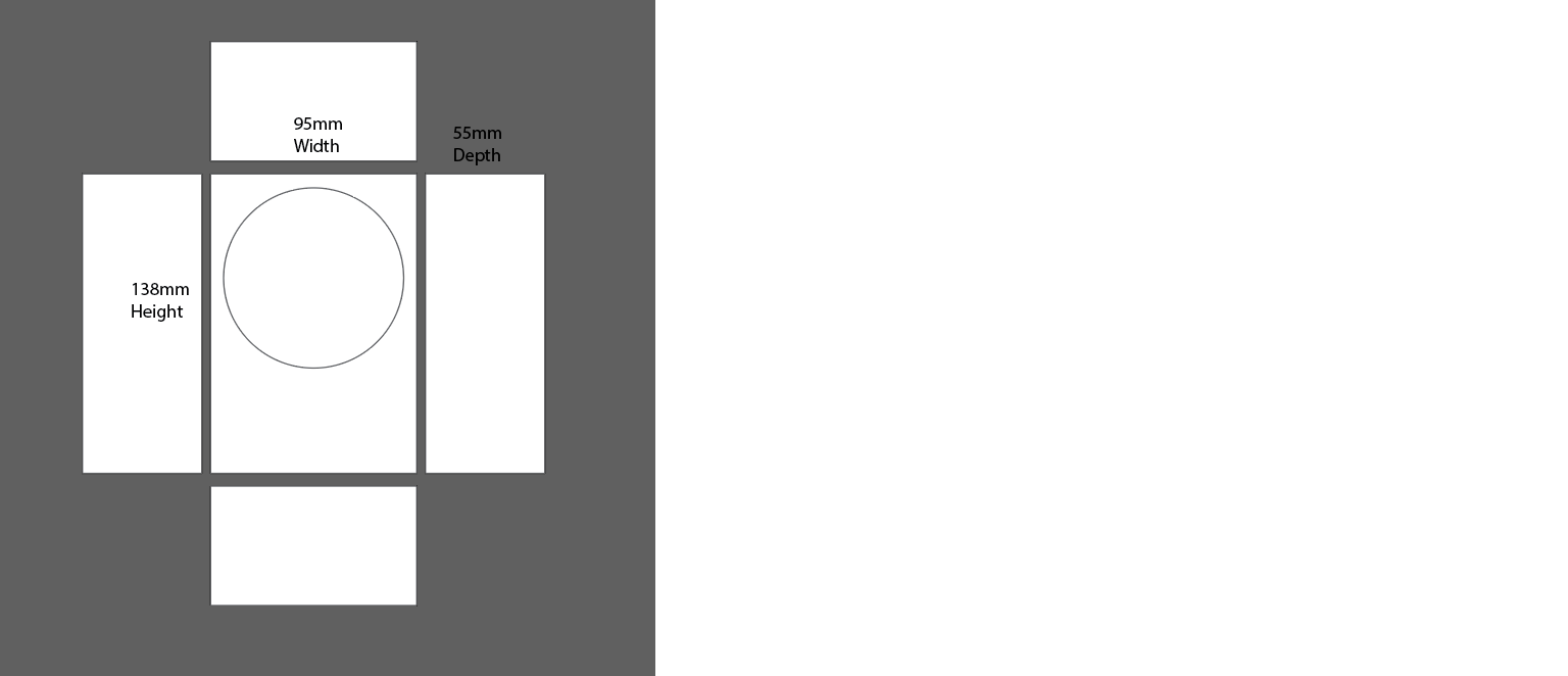

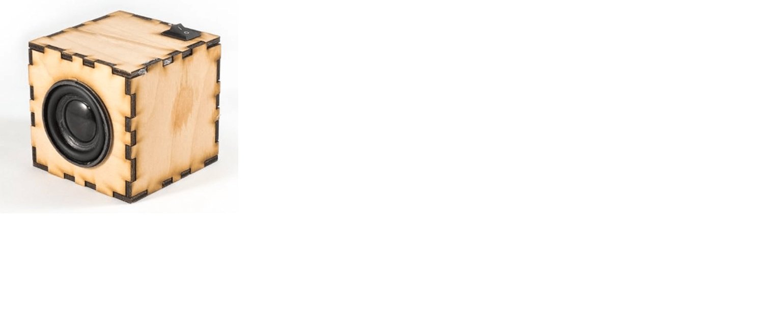

I'm working on a sound installation that will use eight of those speakers that will be placed on a floor in a art gallery.
The speakers should be as low as possible. How can I planning the wooden box? is there any rules for that?
I'm using this 4mm plywood for laser cutter for building the boxes.
I care about the esthetic of the speakers (meaning speakers must be low as possible to the floor) but the sound quality is also consideration.
Any tips?

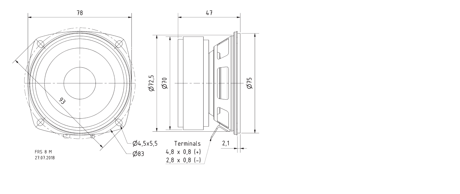

For the record, the Visaton FRS 8M is a 3.3" diameter full range driver suitable for use in "small bass reflex cabinets".
Partial technical specifications are given here: https://www.visaton.de/sites/default/files/dd_product/FRS 8 M_2001.pdf

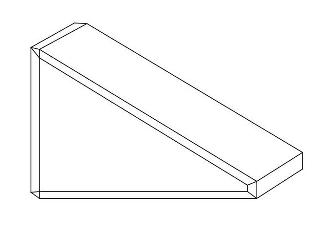

To get as "low as possible to the floor" you may like to consider floor positioned wedge shaped enclosures.
The angle would be chosen to project the sound upwards to the ears of the gallery visitors.

I was thinking of something considerably small maybe height of 13cm/15cm and width of as well 13cm/15cm . Do you think is too small?What internal volume of enclosure did you invisage? We may be able to work something out using that information.
what do you mean? I was thinking make a hole in the top of the box in the size of the speaker and connect it with screwsThe problem is how to attach it to the box, since it has a non-existent frame. Probably it's meant to be mounted from the back
I was thinking of the tightness of the thingy in terms of soundproof-ness.
I guess the basket needs to be glued onto the baffle.

Richard Ellis has kindly supplied an appropriate internal cabinet volume for this driver (3.5 litres).
Simply adjust the cabinet dimensions to arrive at that internal volume.a
I would avoid a cube shape for best audio results.
Richard has also given the reflex port dimensions to match.
You don't have to be perfectly exact with the dimensions.
Job done, I would say!

I saw an installation that had speaker boxes on the floor and they angled the speakers down at 45 degs. Imagine a rectangle but with a 45 deg cut at one end and then put the box down on its smallest face. The advantage is also that it gives good protection. Happy holidays.
Terrible scribble, and the floor was very reflective.
I don't think I understand. Sorry. what is that required bass reflex port?47 mm is not the driver mounting hole diameter, it is the diameter of the required bass reflex port.
If the floor is hard and reflective I dont think it makes much difference but the speaker is more protected.Isn't it better the speaker angled towards the ceiling rather the floor?
