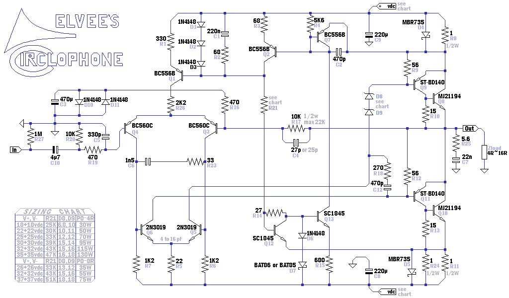

Circlophone is a new topology (a more efficient Class A, dynamic class AA), with a live sound character and an easy build. These are fun!
The Original, optimized Circlophone
The Germanium Circlophone
Inverted Jfet Circlophone
Sample schematic:

Parts options
♦ Q9, Q11 Driver: KSA1220, 2SA1930, 2SA1837, 2SA968, 2SB649, Philips/Harris BD140, and ST's BD140.
♦ Q5, Q6 VAS (cob 4pF~16pF): 2SC5171, 2N3019, 2SC3421, 2N1893, MosFet; Or if < 5pf like 2SC2911, BF819, add this cap.
♦ Q12, Q13 Sensor: BC546B on 25+25vdc rails,:att'n: With higher voltage use KSC1845, 2SC1845, 2SC2240, 2SC2705 or 2N5551.
♦ Q4, Q3 Input: A Philips/NXP BC556B (post 7) is on the original, or nicely HFE matched BC556C or BC560C with a multimeter.
♦ Q8, Q10 Output: MJE3055, BD249C, MJ802, MJL21194, MJW21196, MJ21194, MJ15022, MJ15024, MJ15003 or the classics.
♦ D4, D5: Low voltage drop and high current handling is important, like 5a, 7a (MBR735), 10a (MBR1035) Shottky diodes.

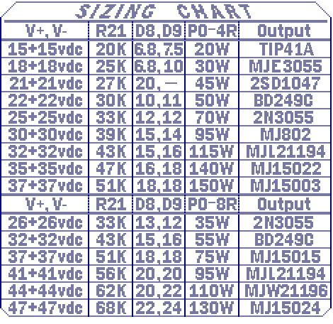

♦ D8, D9: see convenient sizing chart.
♦ D7: BAT type "Signal Schottky" like a BAT86, BAS86, BAT85 or BAT54, available at Mouser & RS. Or there is an alternative.
♦ R21: "The value in KΩ ~ = 0.9 times the total AC supply" Or review Elvee's selection guide. Or, see convenient sizing chart.

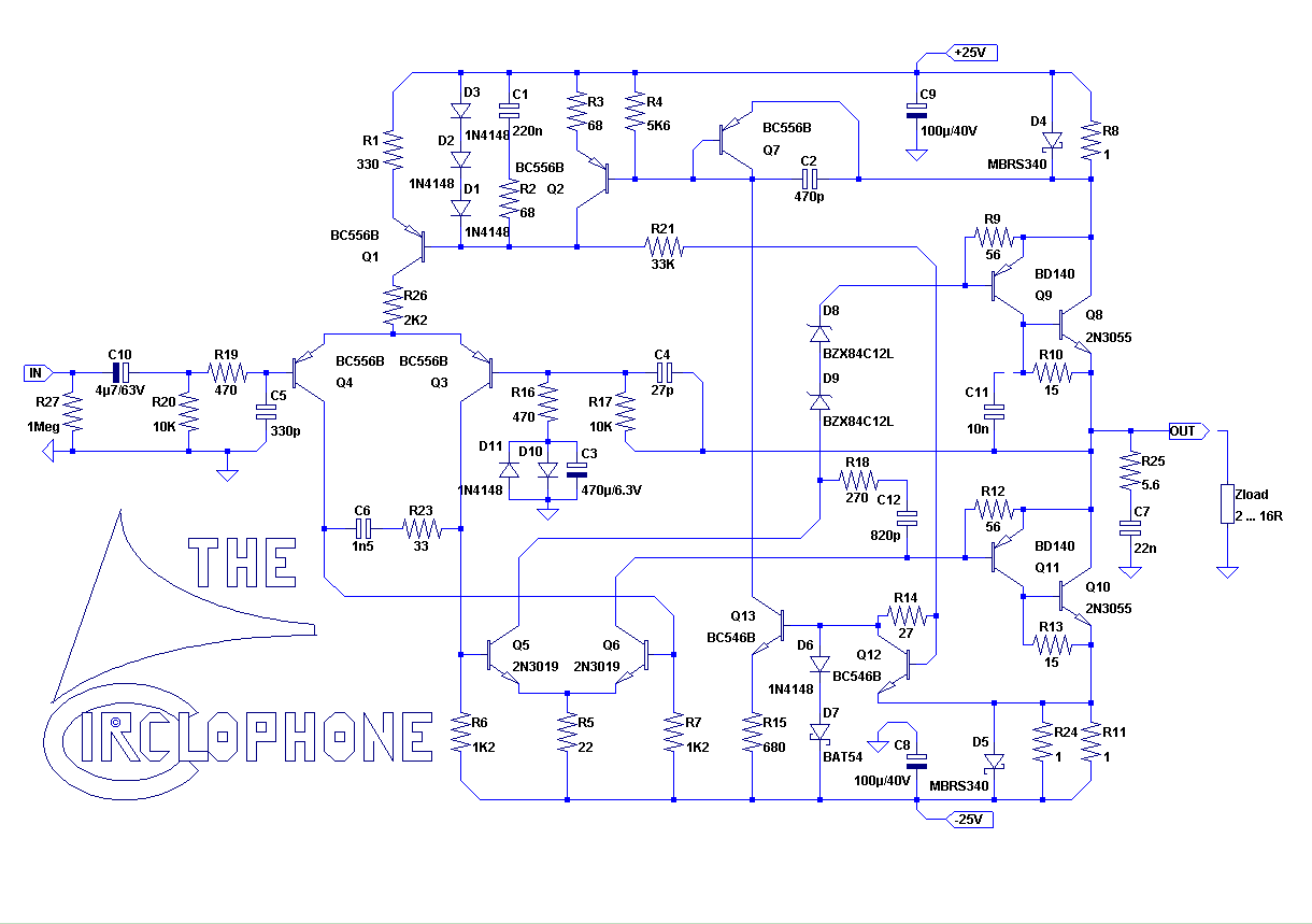

♦ Discussion of topology and modifications: Circlophone discussion thread

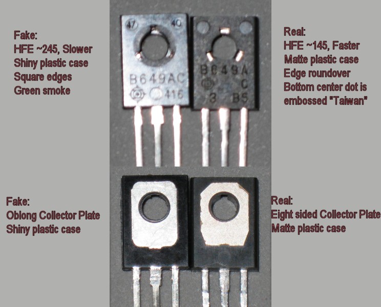

♦ Various brands of 2N5551, 2N5401: Quality Control--check the HFE
♦ Various brands of 2SB649, Quality Control: Click Here
♦ If using faster output devices, click here and install C11.
♦ Other parts selection questions? Here is a link to Elvee's build notes.
♦ Checking R21, Elvee said: "Measure the voltage, divide by the resistor value, if it's 1.5mA +/-50%, it's OK"
♦ While you're measuring, it is also easy to check the idle current.
♦ Elvee's LTSpice Circlophone simulation file for the original Circophone.

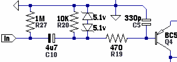

♦ A Jfet buffer isn't mandatory but if you want one for constant input impedance, click here.

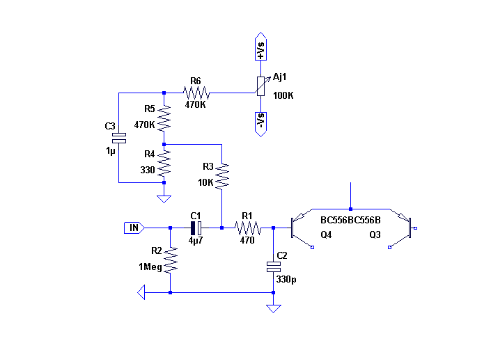

♦ To solve offset bounce versus power issues, Elvee has published an optional offset trimmer circuit.

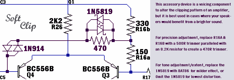

♦ Circlophone has Class A sound but if your sound is too mellow there's compensation in the LTP soft clipper.
♦ If you have efficient speakers in combination with big gain for big dynamics, you might want a limiter to stop x-max.
♦ Circlophone has very simple power supply requirements so regulated is unnecessary, but if you wanted regulated click here.
♦ To block thumps from single rail sources (computer) power up, and block some RF too since it is slightly capacitive, look at this.

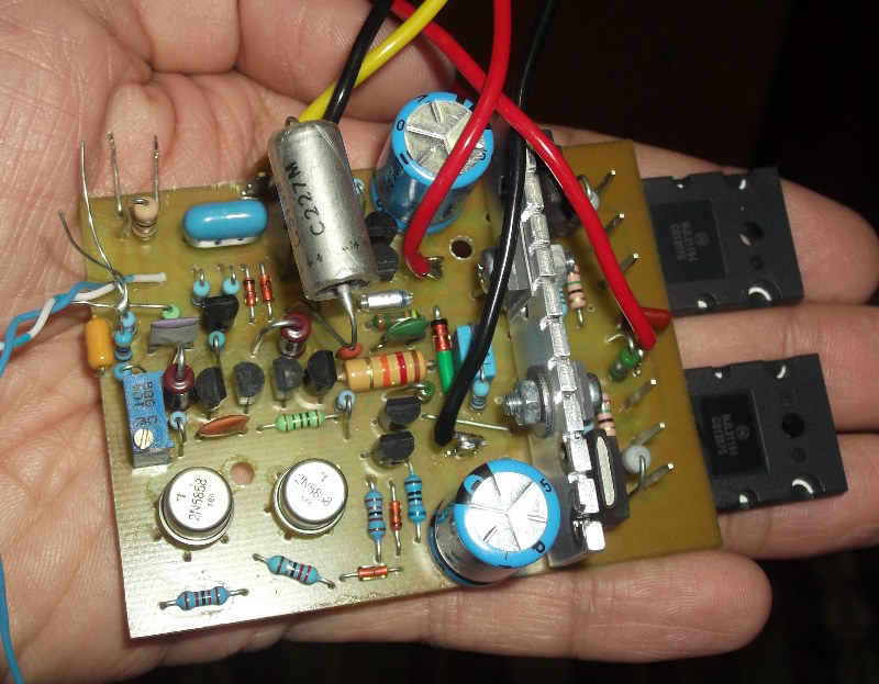

This is my latest prototype build prior finalizing CFP pcb layout. That axial metal case is a military spec tantalum capacitor used as feedback capacitor installed very casual way. You may see, TO220 schottkies have insulated with heat shrinkable tubing. This build carries BC556B/BC546B's and 2n5551's as small signal transistors, 2N5858 as bias servo, Philips BD140 as drivers, MJL21194 as power transistors.
I used a legendary Iskra 12K 1/2W resistor as feedback. Gain ratio kept as 12K/560R respecting original setting.

2SB649 Matte finish, Curve edges, 8 sided collector plate, authentic

This is my latest prototype build prior finalizing CFP pcb layout. That axial metal case is a military spec tantalum capacitor used as feedback capacitor installed very casual way. You may see, TO220 schottkies have insulated with heat shrinkable tubing. This build carries BC556B/BC546B's and 2n5551's as small signal transistors, 2N5858 as bias servo, Philips BD140 as drivers, MJL21194 as power transistors. I used a legendary Iskra 12K 1/2W resistor as feedback. Gain ratio kept as 12K/560R respecting original setting.
275257d1333485884-building-elvees-circlophone-documentation-parts-accessories-beginner-friendly-circlo-proto-pcb.jpg
Wow, that's compact! It looks great. Have you heard it play yet? I was wondering if it is RF resistant like your other boards?
