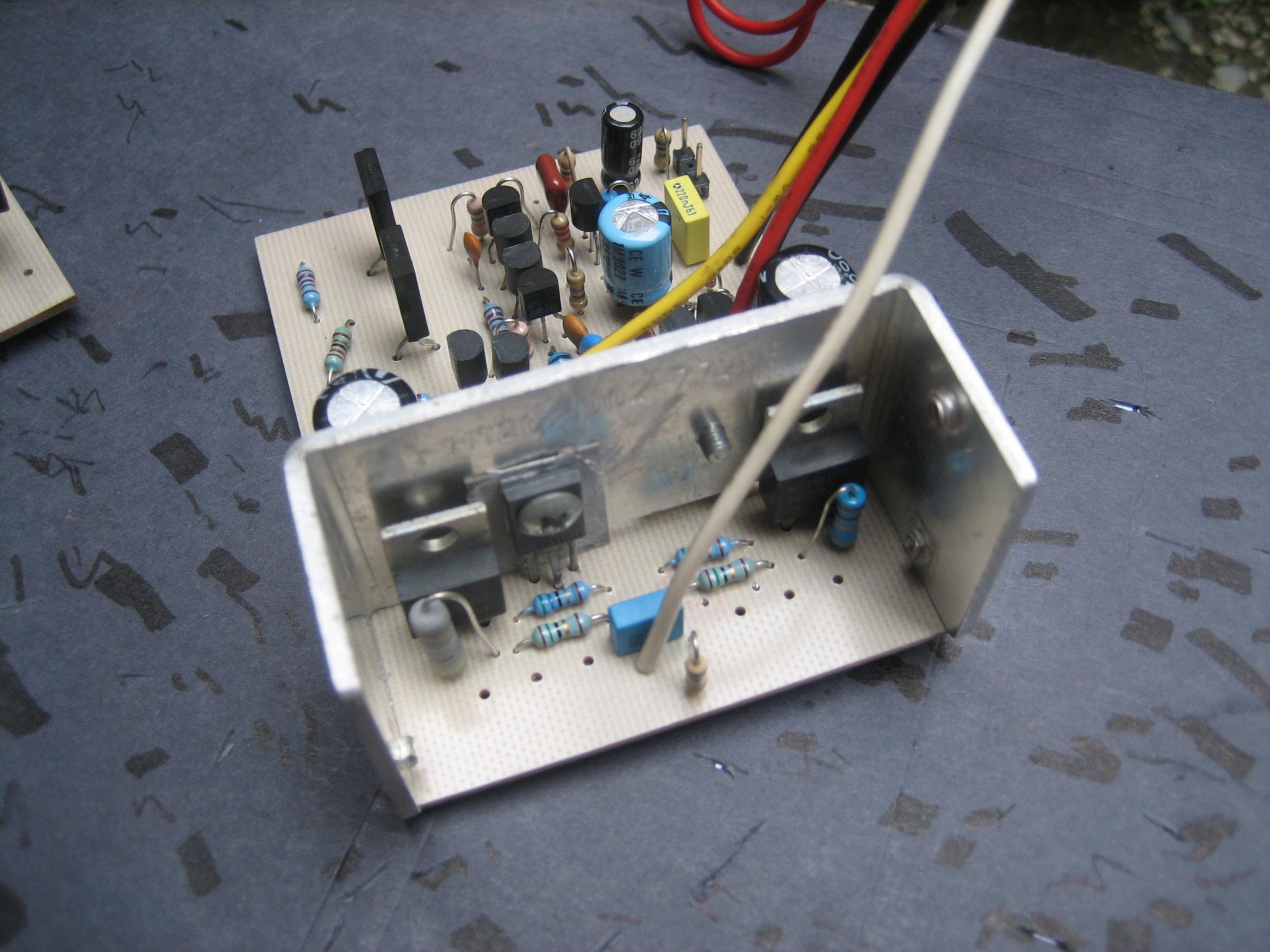

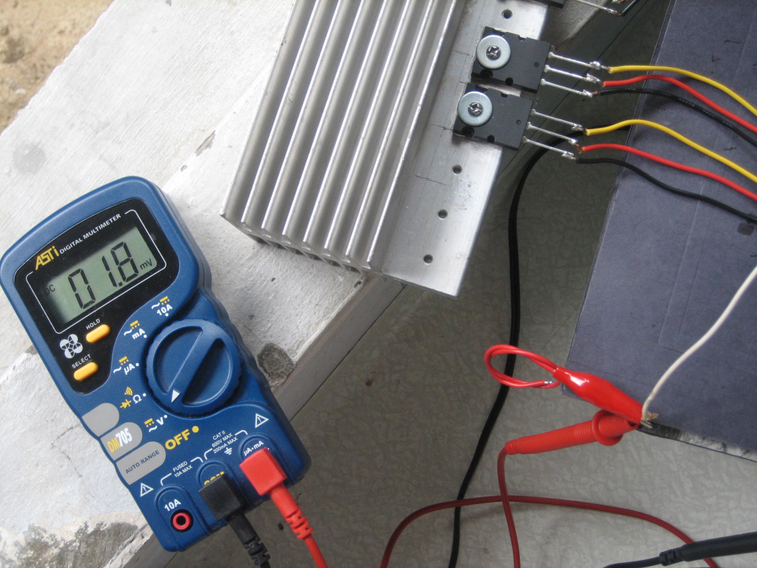

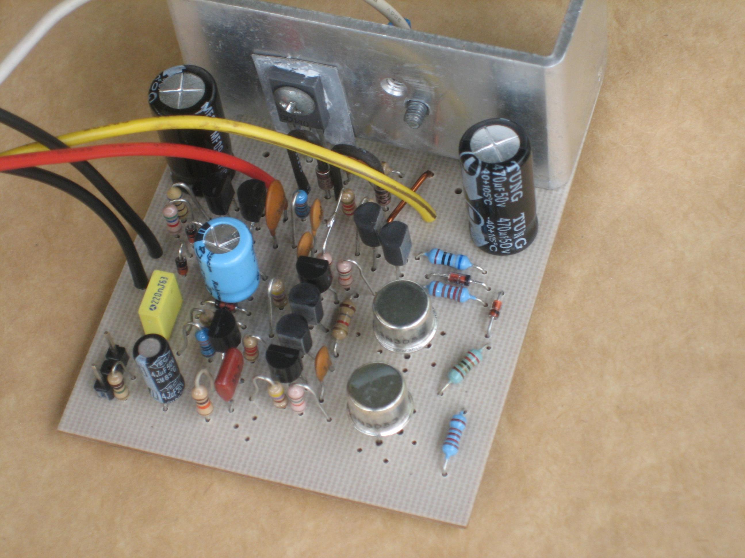

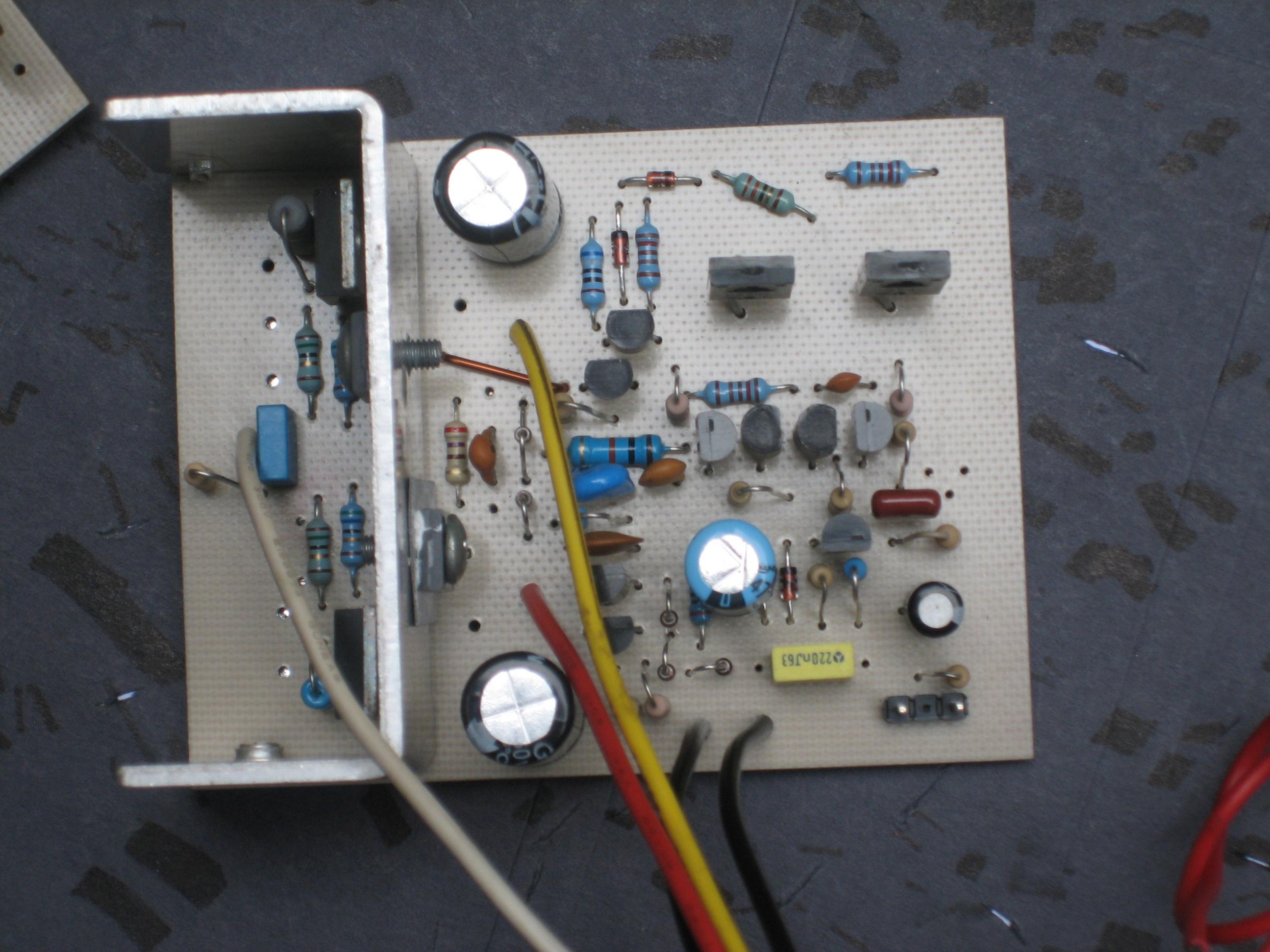

After replacing parts and following terranigmas correction (terranigma has a keen eye on spotting details (eagle eyes!..:D) Here's my build so far, DC-offset measured at 01.8mv but the lowest was 00.6mv...:bigeyes: but at times changing and the highest was about 02.00mv. At + rail collector voltage was at 21vdc and at - rail base & emitter voltage was at 21vdc. At phase-splitter I replaced the 2N5551 with BC547 but they seem to be fine none got shorted...hmm..strange though :scratch1: I decided to replace the 12v zeners for 0.5watts just to confirm if the 1 watter zeners was also creating problems. VAS trannie warms a bit after about 20mins but BD drivers are getting hot even with the heatsink around I think they won't survive. I used 2SC5200 for the output (they remain cold to touch) I think I'm sensing bias problems, can the 10k offset be increased? Could the 2SC5200 creates the problem?
Now I may have to ask a noob question did I measure the output voltages right? and how do I properly measure the idle current, sorry I am not so familiar with quasi's. Was it across R10 & R56? :scratch2:

I've updated post #1 with the means to check the idle current (it is located in with the resistors).

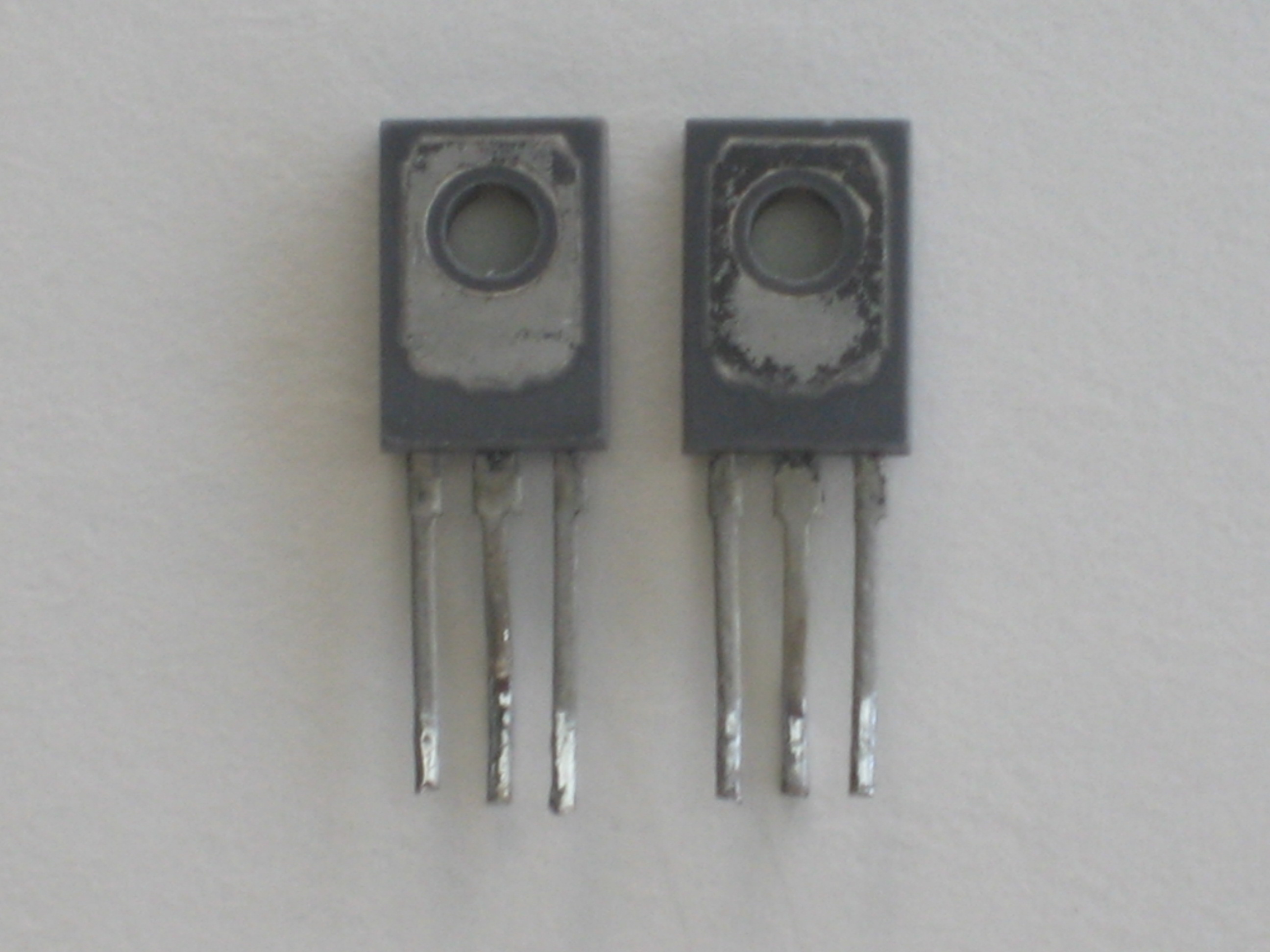

Did you use a gray Philips BD139 (COB=6pF) for Q5 Q6? Surely those will work better than fake Hitachi devices and don't expect any sort of reasonable results or temperatures until you remove the fake devices. Why not start out with 2N3019's or 2N1893's for Q5, Q6 to absolutely assure that this section is working as expected?
Are you testing with output devices connected? I ask because you will need some outputs prior to power up, else the amp will overheat quickly. I got some BD911 and some MJE3055 for smoke tests. If no smoke then I can put on the MJL21194's later.
The MBR735's need shoulder washers and thermal pads if you want to mount them onto the heatsink--the PCB is arranged that way to help hold the heatsink stable. The authentic Philips BD140's have those soft copper leads and those need the added help to hold up the driver heatsink.

Good to see measure healthy offset values. That heatsink looks very fit and nice! It means that you can connect a test speaker and begin to play some music. I see you are using wires for easy testing power transistors. I suggest you to keep those wires short as much as possible.

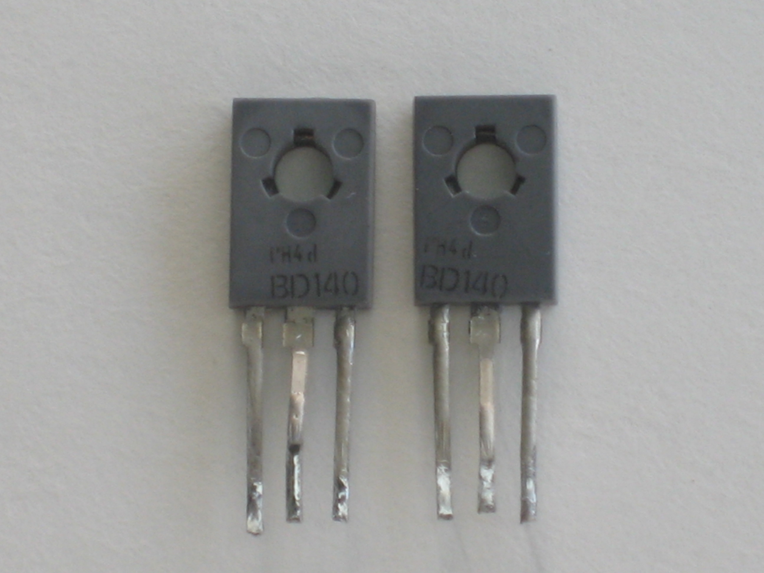

Are you sure that BD140's won't survive? That's right, they are getting hot but it wouldn't be a problem if temperature stood still for enough amount of running time. Those stain on metal plates at BD140's should be removed due to sufficient heat transfer.
As I mentioned earlier, I suggest you to use slower device for output. You can't be sure that 2sc5200 is causing a problem or not if you don't observe output with oscilloscope. For example, 3mhz BD249C's are very suitable transistors for circlophone. I tested Bourns brand of BD249C (they were made in Philippines) and their sonic behaviour was outstanding.

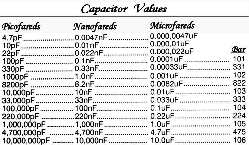

According to Elvee's latest experiments, low pass filter capacitor's value is 8.2 nF. See the C4's value of 3rd picture at related post.

Q9, Q11: Yes, Philips BD140's that have been corroding since 1987 need some black sandpaper (like 600 grit, very fine grain) to "lap" the thermal interface surface and shine it up, thus removing most of the corrosion. Then they do need some thermal paste (and pads). Thermal paste, such as Arctic, will prevent future corrosion.
Q5, Q6: If TO126 size (Philips BD139, Toshiba 2SC3421) are used at Q5, Q6, they might be more comfortable with some little heatsinks, such that free aluminum circle from the bottom of the beer can or some TO126/TO220 economy size little heatsinks, or even some recycled metal will do. Huge heatsinks aren't required at Q5, Q6, but plastic devices need some means to get the heat out of them. The exception is 2SC5171 since it is a physically large TO220, doesn't need a heatsink at Q5, Q6.
That is perfectly normal for discrete devices: it is equivalent to less than 1°C difference between transistors, and random variations caused by draughts for example reach easily that level.
The quiescent dissipation in the drivers is ~1W, and increase with signal, so nothing abnormal.
If you have doubts about the 2SC5200, try a slower device, TIP3055 or BD249.
About the low pass capacitor, I advise against actually using 8.2nF: it was meant as an illustration with a test signal, but for actual use, such a high value could cause excessive roll-off if the source impedance is much larger than 470 ohm.
Anyway, normal audio signals do not contain 10ns maximum amplitude edges.
Nope, I don't have it at hand, 2N3019 is currently out of stock, I might as well check on the BD139 they are complement to BD140.
Yes, I actually did a quick test without the outputs, BD140 gets hot real fast.
Thanks, I got them from a discarded PC PSU I was surprised to see that it was exactly the same width with the board.
I always do this when testing my build, for convenience saves time and when something when wrong with the output it won't damage other parts and the PCB as well..;)
Well, I am not exactly so sure about the maximum heat dissipation of the device but I think but for longer hours of use, they cannot hold on.
As I mentioned earlier, I suggest you to use slower device for output. I tested Bourns brand of BD249C (they were made in Philippines) and their sonic behaviour was outstanding.
I will see if I can find those BD249C here, I do know however that semiconductors manufactured here is hard to obtain. They are being exported to other countries

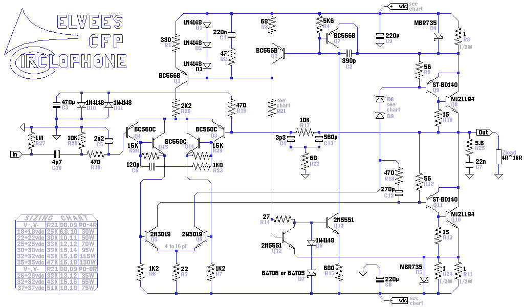

I'm working on a clear CFP Circlophone schematic.
Good to hear that, this is going to be a lot of help! :)

It looks like I'm in big trouble right now, I just worked on my amp again and following the latest mod according with Daniels CFP Schematic here's what the amp say's..:D
Idle current, measured across R8/R11= 0.12ma :whacko:
DC offset = 30.0mv when measured at AC = 15.0v:h_ache:
I've lost two 5.6 ohms resistor at Zobel network, they instantly went up in smoke right at power on. I am now using D1047C for the output and they heat-up fast.
I used 2N5053 for VAS 'found them at one local supplier and the specs was very close to 2N2219 but I don't think the amps having problems at VAS. Drivers and VAS are less warmer, better than my previous set-up using D669A. I have tried to dissect the whole thing but after finding a few parts with no signs of fault I gave up.
All help will be appreciated!
The link yes, I double-check that with Sir Elvees' correction,.. looks OK to me.
Actually I'm saving my spare parts for the official circlophone (to date, according to Elvee) I plan to use AlexMMs lay-out. I just can't give-up on the CFP....anyway..
Here's the revised amp..
