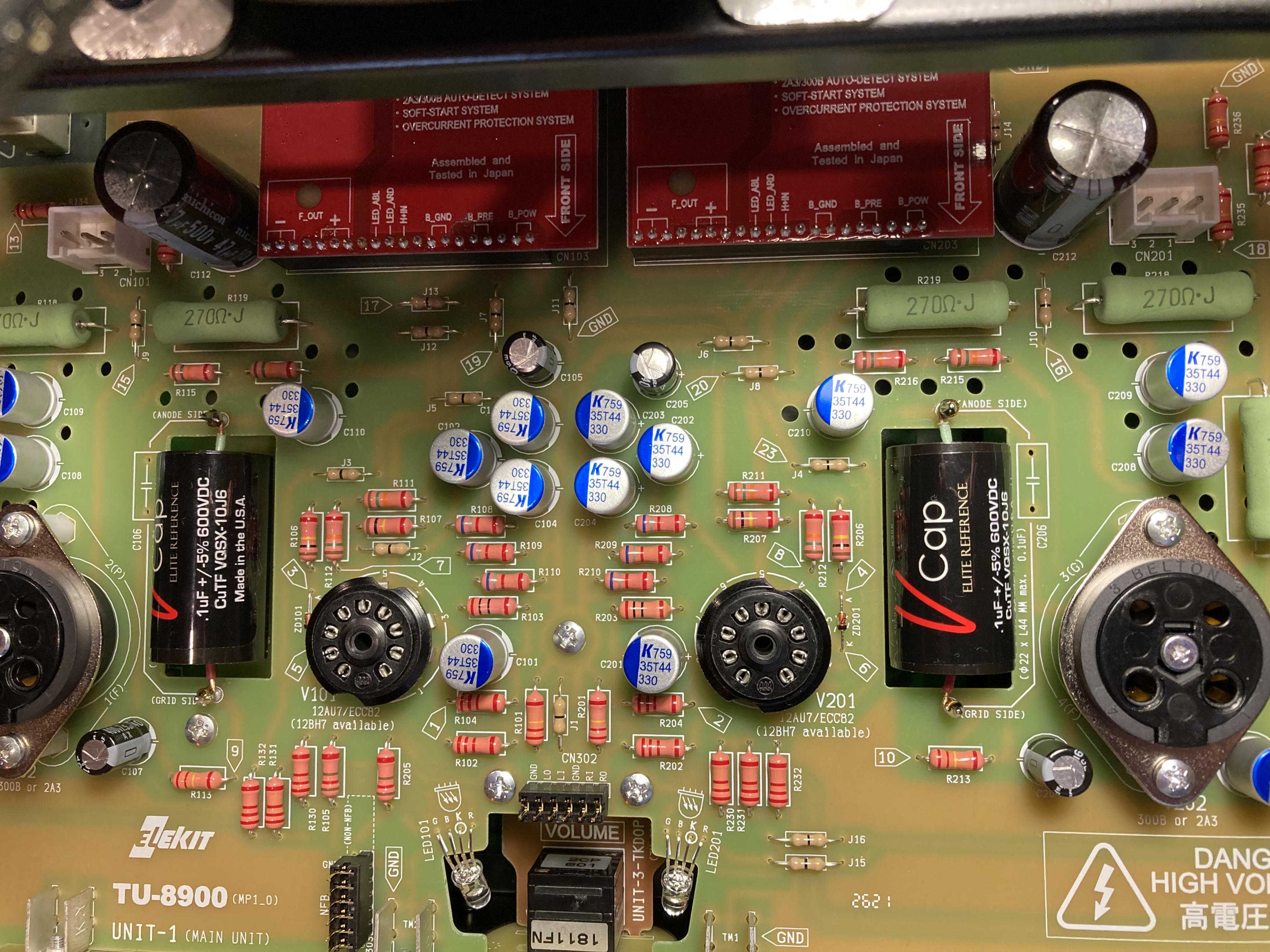

I too am having a brain fart. Do I have the v-cap
installed correctly? Outer foil facing anode. Is this right?
I’ve confused myself.
Green is the outer foil which should be closest to ground, and should be connected to "grid side"
The outer foil should be connected to the lower impedance node of the two.
In this case, that is the plate.

I’m still confused as to which is best direction for vcap install? I was thinking that the anode of the 12bh7 is the lowest impedance path to ground. Maybe there is some difference of opinion on this. Vcap website says that the green side is the outer foil.
The input side of the cap sees the plate and the plate resistor in parallel.
The output side sees the grid resistor (which is much larger).
So the outer foil goes to the plate.
A high impedance circuit node is more sensitive to noise pickup, and the outer foil
(when driven by a lower impedance) helps to shield it.

PT 7, 8 is innermost foil (the V Cap logo side)
The green lead indicates the outermost foil # 9, 10
V-Cap Audio Capacitor Installation Notes
The stock resistor of TU-8600S is a low grade resistor that is why I offer Takman upgrade.
If you have question about your installation, please look at page 26.
