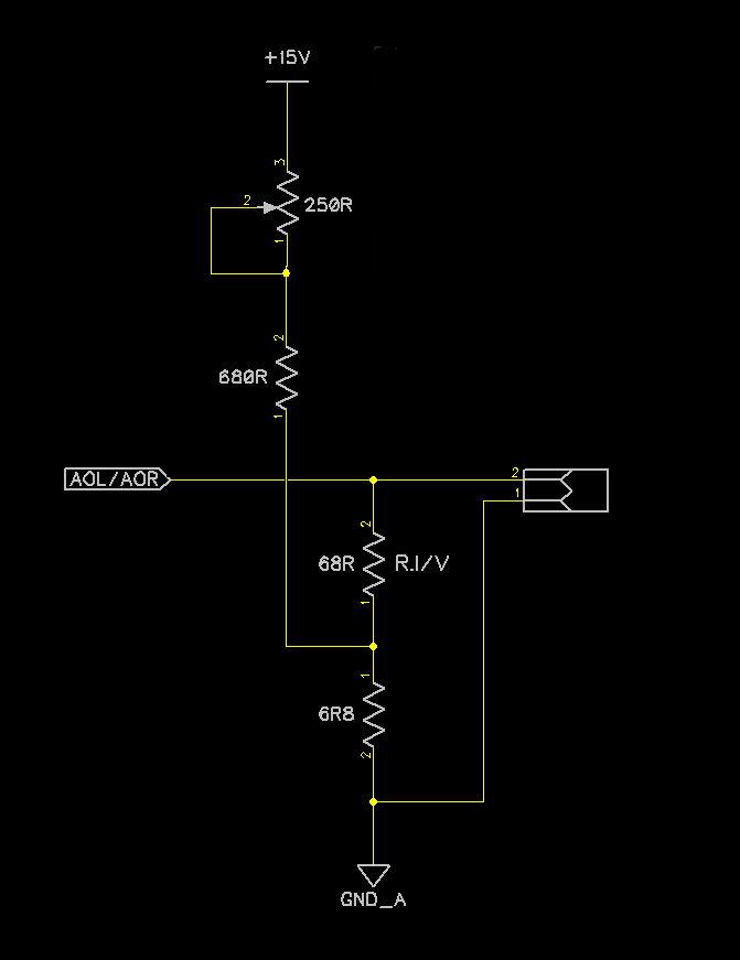

hello John,
glad to have an answer from the expert here, thanks:cheers:

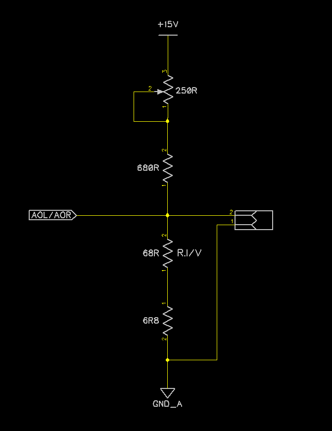

btw i try to figure out into a simple schematic what i can understand from your explanation, is this correct?
and is it compatible with TDA1541 non-A ??
thanks.

Almost correct, I attached the corrected version. Yes this also works for the TDA1541 non A version.
oh, i see
thank you for the correction John:cheers:

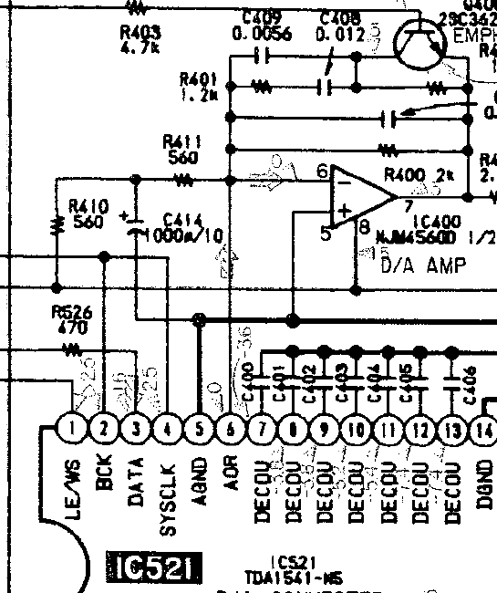

Sony was using a similar scheme back in the time of CDP-950 - they had the design flaw of only providing +5V to the opamps. But they where using quite large capacitors in that current offset path (see attached snapshot of the schematic). stupid Sony style of schematics though...
Sorta of active voltage loaded I/V with the R in the feedback loop of the oap ? :( measure fine but sounds :eek: ?

In order to null the DC on the TDA1541A output we need approx. (15 - 0.136) / 0.02 = 743.2 Ohm resistor between junction and +15V. We can use 680 Ohms in series with a 250 Ohm multi turn trimmer for fine adjustment (0V DC on the TDA1541A output).
Hi EC :)
I just spot that maybe a slight mistake occured?
Probably should be: (15V - 0.136V) / 0.002A = 7432ohms. then 6800ohm + 1K pot set to 7432-6800=632ohms
cheers
I made a mistake too :(
But I checked, and this is right formula to calc values:
for Vb=+15V, Iidle=0.002A Riv=68ohm and Ra=6.8ohm Rx=675.6ohm
(Note, that in this case, from Rx to Ra, will be 22mA,
Rx could be made from 620ohm and 100ohm multiturn pot set to 55.6ohm, or 0mV offset)

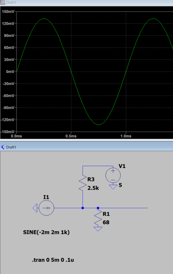

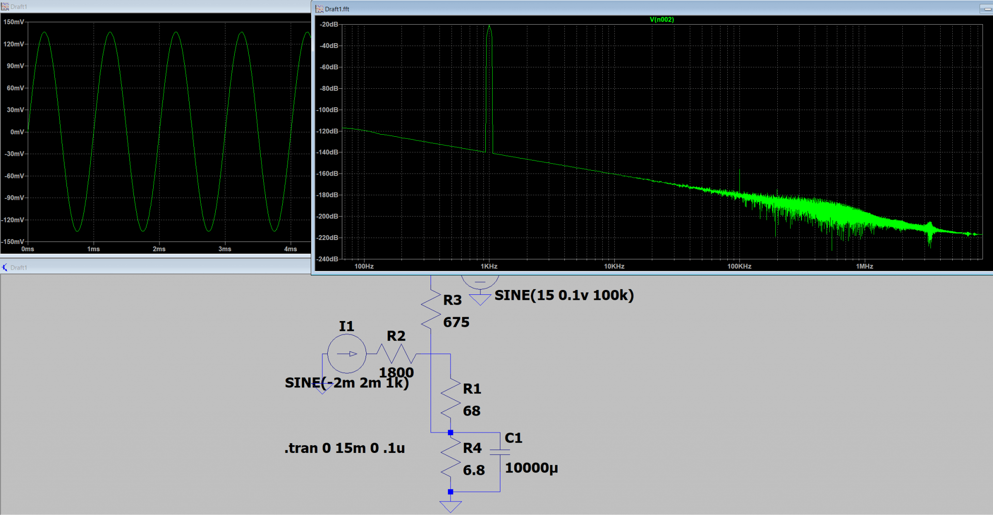

Just out of curiousity, what is wrong with a maybe simple style current injection like this?
Used 5v on pic but +15 can be used here too just 7.5k resistor instead of 2.5k
(I can see if using +5v of vdd from dac (for convenience) you would also inject noise into output, while fresh +15 with no other loads would be cleaner)

I think nothing? You can choose one of several ways proposed for current injection?
(Bare in mind that current should be out of the phase in Your circuit. At Riv voltage is in phase, first going into the +region, but should be out-of-phase and firs to go into negative V region...
To verifiy this, try to simulate classic OPamp design and 0deg phase and You will see right current source polarity, and in-phase voltage output. :)
But anyway, this small voltage should be amplified to some line level, and single stage, single ended amplification, (JFET, Tube, BJT) shifing the phase back to 0deg.
And add serial resistor of about 1800ohms after the current source. That is about output resistance of the dac i think?)
cheers
Hi EC :)
The voltage across 6R8 = +0.136V
So the current running through that resistor must be I = V / R = 0.136 / 6.8 = 20mA or 0.02A.
So the calculated values are correct. Note that this is a bias voltage correction (lifts up the I/V resistor ground potential) rather than a bias current correction. So the bias current through the voltage divider can be much higher (20mA in this case) than the actual TDA1541A idle current of 0.002A.

Just out of curiosity, what is wrong with a maybe simple style current injection like this?
Yes this will work too, but you get power supply noise injection that can only be reduced by increasing the series resistor value and supply voltage. This is the solution with +200V supply and 100K series resistor I mentioned. This was the best performing circuit I tested with bias current injection.. It offers approx. 1470 times supply noise/ripple attenuation. It also creates a more ideal constant current source.
With the reference voltage that lifts up the I/V resistor ground potential, we can easily bypass the 6R8 resistor with say a 10000uF/6.3V capacitor. This way we can greatly reduce power supply noise injection compared to the series resistor solution and don't need high supply voltages.

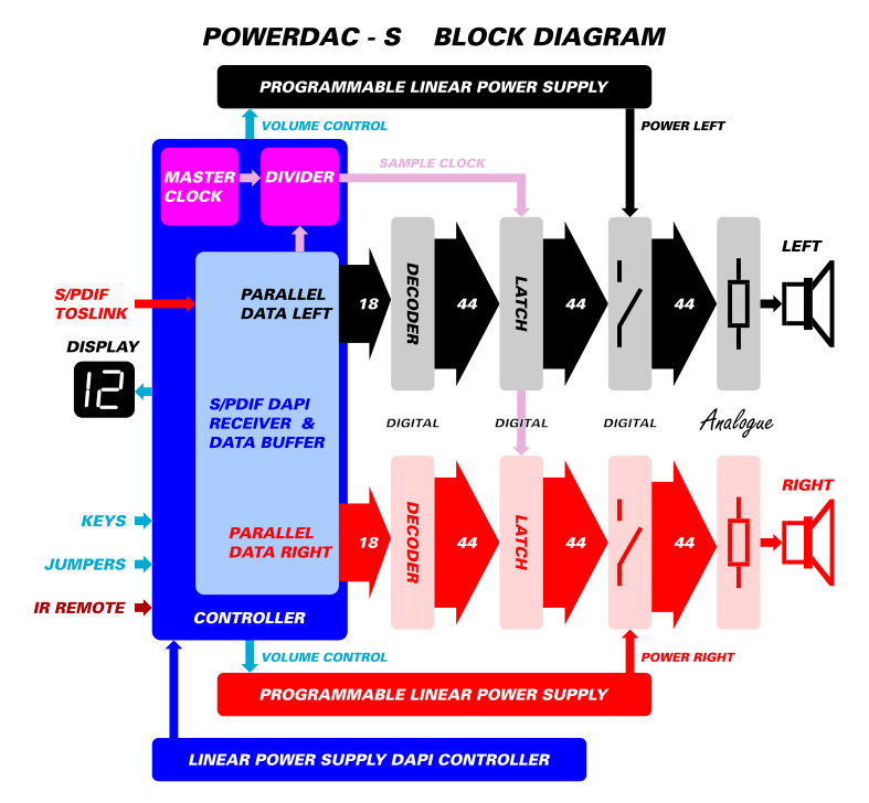

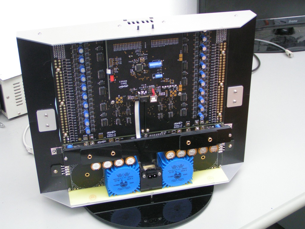

Here is my personal final solution for the ultimate NOS DAC, a quest that was started in 2006.
My idea is removing -all- (digital) amplifiers and active analogue circuits from the signal path. It is difficult to grasp the idea of driving a speaker without -any- amplifier.
The goal is maintaining the lossless digital signal path all the way up to the speaker, eliminating the complete conventional analogue signal path including all related distortion and degrading.
I ended up with this:
Digital audio data (numbers) -> digital switch combinations -> precision power resistor array -> speaker. The device received the name PowerDAC-S.
It is basically a programmable resistive attenuator, suitable for directly driving speakers. Its is designed such way that its output impedance is constant.
One -could- view it as an ultra high speed stepped attenuator connected to a power supply where the speaker connects to the attenuator output. This way we can generate analogue signals without the need for analogue circuits like (pre) amps.
It is easy to come up with a theory, but it is very difficult to translate a theory into a practical working circuit. We also had to fix the well known digital audio receiver problems like jitter & noise spectrum.
I attached the PowerDAC-S block diagram.
On the left we have the S/PDIF DAPI (Digital Audio Parallel Interface) receiver. It basically receives a S/PDIF stream and outputs left and right channel parallel data accompanied with one single sample clock signal:
Parallel data left, Parallel data right, sample clock (44.1 KHz ... 192 KHz).
Because we no longer generate nor use I2S or comparable serial digital audio interfaces, related high frequency clocks and serial data signals are no longer present here.
The parallel data enters two Fractal decoders, these basically chop up the highest and most critical bits into 31 fragments that represent said higher bits. So the data (numbers) remain the same, but are simply represented differently. So instead of 256 for example we express the number as 64 + 64 + 64 + 64, same result, smaller numbers. At this point we still have a digital (lossless) signal.
So why on earth do we chop up the higher bits? by doing so we can minimise bit errors with given high output current and given switch limitations (RDSon). We can minimise glitches and we can easily achieve required low output impedance. Finally we can use standard SMD thin film precision power resistors as the total power is now divided over 31 smaller resistors. The resistors are thermally coupled to a large heat sink.
Parallel 44 bit data for L and R channels enter parallel latches that provide sample timing (sample clock). All outputs now change at exactly the same moment. The signal is still lossless (digital).
The latches drive ultra high speed bit switches. The switch outputs are still digital (lossless).
So up to this point we are still dealing with exactly the same numbers (sample values) as stored in the digital audio file, there are no losses that would typically occur with analogue circuits and we are already very close to the output (speaker).
The switches drive a thin film precision power resistor array and here the still lossless digital signal is converted to analogue. But resistors are pretty linear and offer huge bandwidth (SMD components, low inductance, low capacitance), so losses are very limited compared to active analogue circuits that are always based on non-linear components.
Converter efficiency is low, 12.5% max, measured efficiency equals 10.8%. Efficiency is further reduced by the programmable linear power supplies. So for say 2 x 4W output power we need to dissipate approx. 120 watts continuous. Therefore the practical output power is limited and we have to use suitable speakers with reasonable sensitivity in order to get jack hammer SPL with only 2 x 4W converter output.
The remaining problem is volume control, the conventional analogue signal path no longer exists with the PowerDAC-S, so how do we control the volume?
Volume is controlled by a combination of supply voltage programming (higher supply voltage, higher volume, higher power dissipation in the resistor array) and bit alignment or bit shifting. The power supply voltage sets the "gain" and the bit shifts set the digital attenuation. By combining both we get a lossless (no audible degrading) volume control over a practical range (remember, no more amplifiers, no more gain / attenuation matching required).
The PowerDAC-S cannot clip as the speaker input = DAC output. The PowerDAC-S can drive any load between dead short and infinity. There are no local or global feedback loops at all, so the circuit is always fully stable and cannot oscillate. Bandwidth limitation that is always required with (pre) amplifiers in order to guarantee stable feedback operation is no longer required here. We theoretically have 200 MHz bandwidth with the PowerDAC-S, this bandwidth is obviously reduced by (speaker) wiring and parasitics.
Toslink is well known for related jitter issues, this is usually caused by the S/PDIF receiver that recovers the source clock and fails to block contained jitter. The PowerDAC-S is based on a S/PDIF DAPI receiver that extracts only the data from the incoming stream and places this data in a data buffer. This data is then output in parallel, accompanied with an independent, clean sample timing signal that is directly derived from a local, low phase noise master clock. The source noise problem is tackled by the Toslink interface (perfect galvanic insulation, limited bandwidth) and DAPI.

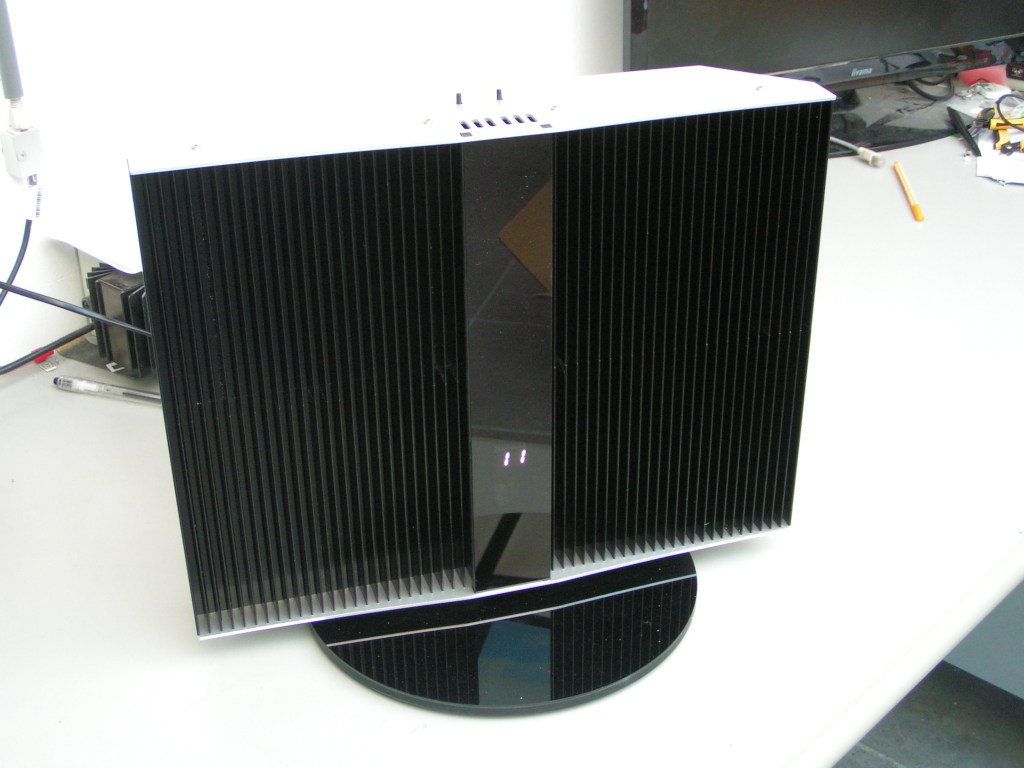

I also attached some pictures of the PowerDAC-S during the final development stage. So this is not just a theory, the practical circuit is up and running and 4 of these have already been built, for me personally there is no way back to analogue circuits as I am very spoiled now.
Hi Yes I corrected the statement in next post sorry :) https://www.diyaudio.com/community/...ate-nos-dac-using-tda1541a.79452/post-6876813
and gave the more acurrate formula to calculate values of resistors acording to +V used.
Please see attachment
But is the re any proposed ratio with Riv and small value R from Riv to GND? In Your example that is 10/1...
Very interesting ecdesigns, thanks for sharing! Never seen something like this, elegant solution. Even the prototype seems tidy. Wonder how it sounds...
Btw since its built, may we inquire what is the thd+n?
Good idea..injecting 0.1v p-p 100khz noise in the biasing supply, the parallel cap greatly attenuates. Thank you for sharing knowledge John and Zoran.
