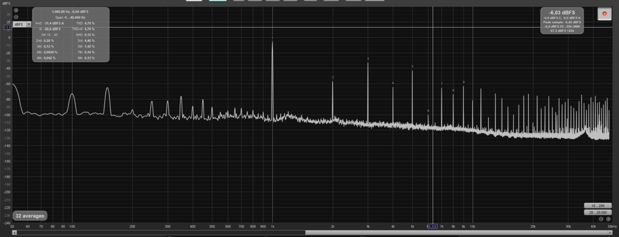

Okay, i managed to do both in simultaneous mode (according to JLsounds documentation), and even paralell them from twice the current, then trim to 0V DC with the ground lift potentiometer.
I guess it technically "works", but there is a terrible crackling noise. At first i thought i just needed to wait for the DEM caps to charge but nothing changes even after 20mins. I wiggled all the caps and everything on the board, just in case. I disconnected one TDA1541, and then the other, and basically it's identical in both so its not them (or they're somehow broken in identical ways). Maybe its just because i have non-A version, and 50Hz reclock doesnt work with it.
I think...the I/V (from previous page) should be ok, TDA1541 should be ok, so its maybe only the JLsounds to blame?
When i look at the RMS voltage of the lines on the multimeter:
LEO/WS = 10mv AC, 50mv DC
BCKO = 0mv (freq too high for DMM to read probably), 850mv DC
Data R (pin 3) = 65mv AC, 620mv DC
Data L (pin 4) = 5mv AC, 820mv DC
First no clue why one data channel is higher voltage than the other, but measuring this with the multimeter is kind of pointless anyway.
When i switch the data lines around it sounds similar though, so im not sure its that. If it was the data lines, switching it around would change which channel distorts more to the other side of the headphone (oh yeah, maybe its the 300 ohm sennheisers loading it too much, but it also distorts at low level where it should have current to supply). Actually, the lower the volume, the more it distorts (or maybe, distortion is all that's left).
Attached is Rar with mp3 of roughly how it sounds like (captured with 2i2 interface). So much unexpected issues with this.

Hi Zbunjen,
TDA1541 has internal DEM oscillator (on-chip timing capacitor, external timing cap pins are not connected), so the 50Hz mod can't work, the oscillator is fixed at approx. 200 KHz. The only option is using 100nF active divider decoupling caps.
Make sure to check JLsounds documentation & settings for the TDA1541 thoroughly, especially page 10, as it contains information about TDA1541 in simultaneous mode. Check if TDA1541 pin 27 is connected to -5V and that the 4K7 resistor is installed on the JLsounds board.
Perhaps it's best to start with I2S and try to get the circuit working, if it works, then proceed with simultaneous mode.
In most cases the TDA1541A simply receives incorrect I2S / SIM signals as these interfaces can be very critical. The signal timing has to be spot on or there will be problems. It helps to have an oscilloscope to check if the signals are correct, timing diagrams are in the TDA1541 datasheet.

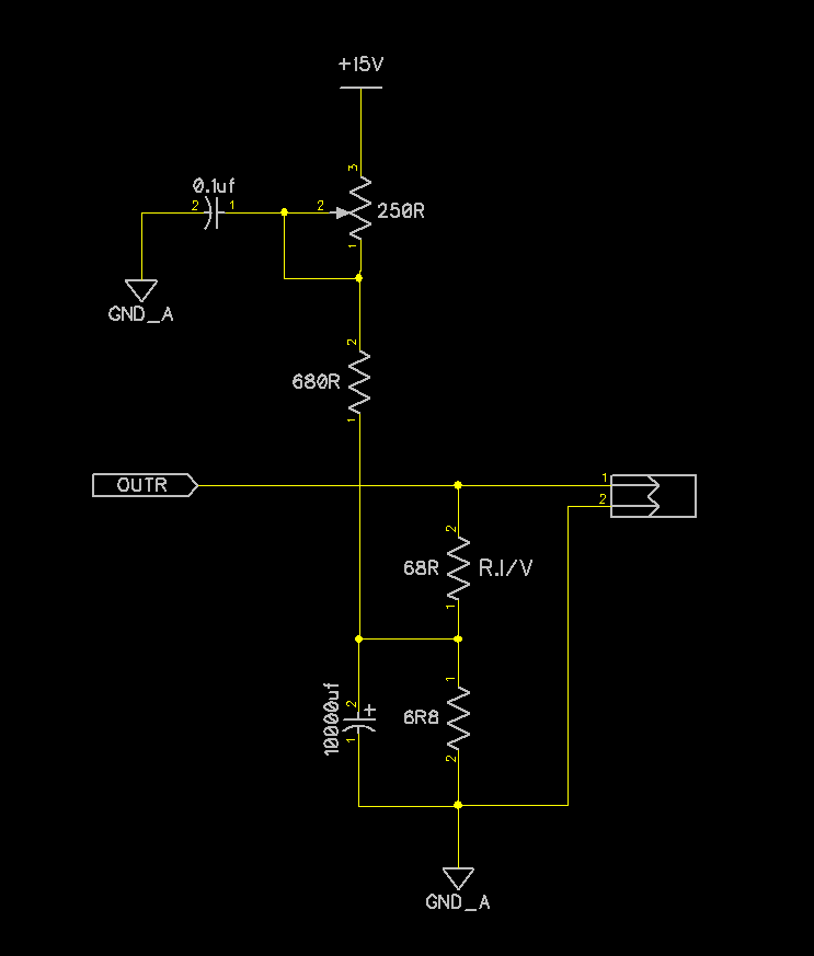

hello ecdesigns,
i've been implementing this schematic
and i can trim the DCout into 0v with very steady
and also the sound is very nice
there is one problem, with 1000uf caps equipped the gain reduced a lot,
i have to turn volume pot at 12'clock position to get a hearable sound
but if i uninstall the 1000uf caps the gain is normal, 8-9'clock position is hearable
why this 1000uf caps could reducing the gain?
thanks.
Peter

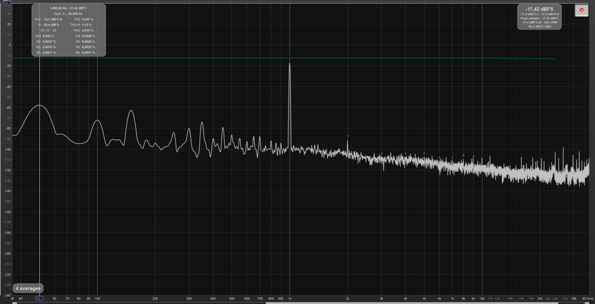

The crunch is now lower in volume but definitely still there, almost like a constant wind, and if you lower the volume all that's left is still just crunch.
I followed JLsounds documentation and can confirm its correctly setup for simultaneous and pin27 is jumpered to -5v.
Trying the I2s mode, i jumper p27 to +5v and reconfigure, it is a lot better but has crunch on low levels as well. Something is not normal here.
I thought maybe the chips are broken (i use 2x tda1541) in parallel, so i checked them individually (take one out, take other out), swapped them around, etc. but no difference.
There is a zip with 2 mp3 recordings, just showing how the crunch presents itself.
I am at a loss, this circuit is not so complicated, i implementned already 5-6 different R2R dac's, yet this one refuses to work...

6R8 resistor (part of DC bias correction) plus connected bias trimming resistors will increase effective I/V resistor value and related ac output voltage.
6R8 bypassed with 1000uF -> low impedance, almost zero Ohms -> 0.004mA ull scale current * 68R = 272mVpp audio output.
6R8 not bypassed and trimmer in centre position: 680R + 125R = 805 Ohms in parallel with 6R8 for ac signals so Rt becomes 6.74 Ohms.
(power supply is basically a short circuit for ac signals).
6R8 not bypassed -> Riv then becomes 68R + 6.74R = 74.74R -> 0.004mA ull scale current * 74.74R = 299mVpp audio output.
If you want to get the same output signal of 299mVpp -with- 1000uF installed, then the I/V resistor must be increased from 68R to say 75R (2 x 150R in parallel).
With 1000uF installed, power supply noise will be greatly attenuated and the output signal remains cleaner.

#8,066

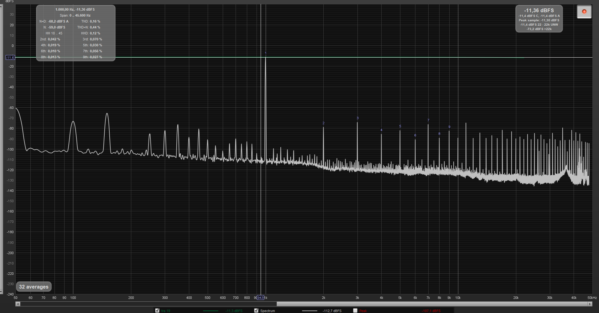

The 100uF electrolytic capacitors need to be removed when using 200KHz DEM clock for correct DEM circuit operation.
The distortion from the examples is low level distortion and this suggests that the DEM circuit is not working correctly. It is unlikely that 2 chips have exactly the same problem, so the problem is most probably caused by the external components and circuits.
When you play a low level 1KHz test signal (-40dB ... -60dB) the distortion should be clearly visible on an oscilloscope as well. There is also quite some mains hum on the signal.
You could remove one of the 100nF active divider decoupling caps (nothing connected to that pin). Then measure the signal on that pin with an oscilloscope (ac millivolt range).
If DEM is working, there should be a kind of step signal on that pin. This confirms that the DEM oscillator is running and the switch matrix is working.
The shape of the step signal depends on passive divider mismatch. The passive divider is part of the active divider circuit.
This is different for each decoupling pin and different for each chip.

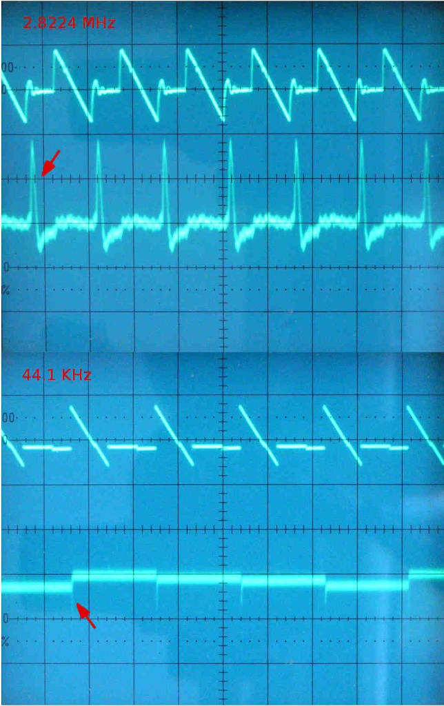

I attached a DEM measurement, the step signal at the bottom of attached picture shows how such step signal on a decoupling pin (decoupling cap disconnected) could look like.
The DEM decoupling cap will filter this step signal, leaving the average DC bit current of 4 slightly mismatched passive current divider outputs.
If for some reason these mismatched passive current divider outputs are not averaged, we get bit errors. Because these active dividers are on the 6 highest bits, slightest errors will be immediately audible and measurable. So correct DEM circuit operation is vital.

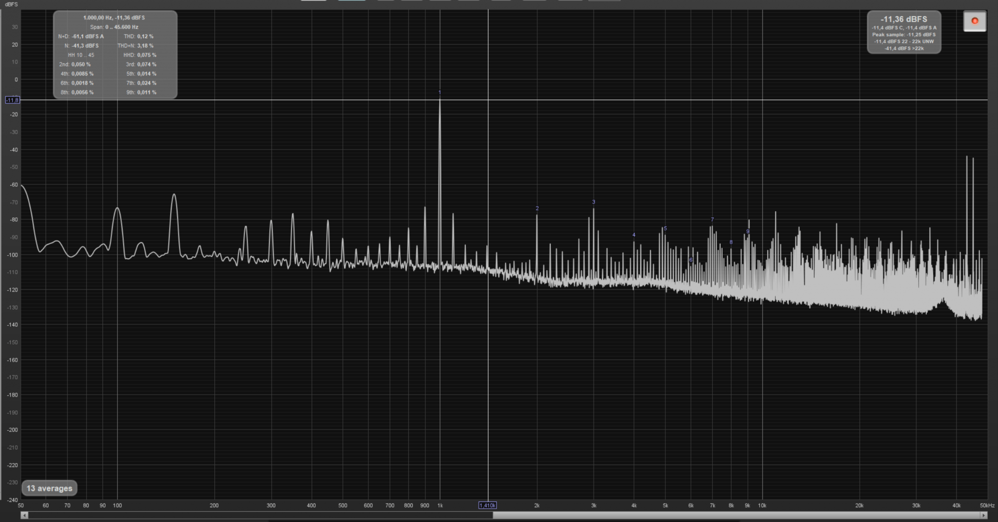

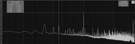

I went on to check the DEM currents as you described, while playing a low level signal.
Everything seemed fine, and similar to what you showed, i even played with the sample rate.
But then just out of sheer curiosity, i bridged the two pins used for DEM reclock, that say should not be connected (16 and 17) in non-A data sheet. Guess what! Completely solves it, but with FFT i found best is actually anything from 330pf to a couple of microfarad capacitor (with little change in this range). I put 2.7n C0G 1206 on both, and then paralleled the outputs, works like a beauty.
I also explored why there is such strong mains hum on the recording, it is actually related to the measurement cable going next to the mains cable, and you can audibly hear it appear and dissapear as you connect and disconnect the cable,so i dont think its there normally. I tried an audio isolator (so an isolation transformer) to see if its ground loop related, but no it made it even worse, so its likely just radiated emi pickup. I'll look into cables. The noise floor is suspiciously high, may or may not be related to this. Anyway harmonics are satisfactorily low, sound is smooth.

For completeness i setup the board in simultaneous mode, so now we know chips and everything else is setup fine for accepting this mode, safe to say problem is isolated to the logic now. Well, i must say i am at least somewhat happy, halfway there and this is still a nice sounding setup, but goal is not complete.
Also interesting, but measured performance seems identical to post 8069, at least as far as figures of merit go, both in spectra and levels of harmonic distortions. But my measurements right now aren't the best due to this mains stuff i still have to figure out why it appears there.
