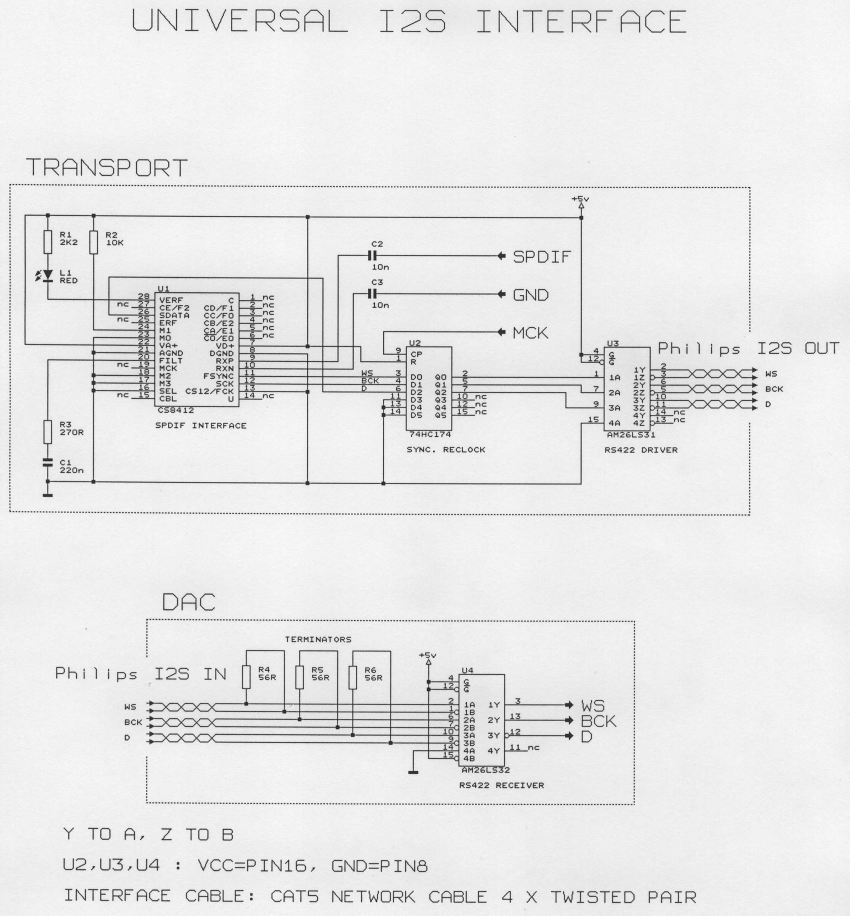

Hello!Universal I2S interface schematics
Hi all,
Problem1: SPDIF jitters
Problem2: I2S comes in different formats (compatibility)
Problem3: How to transport I2S to a external DAC
Solution: Universal Philips I2S interface (can be added to almost every transport).
Basically SPDIF jitter occurs because both data and clock signals are mixed using Biphase Mark Code and then transported to the DAC by a optical, coax or differential interface cable of a few meters, jitter is added to the integrated clock signal by the varying data content.
So let's forget about SPDIF and move on to I2S,
What signals are present in almost every transport? SPDIF and the master clock (low jitter guido tent or elso kwak clock).
Now suppose the the audio interface chip (CS8412) was placed in, or very close to the transport instead of the DAC. It could be directly driven by the SPDIF output signal of the digital processor chip without using long cables or transformers. It would also automatically convert to philips I2S format (jumper settings). Then the icing on the cake, BCK, DATA and WS can be synchronously reclocked by the (low jitter) master clock that has a fixed phase relation to both WS and BCK. D-flipflops can be used for reclocking.
Now we have a universal very low jitter philips I2S interface in the transport. The 3 signals WS, BCK and DATA can be transported by using 3 differential RS422 interface drivers (1 X AM26LS31). On the receiving side (DAC) we use RS422 interface receivers (1 X AM26LS32), the lines can be terminated at the DAC side (54 Ohm). And why not use a standard cable available for this purpose: (screened) cat5 (4 X twisted pair) network cable. I am sure this will significantly reduce jitter as the transported clock signal is a non-modulated squarewave of a constant frequency. It will also solve I2S compatibility problems.
Oh, yes I already added a rough concept schematic diagram of this universal I2S interface. I am sure lots of improvements can be made, but it's a start.

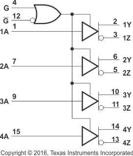

I tried this on philips interface on my philips 620 which i use as a transport, but it doesn't work, the sound is distorted. I was wondering if pins 4 and 12 (both of 31 and 32) must be connected to 5v or PIN 4 to 5v and PIN 12 to gnd as in the attached photo.
No try to enable it like in the datasheets.
https://www.quick-teck.co.uk/Management/EEUploadFile/1469530629.pdf
All G to Vcc 5V and all -G disconnect
or another way, All G leave unconnected and all -G connect to ground.
This option of enabling can be usefull for selecting lines
I did it with simple inverter.
Also find that sound was better even with shorter lines inside the dac... Dont know how to explain...
I think i used same drv/rcv pair but termination was little different not hard with 50ohms.
try to get first standard enabling
after that measure with scope diff lines and find better termination values of reistors?

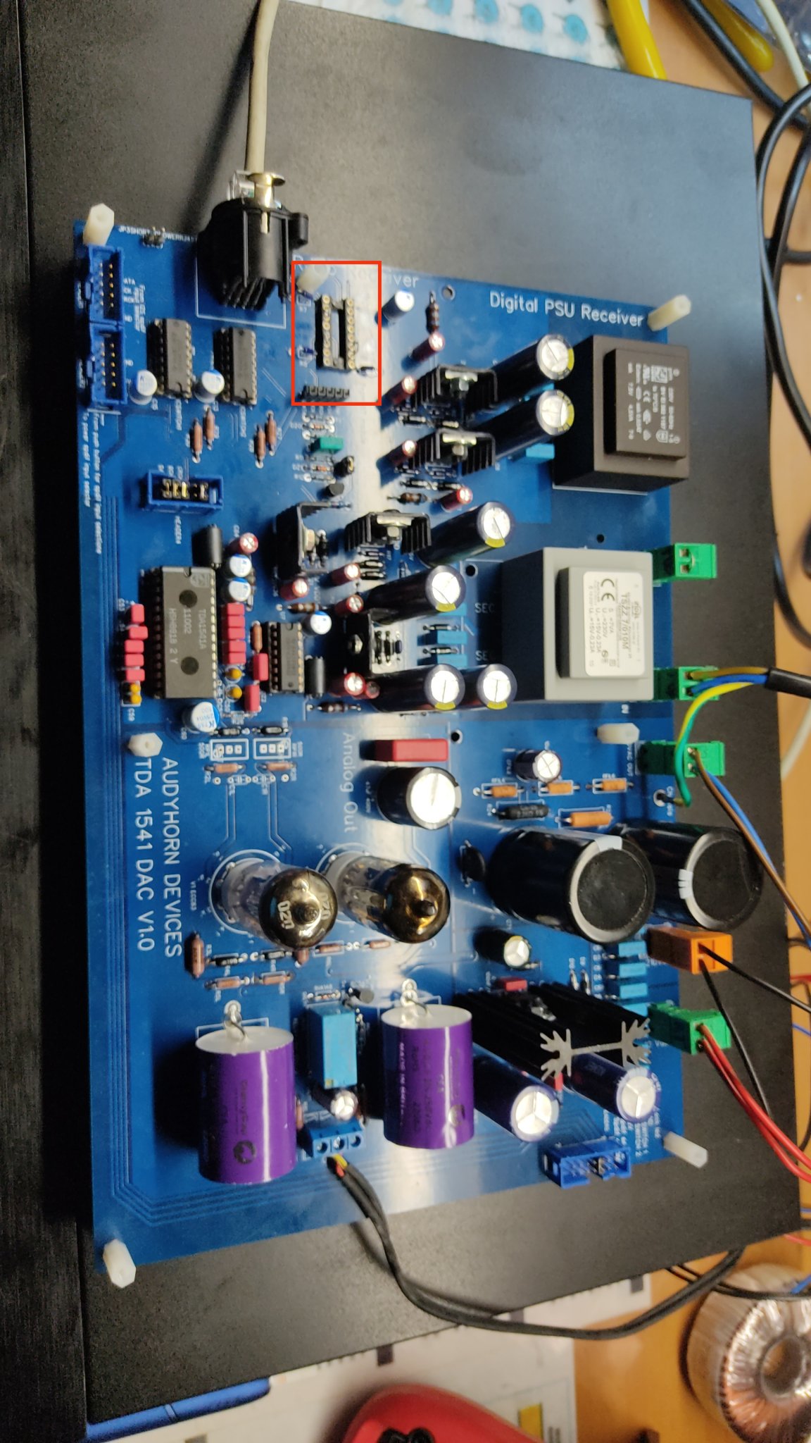

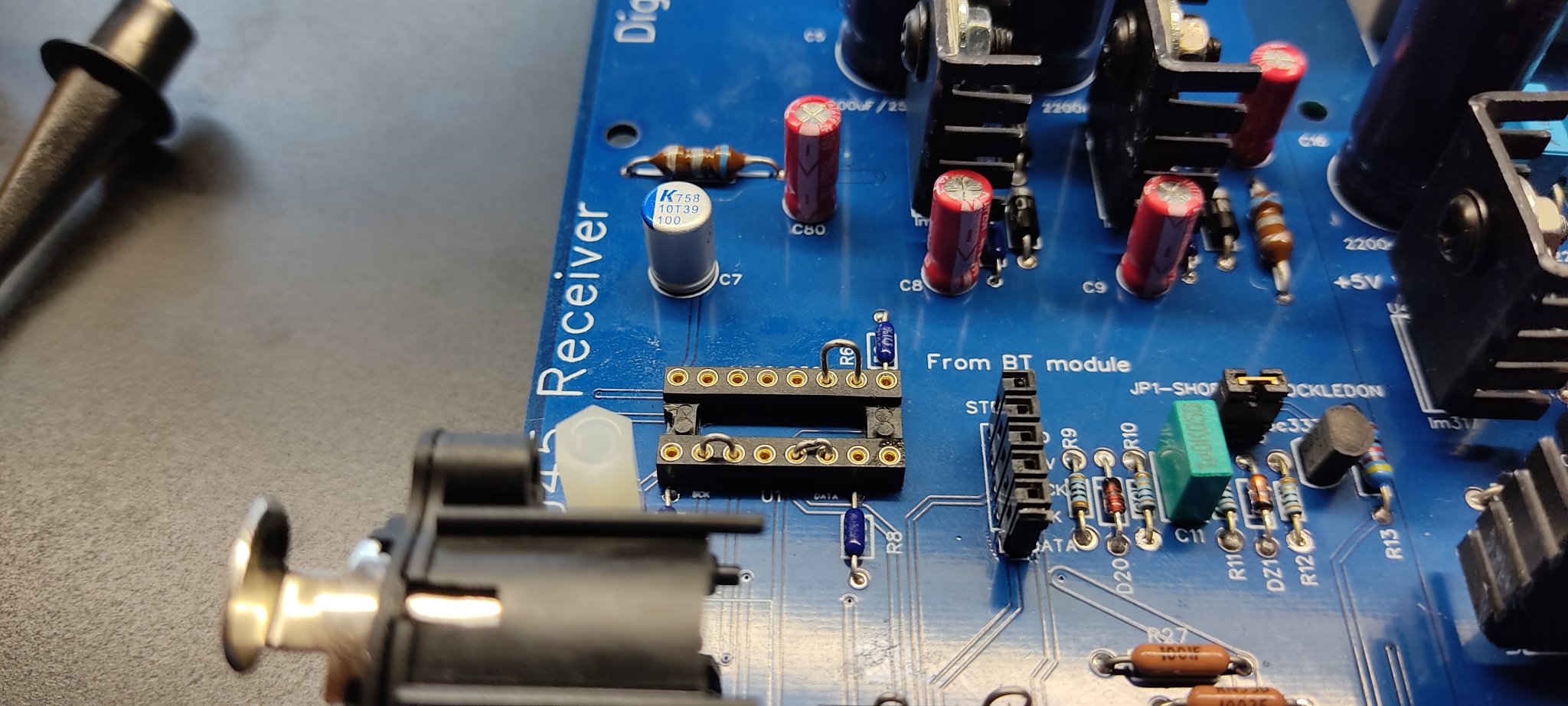

I need to connect my cd transport to my tube dac with tda1541.
Both are connected via rj45 connections and LAN cable.
I used chip 31 on transport and chip 32 on dac but they don't talk.

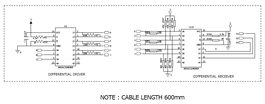

Bypassing AM26LS32 and lifting the 56 ohm resistors instead it also works with AM26LS31 (with pins4 and 12 connected to 5v).
Strange!
Could you help me solve my problem?

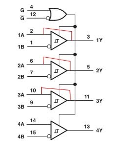

OR If it is on this place receiver
You bypassed like this
BUT that will be little strange because of the serialresistor only at one leg...
Try to find with the scope what are all signals present at the cable connector after the driver
Problem solved, - lrck inverted with - data on 31 chip driver .OR If it is on this place receiver
Now is working fine
Thanks for your advices.

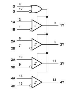

In this diagram the PIN out of AM26LS32 are wrong.Universal I2S interface schematics
Hi all,
The correct PIN out are:
1Y= 3
2Y= 5
3Y= 11
4Y= 13
PIN 12 of AM26LS32 and AM26LS31 must be float, only PIN 4 must be connect to 5V
