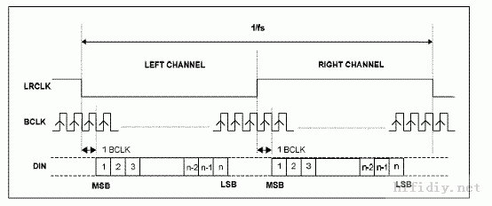

Now I am looking at the EC time I2S diagram and it seems that BCK is inverted from i2S standard? IN all cases of LE, going from 0 to 1 or 1 to 0, BCK is going falling edge. But in I2S standard whwn LE changing states BCK always going from 0 to 1, rising edge. Please check. At EC sch BCK going falling edge when LE changing states...Well, you might as well ask about his latest work because i feel pretty much momentum of thread is concluded, tda interest seems a bit died down, i think (but dont quote me on this) John mentioned he moved on to other things and got out of tda1541 what he wanted...now he just anwsers questions here and there out of generosity and good nature it seems. And questions bump the thread up anyway so it has its positive aspect..

Hmm...interesting.. i see what you mean if we're both looking at 7092Now I am looking at the EC time I2S diagram and it seems that BCK is inverted from i2S standard? IN all cases of LE, going from 0 to 1 or 1 to 0, BCK is going falling edge. But in I2S standard whwn LE changing states BCK always going from 0 to 1, rising edge. Please check. At EC sch BCK going falling edge when LE changing states...
Definitely will try to play with BCK and U4
Thank you for alerting me Zoran

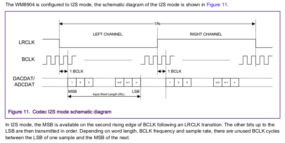

I must correct myself. Double check is always good...
I2S bus presented in the 7092 is correct.
But
it should be verified by measuring I2S coming from receiver spdif-I2S board OR USB-I2S interface.
Also when measuring signals not bad idea is to take a look at master clock MCK line and how it is related with SCK line
in some interfaces I measured is in phase (booth rising edge starts) with SCK like Amanero, but in some XMOS based interfaces it is opposite to SCK

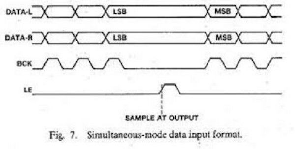

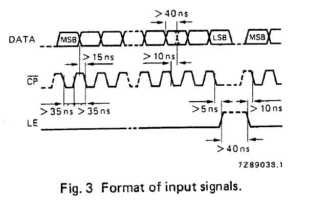

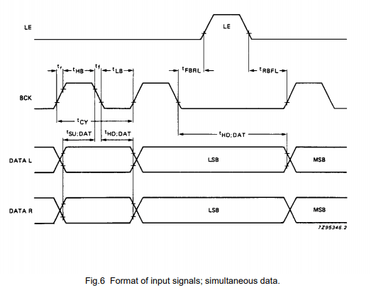

Hi Zoran,
If I recall correctly, this circuit (post #7092) was designed for simultaneous output (L and R data time aligned) in order to feed both, left and right data into the TDA1541A simultaneously:
DATA L
DATA R
LATCH (WS)
CLK
When you check TDA1541A data sheet & timing diagrams for simultaneous mode (pin 27 connected to -5V), you will see that data is now being latched at the falling edge of BCK.
In I2S mode (pin 27 connected to +5V) data is latched at the rising edge of BCK.

If I get right from the I2S standard:
a) SCL is always fallen edge when LE change state.
b) MSB is 1SCK after the LE change state
c) MSB is fallen edge SCK?
For time sim :
a) no matter the data value bit starts at rising edge of BCK
b) LE is independent, common for L and R ch, and can trigger the conversion 0sec after LSB loaded or latter. With rising edge. Enough pulse of LE is 1/2 of BCK...

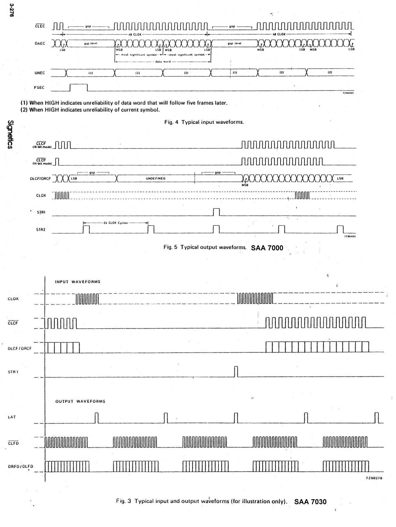

From SAAs chip we can see that the data are at the rising edge of SCK too.
