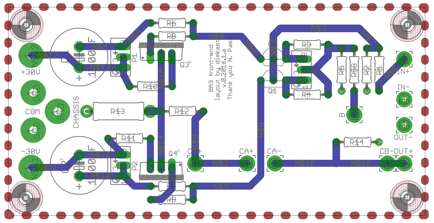

I have a question. Are there any issues with pops using the board as a preamp? Shouldn't we have a resistor shunting the output of the cap?

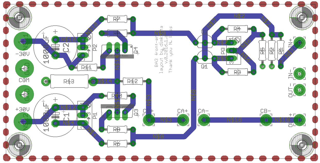

Oh and here is the layout I have so far. I would appreciate any input.
A resistor on the output cap is a good idea.
I'd make the layout narrower in general if you plan on floor mounting the Mosfet, the devices are TO-220 and you won't have enough room to get a tool on the mounting bolt. It looks like the device drawing is bigger than TO-220.
Is this a single-layer board?
Good catch. Yes it supposed to be an IRF510 TO220, but the package design is quite bigger than the datasheet spec.
I moved the mosfets more to the sides based on the datasheet.
The contacts are now 11mm from the sides. So the entire metal part and the hole should be exposed
The PCB is double layer, but all signals are on a single layer. The other one is a ground plane.
Added a few details
I added a chassis connection (keeping 0V level on the preamp pcb)
I added the output shunt resistor (R14)
I added an alternate position for R5 (R5B) with a pad (B) to allow connecting two boards for balanced operation.
That asymmetry was killing me...
I also splitted return currents, added provisioning for sensing regs and fixed a few more minor things

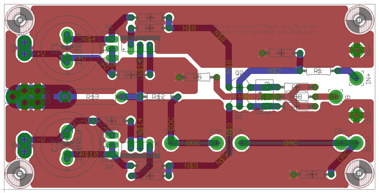

Here's a preview with flooded rectangles, so that they are more obvious
The fact that the pcb can be easily split in half got me thinking...
What if keep the input separate?

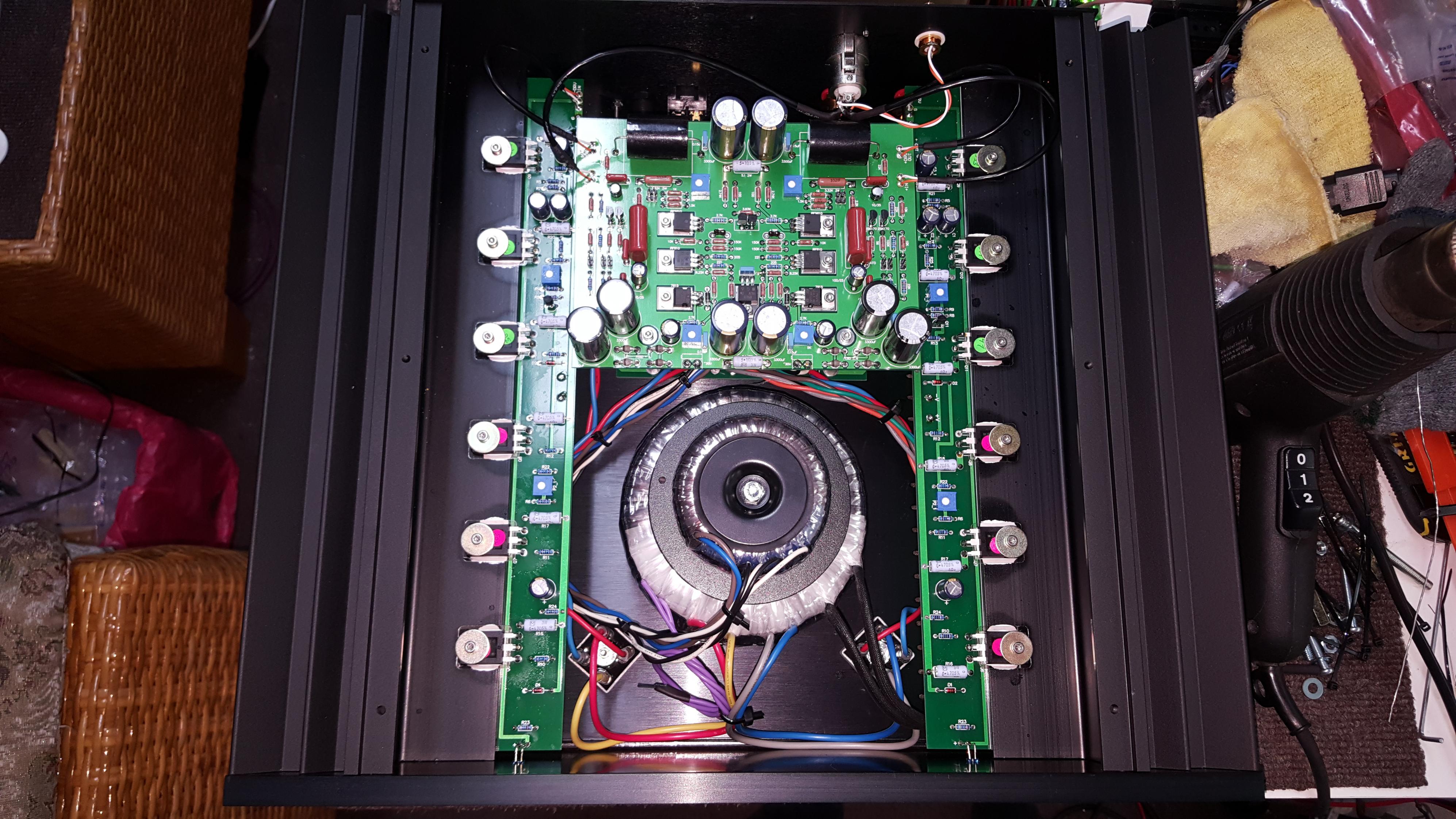

Re reading all this is again giving me the BA3 itch. Or I should say, the BBA3. I will need to bite the bullet and by 2 more large deluxe 5 cases for the project, but I have the boards, jfets, and most of the pesky stuff already.
Rather than a BBA3 pre, I am slowly finishing a Shunty Pumpkin. It never stops...
