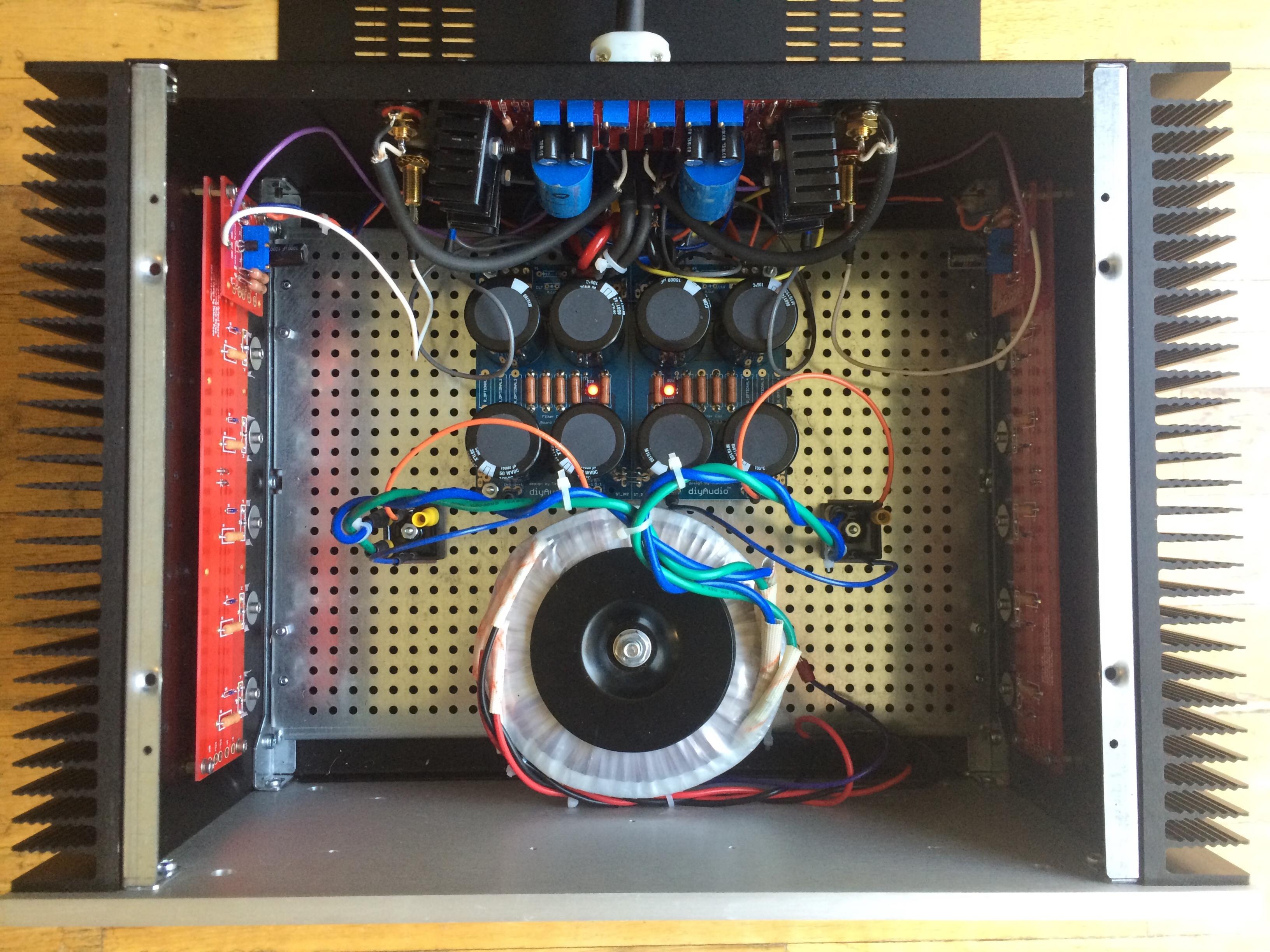

After a lot of time trying to zero the offset at the Front End (which proved to be very difficult), I settled for "close enough", at about 0.025 V when in thermal equilibrium.
Now, it is finally up and running! Thanks a lot for the priceless advice!

Okay i have a problem that has me stumped. I have just begun to bias the FE boards. When i start the variac and slowly increase voltage my R10&11 begin showing voltage drop with the pots zeroed and variac not even close to mains voltage. In fact its about +-5 VDC coming out of the power supply. Anyone got any suggestions?
Disregard... i had Q1 & 2 switch on one channel. Good thing i was gentle with the variac. The jfets are fine.

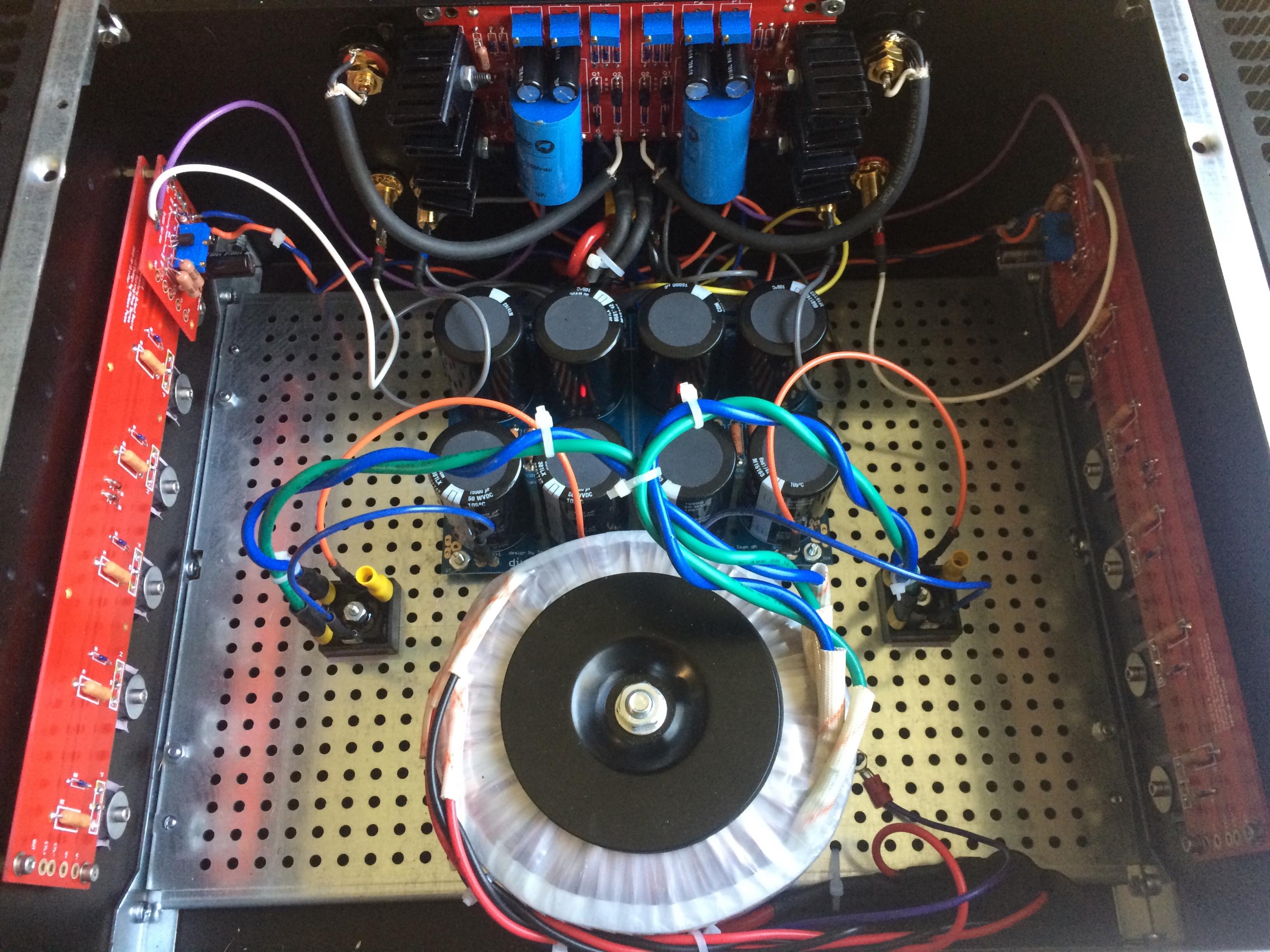

Okay. I have been letting the amp burn in and try to reach equilibrium on the sinks. All was great until i went to go measure the bias. Soon after connecting the meter leads the transformer started buzzing. Everything otherwise seems fine. No smoke, bias still seems good, put music through it and sounds great, but there is a fairly loud hum now coming from my transformer. Which is a 600VA Antek 24x2. Any ideas? Could one/more output device be bad and draw a bunch of power but the amp still works?
So I unplugged the leads from the rectifiers to the power supply boards essentially removing any load from the transformer and it still hums. I’m thinking there is a mechanical error in the construction of the transformer. Maybe it was just coincidence that it started humming when i was taking readings. The music from the amp sounds fantastic, bias is steady around .3V across the source resistors. Maybe i will see if Antek will exchange it.
Had a similar experience on a duel mono LM I built. One transformer noisy, one not. At the suggestion of someone here I tightened the retaining bolt on the noisy transformer a little. It must have been vibrating a little. No more noise for two years now.
I will do this tonight. After letting the amp rest overnight Saturday night, Sunday the buzz was gone. I'm guessing the heat from leaving it on all day Saturday softened the insulation and whatever they use keep things tight, allowing some things to loosen up. I will take the added measure to tighten it up a little more.
