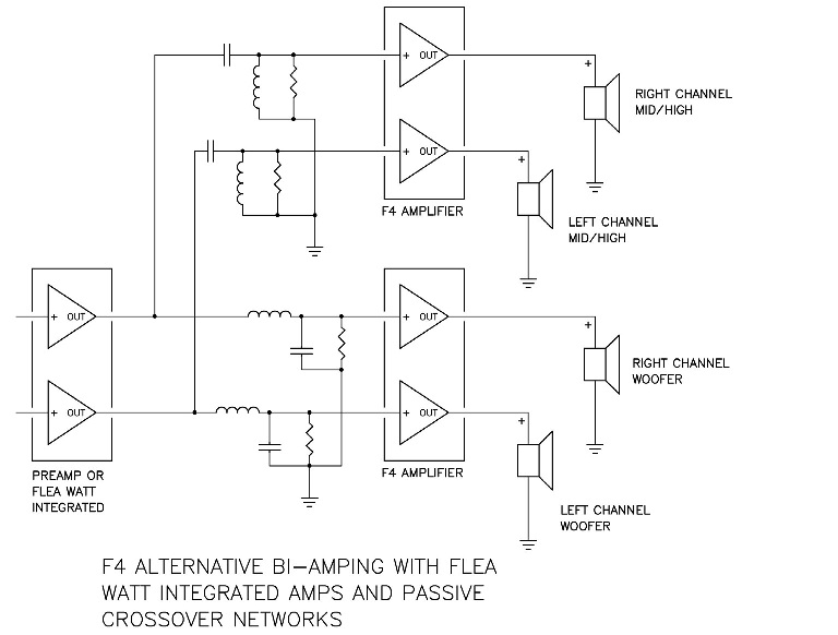

I'm planing to mount following chain of elements: BA-3 preamp + passive crossovers + and four chanels of F4 for bi-ampling, like on attached Fig from F4 manual. Is it better to have F4 regular chanels with Jefs in front or without them like BA-2 push pull output stages.

Q4 is SJ and Q3 is SK
compare with F5 for instance or BA-2 the p is connected with negative rail, the n with positive rail....
You just taught him how to make a fire.
Guys, you need to learn device's symbols and polarities.
