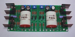

Can't get 1V across R10 or R11.
P1 and P2 are 500ohm. Max resistance creates 0.5V on R10 and 0.1V on R11.
Have tried adding 470ohm to P1 and P2 and this makes no difference although I'm not sure I've broken the trace fully.
Just checking that Q3=2SJ313 and Q4=2SK2013.
Any thoughts?

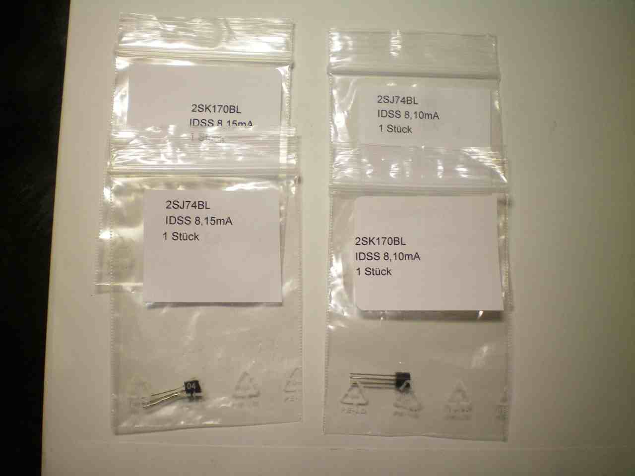

I can send you these two pairs matched by a friend with a curve tracer......
PM me please

Q3, Q4 seems correct to me, is he polarity of the caps correct?
I'll go down to the garage and check.

Caps are in correctly.
Q3 and Q4 are Gate Drain Source from left to right (looking at front of case) I believe so these are round the right way (this time!).
correct!
The other BA-3 board has produced the same results. I'm running them at -25V-0-25V+.
Makes me think the mosfets are faulty in some way but if so very consistently.
Can't move forward on this at present.
Would using 1k for P1 and P2 make a difference? This difference in the voltage across R10 and R11; if P1 and P2 were not high enough would there be this voltage difference?
