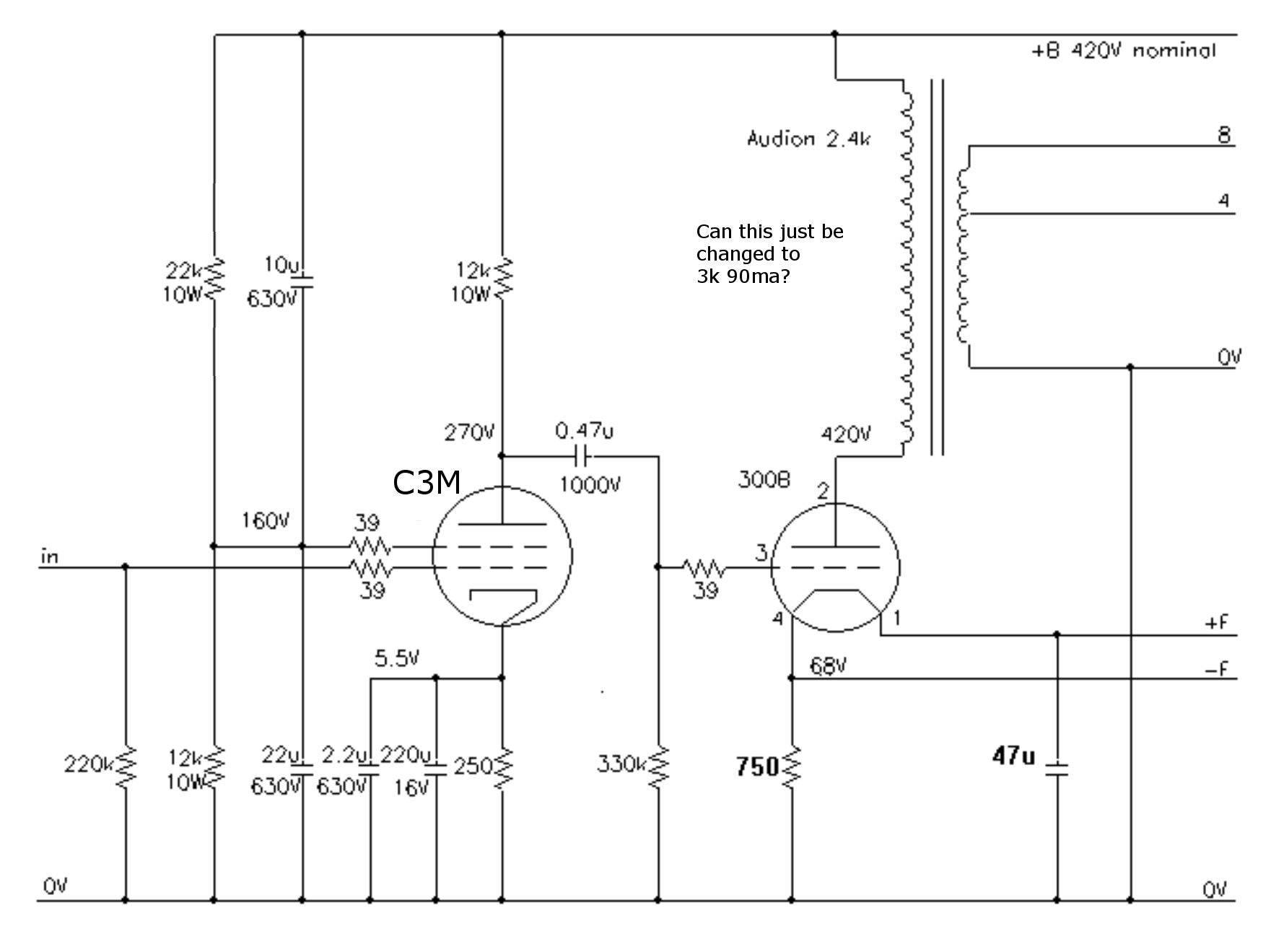

1) In the Legacy amp below, the 300b operating values seem to be set for a 3.5k transformer. Do you agree, and if so what are the implications of replacing the Audion 2.4k transformer with a Lundahl 3.5k/90ma transformer?

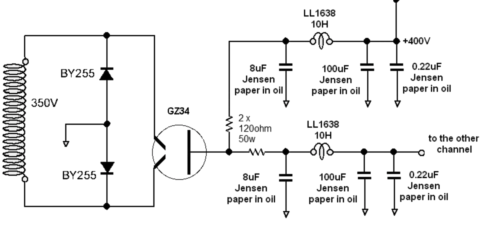

2) And if I use the power supply from the 'New Reference Amplifier' on audiodesignguide.com (below), can I just swap out the mains transformer for a 375v one to give a 420v nominal supply? (And what does 'nominal' mean? If I do the current/voltage calculations on the legacy amp, I calculate that the B+ above the driver stage to be 390v not the 420v given)

1) Higher load impedances (for triodes) give slightly lower peak output power and slightly lower distortion and better speaker damping. It's entirely your call.
2) Nominal means "Good luck, and thanks for all the fish." But seriously, it means you don't have enough information to pretend to have 10% tolerances there. If you're bound and determined to actually design a B+ supply, you need real numbers, including specs of the power transformer, and a program called PSUD (I hope that's the right name - if not somebody will fix it for us.)
The proposed power supply design looks slightly wasteful, and the GZ34 is drawn backwards, and there's no decoupling for the driver stage, and there's a weird capacitor from B+ to driver G2, but the worst part is that it doesn't show the filament supply for the DHTs. The amplifier circuit demands clean DC there.

Thank you. I can sort out the GZ34 and I have the filament supplies, but the two points you raise above around decoupling and the odd G2 cap I thought were clever design choices by Mr Loesch. I don’t know enough to design my own amp and yet this seems a respected amp design for the 300b.there's no decoupling for the driver stage, and there's a weird capacitor from B+ to driver G2
Difference of "nominal" 400V or 420V is negligible considering the mains power voltage fluctuation (+/- 5...10%).
In this design -in the PSU- the main bottleneck is the power transformer, then the rectifying structure.... and the other part of whole PSU. :-(
Producing -good- 2x 90mA isn't easy job, requiring properly selected parts.

I was intrigued by the 10u/22u path in parallel with the 22k/12k voltage divider. Is the purpose of this to follow PS ripple?
Re the power supply decoupling for the driver stage, I assumed that the 12k above the C3M anode did that job.

I would lower the operating voltages of c3m.
Ah, good spot. My mistake. The anode voltage should be 220v not 275v. Any thoughts on the role of the two capacitors by the driver?

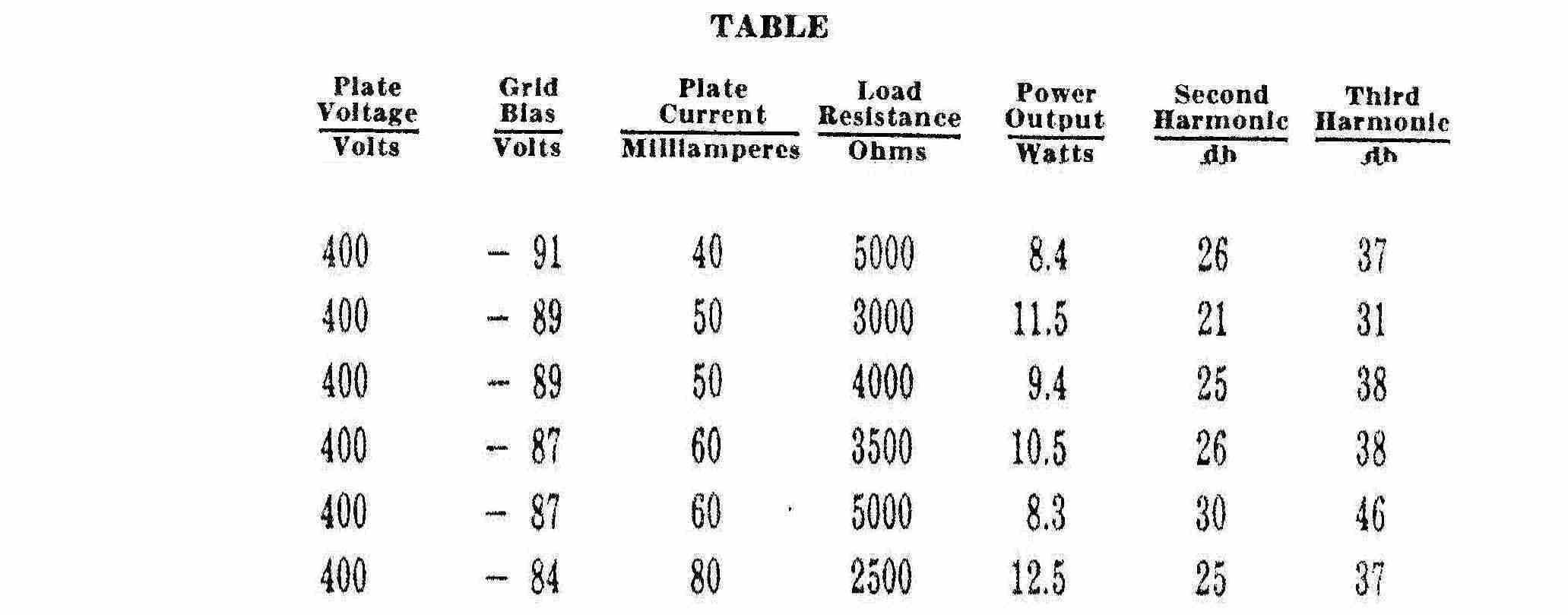

Have a look at the WE operating points for 300b. They're posted regularly here - I don't have the link handy - does anybody have it?
WE
4300 data at 400V
4300 data at 400V
I have the specs and have used a load line calculator to calculate operating point and grid bias voltage etc. I just wanted to use a simpler power supply (have now got PSUD so have calculated that), so just the driver stage to get my head around. Still intrigued by the 2 caps.
