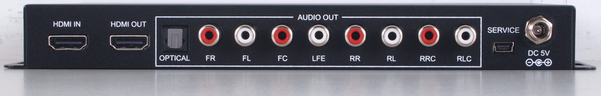

How did You "modded" the HDMI DAC?This works with these extractors and allows me to output 8 channels up to 24bit 192kHz (i modded the card to output 4x stereo SPDIF outs)
I use those DAC for 4 channel output and had never a channel switch. But i use also larger chunksizes.
Nothing special, the hdmi transceiver chip in the dac i posted outputs 4x stereo i2s signals. Tapped those and built a board with 4xwm8804.
Yes, with large chunksizes the buffer underruns are very rare, but still, i want to have a tool to automatically correct the channel swap if it happens. As of now, i am thinking on a python script that reads the log file of camilladsp (-o, --logfile ) with a sort of "tail -f" functionality, so that if detects an underrun, restarts camilladsp. Not sure how it is going to work.... What i wonder is if those underruns are also written to an alsa log and if yes, where to find this log.
If you use exactly the same dac, i would be curious to know if you can force and underrun and see what happens.

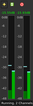

I just released camilladsp-vu. As the name suggests it is a VU meter for camilladsp. It requires at least version 2.0.0-alpha1 of camilladsp.
For more information see this page: https://t-5.eu/hp/Software/Camilladsp VU Meter/
And the obligatory screenshot:
