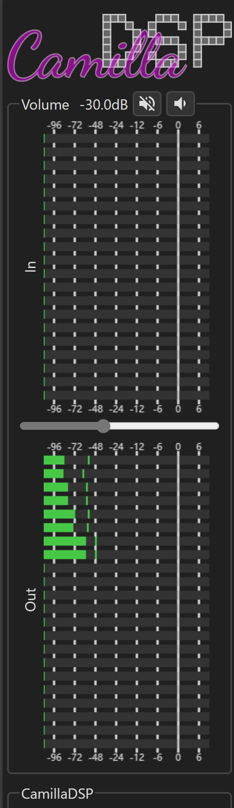

There are two bugs I found in Alpha-2 so far. One is that from time to time, in volume section, output level bars will not disappear even there is no input. The other one is that when creating a new config in GUI with different sample rate(comparing to the sample rate of the config that is applied at the moment) with resampler_type set to none, the capture sample rate will not change to the new value unless you set resampler_type to values other than "none". Minor issues though.
