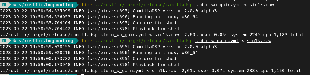

I'm seeing some weird results that make me think this is a pre-existing bug that is now being triggered in 2.0.0a3. I don't think it's related to sse4.2, though enabling sse4.2 seems to mask it for some reason.
This should be easy to reproduce. First generate a 16-bit stereo raw file, say with sox:
The reason I think this is a pre-existing bug is if I remove the Gain filter from the start of the pipeline I get similar results with v1.0.3.
The modified config file is:
Both the binaries I'm using are straight off github.
Use this config file:sox -V -r 48000 -n -b 16 -c 2 sin1k.raw synth 300 sin 1000 vol -10dB

Doing the same thing with v2.0.0a3 is tricker as it goes into a loop at the end of the file rather than terminating so I need to quickly hit Ctrl-C when it starts looping:$ time ./camilladsp-1.0.3 config-gain.yml < sin1k.raw
2023-09-19 22:03:42.132408 INFO [src/bin.rs:711] CamillaDSP version 1.0.3
2023-09-19 22:03:42.132446 INFO [src/bin.rs:712] Running on linux, x86_64
2023-09-19 22:03:43.226724 INFO [src/bin.rs:420] Capture finished
2023-09-19 22:03:43.226874 INFO [src/bin.rs:410] Playback finished
real 0m1.098s
user 0m1.798s
sys 0m0.192s
The warnings are new and the CPU used is significantly higher - 11 seconds vs 1.8.$ time ./camilladsp-2.0.0a3 config-gain.yml < sin1k.raw
2023-09-19 22:06:23.548472 INFO [src/bin.rs:690] CamillaDSP version 2.0.0-alpha3
2023-09-19 22:06:23.548493 INFO [src/bin.rs:691] Running on linux, x86_64
2023-09-19 22:06:27.550472 WARN [src/filedevice.rs:449] sample rate change detected, last rate was 1381731.3567070565 Hz
2023-09-19 22:06:28.551566 WARN [src/filedevice.rs:449] sample rate change detected, last rate was 1387024.768191978 Hz
2023-09-19 22:06:29.552479 WARN [src/filedevice.rs:449] sample rate change detected, last rate was 1385233.6130594476 Hz
2023-09-19 22:06:30.553721 WARN [src/filedevice.rs:449] sample rate change detected, last rate was 1388870.332724759 Hz
2023-09-19 22:06:31.554895 WARN [src/filedevice.rs:449] sample rate change detected, last rate was 1384869.1706424702 Hz
2023-09-19 22:06:32.555385 WARN [src/filedevice.rs:449] sample rate change detected, last rate was 1385816.6255723792 Hz
2023-09-19 22:06:33.555945 WARN [src/filedevice.rs:449] sample rate change detected, last rate was 1385743.855650237 Hz
2023-09-19 22:06:33.940457 INFO [src/bin.rs:390] Capture finished
2023-09-19 22:06:33.941769 INFO [src/bin.rs:378] Playback finished
2023-09-19 22:06:33.942108 INFO [src/bin.rs:390] Capture finished
2023-09-19 22:06:33.942143 INFO [src/bin.rs:378] Playback finished
2023-09-19 22:06:33.942372 INFO [src/bin.rs:390] Capture finished
real 0m10.759s
user 0m11.116s
sys 0m0.663s

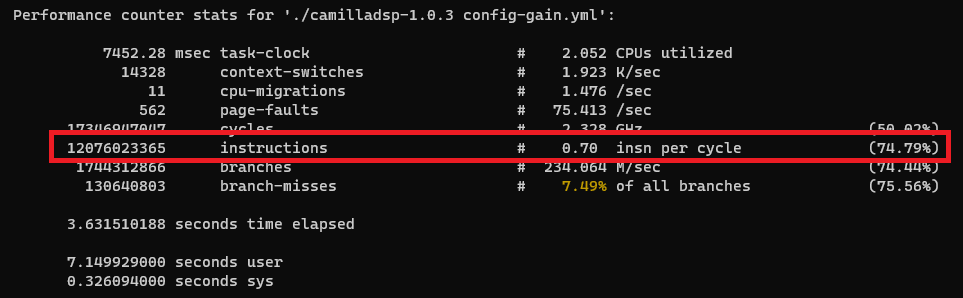

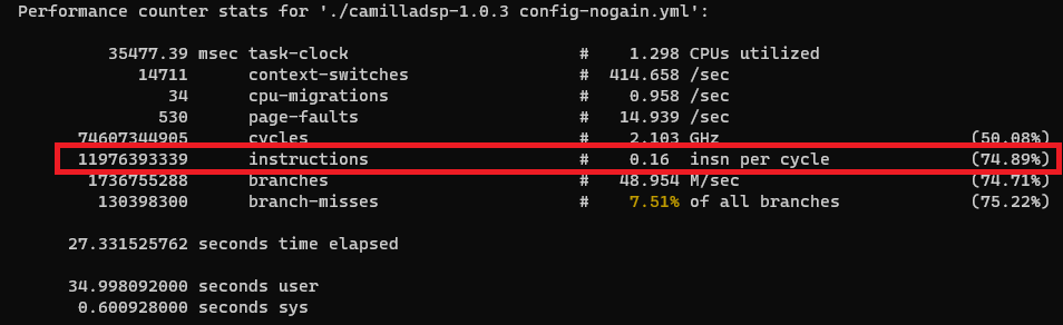

And the results with v1.0.3:devices:

i.e. the same warnings that v2.0.0a3 gave and similarly high CPU usage. I have no idea why just removing a filter from the start of the pipeline would have this effect.$ time ./camilladsp-1.0.3 config-nogain.yml < sin1k.raw
2023-09-19 22:15:46.061027 INFO [src/bin.rs:711] CamillaDSP version 1.0.3
2023-09-19 22:15:46.061066 INFO [src/bin.rs:712] Running on linux, x86_64
2023-09-19 22:15:50.063601 WARN [src/filedevice.rs:446] sample rate change detected, last rate was 1392380.5396331032 Hz
2023-09-19 22:15:51.064191 WARN [src/filedevice.rs:446] sample rate change detected, last rate was 1399996.1421033302 Hz
2023-09-19 22:15:52.065452 WARN [src/filedevice.rs:446] sample rate change detected, last rate was 1394977.1528217047 Hz
2023-09-19 22:15:53.065904 WARN [src/filedevice.rs:446] sample rate change detected, last rate was 1394059.4980337278 Hz
2023-09-19 22:15:54.066315 WARN [src/filedevice.rs:446] sample rate change detected, last rate was 1392067.1810598 Hz
2023-09-19 22:15:55.066767 WARN [src/filedevice.rs:446] sample rate change detected, last rate was 1396104.2753803288 Hz
2023-09-19 22:15:56.067404 WARN [src/filedevice.rs:446] sample rate change detected, last rate was 1397894.6719907317 Hz
2023-09-19 22:15:56.379869 INFO [src/bin.rs:420] Capture finished
2023-09-19 22:15:56.381235 INFO [src/bin.rs:410] Playback finished
real 0m10.323s
user 0m10.883s
sys 0m0.240s
I'm trying to reproduce this but haven't had any luck so far. Unfortunately I don't have anything with an Atom CPU. It doesn't happen on the only x86 linux machine I have (a laptop with a first generation AMD Ryzen). I don't expect it to happen on ARM but I will try when I have a little time.
The sample rate change warnings are normal. They will come every few seconds, so when it runs fast it has already finished when the first one would have appeared.

Running with "perf stat" gave some interesting information: The "good" performance scenario:
And the"bad" performance scenario:
I'm focusing on v1.0.3 because that way I can see the difference in performance with an identical codebase. The results with v2.0.0a3 are similar to the "bad" scenario.
This shows the number of CPU instructions executed is roughly the same, but the instructions per clock drops from 0.70 to 0.16. In other words, CamillaDSP is functioning the same but the CPU is running less efficiently in the second case. The results above are for the Atom N3700. The pattern was the same on other Intel CPUs though with overall performance being much higher.
I am way out of my depth trying to understand why a change in the config file would lead to this change in CPU performance. I wondered if it might be something to do with spectre/meltdown mitigations as some of those were supposed to have a big performance hit, so I tried setting "mitigations=off" in the kernel command line but that didn't make any difference. Some of the mitigations were also in CPU microcode but that's much harder to roll back to test. Anyway that's just a guess.
I'm getting this performance difference only on Linux. I tested under Windows and didn't see any difference.
As I indicated above, compiling with target-cpu=x86-64-v2 avoids this problem - at least on the scenarios I've tested.
The takeaway seems to be that on Linux machines with slightly older Intel CPUs, target-cpu=x86-64-v2 gives improved and more consistent performance. I don't have anything more recent than a 9th gen CPU, so I don't know what the effect is on more recent CPUs. I'd suggest adding this option to the standard compile options - at least on Linux. That would rule out some very old CPUs but should be compatible with anything since 1st gen Core i5/i7 (2008) and AMD Bulldozer (2011).
