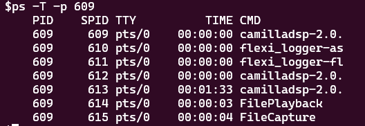

These are the threads created by v2.0.0a3 while encountering the performance issue:It's expected the major load comes from the processing thread, but it may not hurt to confirm, e.g. https://unixhealthcheck.com/blog?id=465
Three threads are using CPU time. Two are clearly the capture and playback threads. The third - the one with the high CPU usage - isn't labelled but is presumably the processing thread.
I also ran the test on an rpi3b+ and didn't find a performance issue. It looks like it's specific to the combination Intel + Linux.

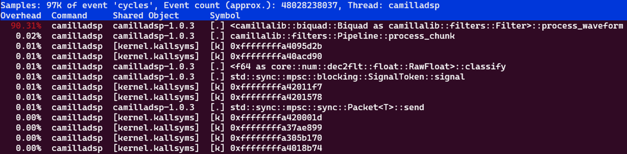

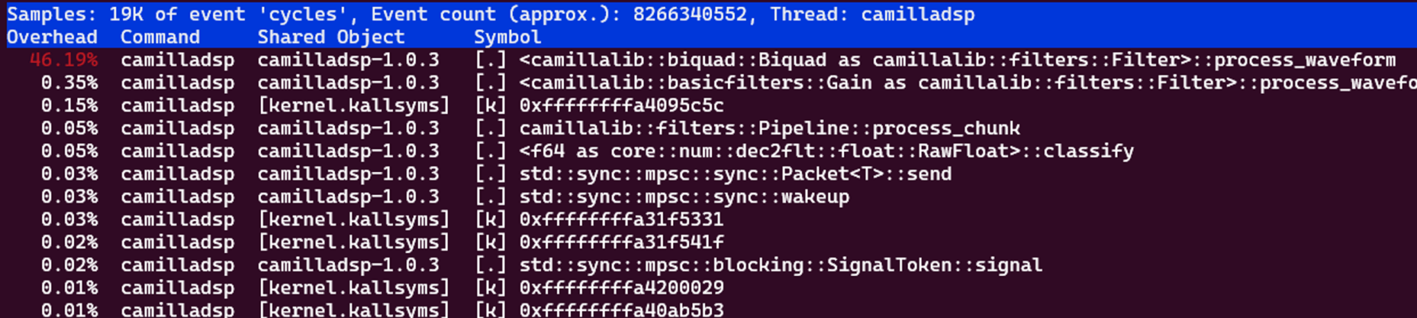

Here is some more information from perf showing the functions executed in thee processing thread. I haven't yet explored the extra debug options, but will do that. For these tests I've gone back to 1.0.3 as that lets me compare the two performance states by just changing the config.
First is 1.0.3 from github (default compiler settings) with the Gain filter - i.e. good performance:
Next is the exact same binary without the Gain filter - i.e. bad performance
The two look very similar except:
- Gain:
- The number of "event cycles" goes up. I assume this reflects the overall runtime being longer
- The percentage of time spent in Biquad:
I'm not sure what to make of this, other than the exact same code is running slower for no apparent reason. The "perf stat" results I posted earlier are for these same scenarios - so the slowdown seems to be due to reduced IPC but there's no obvious reason for that. Biquad:

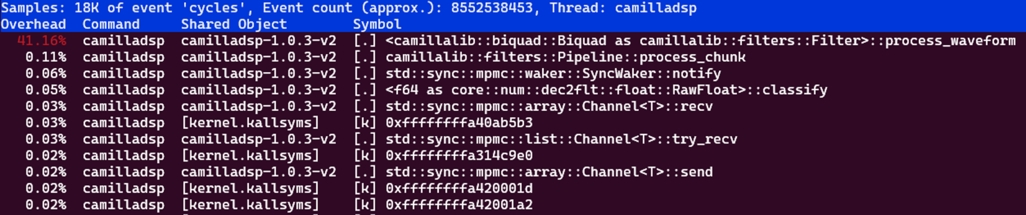

Finally for comparison here's v1.0.3 compiled with target-cpu=x86-64-v2 without the Gain filter (i.e. the same config as test 2)
The performance is pretty much the same as the test 1, so it's good to see the problem has gone away, but again there's no obvious reason why.

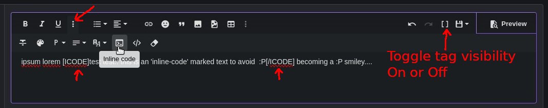

@spfenwick
ipsum lorem
smiley....
ps. The post is editable for 30 minutes from posting it, after 30 minutes the edit button disappears, except for post #1 which can be edited indefinitely by the thread starter.
Sorry for the off-topic, cheers.
ipsum lorem
test test.. this is an 'inline-code' marked text to avoid :P
becoming a ps. The post is editable for 30 minutes from posting it, after 30 minutes the edit button disappears, except for post #1 which can be edited indefinitely by the thread starter.
Thanks. I didn't realise my post was being "smilied" when I wrote it.Sorry for the off-topic, cheers.
@spfenwick
I forgot to mention one can press the 'Preview' button to the right in the post editing window (desktop PC browser) to see how the post comes out before posting it, eventual smileys and other artifacts will show up.

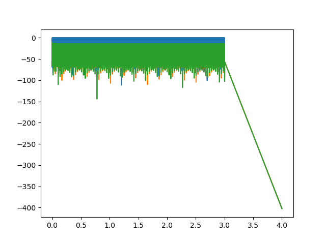

I implemented a biquad in Python to make it easier to track the values. It doesn't help, I can't explain how there can be denormals while a sine is playing.
This is the output, and the internal variables while processing a 1 kHz sine at 48 kHs sampling rate. The filter is the same Peaking filter as @spfenwick used in the example.
Blue is the signal, green and orange are the s1 and s2 state variables, all shown on a dB scale. While the sine wave is playing, they all stay >-150 dB which is well within what can be represented with normal numbers (with a margin of over 1000 dB!).
Then the signal ends at 3 seconds, and the variables all start dropping until they end are low enough to need denormals, some seconds after the plot ends. That is the problem that was solved by flushing denormals after each chunk.
This is as far as I have gotten today. To be continued..
