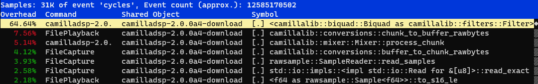

Could you run perf annotate on this so we see what instruction that gets slow? I have revived an old Intel machine I had forgotten about, an old Haswell i5 with Debian Stretch. When running on this one I can reproduce the first issue, but I don't see this new one with the crossfeed config. The OS is too old to run the binaries from github so I had to recompile, might be why things are different.Here's the config that causes the problem. It's doing a straightforward headphone crossfeed.

Here's perf report on the github version of 2.0.0a4 (running slowly)Could you run perf annotate on this so we see what instruction that gets slow?

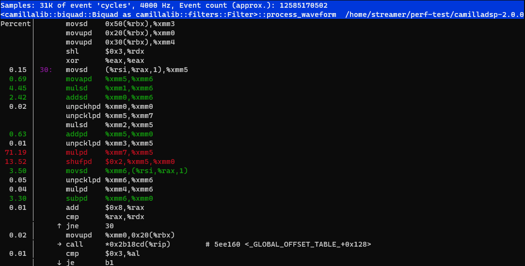

And the perf annotate results for the same test:

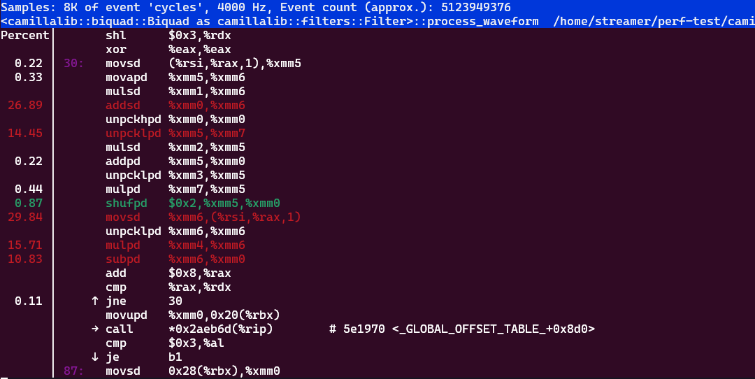

For comparison here's perf annotate on my version of 2.0.0a4 with the sse2 registers zeroed out:

@spfenwick thanks for testing that! The issue isn't as easy to spot with
codegen-units=1
, but it's still there. Now the pronlem is unpcklpd %xmm5,%xmm7
that keeps whatever happens to be in one of the lanes of xmm7.Still thinking about what to do about that compiler bug. It doesn't seem to be possible to make a complete fix without raising the cpu requirements to include sse 4.2.
