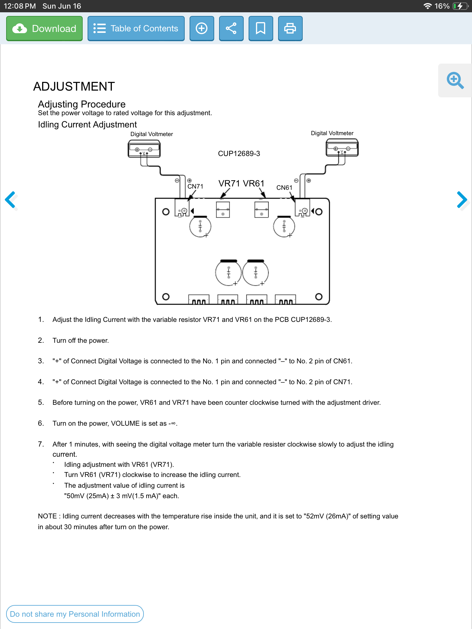

do you think ‘ upgrading’ the transistors on the Marantz headphone amp part, would offer better performance?
currently there are two Sanken 2SD2081 Darlington BJT transistors feeding the headphone amp part.
they are located just above IC99 In the below link to the diagram.
https://www.manualslib.com/manual/2859921/Marantz-Hd-Dac1.html?page=60#manual
The RME ADI is a professional DAC that measures good, but sound character-wise it reminds me of the song; "The Polyester Girl". I could not listen to that thing for longer than 10min... but my taste might be completely different from yours. Many people like this DAC. As I said, listen and decide for yourself.
DAC3 I haven't had the pleasure to demo at my place.
I'd leave the Darlingtons alone... just do the voltage regulators as I suggested...

@Extreme_Boky
i forgot to ask
does number 6 below mean to turn up the volume all the way up when adjusting the bias?
doesn’t really make a diff
i forgot to ask
@Extreme_Boky
it makes no diff in the reading on the voltmeter anyway.
but the instructions are odd
shouldn’t I just wait 30 min and then adjust since the idling current changes with temp?
and then check after a day or so to make sure it didn’t drift?
thanks
thanks

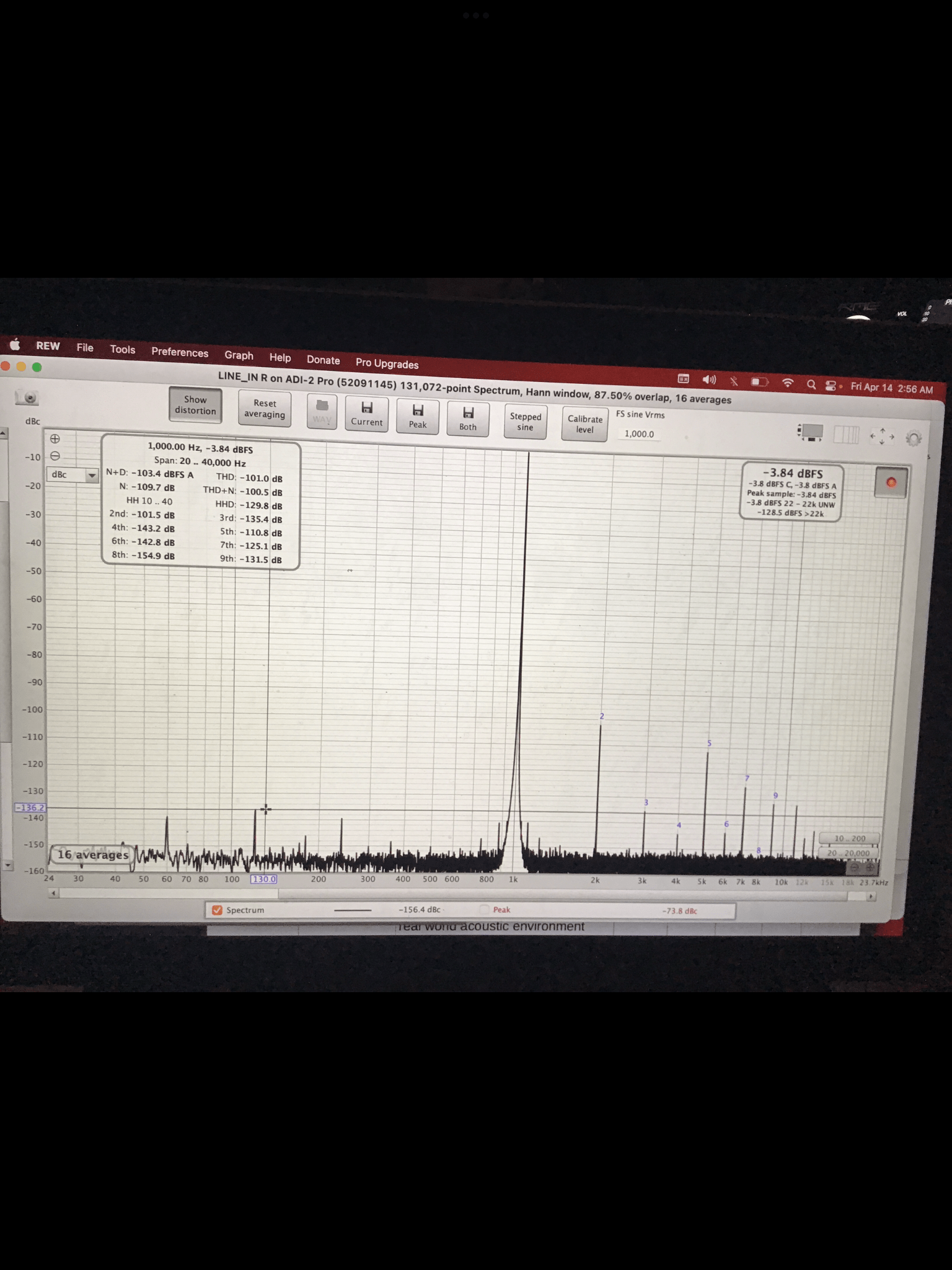

@rfbrw , yeah I know how to use REW with a AD and measure distortion from the DAC by connecting the analog out of the DAC and measuring using an FFT.
such as what I did here with the Marantz below in the pic.
to measure where the crossover distortion is for the headphone amp, do I need to pass a 1khz sinewave and take the headphone out Jack of the headphone amp and pass it through a load like mt headphones into the AD And use the oscilloscope in REW?
thanks
