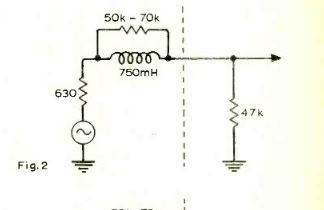

I've been rootling around looking for references where people have done work coming up with a better electrical model for a cartridge. First reference I have found is Reg Williamson from a wireless world letter in 1973. This is the first reference to a 'semi-inductance' with a resistance in parallel to the coil inductance.
Holmans 1975 AES paper discusses things a bit but skirts around the useful meat. He does however reference another AES paper by Hallgren which may hold useful information. Holman paper is here for those who don't have a copy.http://www.kallhovde.com/advent/phono-pre-research.pdf
Oddly (or not) MM goes out of fashion around then and very little is published for a while. Rod Elliot did some analysis around 2012 Magnetic Phono Pickup Cartridges and I've been messing around with that model to see if it gives the answers I would expect. Still no luck on that so far but spare time is temporarily short.
And one of the references Rod notes is a post from 2011 by a certain 'dlaloum' which is around the time some of the purged research was being done with LD?
Edit. Williamson model screenshot attached.

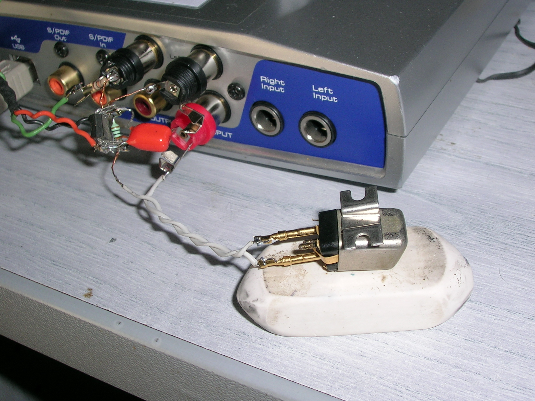

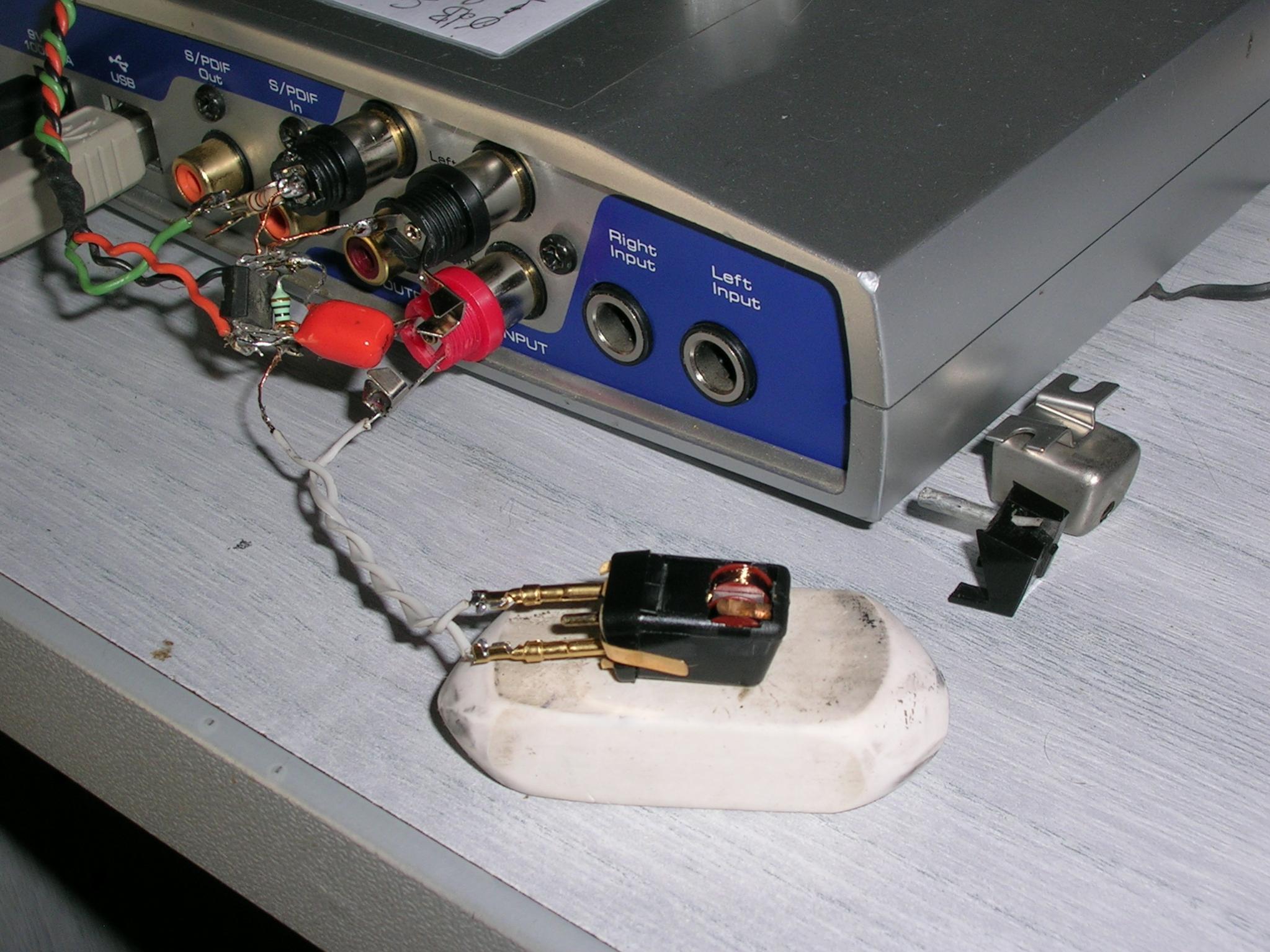

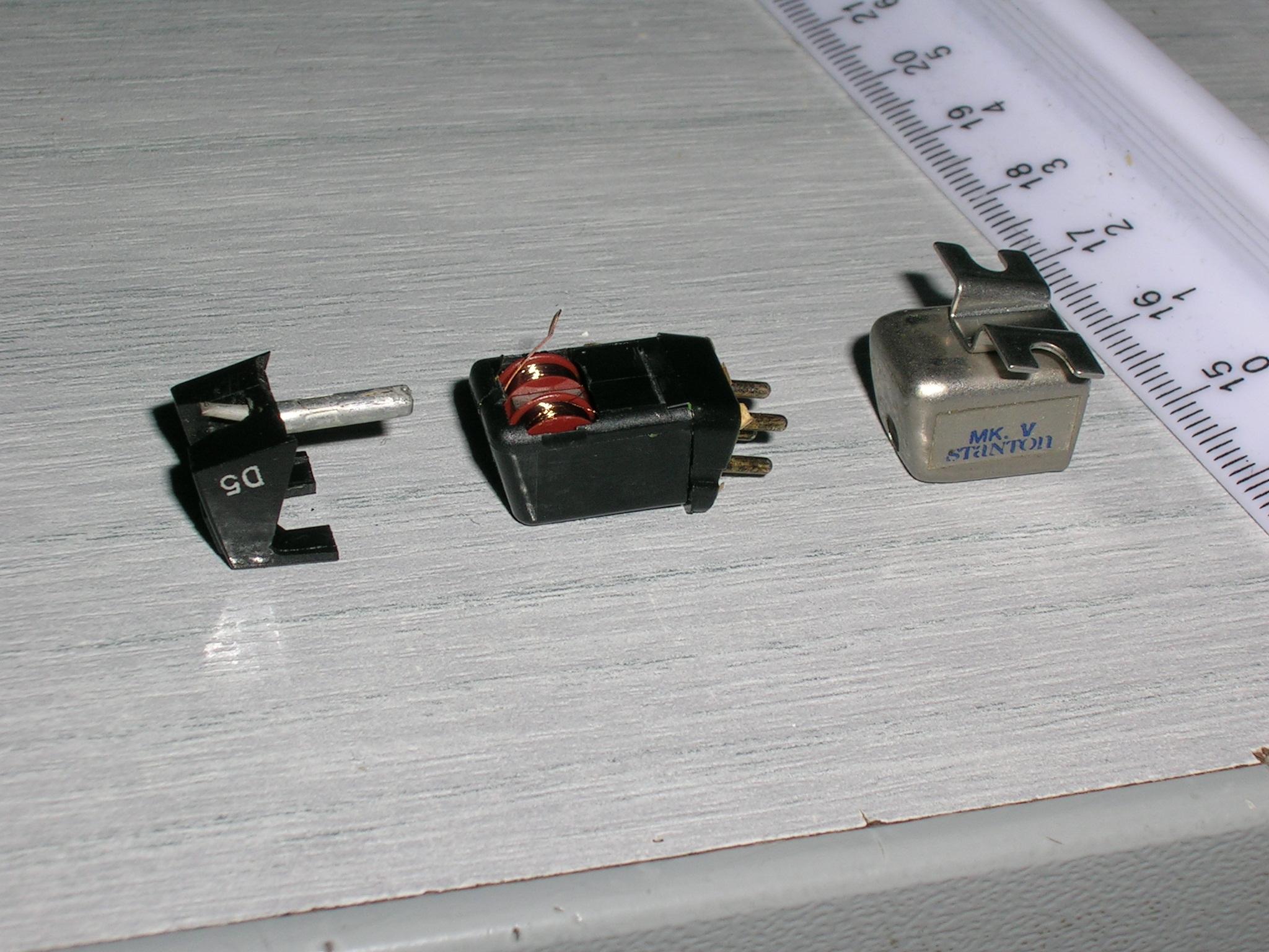

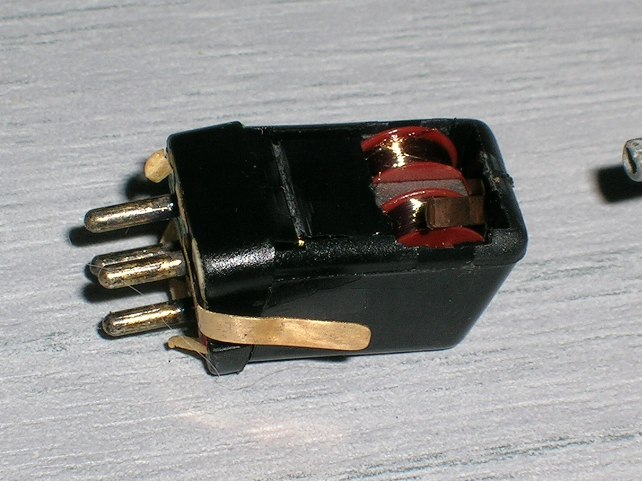

Good idea David. I will test the influence the metal shielding (don't know it's composition) may have on the impedance of this Stanton.
The Williamson model is somewhat similar to Bill Whitlock's Jensen audio transformer model, except that the parallel resistor is non-linear in Whitlock's text. It's not expanded in the Whitlock text though, beyond hysteresis and eddy current mechanisms.

Thanks, George. That will be interesting because it's said to have audible effect for some cart/coil topologies. But does Davidsrsb not mean permalloy foil laminations used in coil cores ?Good idea David. I will test the influence the metal shielding (don't know it's composition) may have on the impedance of this Stanton.
George
LD
Thanks, that's consistent both with Williamson's, and Whitlock's sketch models for real magnetics. Whitlock identifies RLT as being non-linear resistance. The devil is in the detail (and further expansion) of RLT, representing losses, methinks.The Hallgren improved equivalent circuit:
