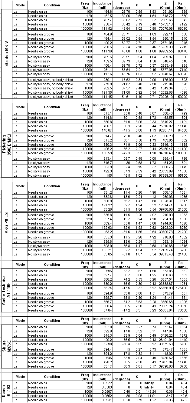

Can't see anything in the pic, resolution is too low. But impedance measurements are a fraction of the total system, don't begin to tell the whole story, and by themselves might prove misleading.Some measurements on cartridges (one channel) with an LCR meter (DER EE model DE-5000)

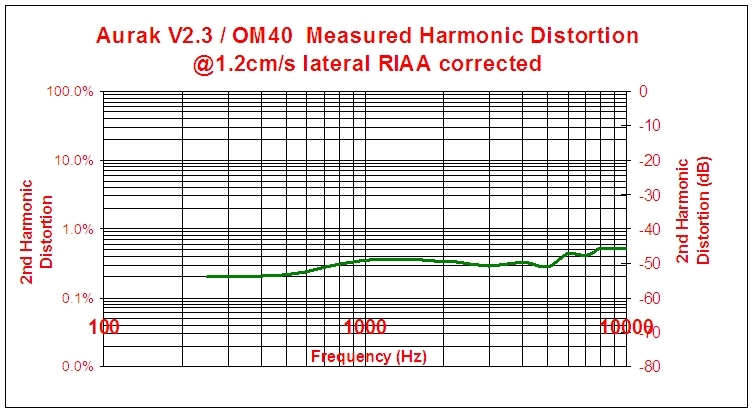

More interesting (though still not definitive) would be THD vs Frequency vs Level. Anybody have that data?

Left click over the attachment.
Then Left click on the lower left corner over the X rectangle.
The LCR measurements is one set of data.
Cartridge Impedance plots will come later. It's another set of data (and a lot of it).
We'll see which of those are useful and which are not. Maybe all is useless.
After that, suggestions will help to do other tests.
I can't help it if you are in a hurry. I have only so much time.

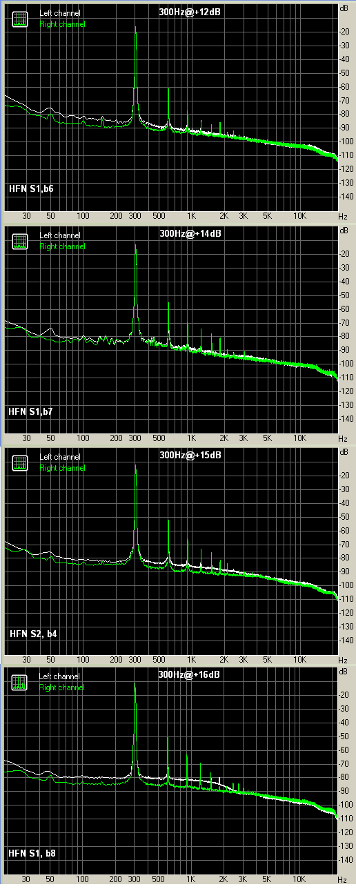

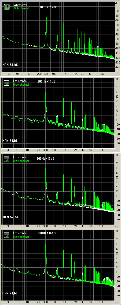

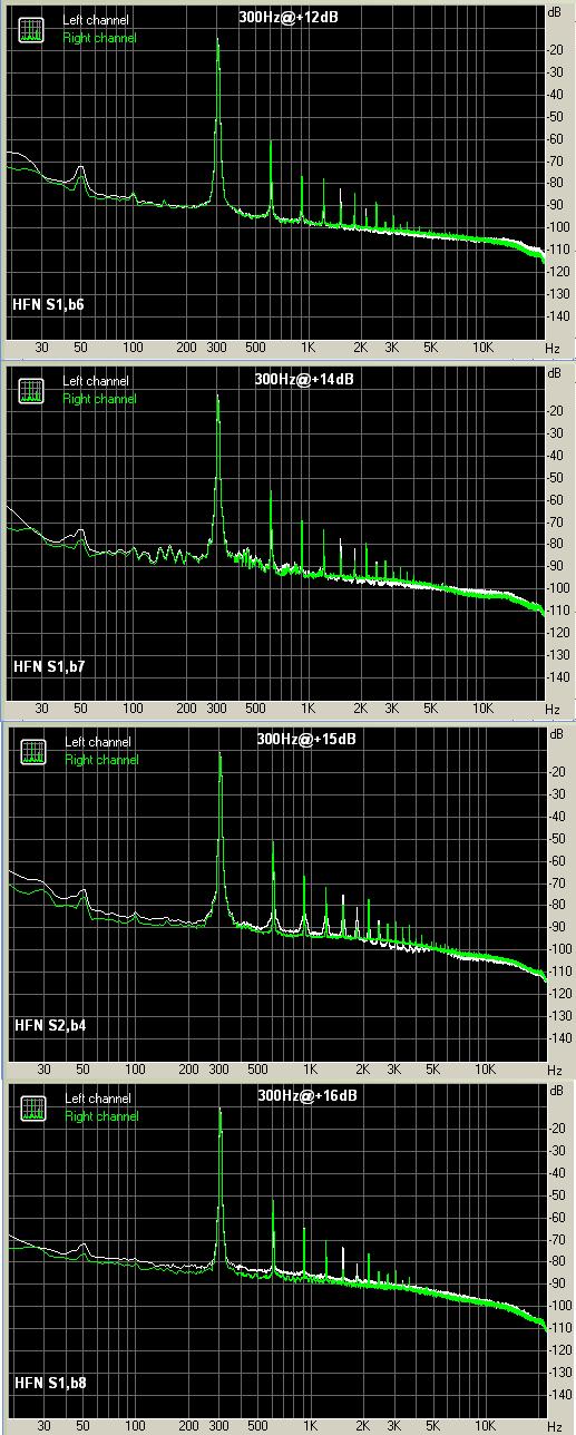

You mentioned distortion vs signal level. Distortion increases with level, evident on single tone test tracks playback.
Note, this varies with the system and adjustment level. (attachements are from the same system at different adjustment points)
I think there are good indications that increased distortion increases loudness thus perception of dynamics.

Yes, increased distortion changes perceived loudness, but to couple that with the perception of dynamics is a very slippery slope. Generally, distortion caused by nonlinearity reduces the perception of dynamics, often in a very pronounced way. It's a tool used in loudness war processing, for example.You mentioned distortion vs signal level. Distortion increases with level, evident on single tone test tracks playback.
