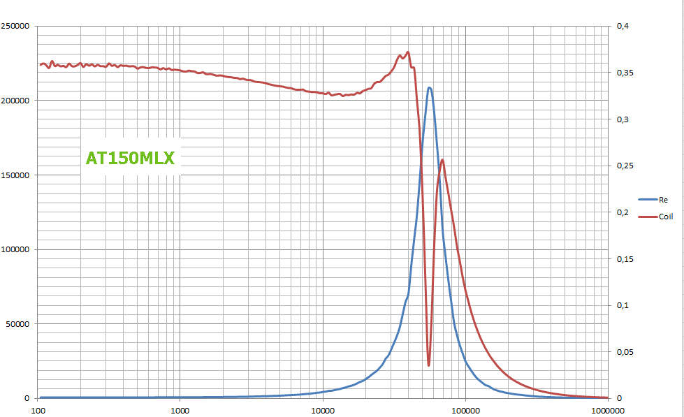

Just as a first test to check everything, here the inductance of the AT150MLX with 4.5mV applied.

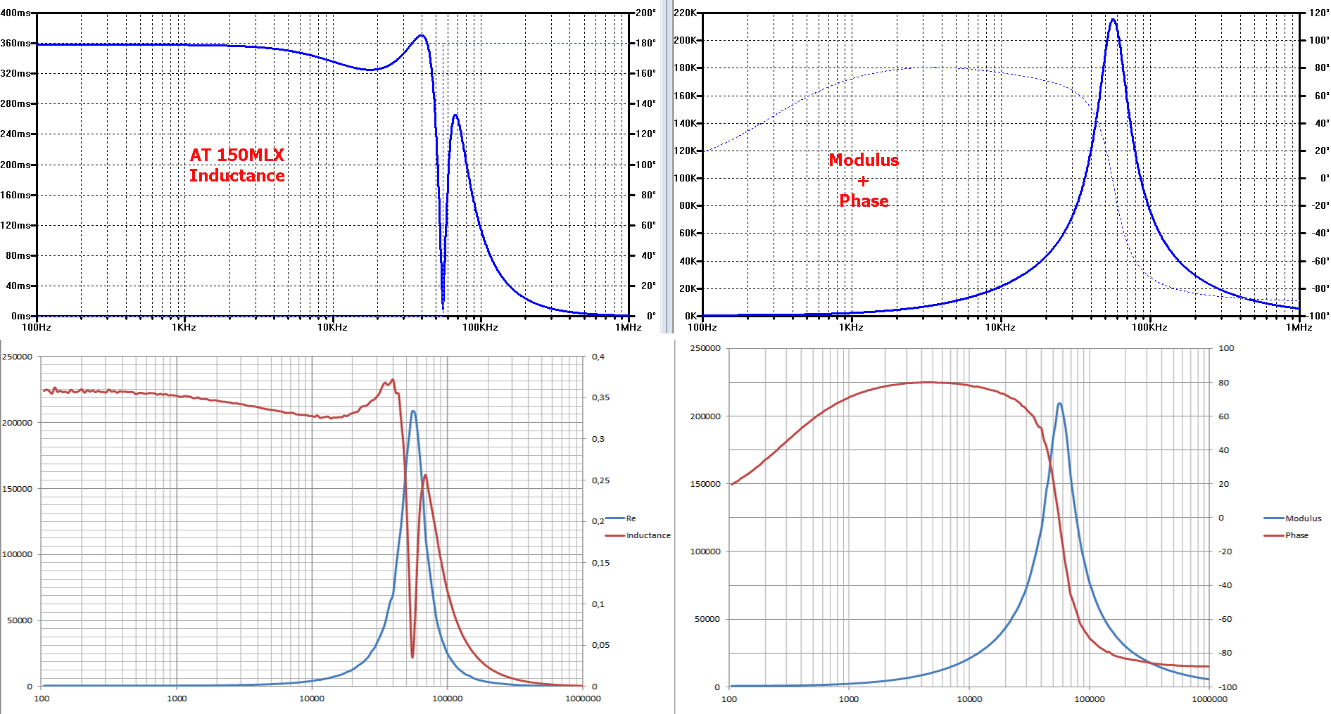

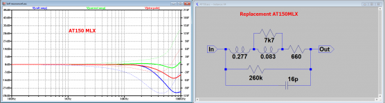

I'm still working on the measurement set up, but results for the AT150MLX are good enough to be translated into a replacement circuit and that's what I wanted to show already for eventual comments.
The first image below shows the replacement circuit, its FR through a 47k //150pF amp in blue and through a virt. gnd amp in green.
The latter also with an added 6usec filter in red.
The second image shows the measured data versus the simulated results.
Measured and simmed go from 360mH to 325mH, have peaks at 370mH, an Fres at 56kHz, where the modulus is 215K and a par. cap of 16pF.
The only small difference is that in the measured data the inductance rolls off slightly earlier, but for the rest everything is the same.
A bit surprisingly, the value of the part of the coil with the par. resistor comes quite precise, in this case 0.083mH.

Heat, the model fits losses to resistances some are easy to understand like series resistance but any loss like eddy current and skin effects will usually end up as heat at these frequencies I don't think much is radiated away.

In the meantime I found why there was a small discrepancy between measured and simmed results where the measured inducance started somewhat earlier to roll off.
My test gear, showing the details later, has a 14pF//1 Meg input.
I included the cap in my sim, but forgot the 1Meg. This results in a small correction of the replacement circuit that I will also show tomorrow.
